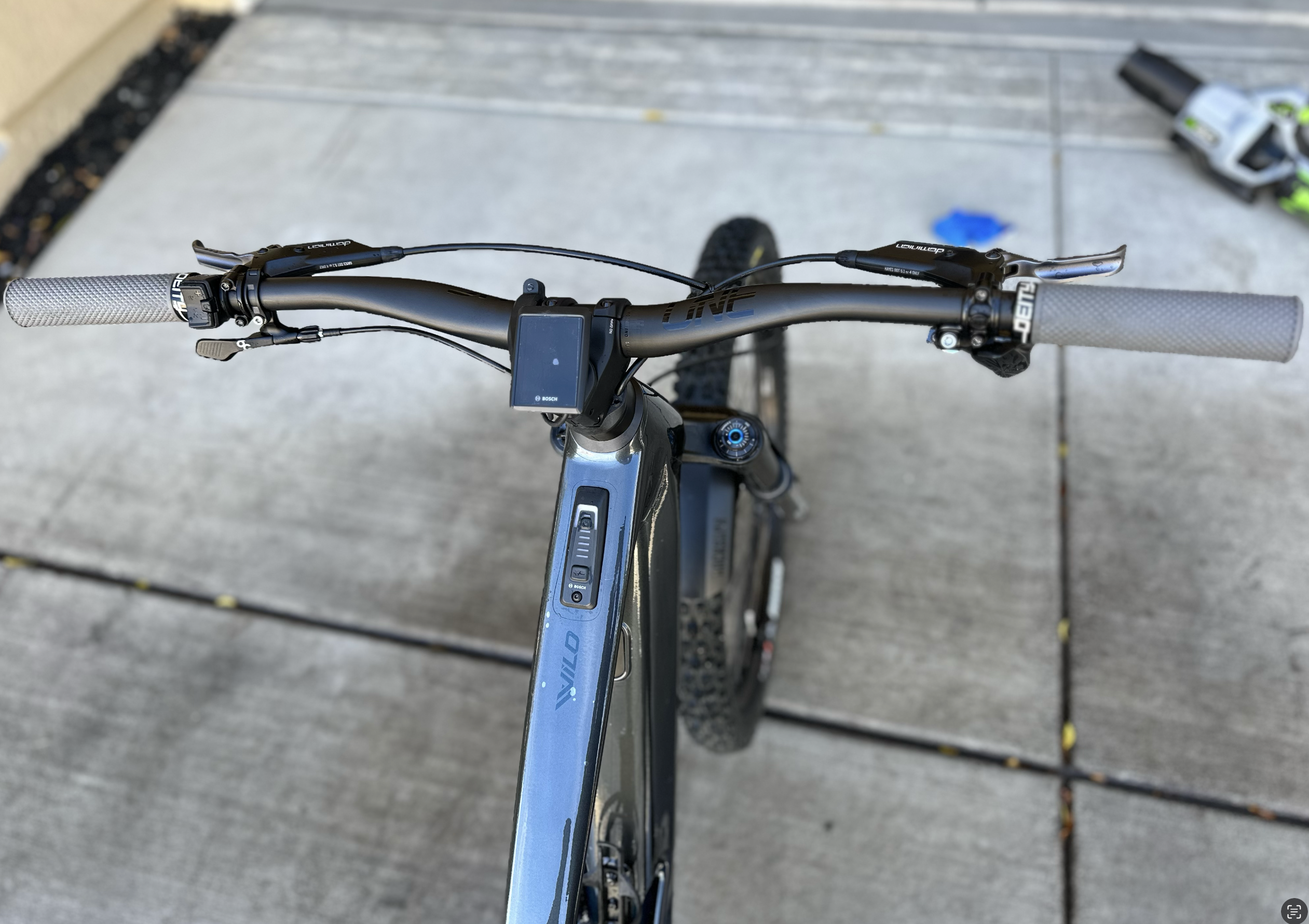

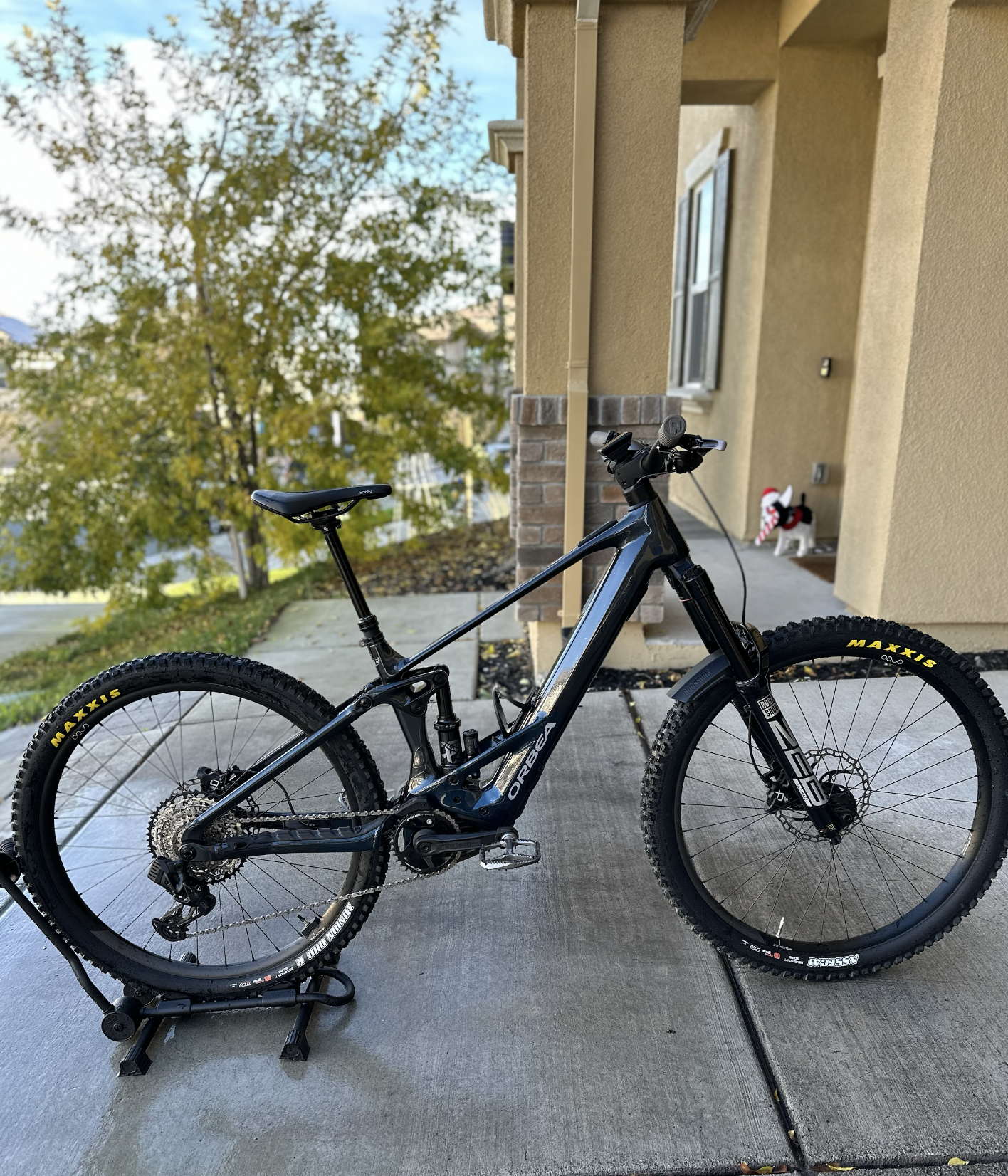

Recently picked up my 2023+ Wild H10! Upgraded a few things through my LBS:
  • RS Zeb Ultimate 170mm
  • Hayes Dominion A4 Brakes
  • SRAM AXS GX shifter
  • 170mm dropper
  • OneUp carbon E-bar
  • DH casing tires
  • Kiox 300 display. Not sure if I'll keep the display or not - I wish the Bosch "smart" system would connect to external devices like Wahoo/Garmin etc. I may just want a completely clean cockpit and stick my wahoo in my fanny pack (lol)

I didn't realize how limited fitment for rear shocks is, but I guess It makes sense with the frame design. I had a RS SuperDeluxe coil I wanted to throw on but I read on multiple forums (including this one) that it will rub the frame. Oh well, the Float X will do for now - I'll explore that later. It's just so fun to ride already! I do enjoy the headset routing for a super clean cockpit.
The only thing I may want to upgrade soon is going to 220mm rotors + a new dropper lever to go with the matchmaker setup.

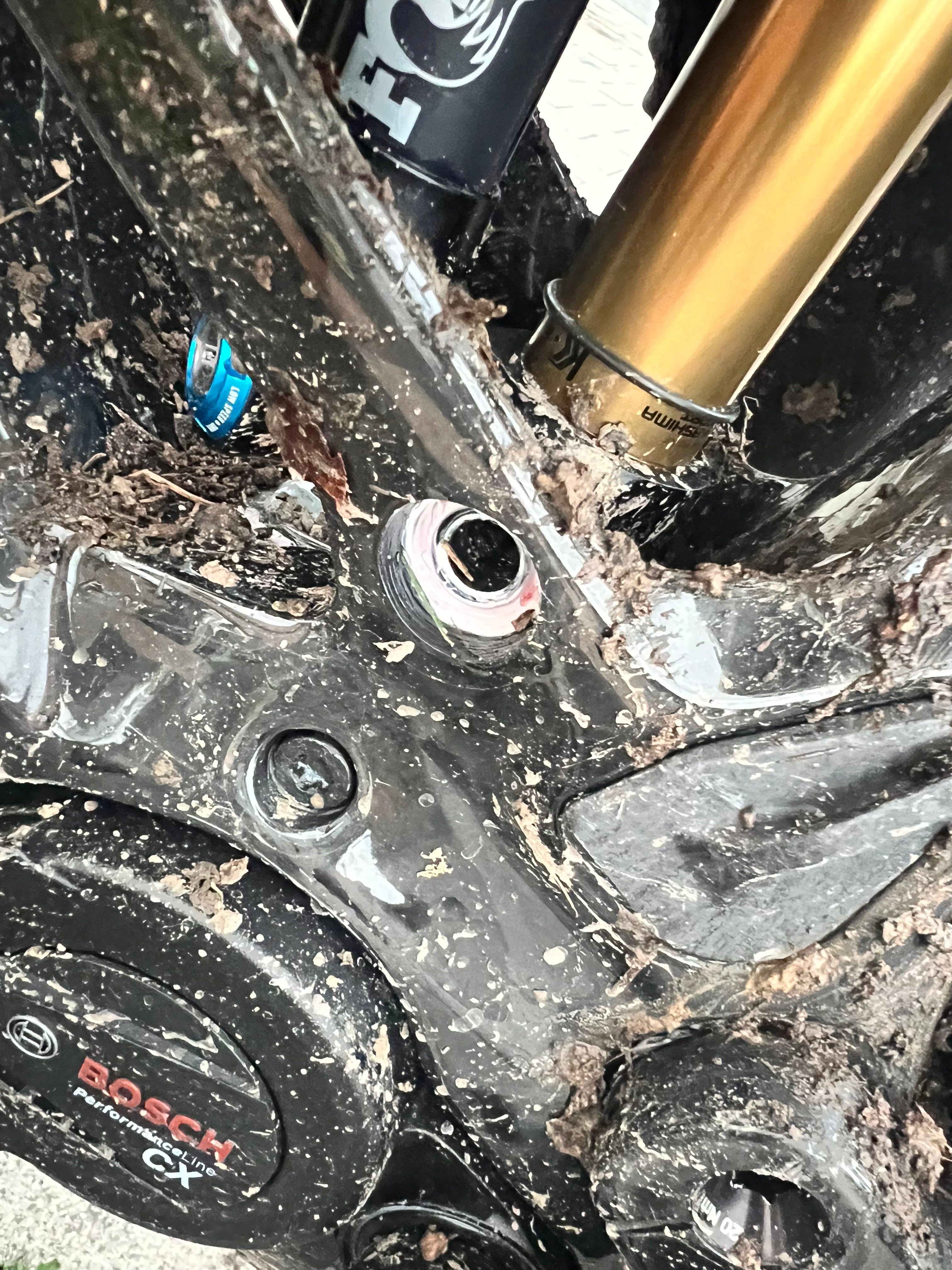

Guys, check your lower shock mounts. I lost one screw today on the trail, and this was the third ride.
I checked all torque specs after the first ride and everything was fine.
  • 170mm dropper
  • DH casing tires
  • Kiox 300 display. Not sure if I'll keep the display or not - I wish the Bosch "smart" system would connect to external devices like Wahoo/Garmin etc. I may just want a completely clean cockpit and stick my wahoo in my fanny pack (lol)View attachment 131187
