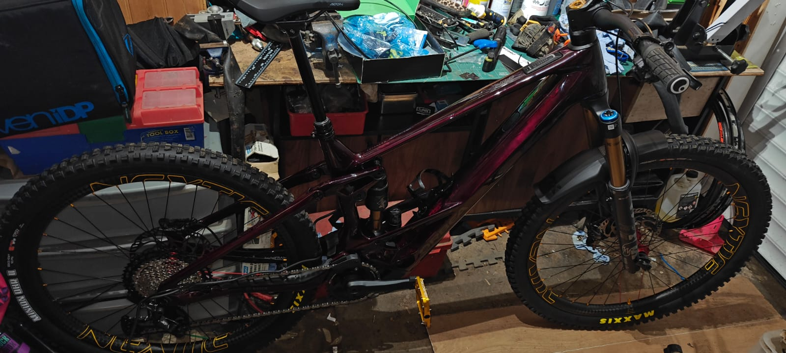

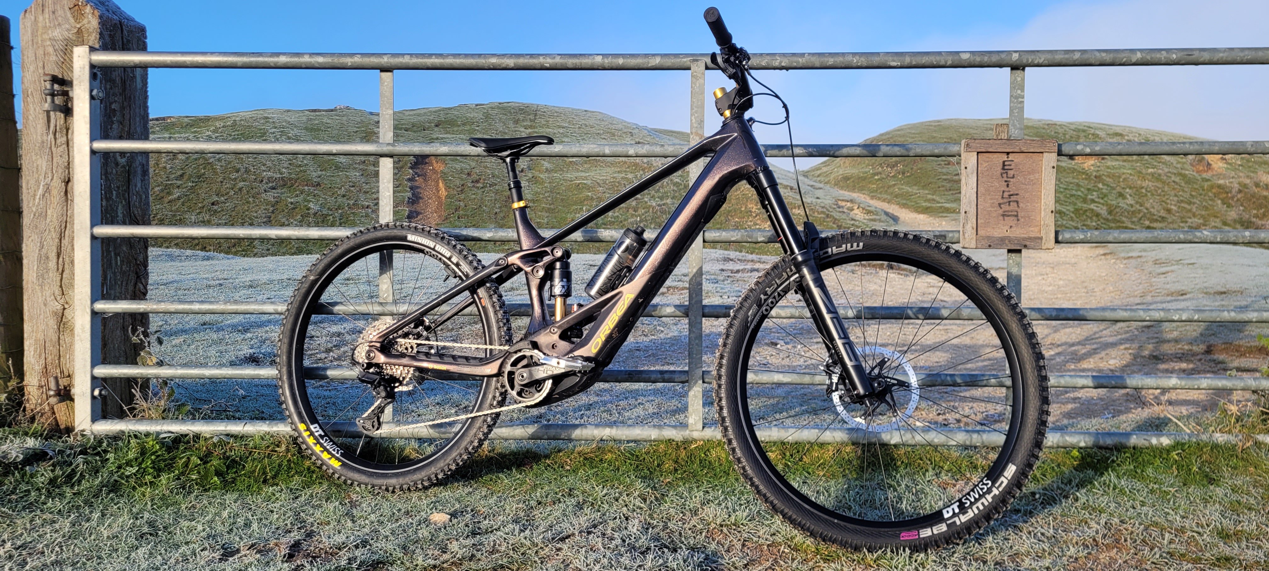

Here's mine. 23 XL M20 with just about everything changed. Mismatched suspension and tyres because reasons
Zeb Select plus which is near identical to the Ultimate, I've had a couple of sets of Ultimates and can't tell the difference
24 Fox X2
H1700 wheels
Tech4 V4s with TRP 2.3 rotors
Linkglide drivetrain
Praxis HD cranks
PNW Loam XL grips
Nukeproof enduro saddle
Headset top plate to remove the knock block thing and stupid spacers
Got a Oneup bar and 240mm dropper on the way
Also put a bead of silicone under the system controller and the accessory plate on the downtube to stop water ingress

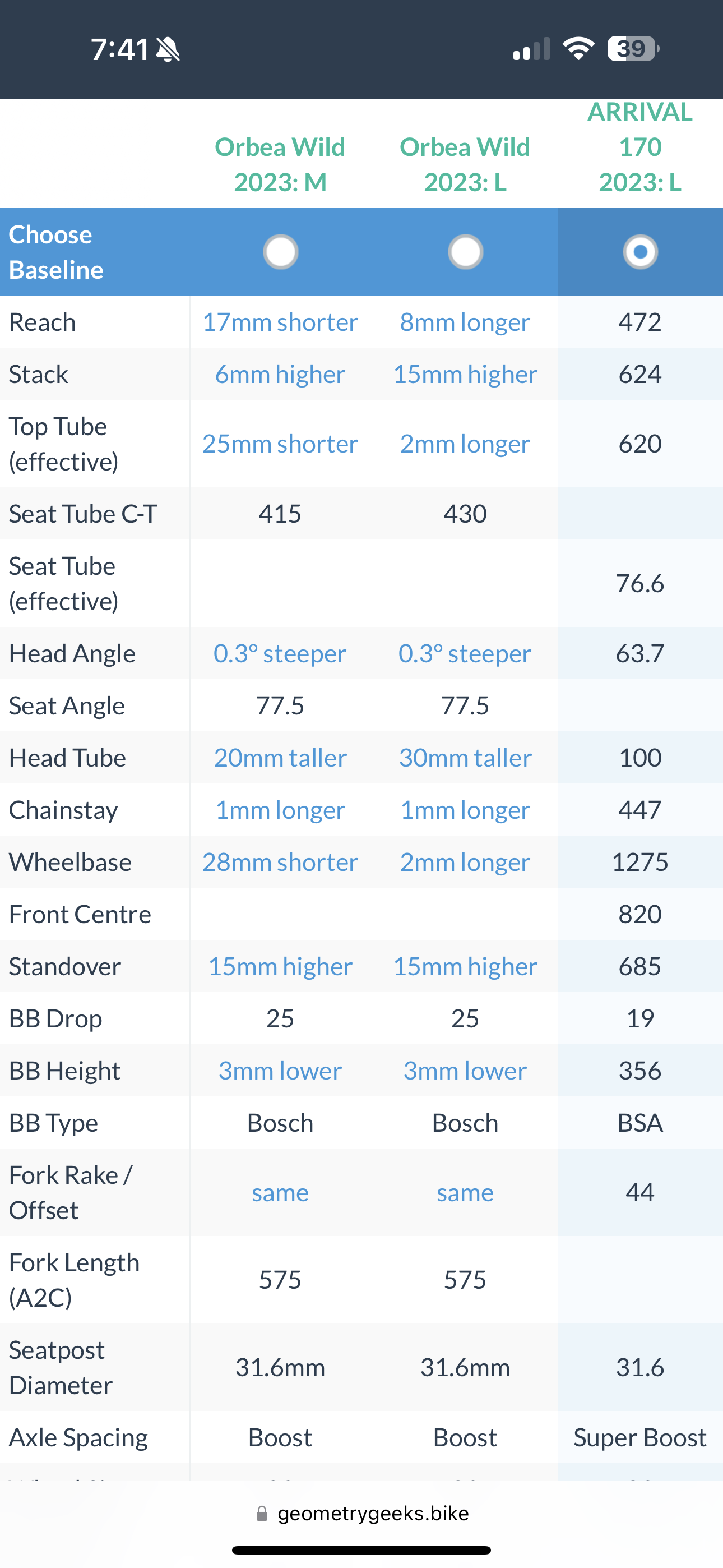

So I’ve had an offer for 25% off on an M20 and now my dilemma is what size.
I’m between medium and large.
Wingspan ~67"
Foot to Groin ~32"
Height 70.5-71"
I ride a Large Arrival 170 which is 472 reach. It’s comfy for me, but I may want a more neutral less race position on the e-bike. I’m undecided.
Would be easier to know if anyone else bought a bike while at the upper end of the sizing spectrum.

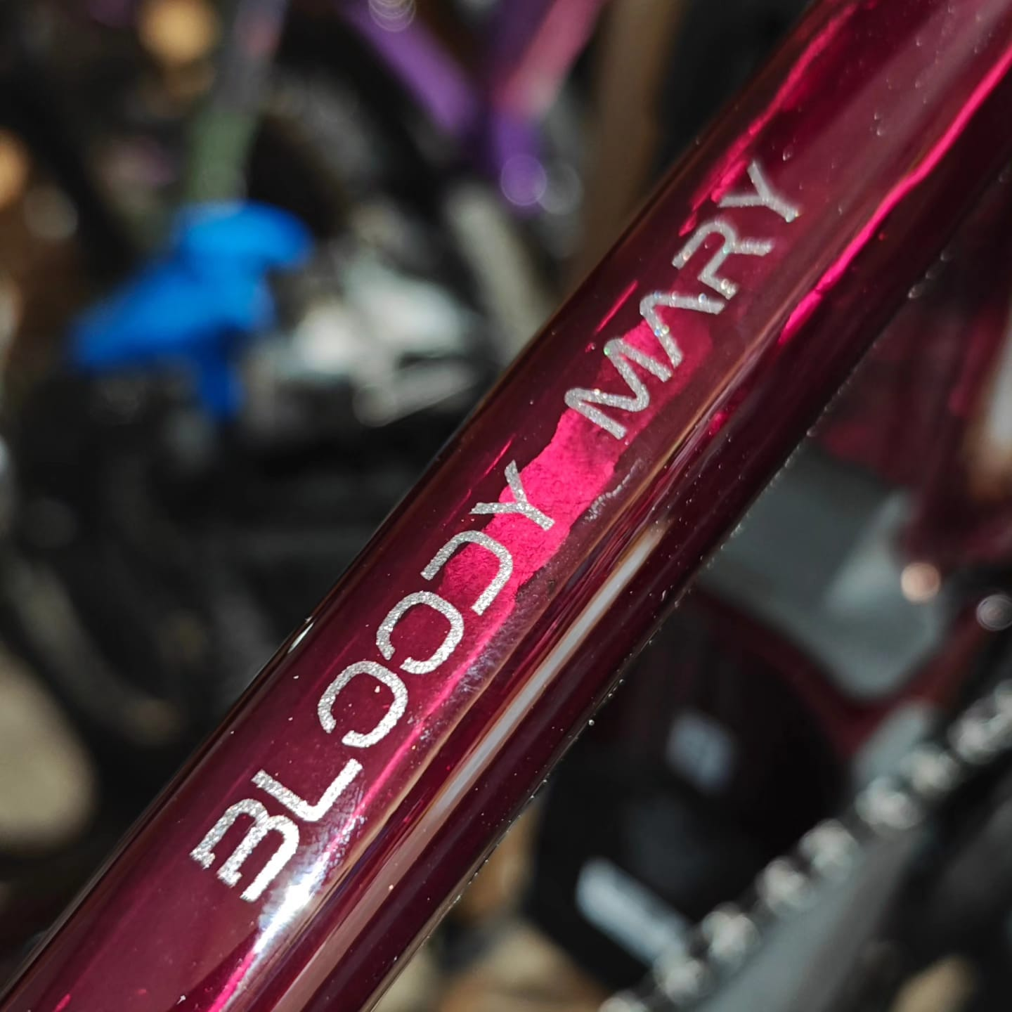

I had "The" Email from the bike Shop, Mary should be with them this week.
So then its Invisiframe fitment and I can collect!
Then get her home to put new wheels and brakes on and hopefully get back out riding!

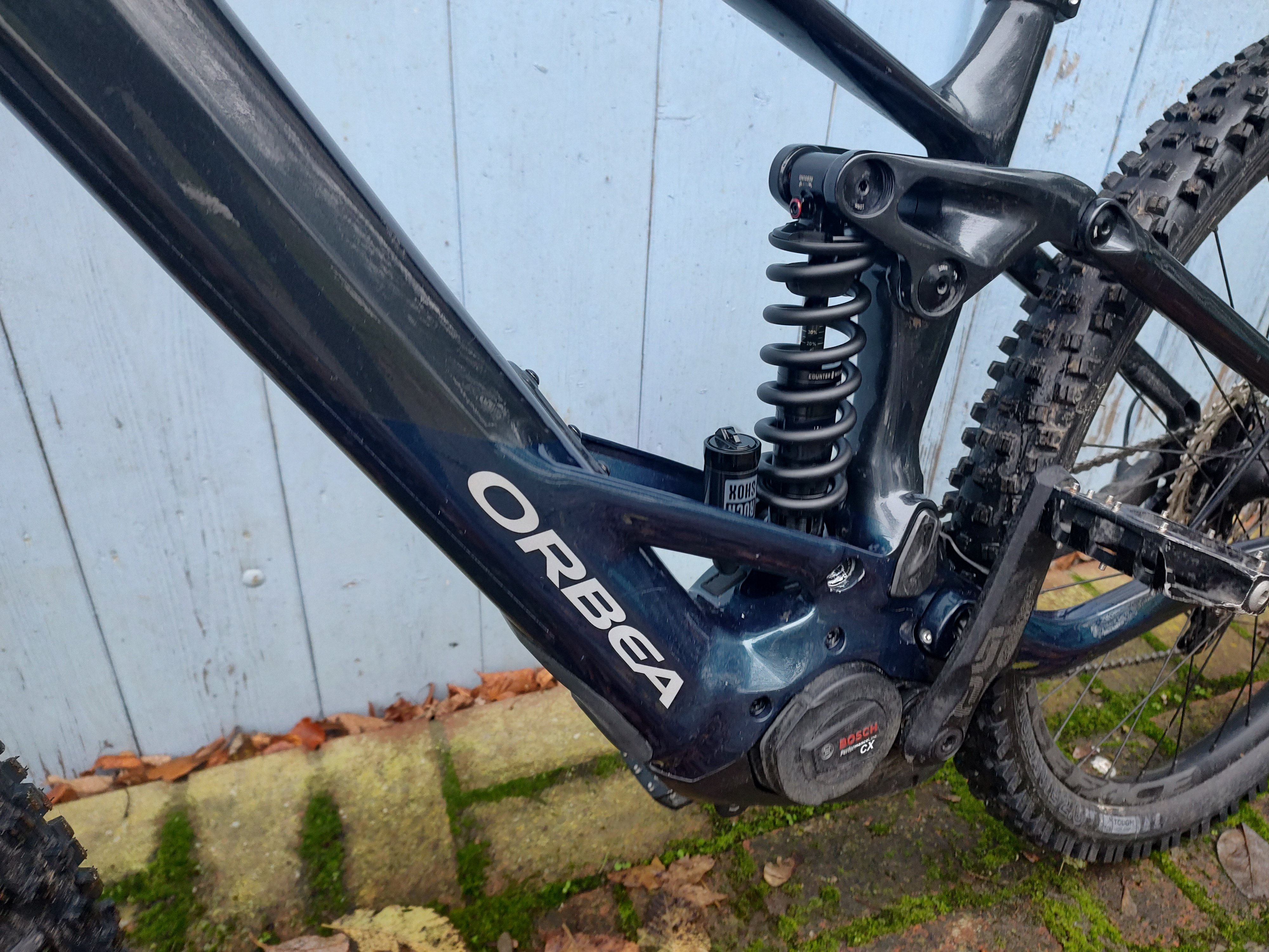

Well, turns out with a bit of tinkering you can fit a Rockshox deluxe coilto the wild. I got the shock for a great deal, but soon found out that it has bearings in the upper eye. So I took out the bearings and spacer, reamed the upper mount to 17mm H8 and pressed in a igus bushing (GSM-1517-15) shortened to 13,2mm. I then threw some black delrin in the lathe and made 2 spacers. Did my first ride with it today, and it's a tad harsh. Based on my halfassed calculations I put on a 450 pound spring. Guess I'll try the 400# that came with the shock next.
What hubs ship with the m20? I can clearly see the race face rims on the bike, but cannot find the hub spec anywhere.
Thanks,
View attachment 130493 View attachment 130494
That’s the ’22 shock, not the new model correct?
Probably. I haven't even checked. I got a smoking deal from RCZ bike shop and thought I'll try it. It's a tight fit, but it's not touching anywhere. Size M frame.

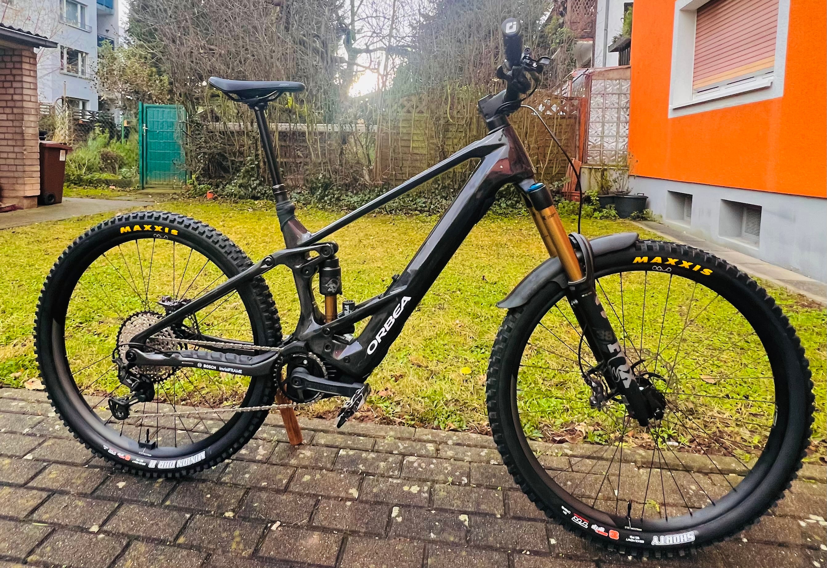

Finally after 3 months of waiting…
Apparently the delay was caused by Fox but the good news is that the fork and the shock are the 2024 models. Which is fantastic especially for the x2.
M10 myO in Raw Carbon with white decals. 170mm Fox38, x2, DH tires etc. 24,3kg (53,57lbs) in size L with the 750wh battery with heavy tires and a Tannus insert in the rear. Could be worse.
Had to do some upgrades like a XT chain, XT shifter for multirelease but the built is nearly perfect. Especially with the colour which ist awesome. Even if it’s hard to see on a picture.
