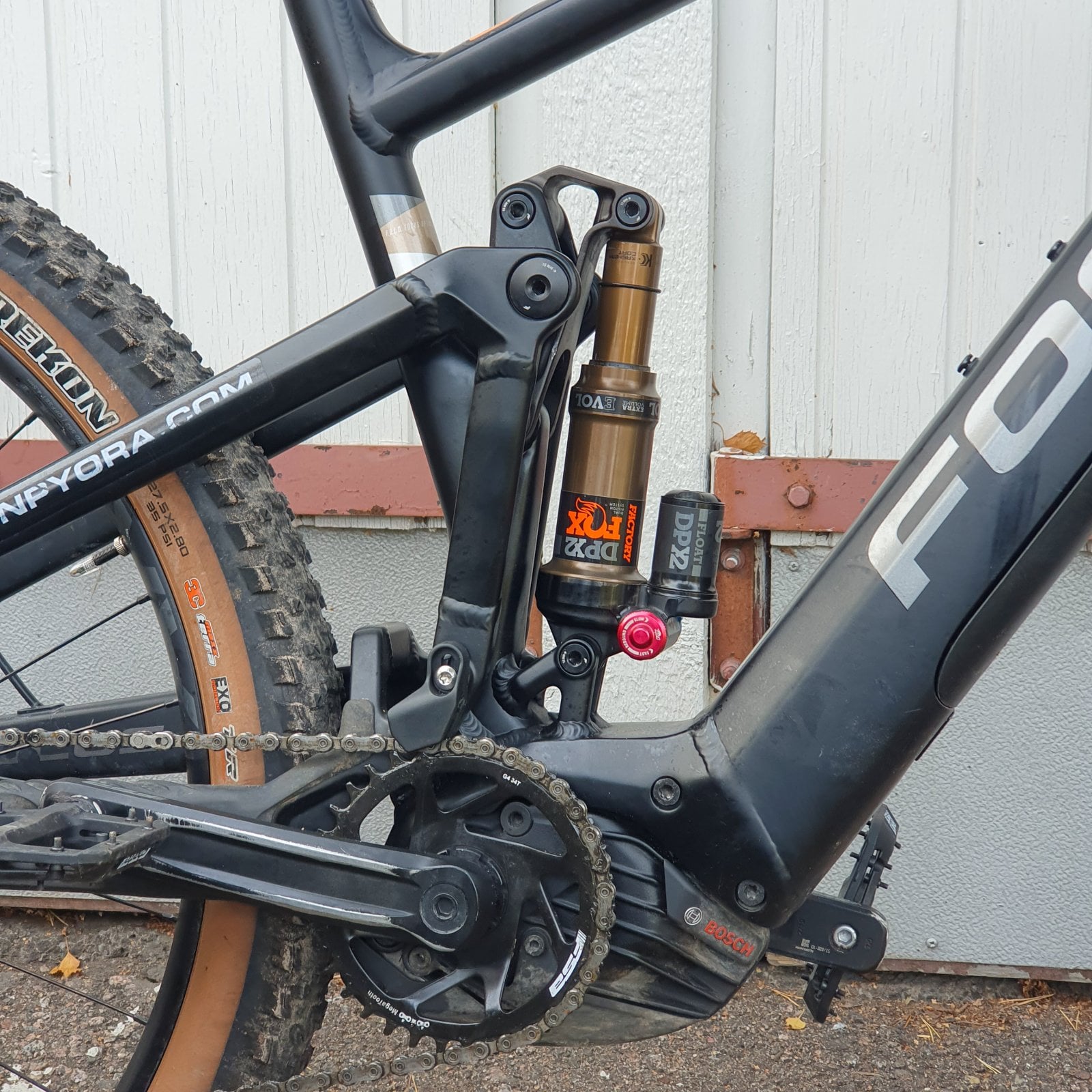

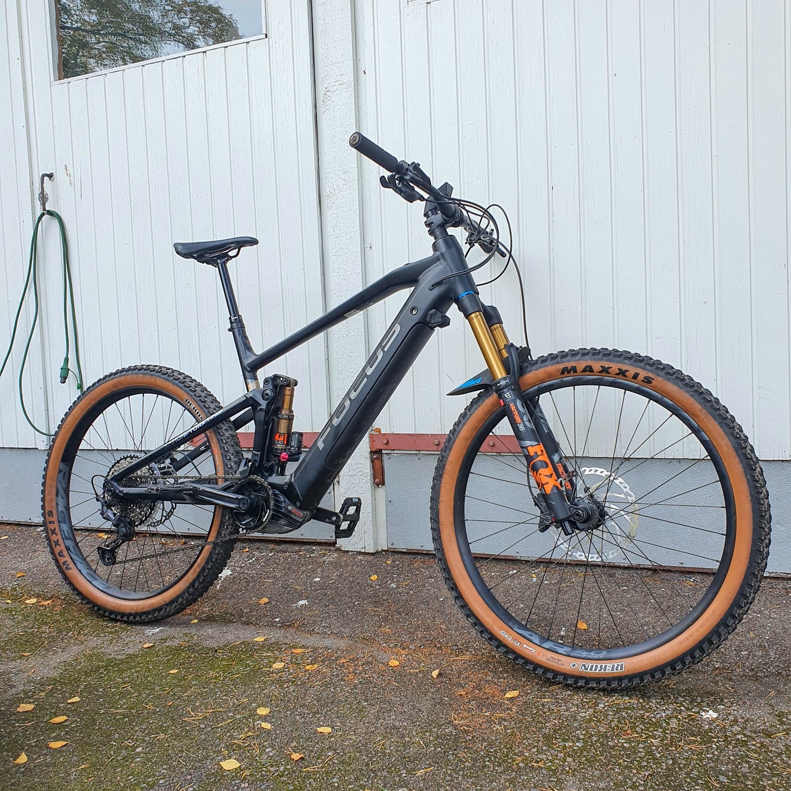

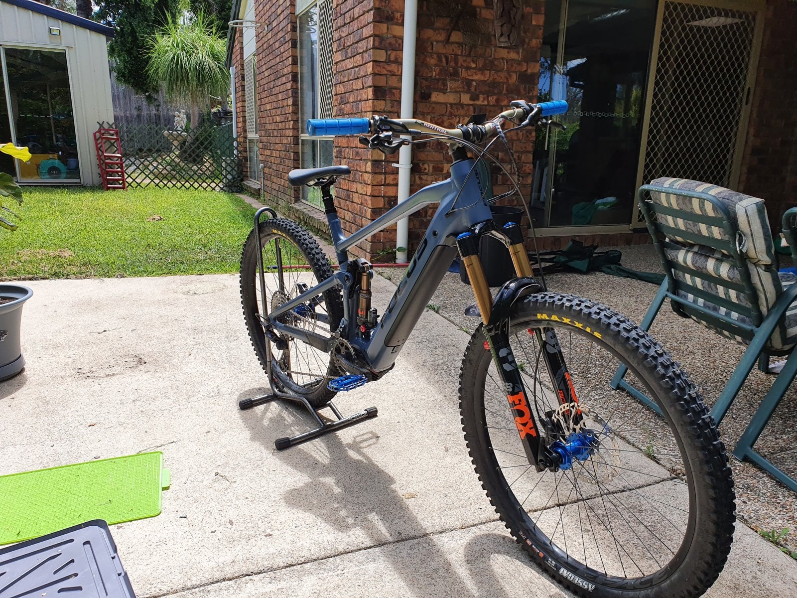

I answer to my self and all you how are wondering will fox dpx2 fit jam2.
Frame is XL

Amazing! I suppose you have released the air to check if piggyback hits the frame.
What about the performance compared to stock one? Mine is L size...
Thanks.
For XL frame dpx2 fits with out any problems.
I did change fork and shock before first ride.
But I think it do work well and better than my old Jam2
L size can be tricky

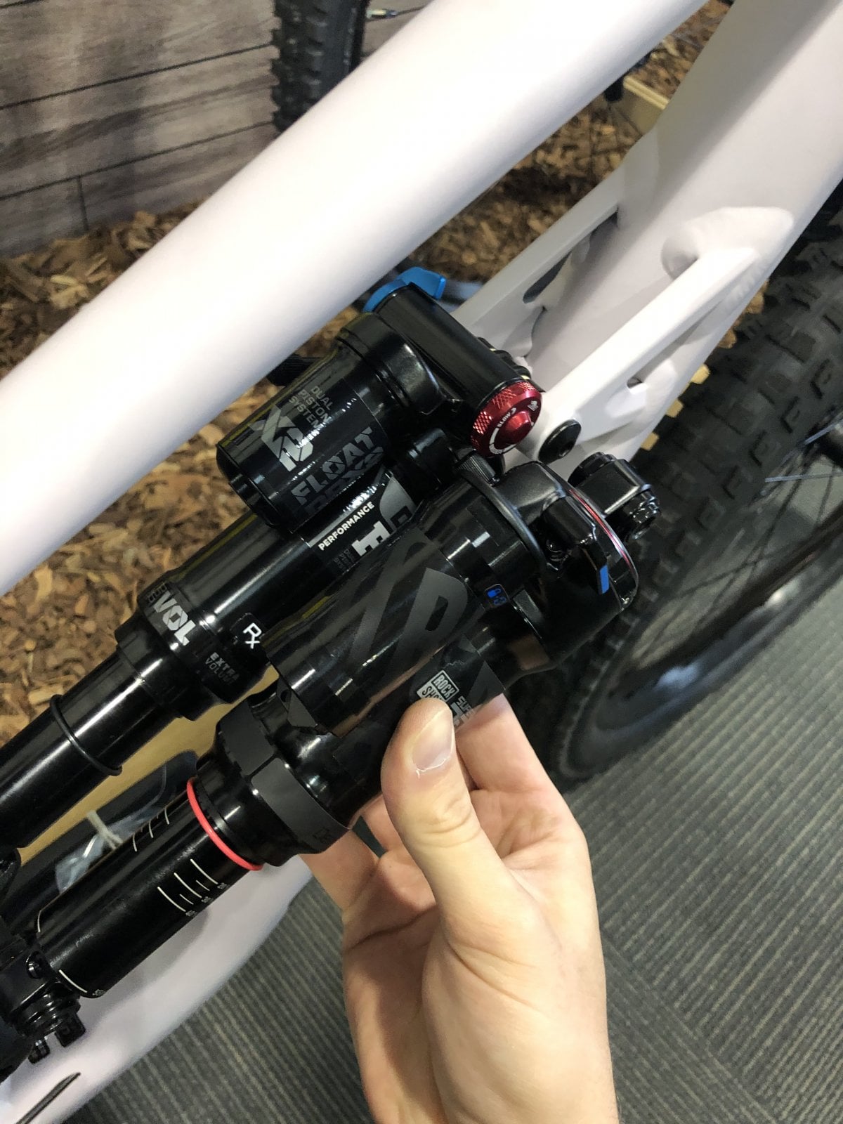

Hey all!

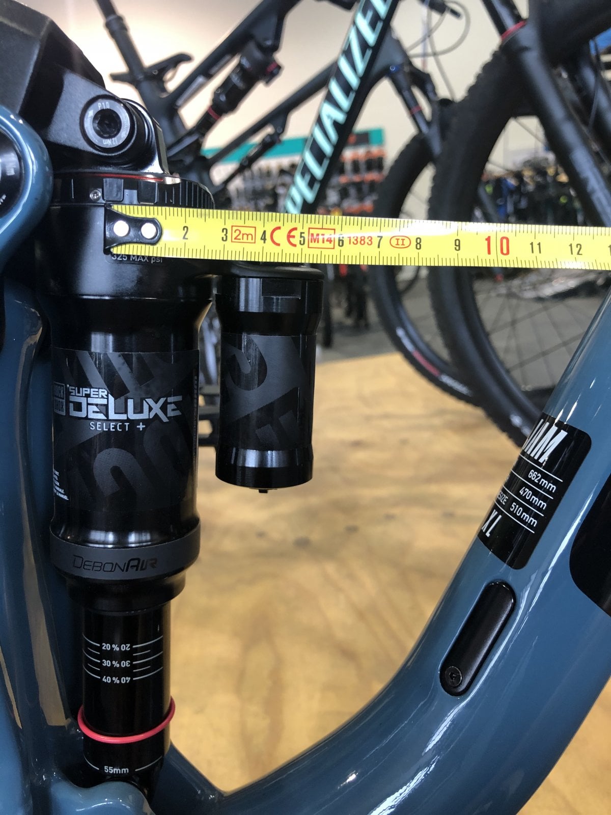

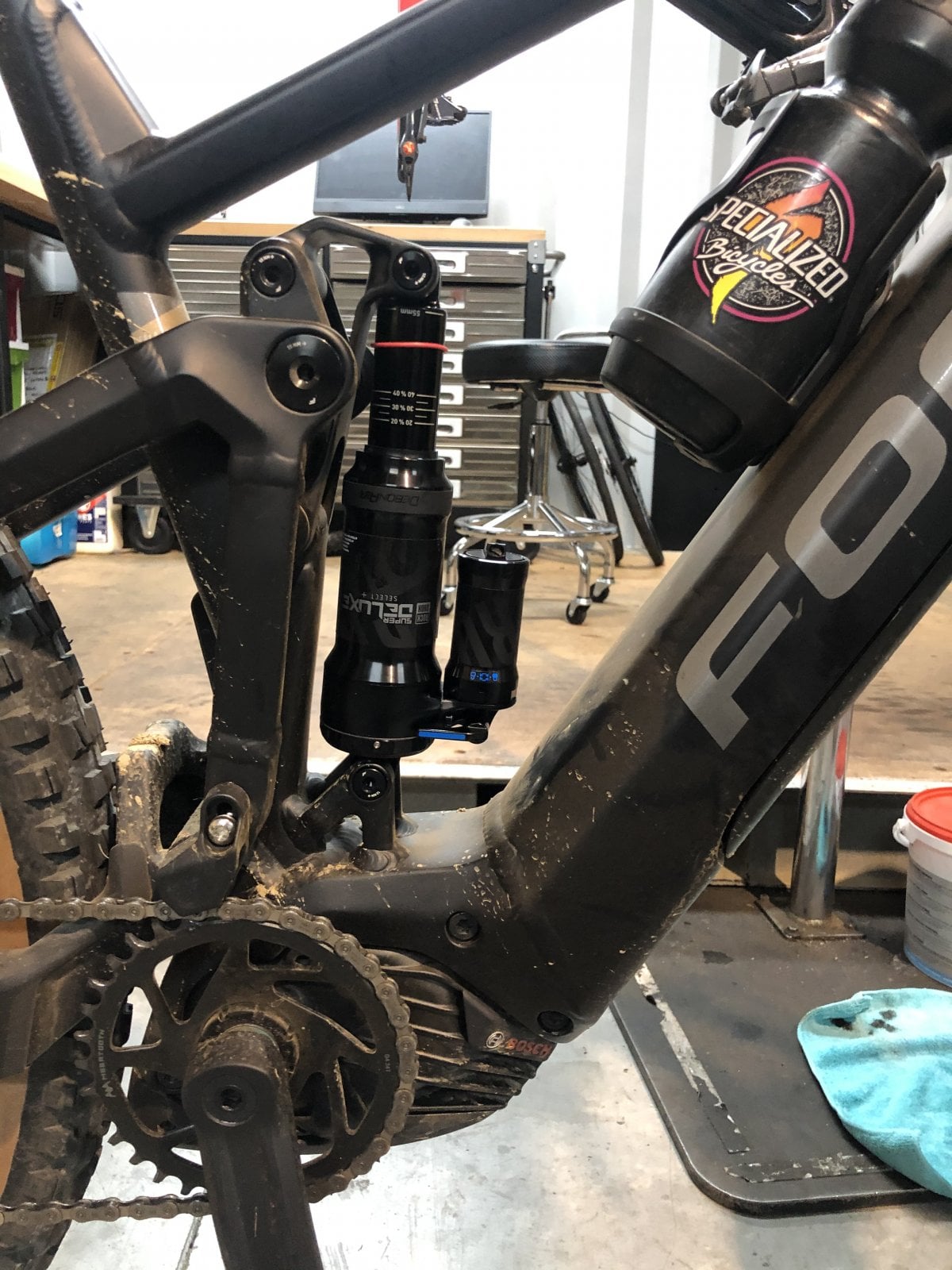

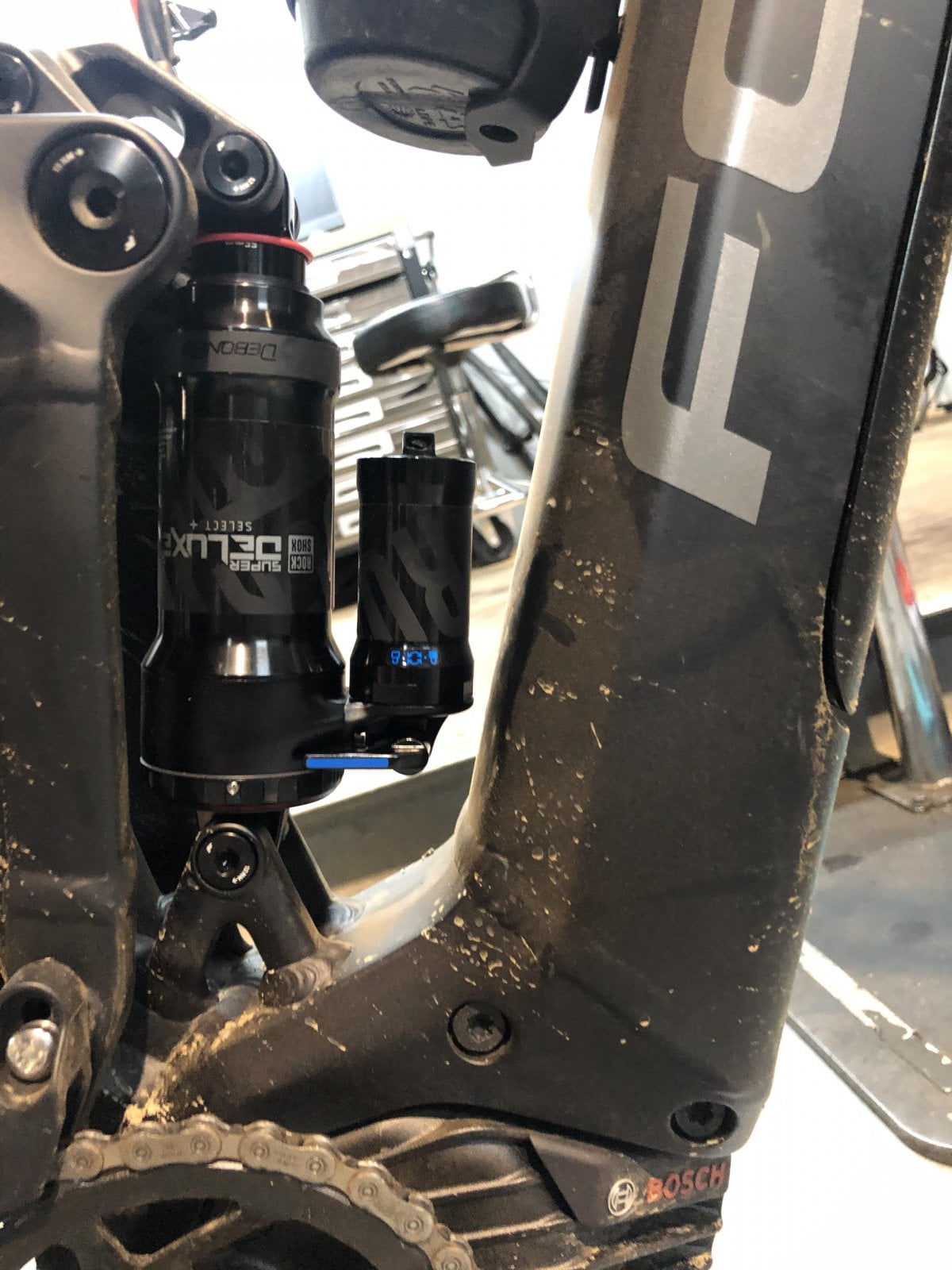

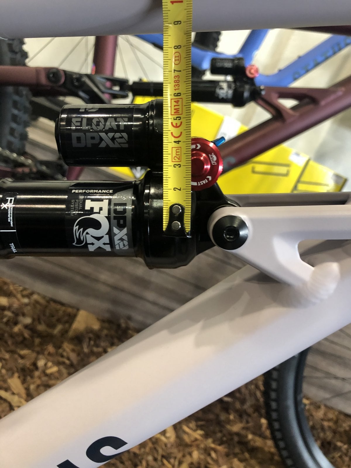

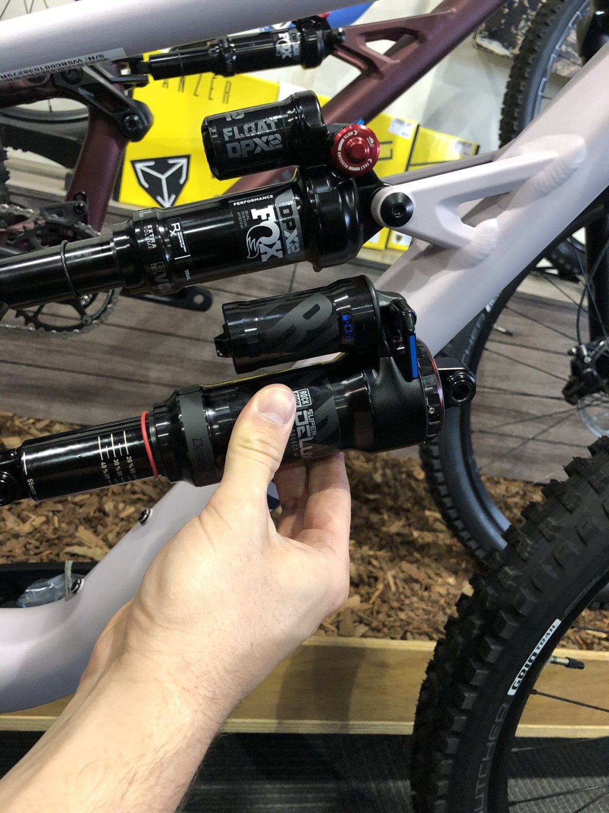

I work in a bike shop in Brisbane Australia and had the opportunity to steal a Rockshox Super Delux from a Jam 8.9 to see if it fits in my LARGE jam2 6.8. it fits with a few mm to spare. Got pics of it next to a DPX2 to show size difference as I know that is the one everyone is asking about. The DPX2 in the pic wont fit the jam as its the wront stroke and eye to eye but atleast you will get an idea of size. I think it will fit a Large fine.
D_Stan
Jan 21, 2020

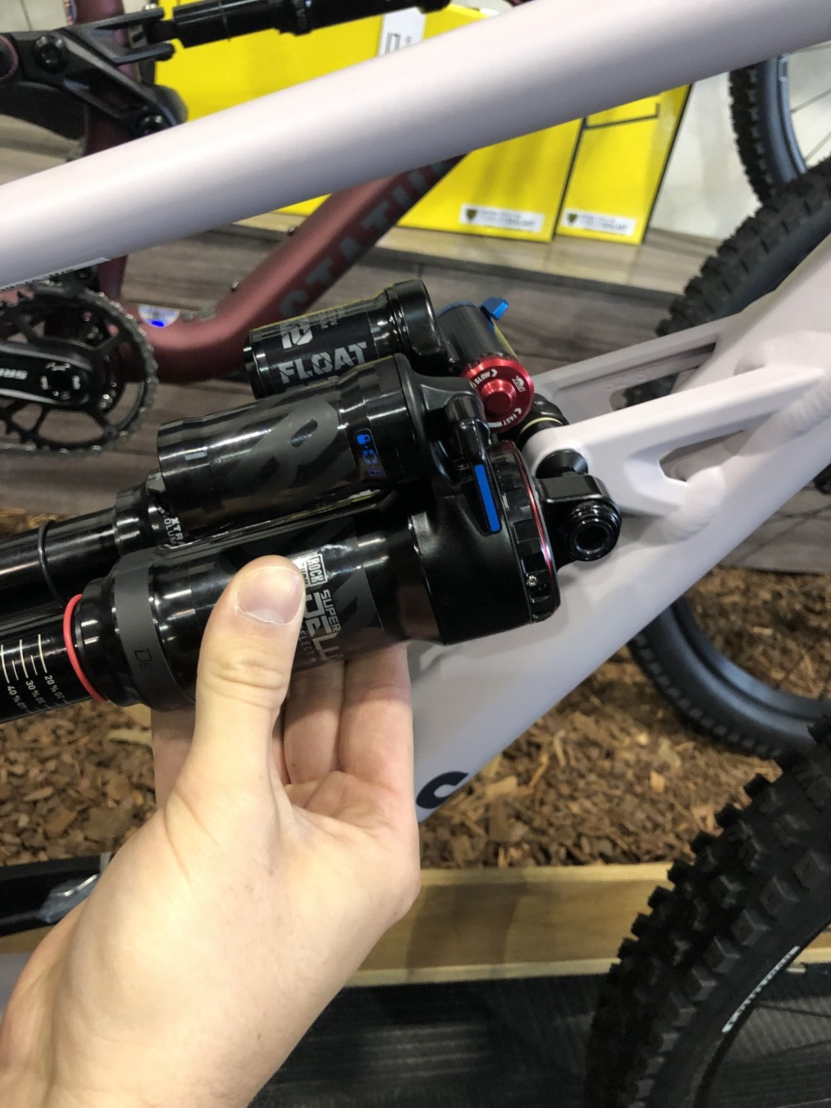

More pics, I did some measuring and the DPX2 is FRACTIONALY bigger. Both shocks were measured from the centre of the can to the edge of the piggy back. (roughly)
D_Stan
Jan 21, 2020
Looking at your photos, I think that the DPX2 might just and only just fit - looks too close for comfort. I'm trying to find out if an X2 fits
I think I would agree with that! Keen to see for sure, was just unfortunate that we didn't have an X2 to try ?

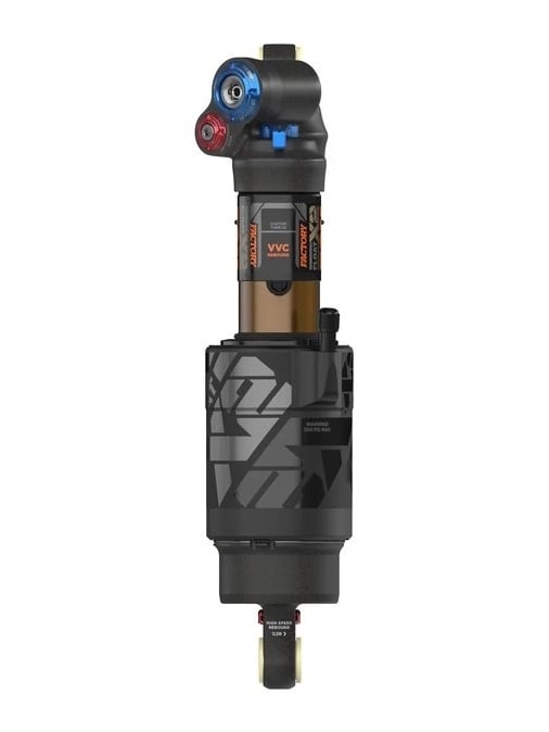

Just measured the standard shock and at the widest point it is 53mm, the X2 has a measurement of 57mm. Just need to see if there is enough room to fit it in. I think it will work

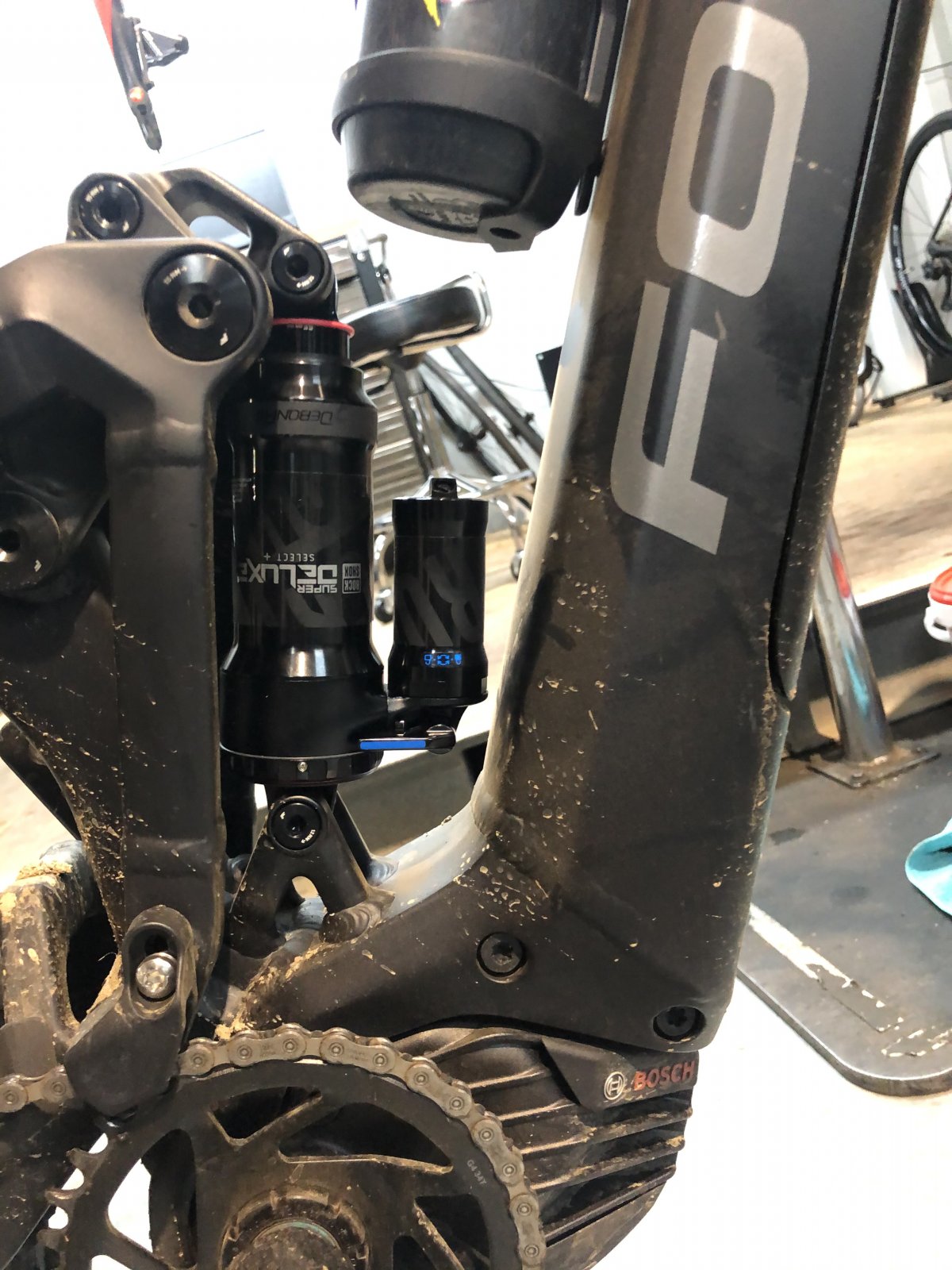

Fitments to 2020 Jam2 large.
Unfortunately the Fox X2 won't fit. DPX2 may fit. RockShox Super Deluxe Ultimate fits.
Now looking to see what coil shocks fit. Marzocchi Bomber CR perhaps?

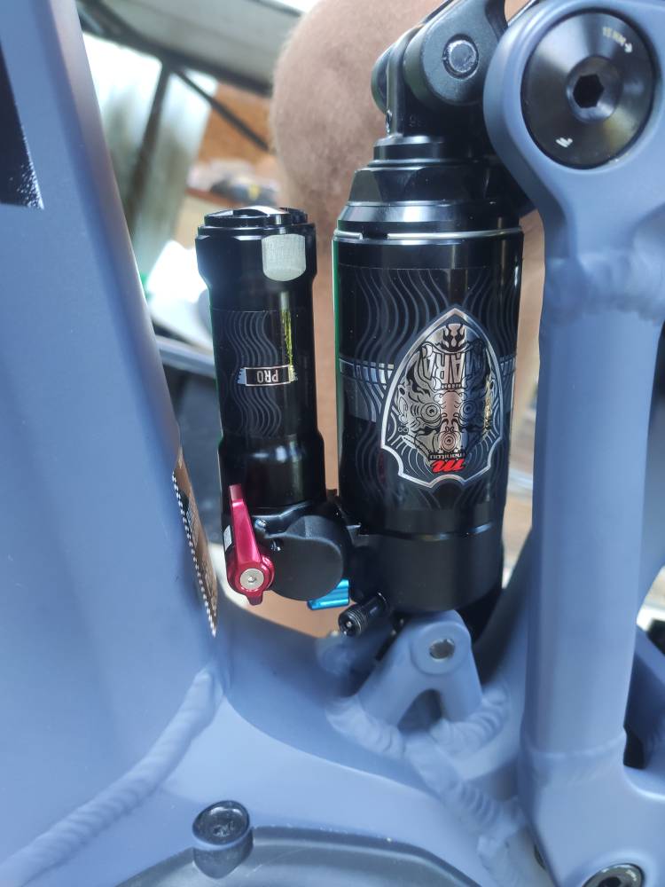

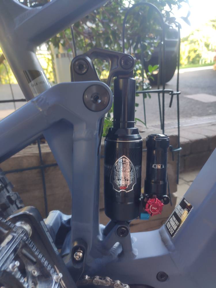

The manitou mara pro fits on my XL jam2.
I needed to rotate the work / party mode lever as it was going to foul in party mode. It was a 30 second job.
No biggie since I won't ever use the work mode anyway.

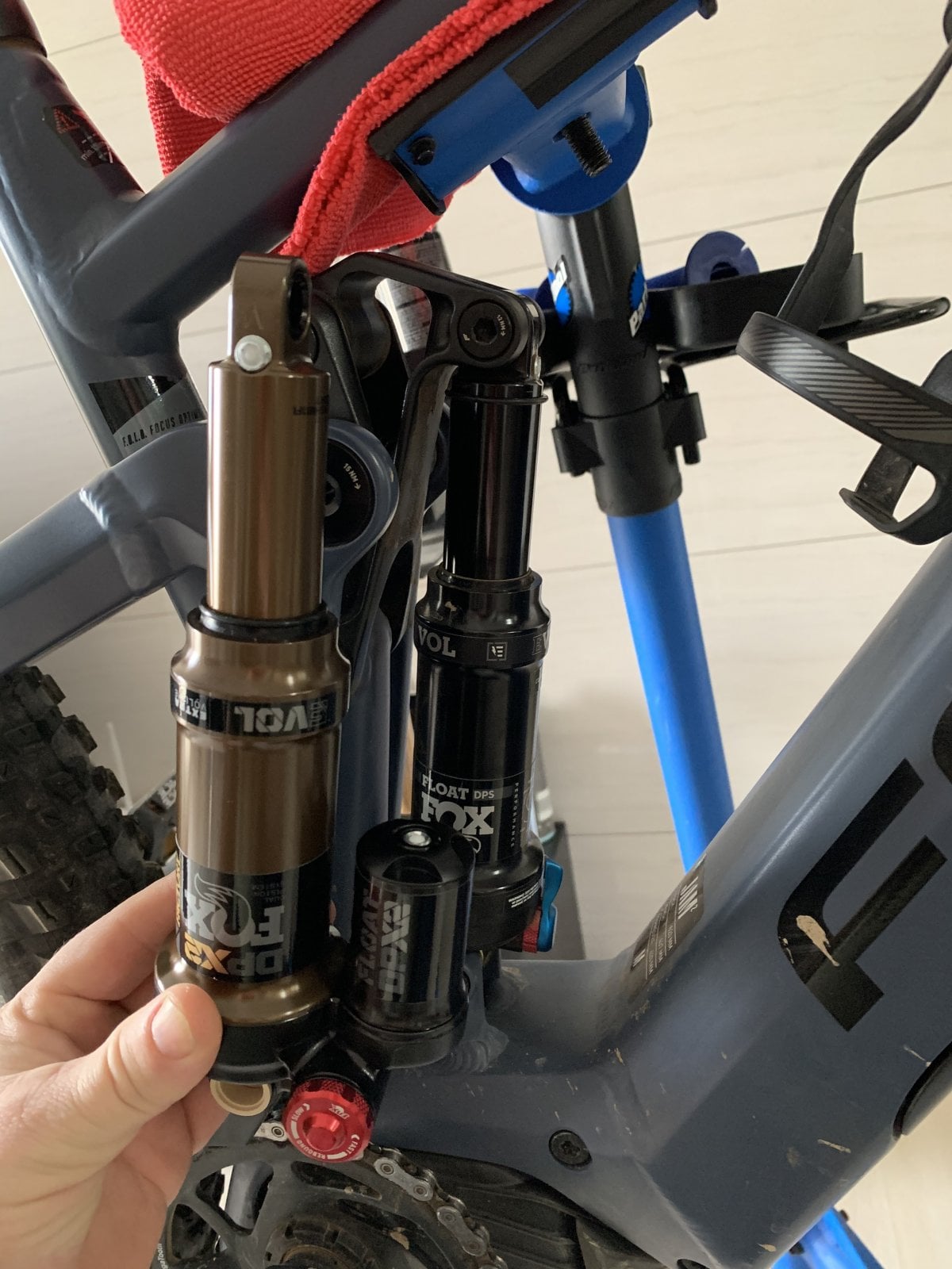

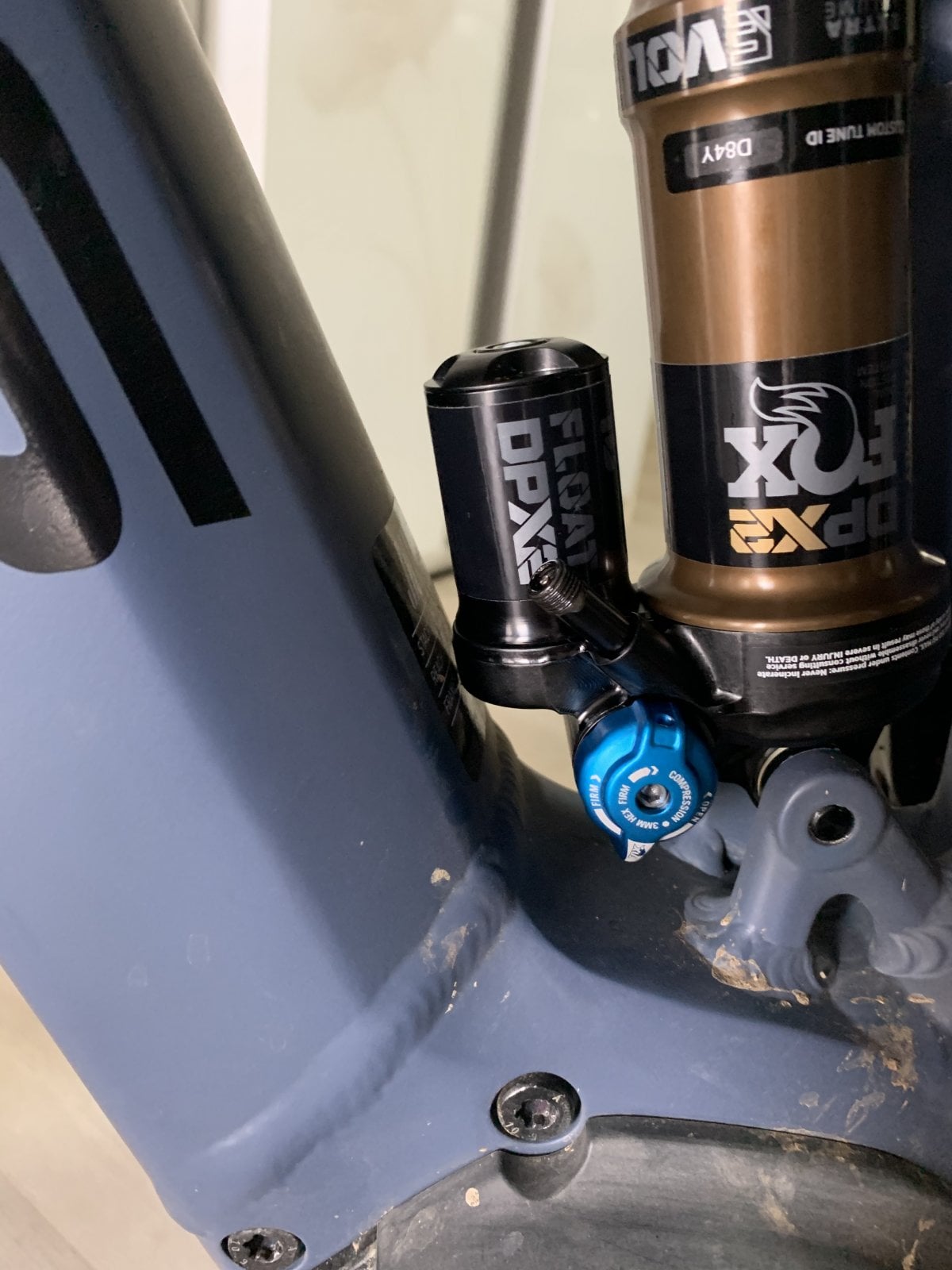

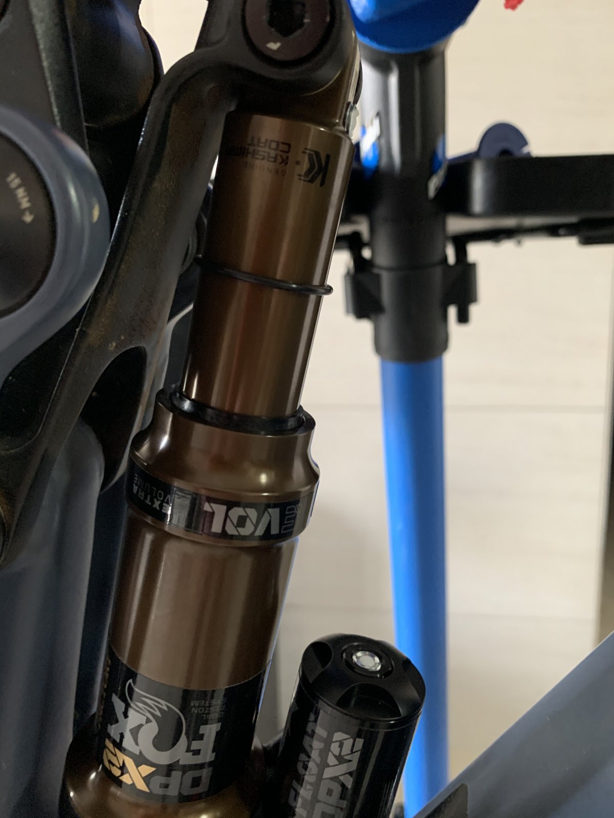

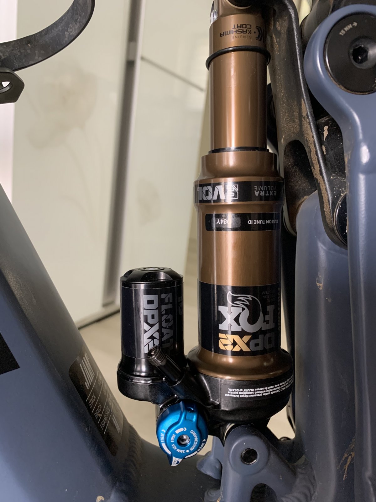

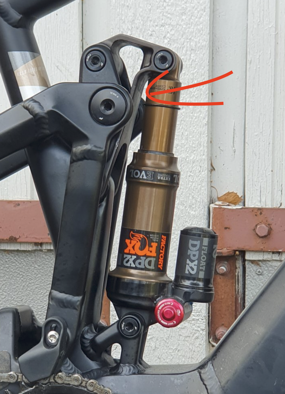

So I was following this thread to get an idea if the DPX2 would fit in my medium frame Jam². I went ahead and pulled the trigger and bought a new takeoff and as you can see it hits the frame pretty bad. it only gets through roughly 27mm of the 55mm of stroke before it contacts the frame. I was really hoping it would fit as I want to upgrade from the stock dps. But just to let you all know a dpx2 does not fit in a medium or smaller frame.
