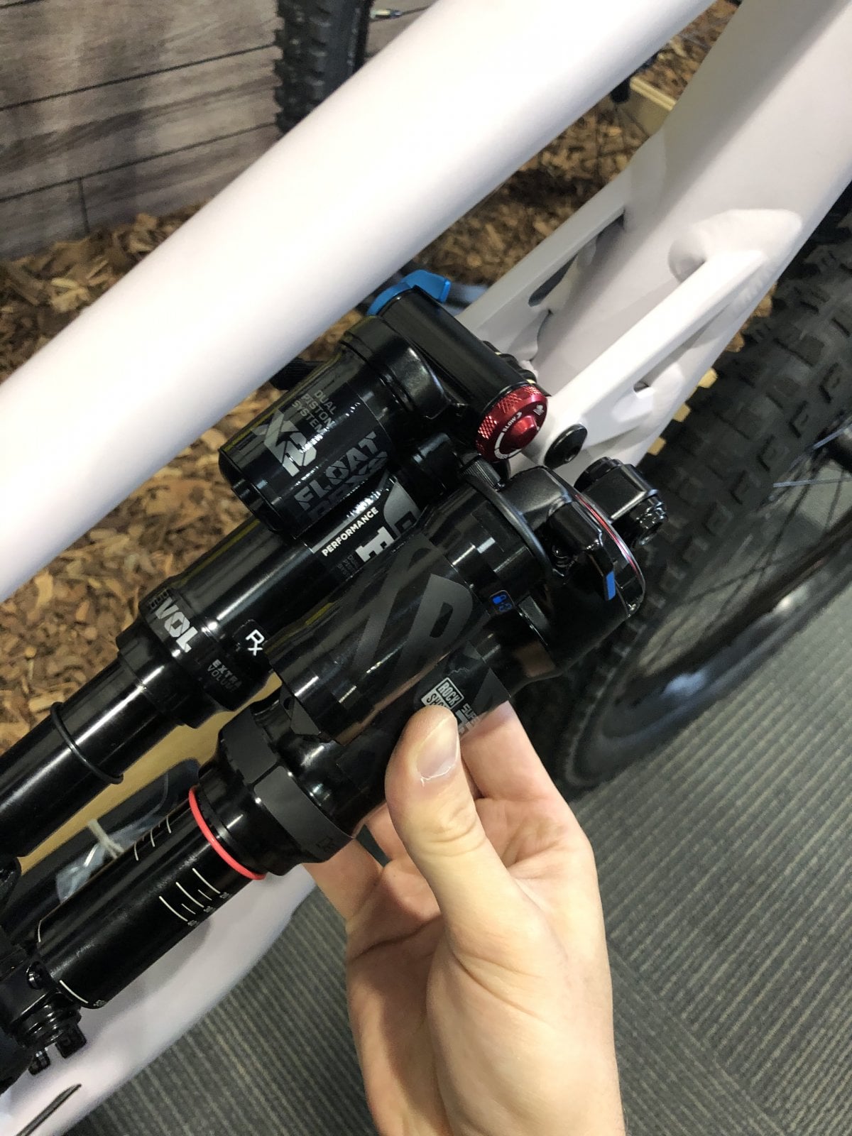

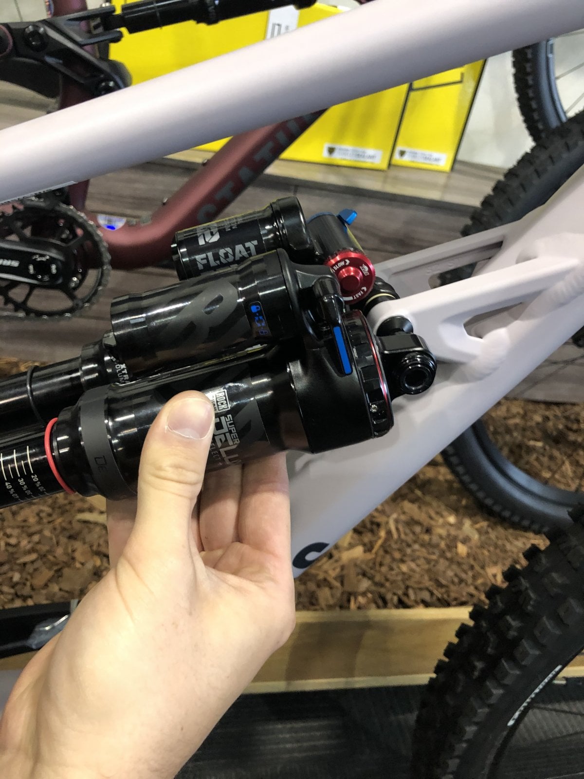

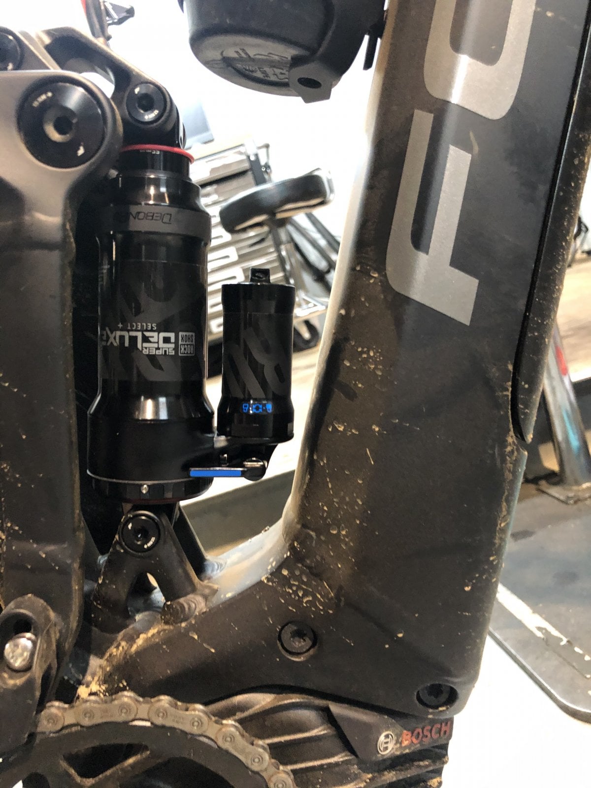

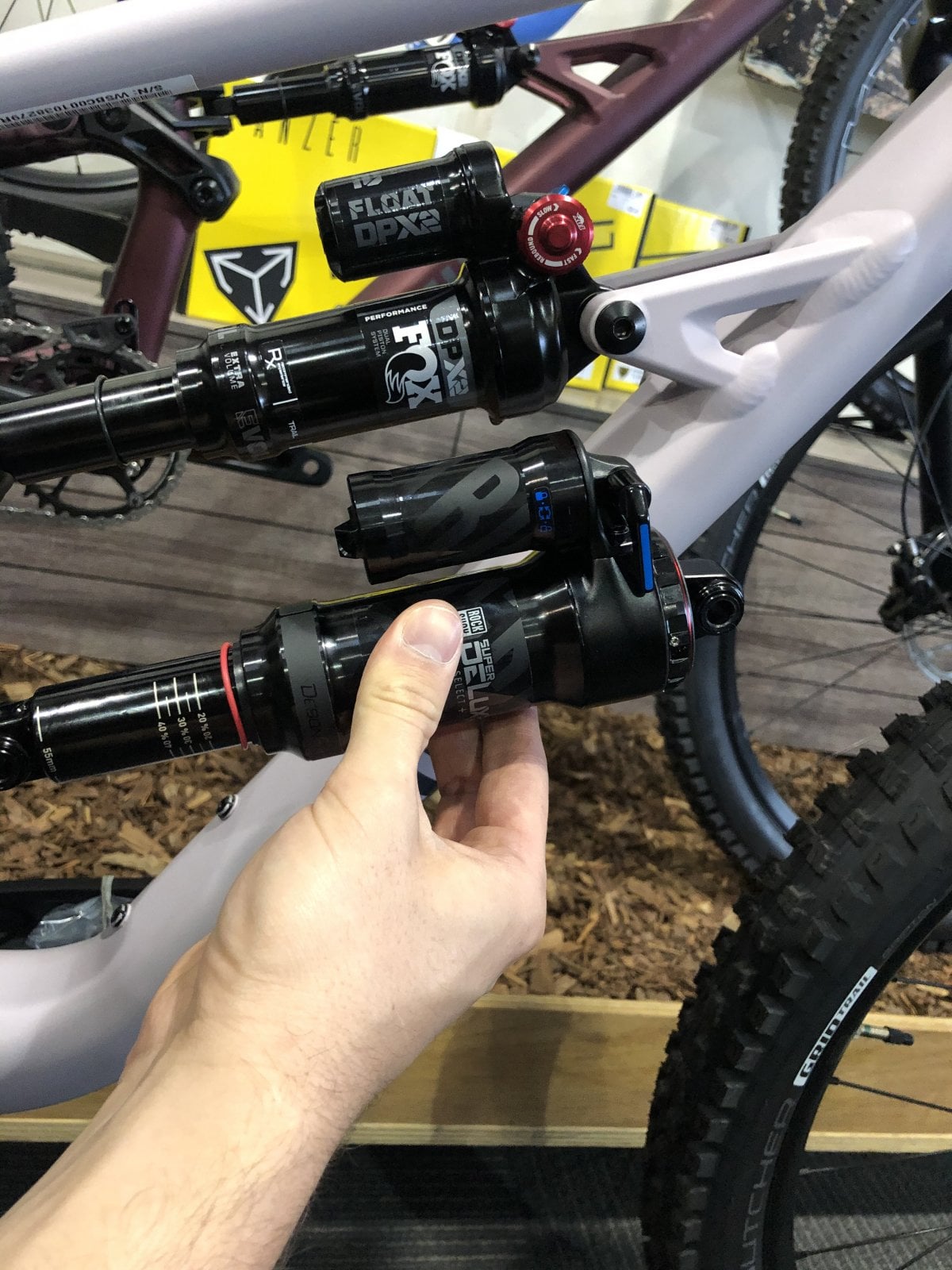

Hey all!
I work in a bike shop in Brisbane Australia and had the opportunity to steal a Rockshox Super Delux from a Jam 8.9 to see if it fits in my LARGE jam2 6.8. it fits with a few mm to spare. Got pics of it next to a DPX2 to show size difference as I know that is the one everyone is asking about. The DPX2 in the pic wont fit the jam as its the wront stroke and eye to eye but atleast you will get an idea of size. I think it will fit a Large fine.

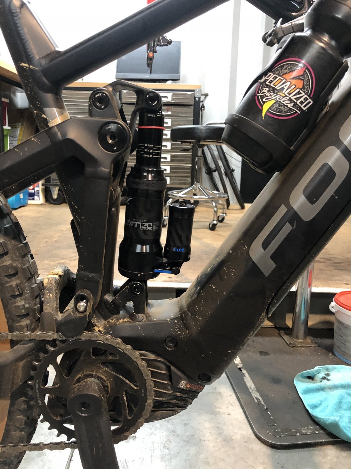

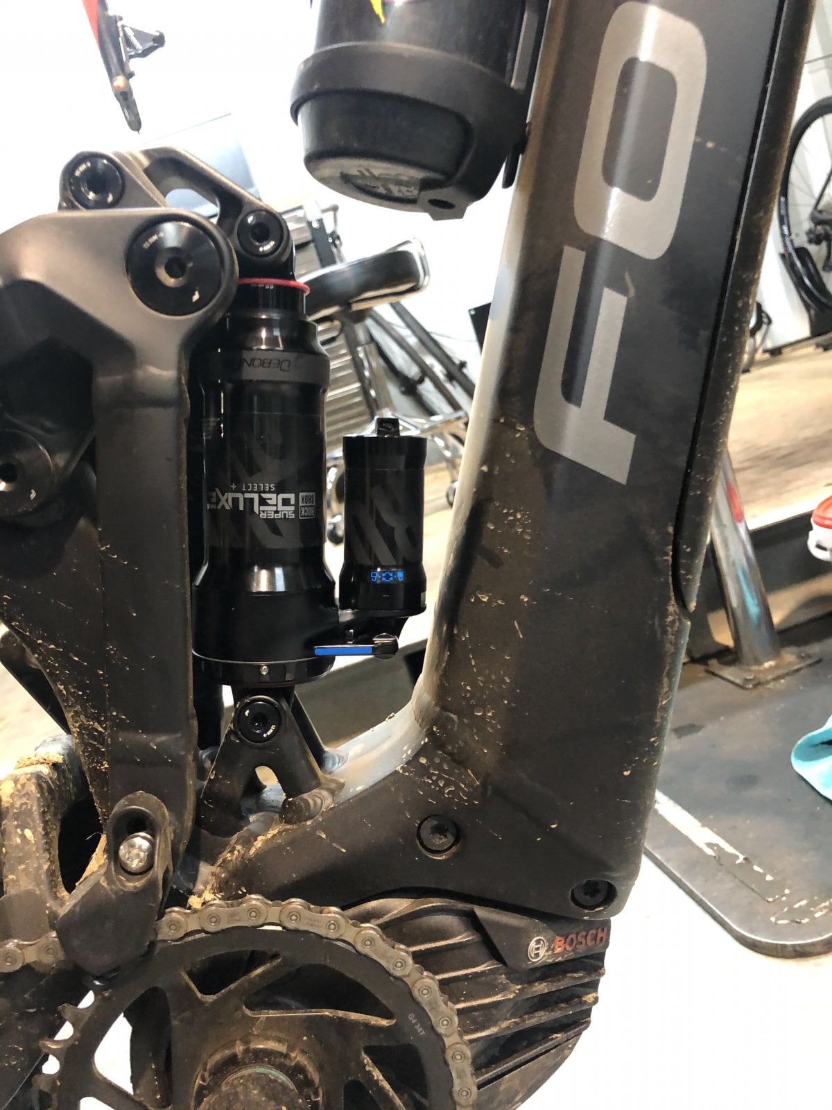

I can confirm that the Rockshox delux reservoir fouls the downtube on a size medium, unfortunately.

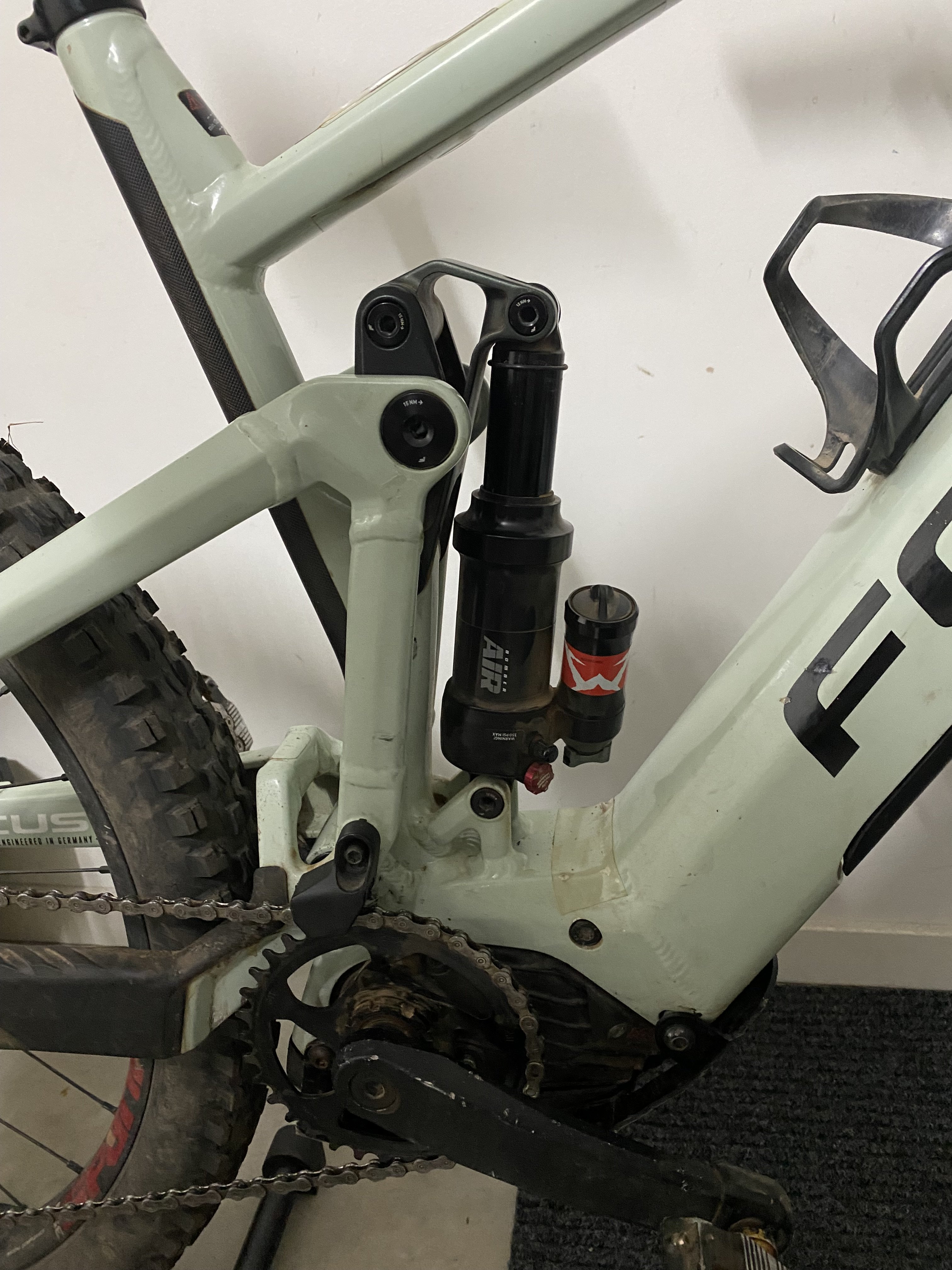

Focus Jam2 6.9 2021 Large size frame

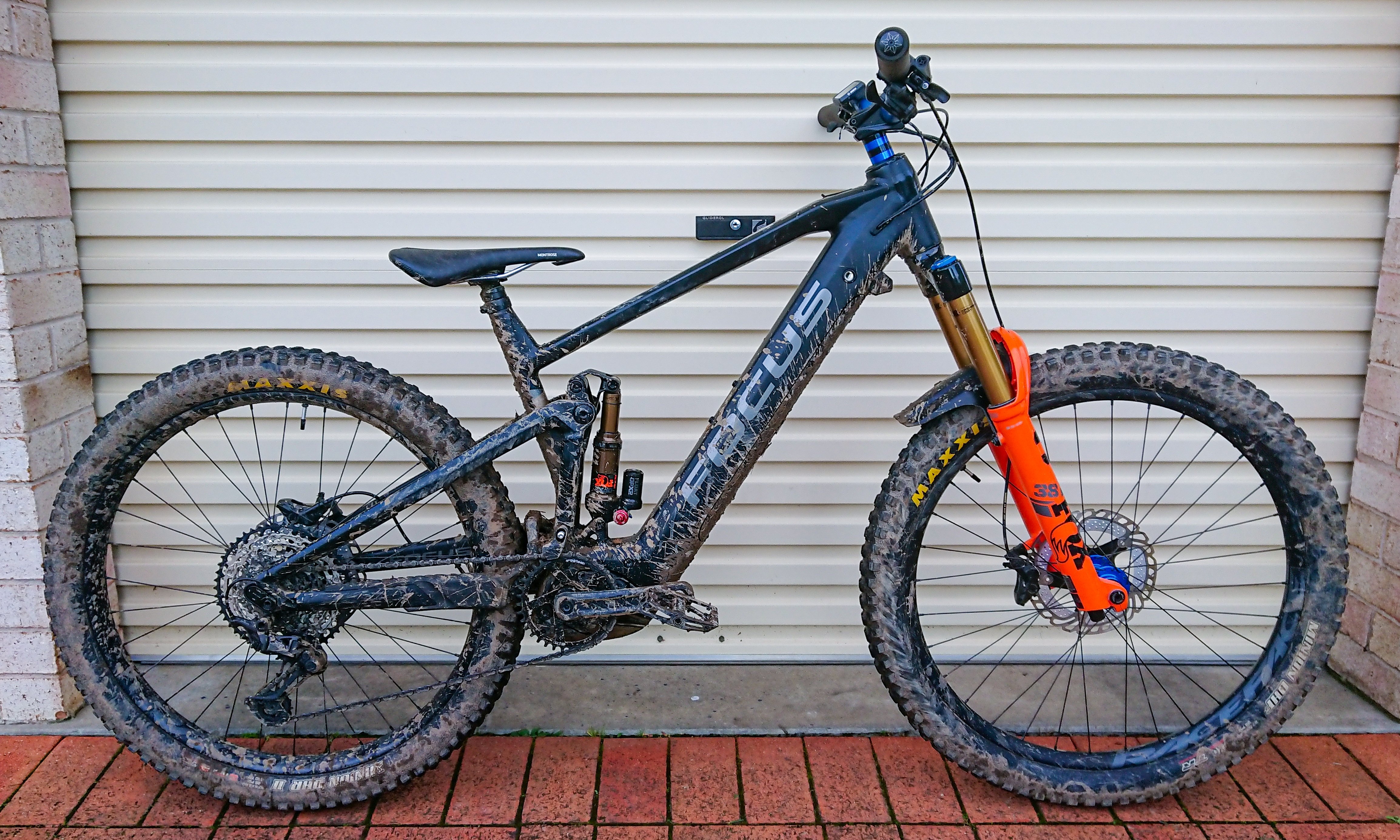

….If you can live without the 150mm rear travel down to approximately 136mm with a DPX2 try this.
Fox 5mm travel spacer
The shock will require full disassembly to fit the Fox part
The 2.5mm spacer I didn’t try. Wanted peace of mind for the mega bottom outs that the piggyback won’t touch the down tube.
Large Jam2 with 210 x 55 DPX2
This works
Back to 55mm stroke shock ⚡
Maybe also enough clearance for medium frames
