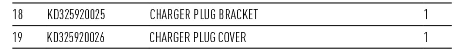

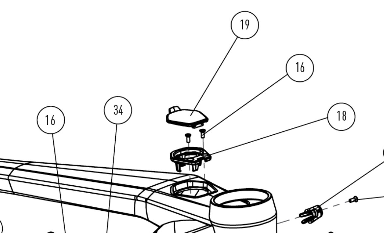

From the exploded diagram, one assumes you can walk into your Focus dealer and order part number KD325920026.

Many thanks for that Graham; I had another look at it this morning and saw that it was just a plastic surround and I figured it could easily break again if the charging plug was pulled out a slight angle; I mean it is just a piece of cheap plastic so I had a go at fixing it myself. Now, I’m no engineer, and my engineering skills aren’t brilliant.........I actually trimmed down the pull-off top from a tin of beans, bodged a couple of holes in the right place and screwed it down, I even painted it black.....job’s a good’n!

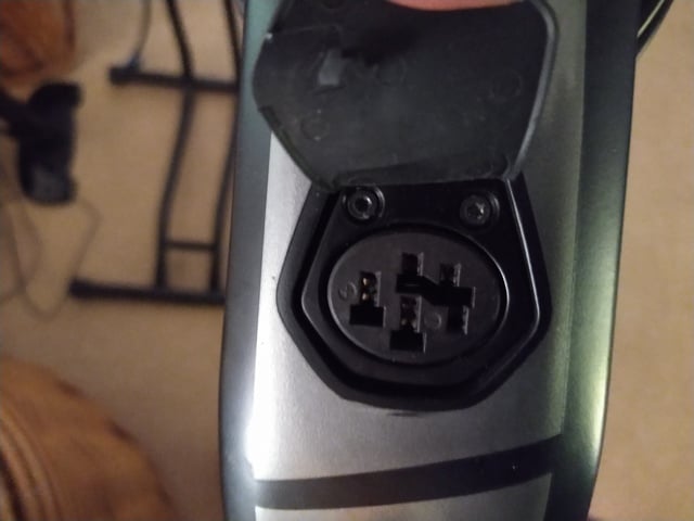

Hi, same happened to me.....bought the part and tried to install....went as far taking motor covers off...decided bugger that...got the Dremmel out with a thin blade and cut a 45 degree angle twisted this little plastic part a bit ....fed wires at the bottom of the plug through one by one...mixed some epoxy glue and glued the part together....worked just fine. Have a look at the pic...at 7 o clock you will see just a bit of raised glue...could have done a bit more sanding....but came up ok.
Cheers
Rob
