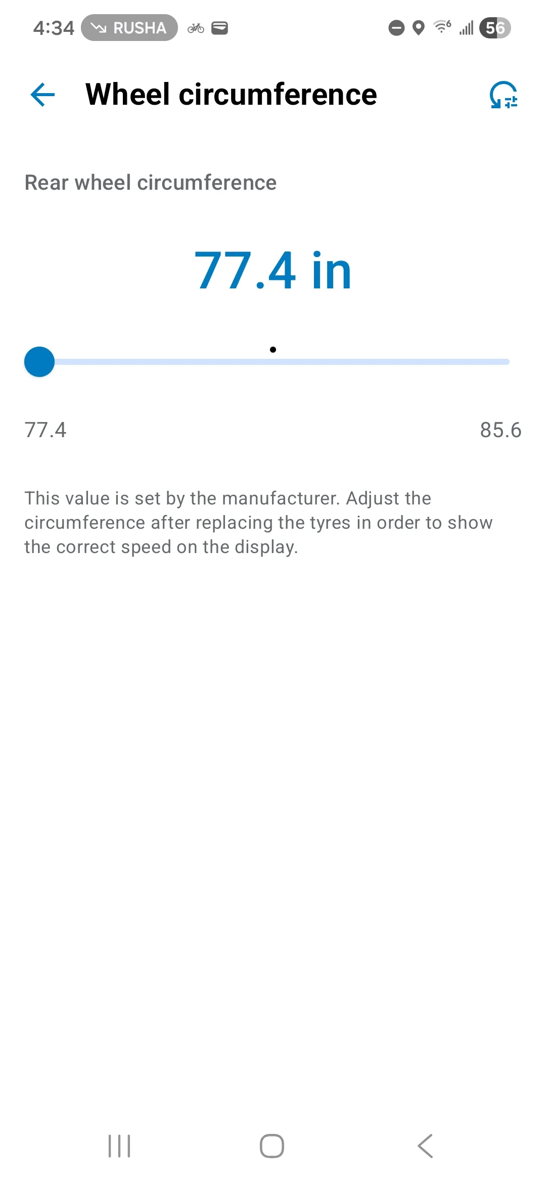

However when I was digging around in the Flow App I noticed that I could just change the wheel circumference.
Can the top speed be increased by a few mph/ kph utilizing this slider?

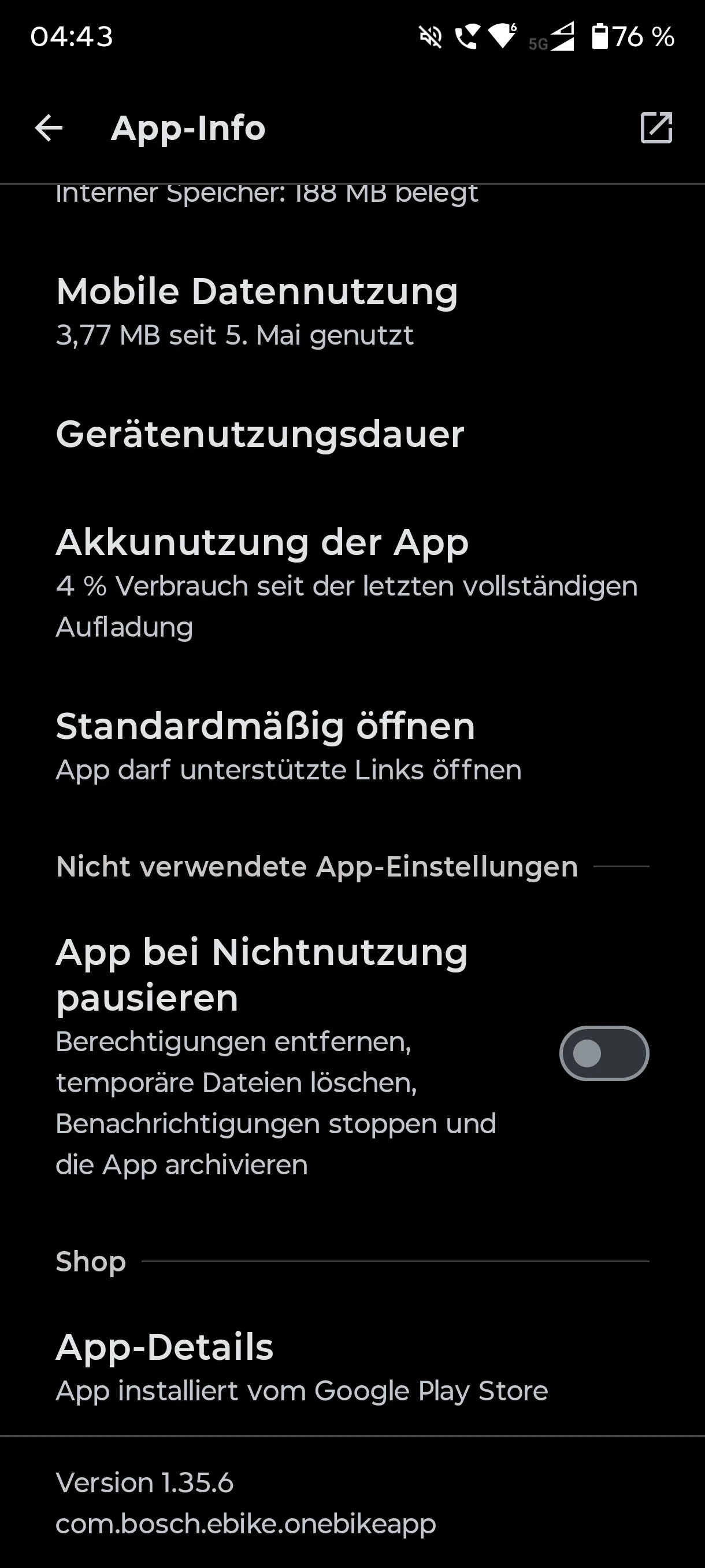

found 1.35.6 flow app on internet with apk, only 1.34 in google/android playstore

That’s about a 10% delta in speed from min to max on scale… but it’ll only “help” if you set the circumference smaller than reality.

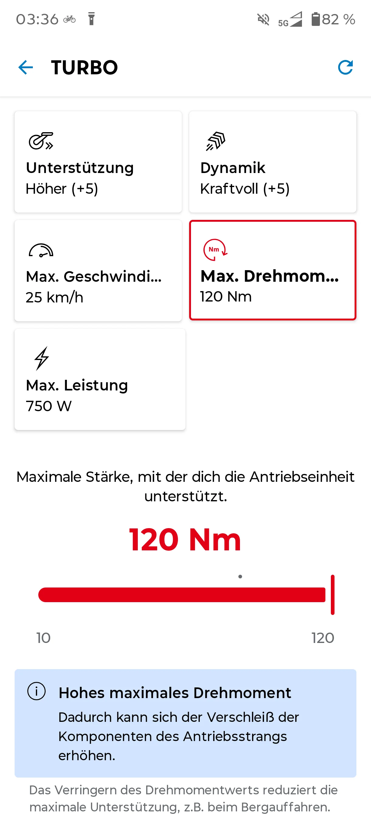

Finally! You get 120 nm

Seems to me that since max speed isn't determined by GPS, then it can only be by rear wheel roll out (circumference) multiplied by RPM as recorded by the rim magnets sensor. So with this 10% circumference setting range there should be about 10% range in speed, with 20mph being the targeted cut off, which could be from 18-20, through 20-22?:unsure:
It would be just like changing the tires on your car or truck to a smaller or larger diameter/circumference, and causing inaccurate speedometer readings.

Unfortunately changing this setting in the Flow app does not make any change to the actual speed of the bike, this only changes the reading on the speedometer. There is/was discussion about this in the derestricting section before.
There are two records for the wheel size. One is configurable in the app and only ensures the speedo is accurate if for example you did change wheel size.
The other is only configurable in the Bosch Diagnostic tool, this one changes the speed the bike thinks it is going and reducing the wheel size here does impact the real speed limit of the bike. Smaller circum setting here makes the bike think it is going slower than it actually is, and therefore allows for assistance at higher speed as bike still thinks it's within set speed.
I found this confusing when reading about it before, until someone posted a screenshot showing the two values in the diag software.

That is incorrect! The circumference setting in the Flow app. is merely to allow the display speed to be accurately set. The real circumference setting is fixed in the firmware so if the tires are replaced with different sized ones which will change the speed slightly it is still possible to correct the speed shown in the display.

For those who are still waiting for the 120 Nm to appear in the Flow app
A number of experiments showed that it is sufficient to delete the bike from the Flow app after the initial upgrade of Flow and update of the bike firmware.
After deleting the bike and then adding it back into the Flow app a second Performance 2.0 update will show. This takes only 15 seconds to install and, surprise the 120 Nm show up in all riding modes.
