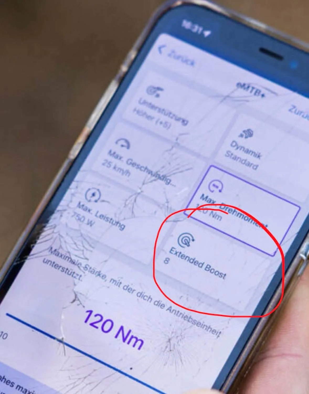

I thought I saw it mentioned somewhere that there would be an option to enable 80% charge limits on the battery but I can’t find it anywhere. Anyone have that?
Future... like fast charger, extended boost setting, tensioner, blah, blah. All you get, maybe 😂 ... torque, assist, trick counter, TC in turbo (-2 setting) and in eMTB in 0 and -2.

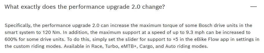

Velomotion article on Performance 2.0 update describes it as:
"In Turbo mode, the setting "+0" corresponds to approximately 340 percent. At "+2," we hit the 400 percent mark exactly. Pushing the dial to "+5" brings us very close to the promised 600 percent on our test bench"
Also Bosch's Performance 2.0 site:

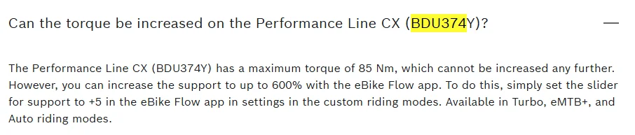

update succesful - No torque upgrade.
Before -
Drive unit software : 19.24.0
powetube software :19.16.0
After -
Drive unit software: 19.54.0
powertube software : 19.17.1
I'm still on 85nm torque.
My bike is 2 months old - I contacted cube and bosch a few weeks ago and they both confirmed my bike could do the 100nm update. They said to go to a dealer to do it. I heard of the rumours of the new 120 update, so decided to wait.
I waited. The update was succesful (according to the app) yet I'm still on 85nm.
The bike is a cube reaction hybrid - ive checked the cube site and they're saying it IS 120nm compatible.
So - why no update?
I read 600% up to 20mph but then 9.3mph, the app in the US says 20mph but the videos and other sources say 15kph.
Can anyone confirm
Can anyone confirm
Bosch's site has both 9.3 and 20 mph listed on two different Performance 2.0 articles. Reality, it is what it is... update bike, set support to +5 in any Auto, EMTB+, Turbo, Race or Cargo modes and it should be very apparent if the assistance drops at 10 MPH.
