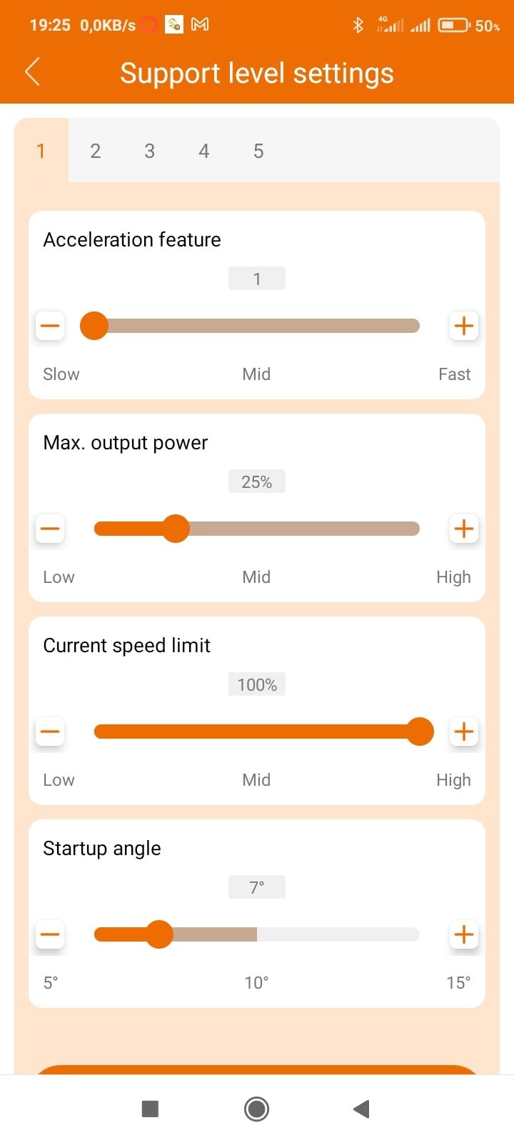

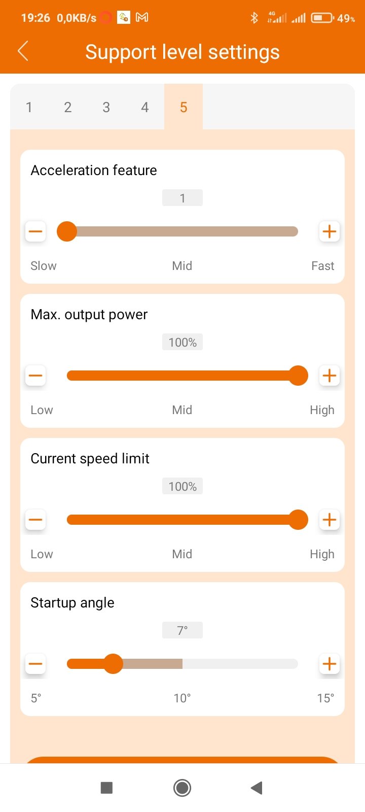

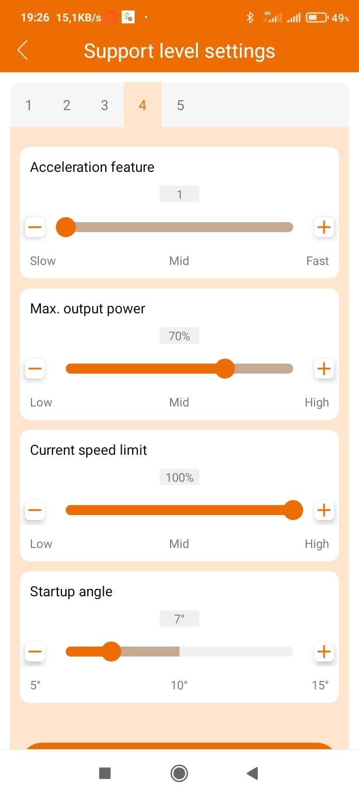

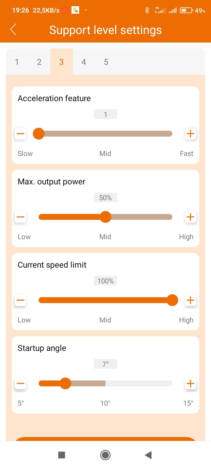

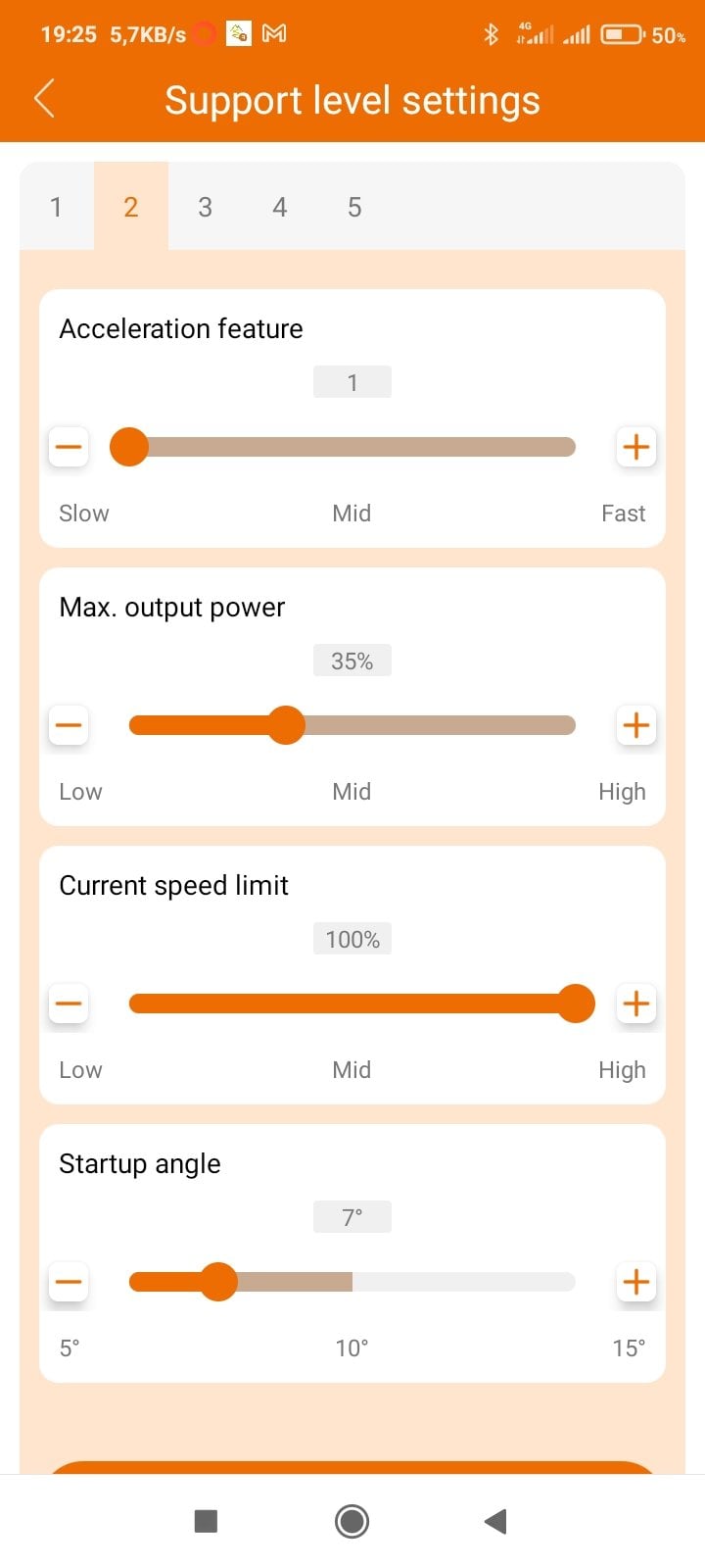

Hello
I have connected the Bafang GO+
application to my bike and I get what is seen in the following photos in the configuration of the different levels.
As you can see how it is configured (I haven't set it that way, it's how it appears when you connect it). Would you change something?
Screenshot_2024-08-21-19-25-48-240_com.bafangen.ride.jpg Screenshot_2024-08-21-19-25-58-532_com.bafangen.ride.jpg Screenshot_2024-08-21-19-26-04-446_com.bafangen.ride.jpg Screenshot_2024-08-21-19-26-09-529_com.bafangen.ride.jpg Screenshot_2024-08-21-19-26-19-500_com.bafangen.ride.jpg

Thanks! Can I assume that lower settings will save the battery? and higher will have higher consumption?
Acceleration will have a small effect on battery consumption where max power has a much bigger effect. Once the motor is ramped up it will consume the same amount of power regardless of the acceleration setting.
I run my acceleration at the maximum setting. If at the maximum setting you feel like the motor kicks in too harshly (surges) you can adjust the setting down to your liking. Surging is not a problem I have with the m820, perhaps because my other emtb has 3 times the power and I'm used to it.
Having said all of that I haven't done exhaustive testing on this. I am basing this on my understanding of how the settings affect the power during a ride. Perhaps others will weigh in.

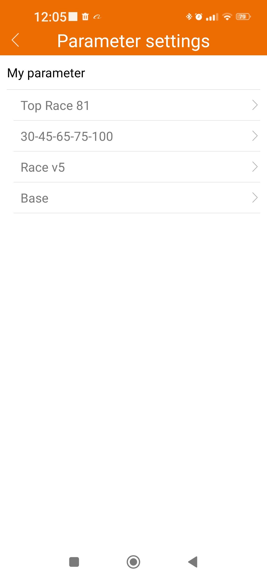

The new app can read data from v 2.0. But it can't edit the assistant levels it's says success when I try to write but it is not getting saved.
delete apps you have. Download v 2.2.0 install pair with bike and you will get the changes you want
