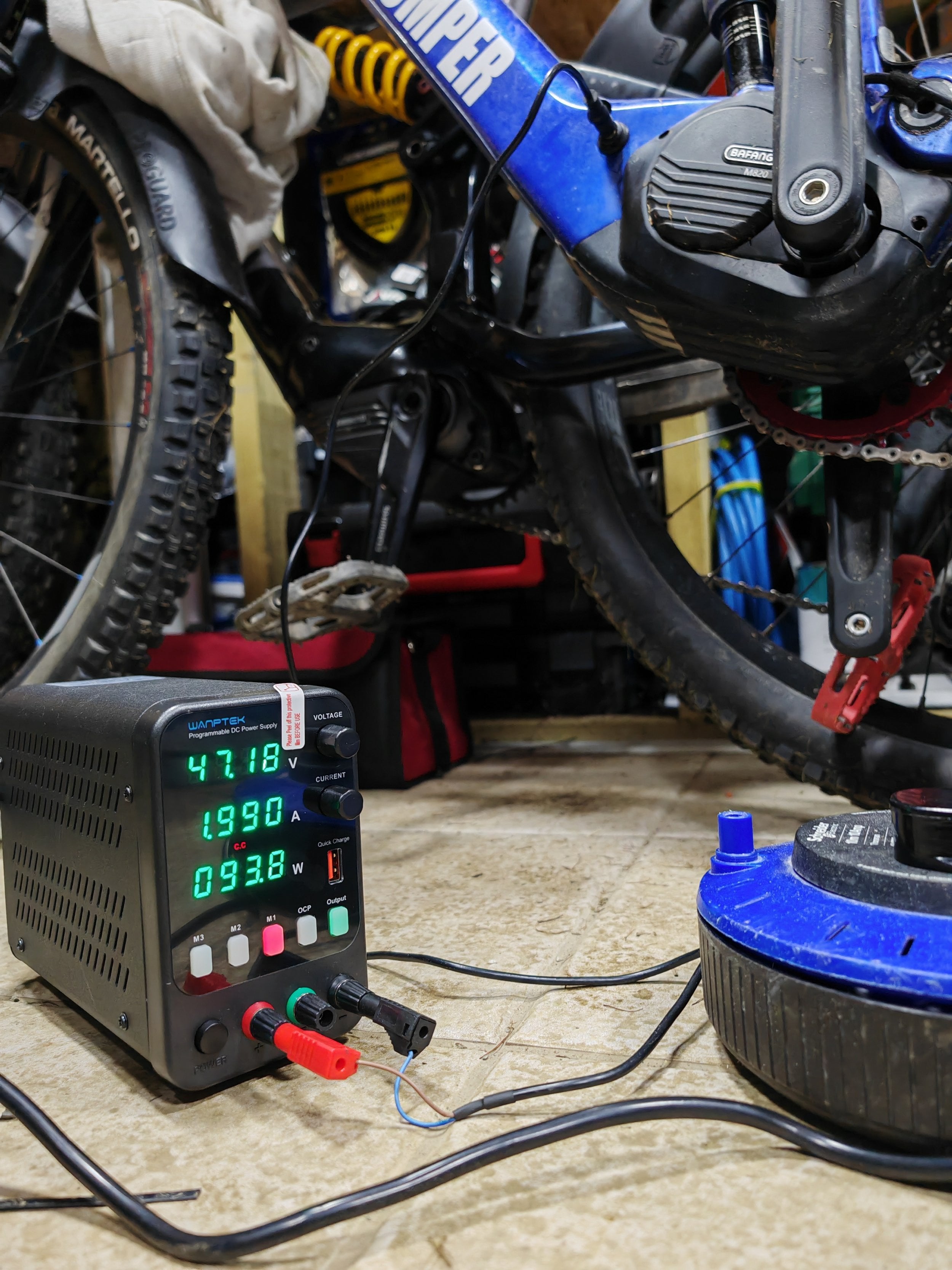

The subject in the video is 100% up to date. Exactly reason I went with DIY ebike.
4k EUR we can build light ebike with customisation we like. Where is the point of buying 10kEur ebike and upgrade wheels, stem, handlebar, dropper post, T transmission, grips, brakes, multitool, etc.
Another point is, unification of DIY ebike, we can build the battery, reuse the cells, use lab psu and charge battery way we like.
Uograde the bike? Not a problem, get new frame and swap over rest of the parts. DIY is the way.
