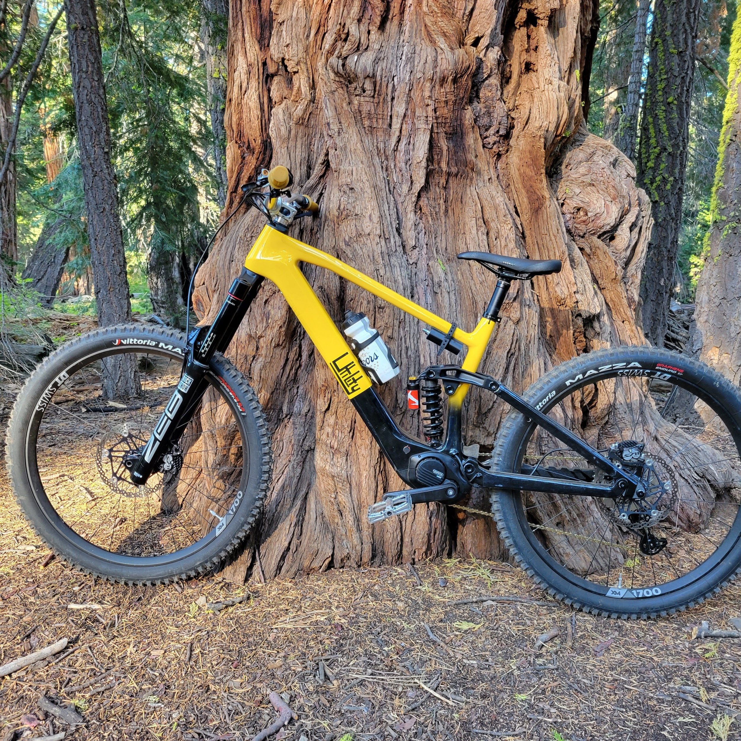

New frame and motors are a dream. Here is my build.

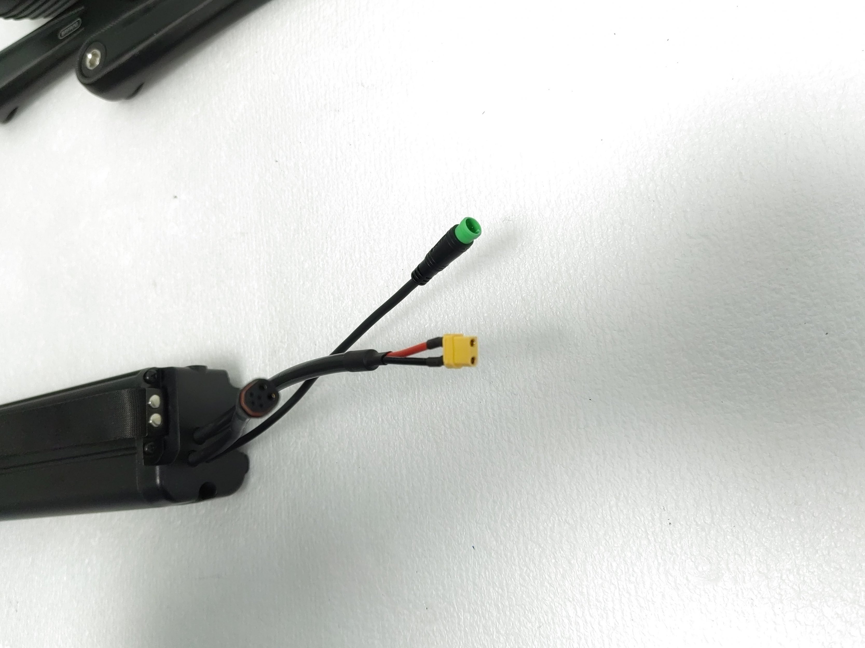

This is the one, if you need lights output:
And the one without:
edit: at least this is the one I ordered as 1T3.H and recieved the correct one. The picture does look different, than what I recieved. BMS connector is indeed green and circular, with 5 pins. In the above web page I don't find the exact one, according to the pictures.
Looking slick overall! What's your travel, 160/150? If so, could you over-stroke rear?
Also, good brake/rotor combo💪 (IMHO). I run Saints and Hope 220s for no-fade breaking!
Some sweet, black, Hope E-cranks are a nice and light aftermarket upgrade over stock. They're killer and half the price of 5Dev bling! I run mine at shortest possible (for Hope)...155mm to minimize pedal strikes!🤟

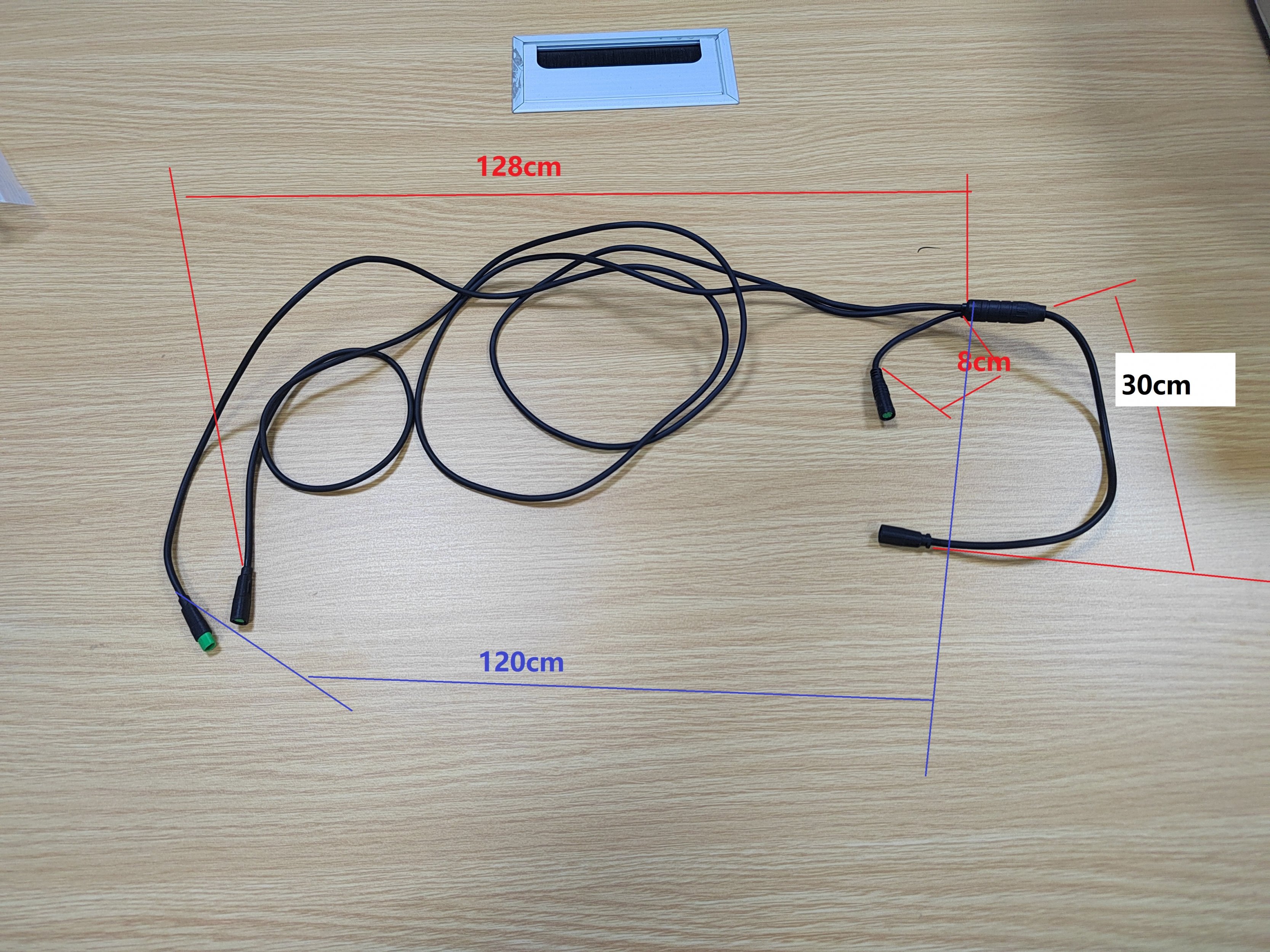

both cables are wrong, both are for M510/M560/M600, the cable for battery BT F014 have a roud greed port which conect to the green port on battery,
Does anyone know the part number for the correct cable? My vendor is really struggling to get me the right part.
Will hope cranks fit on bafang motor?
