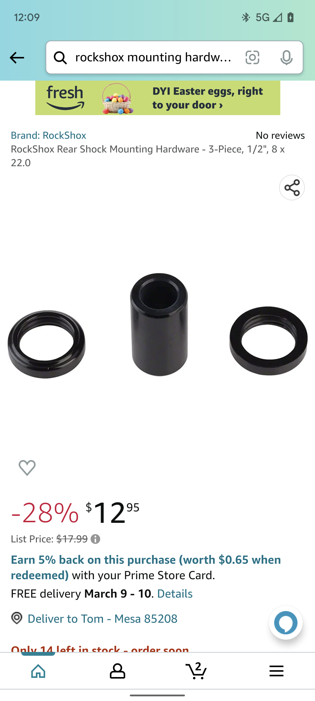

Rockshox does not make 8x22 mounting hardware. They make 8x20 and 8x22.2. Why did you change your post to M8x22 from M8x20?
So the question is how much smaller than the actual measurement?
they sent me those same pictures. So I posed a very specific followup question as to what size bushing to buy. They checked and engineers said 22mm. You can see on those pictures, the opening is 22.2mm and bushing size is 22mm. Guess they factor in tightening?
Quick search I see locally can get Cane Creek in that size. Or if you can wait for the slow boat from China, Aliexpress has them cheap: 2.63£ 6% OFF|Shock Absorber Bicycle Mtb | Bicyxle Shock Bushing - Mtb Rear Shock Bushing Bike - Aliexpress
For my RS Ultimate MegNeg shock. I'm doing it for both upper/lower eyelets.🍻
that's 22.2mm. You need 22mm (according to their engineers). Looks like they have them in 22: RockShox Rear Shock Mounting Hardware - 3-Piece, 1/2", 8 x 22.0
