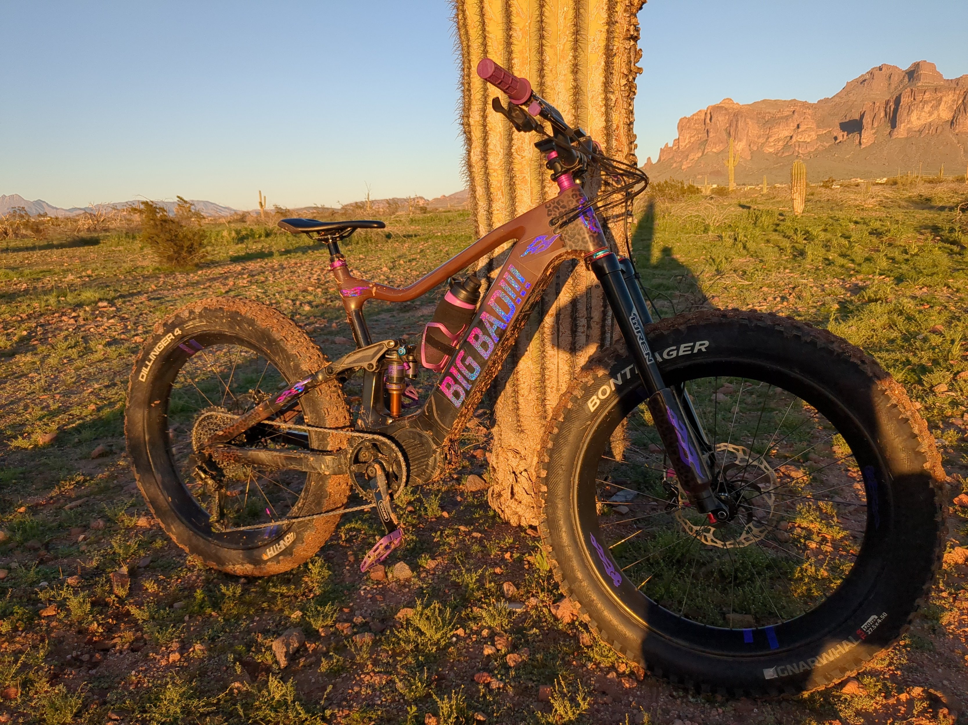

My fade paint job still holding up...$25 of paint.... But customer sticker expensive.💵💸💰
PXL_20230228_010005430.jpg PXL_20230228_010012885.jpg PXL_20230228_010030348.jpg

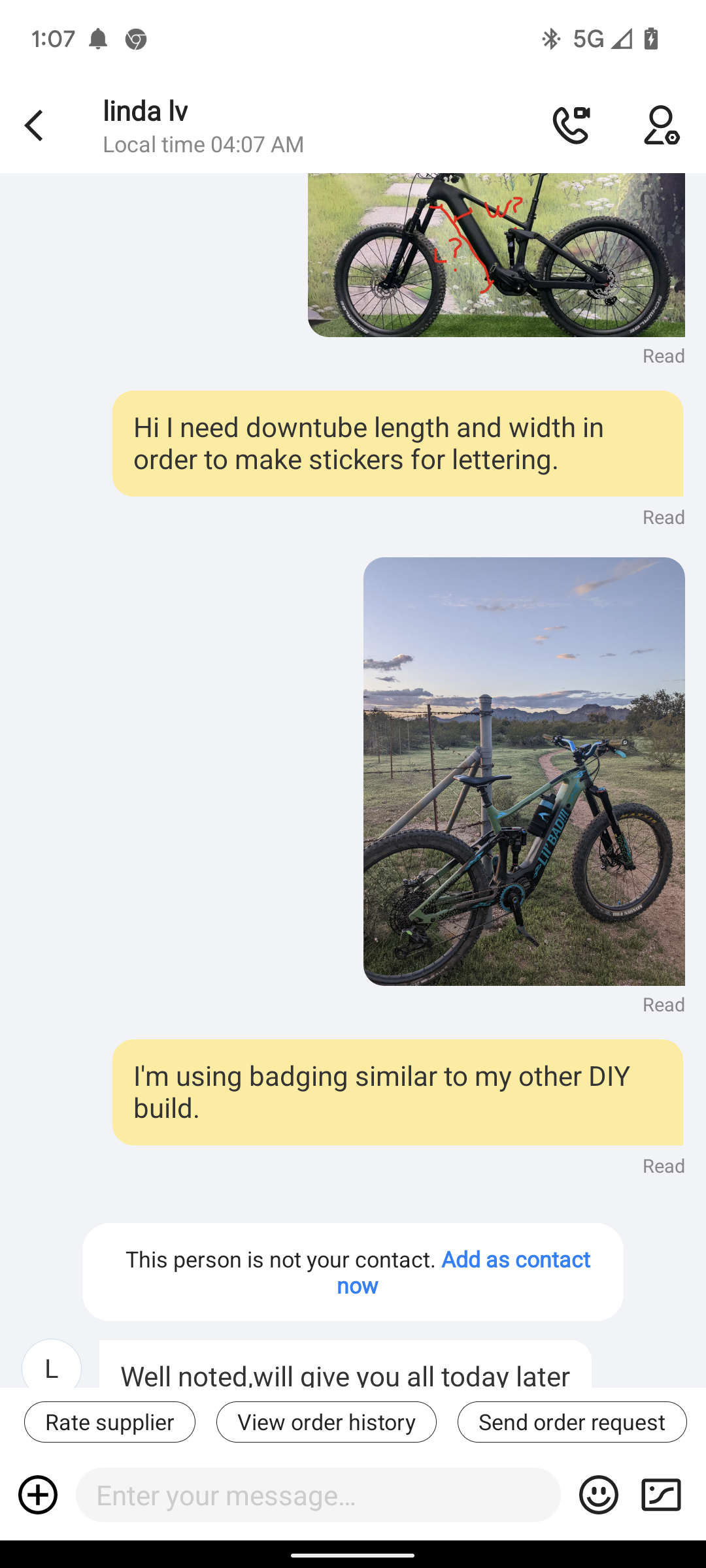

Well sure, Linda responds when in their office time zone on Alibaba messaging too...I just Google Beijing time and contact in their working hours. But here's today: see Convo below a few hours ago.
Then I'll have to ask again in another week or two due to no follow-up. These are very basic, yet critical build questions that should be known to the sales team at the outset.

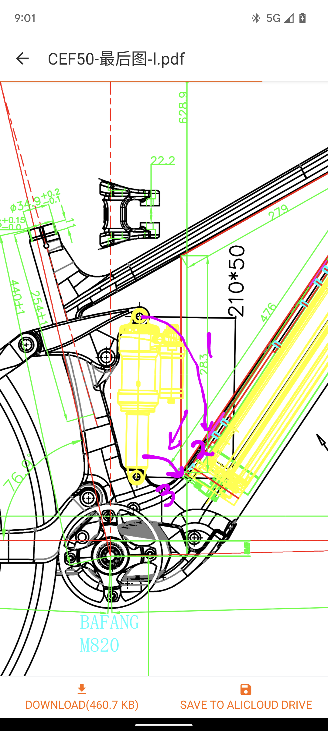

Update: On bigger air-can and/or coil shock enthusiasts here's my mock-up of the CEF50'S probable shock pathway courtesy of their engineer.
Apparently, a full CAD motion illustration was not to be had...they're producing frame orders and probably lack time. For what its worth.*
Note: poorly drawn purple lines are mine.
1. Should be the general arc of the top shock (rocker arm).
2. Travel compression direction.
3. Clearance of the damper body that should allow complete compression w/o rubbing the seattube.🤞
*If you're worried you might want to wait prior to buying a bigger air can upgrade or coil. Personally, I need to see that bad boy in action as it will be the first item to suss out for frame fitment and testing straight outta the shipping box! Then I'll post my findings forthwith.💪
