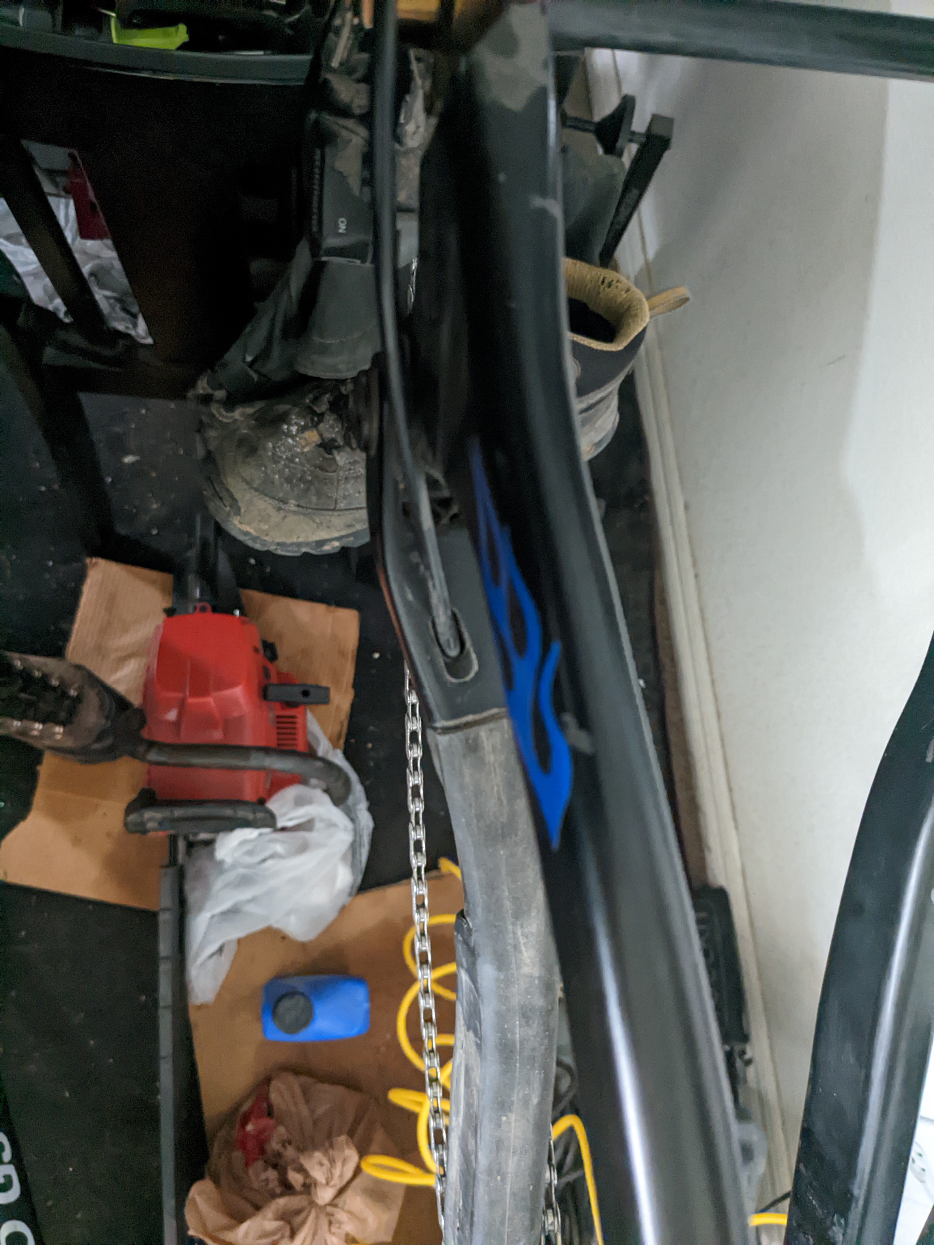

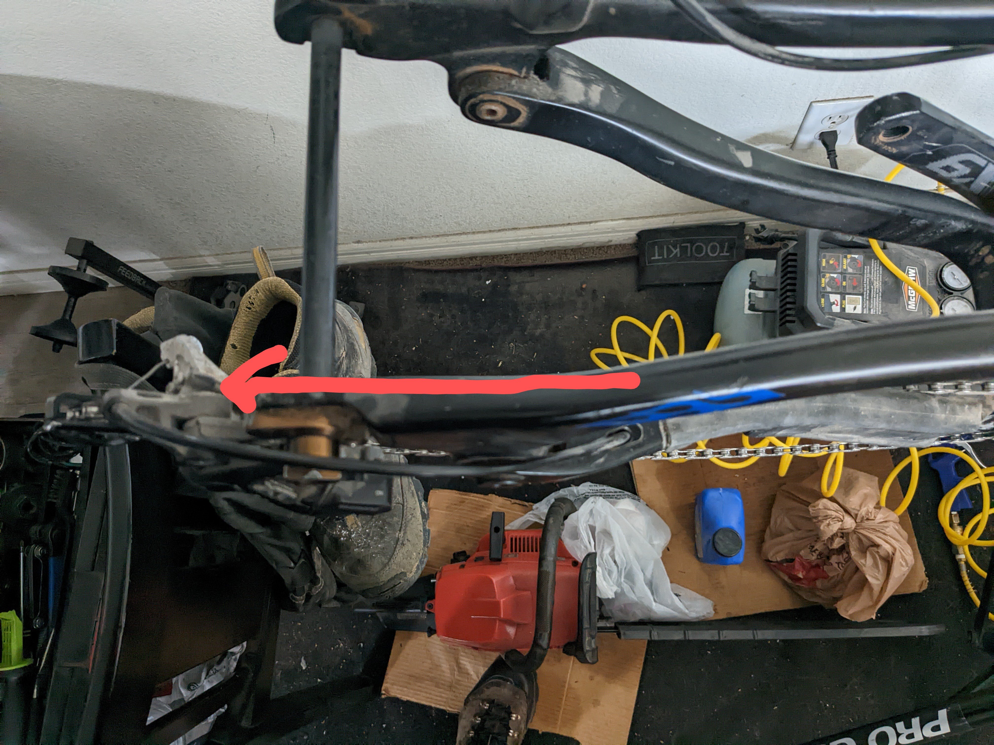

Yep I see it...agreed. It just rare to see the derailleur cable port laterally....it's hanging out there a little to get snagged easier than on a dorsal cable line feed. But I'm sure it will be fine.
Plus, the cable is more aligned with the derailleur bolt clamp.

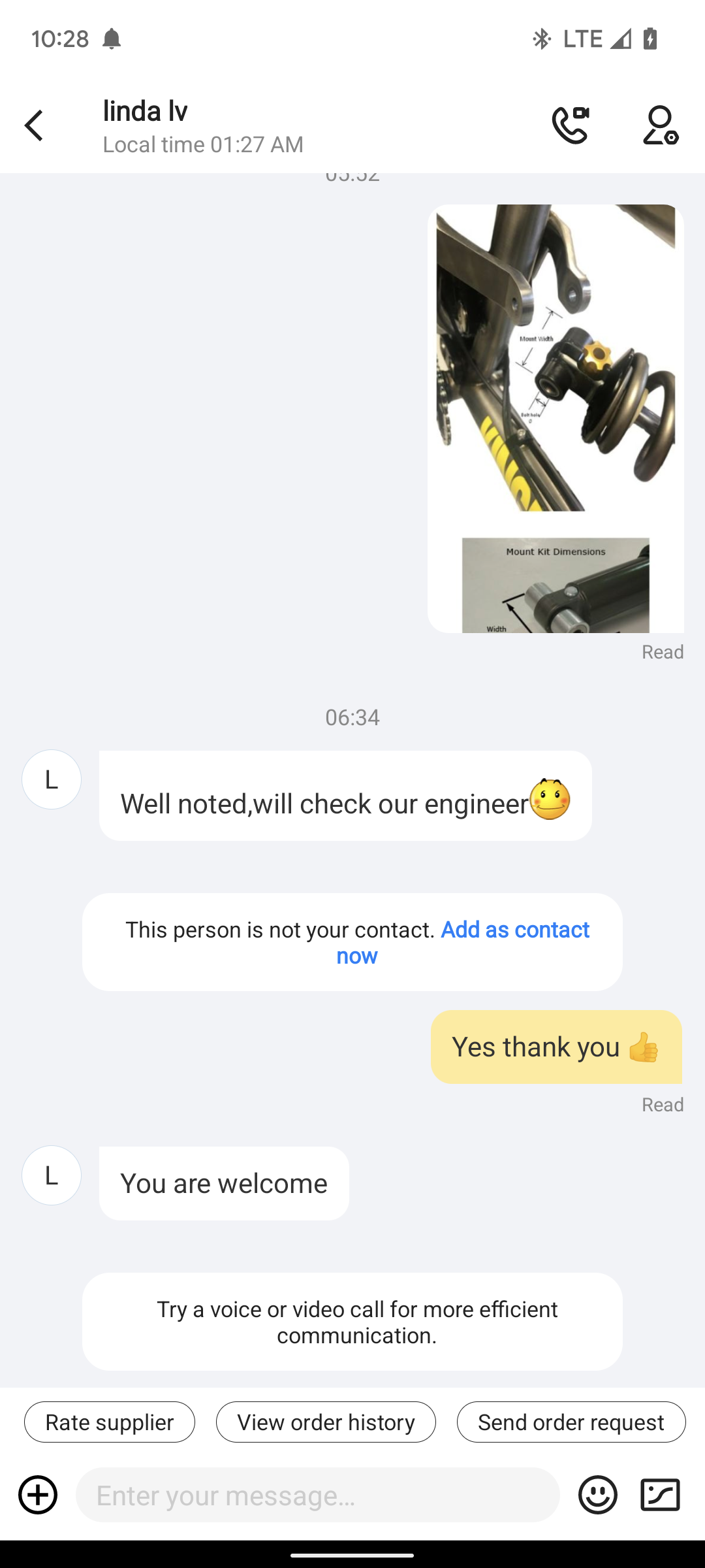

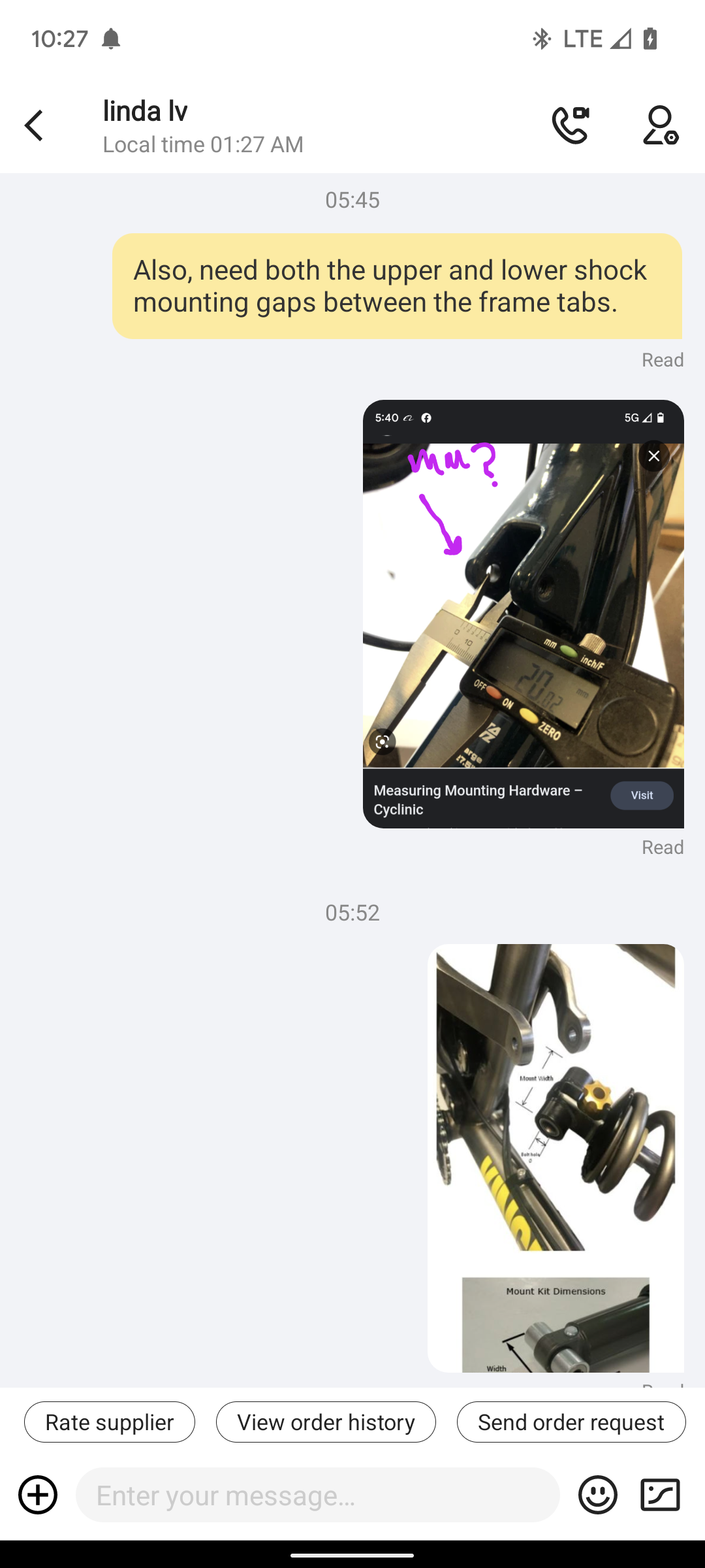

Did anyone ever get an answer about that top tube power button (i.e what they will ship and how it will work)? Also shock mount hardware sizing?
Linda just gave me the mounting bolt dimensions (M8) only not the mounting width between tabs. But I had to show her an illustration to get the actual mounting hardware sizes below this morning...still waiting.

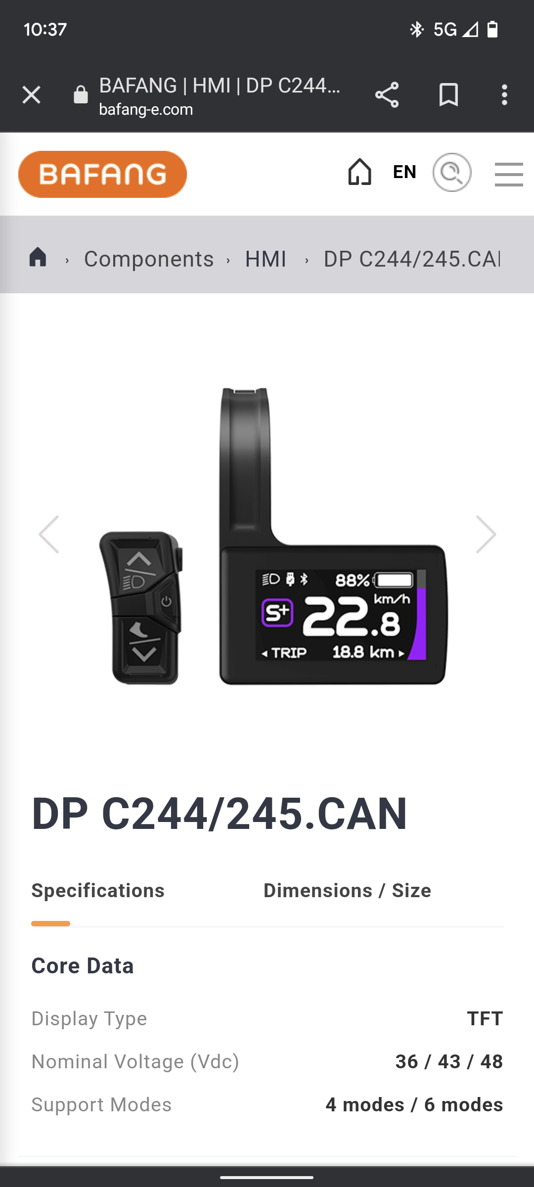

I ordered the DPC-245 bluetooth because it is most like my minialist shimano steps display on the Orbea. I don't like the chunky look of the DPE-18.
There is no possibility of crosstalk but there certainly is no need for two displays. The top tube is the simplest integrated display, which is also probably the cheapest, but who wants to take their hands off the bars to change assist?
Ok we agree. It's redundant and adds extra weight unnecessarily. 👍
I agree on the DPC-245, I've tried to order it through greenbikekit, they are available to purchase now?

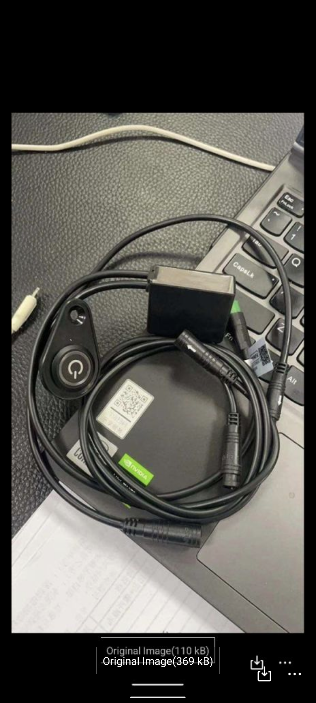

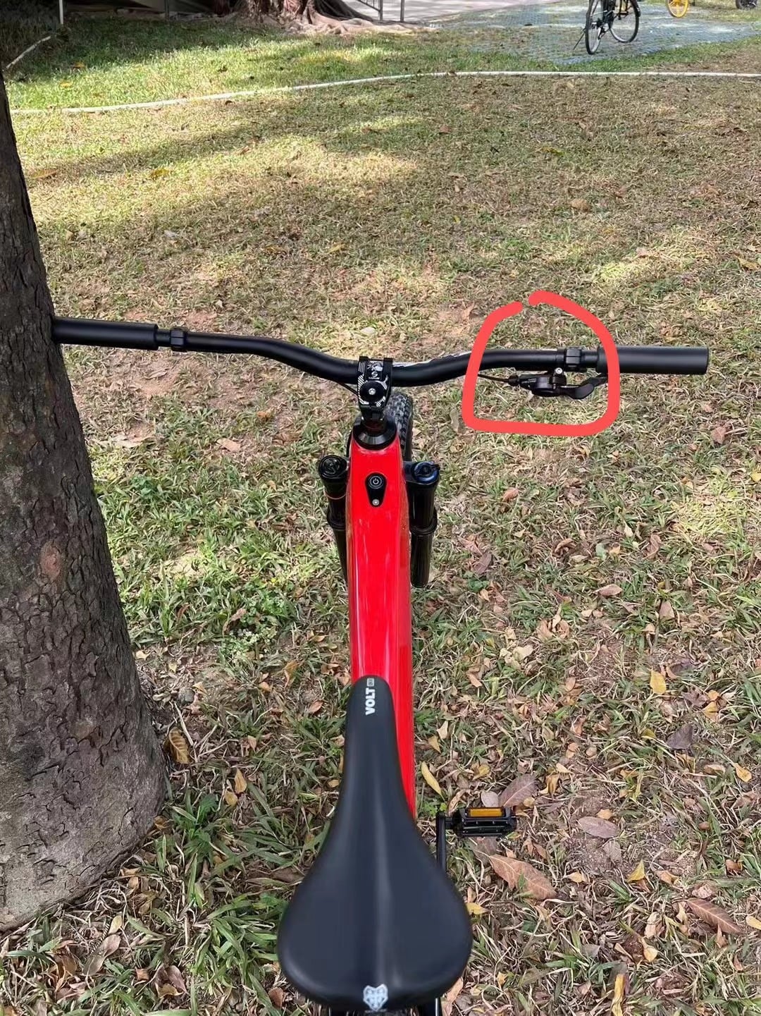

Here is a shot with only the top tube display/assist control.

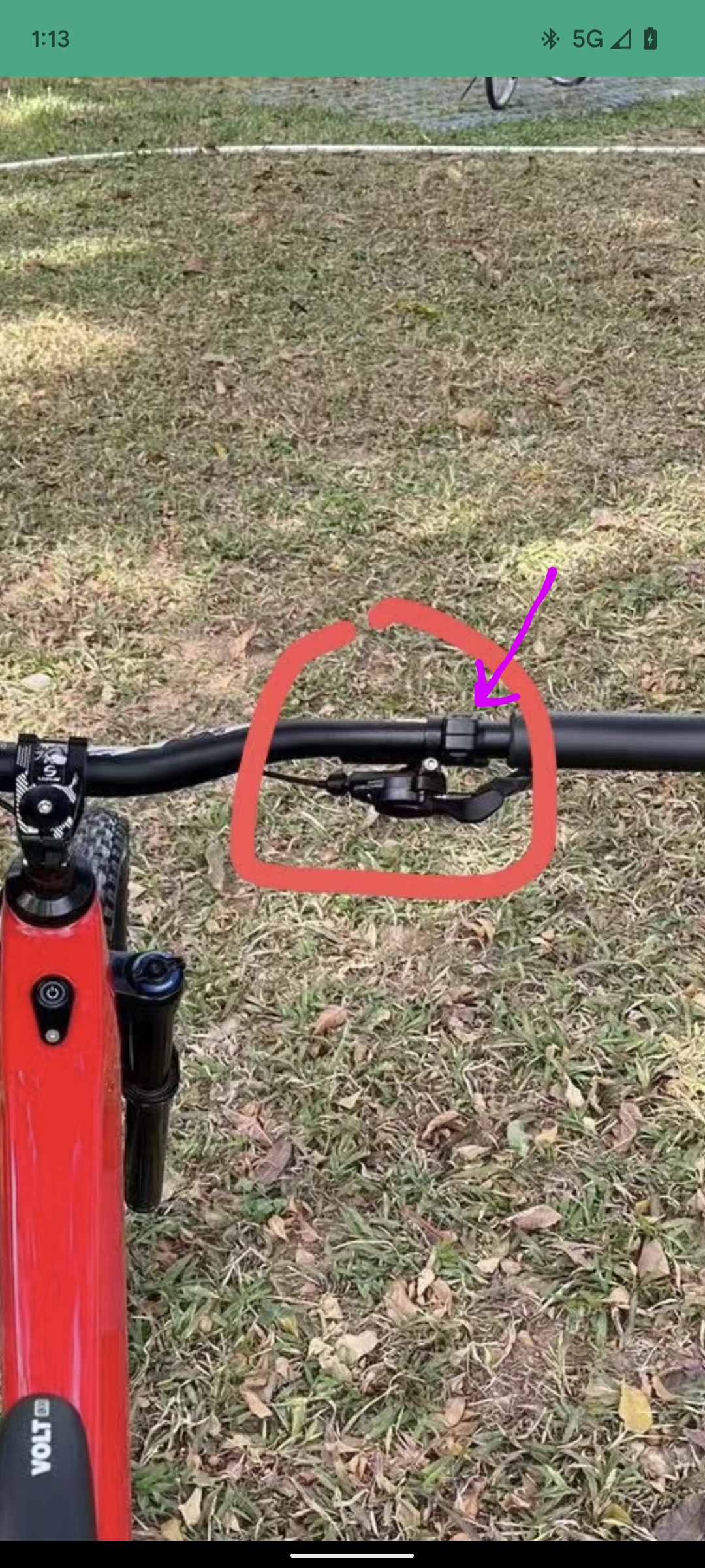

Wait. Is the purple arrow that I drew point toward a wired thumb power selector?
If so, I prefer the DPC452 color display too, but could live with this minimalistic setup.
Unfortunately, Linda originally said "no" on the thumb switch with frame integrated system alone. She probably didn't know. Aggravating for sure!😵‍💫
I think it just the brake lever clamp (both sides)
Yes I can see the inexperienced customer thinking the top tube assist is clean and cheap but anyone who has ridden would discard it as an option immediately. Unless you are a commuter I suppose.
But an Enduro bike? Ya I am going to take my hand off the bars to change my assist in the middle of gnarly down.
Definitely a bad choice by the design team.
So maybe a goo holder?
Yep...brake clamp. Was hoping for the best...

I personally prefer to see a small screen instead of the bulky high profile remote.💪
Plus, the DPC 245 has a fairly minimal remote switch. Vast improvement over the older black and white screen DPC242 that was hard to see in daylight or with shaded eyewear. 😎
But the 245 is better because it has bluetooth for connecting smartphone. The 244 does not have bluetooth.
(the picture above is a 244)
