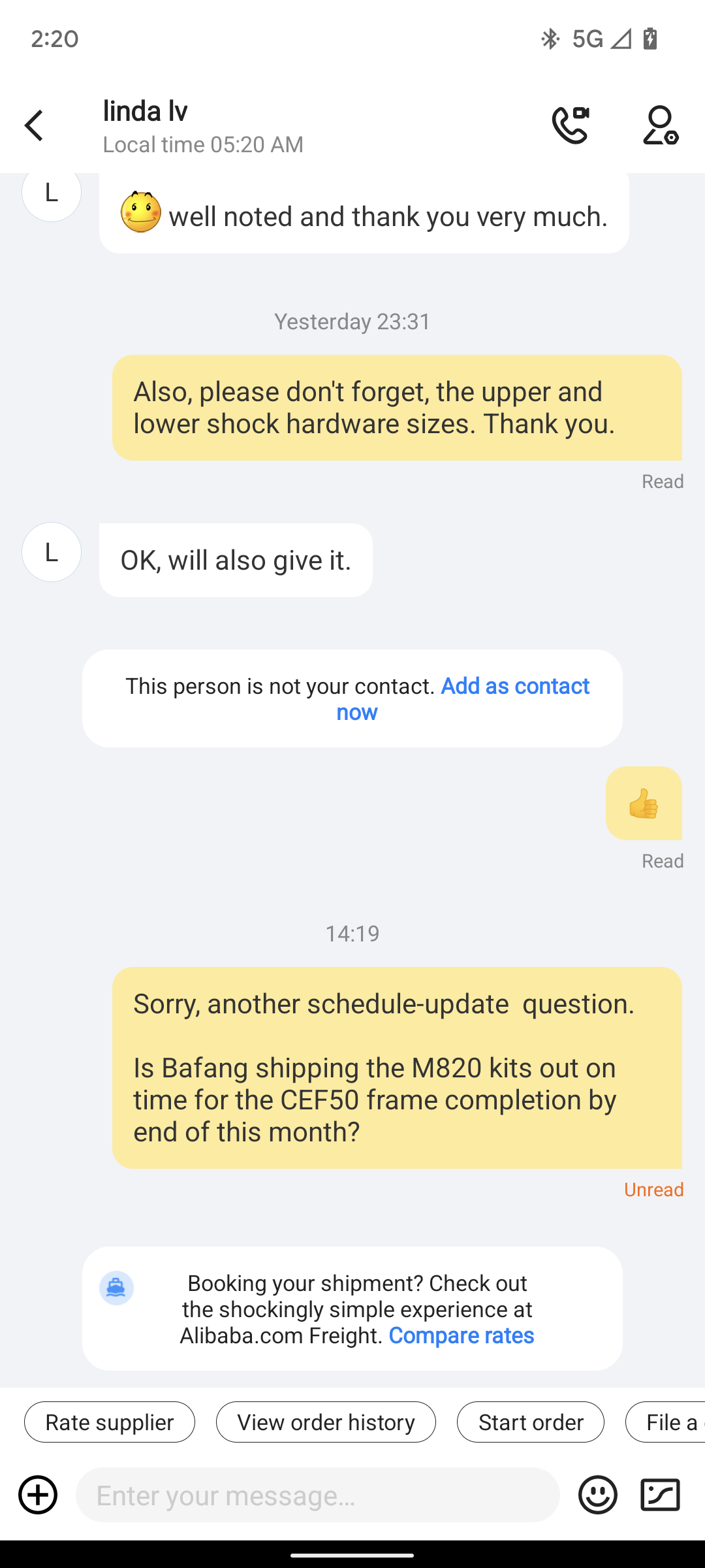

Unfortunately, still a month out before most can hoist on a bike scale. If they actually send out 3/1 (Linda re-confirmed frames on schedule recently)...then mid to late March to buyer's door?

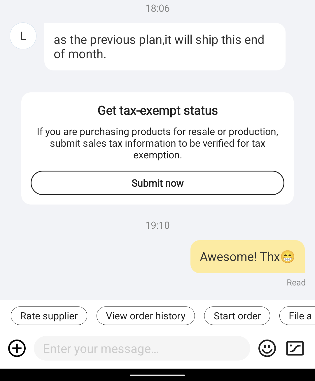

Plus, I too am wondering if Bafang is shipping M820 kits out to dealers yet? It's been white noise thus far, unless someone has heard different?
Maybe question for Linda. She's probably getting tired of my emails.😁

Alright, I asked for fitment hardware and Bafang M820 kit shipping update.

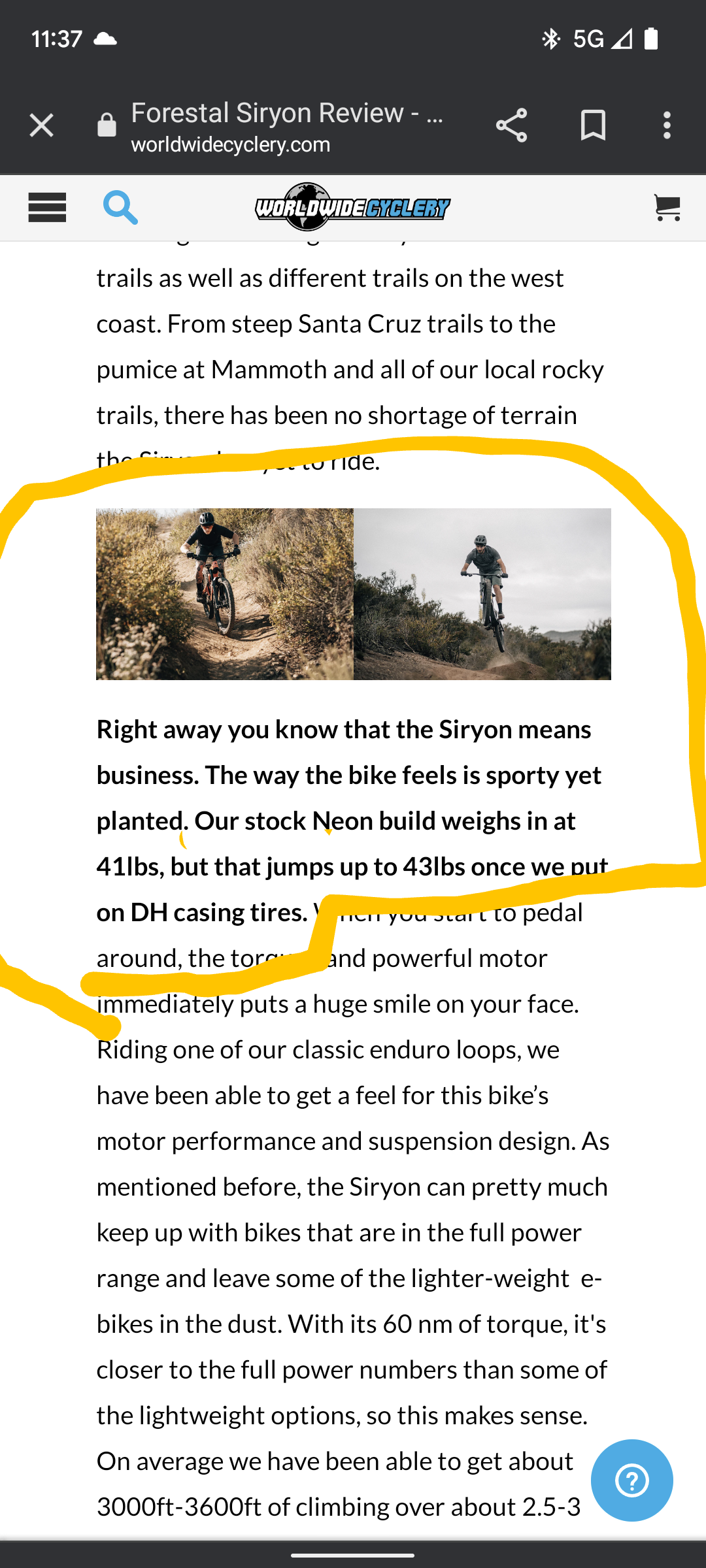

Maybe what to reasonably expect in comparison of the complete builds:
CEF50 v. Siryon (Neon, mid-end build):
💪Overall weight: 43 lbs. 2.4kg Siryon frame +360 Wh Aurora battery 1.6 kg, fit w/ heavier casing tires, and 36 fork. Same M820 motor (different tunes)...Jus' say"n.

Hope Linda confirms me that they ship the frame next week, looking forward to build it once it arrives

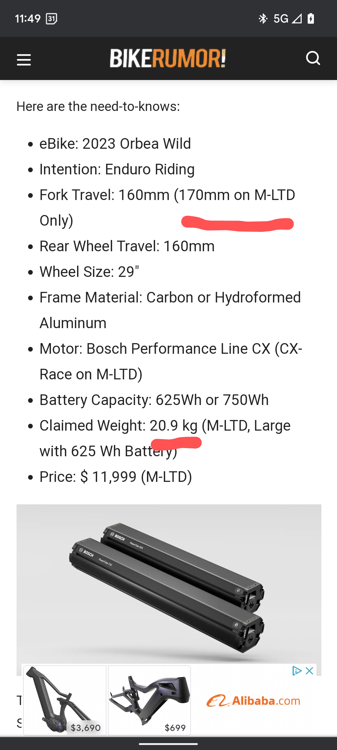

Argument #1. Here's my argument compared to the the newest, lightest full-powered offerings. The novel Orbea Wild LTD in large w/625 Wh motor-drop battery with Bosch Cx motor 85Nm, beefy tires, and Fox 38 fork weighs an amazing 46.5 lbs!!!
***Here's the key#1. They claim to save a full 900 g/1.98 lbs while getting a 51% stronger downtube w/o cutouts and removable cradle hardware.
Argument #2: Now compare it to the Transition Relay large build 460 Wh trailside removable battery, Fazua60, and Fox 36 at 19.8 kg/43.6lbs
***Here's the key #2. It's fair to assume w/o the cutout and cradle removable battery hardware, add back on at least 1.5 lbs.

Ergo...the weight difference is in the M820 motor savings compared to the Bosch Cx85 (6.3 - 5.1 = 1.2 lbs) and in the frame weight savings from the Relay (-1.98 lbs). Now add back in the weight of 720, Wh battery (+ 1.2 lbs).
This projects that the CEF50 720 Wh 180Zeb/heavier tires should be +1.98 lbs heavier than the Relay (43.6 lbs + 1.98 lbs = 45.4 lbs) but lighter than the Wild (46.5 lbs - 1.98 lbs = 44.52 lbs).
Tradeoffs. While one gains power, travel, beefier tires, and range over the Relay, it loses power, but gains range being slightly lighter, and possessing a higher capacity battery than the Wild. It will also lose convenience of easy, trailside battery removal to the Relay. But only the m820 motor is DIY serviceable w/o voiding the warranty, plus it's widely available and half the cost of the Fazua60 and Bosch CX85.
Take home message. I should reasonable expect that CEF50 big 720 Wh, enduro-build to range between 44.52-45.4 lbs!
