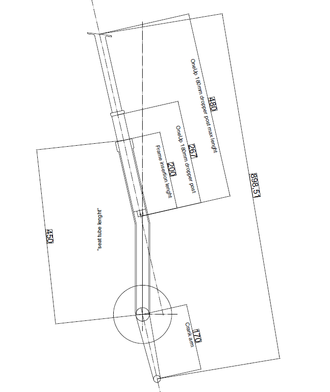

I have made a simple drawing bellow, LCE930 frame + 180mm dropper post from OneUp. 200mm of insertion length is a bit low but 180mm dropper might fit OK.
Regards
Peter
Regards
Peter
yes, The dropper seatpost we design is fit for 180mm, mot 200m, In fact, the design positioning of the LCE930 is an EMTB with all-terrain passing capability, rather than a heavy-duty EMTB. the travel's date is under enduro EMTB, it's all mountain, the drooper seat post 180mm is enough.,
