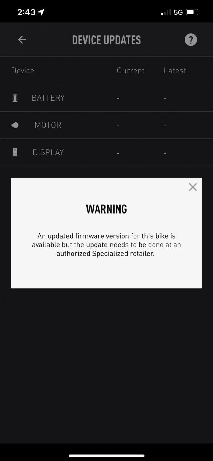

Anyone else had this pop up?
I just connected to Mission Control to change some power settings before heading out on a ride, and I got this message. Everything says it's up to date, and I just rode this bike a couple days ago without any issues.
I was hoping to get this sorted so I could get out for my ride early today, otherwise I'll just swing by my shop when they open in a couple hours.
I didn’t get a message like that but did get this message about an update that needs to be done at a dealer…
Everything was up to date, but my motor had somehow lost its calibration.
We just had to hook it up to the computer, recalibrate, and it was all good to go. We also changed my wheel size from 2300m to 2000mm, so now I can go 23mph before the motor cuts out!
Cool, did they charge anything for reprogramming wheel size to 2000mm? I need to do the same.
No charge.
For sure worth it - It's quite noticeable how I still had full assist from the bike pedaling 20mph on flat ground, whereas it used to be cutting out at that point.

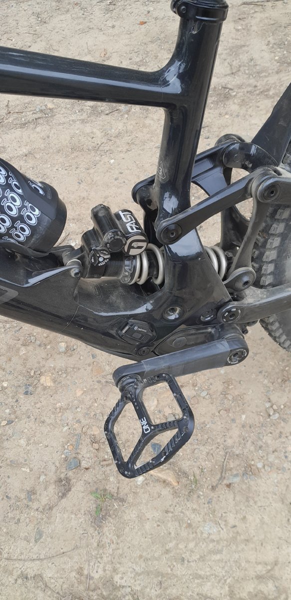

EXT Storia coil fits my KSL S5 just great AND its an amazing upgrade, done by Chris Porter at Mojo / Geometron Bikes who work very closely with EXT
