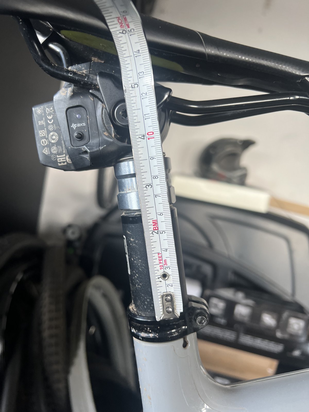

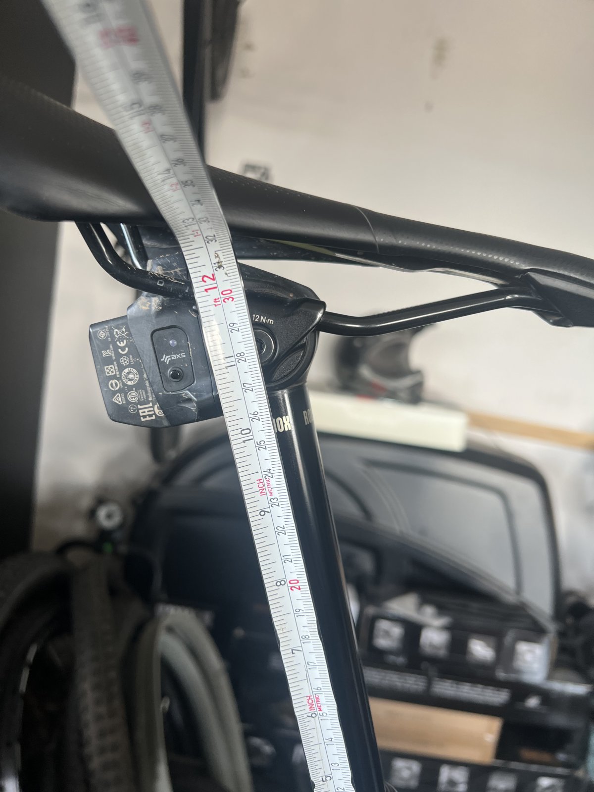

Has anyone tried a 170mm AXS dropper in an S3? If so, can you I please share some dimensions when fully inserted?
KSL S3 Expert,
I cut down the air valve protector to gain another 5mm of clearance. I also lift the seat up another 5mm from full bottom out, just in case.
I am 5’10, bikes in neutral and high position running 180 back and front. I rarely tire buzz myself or nut myself on the seat on the DH.

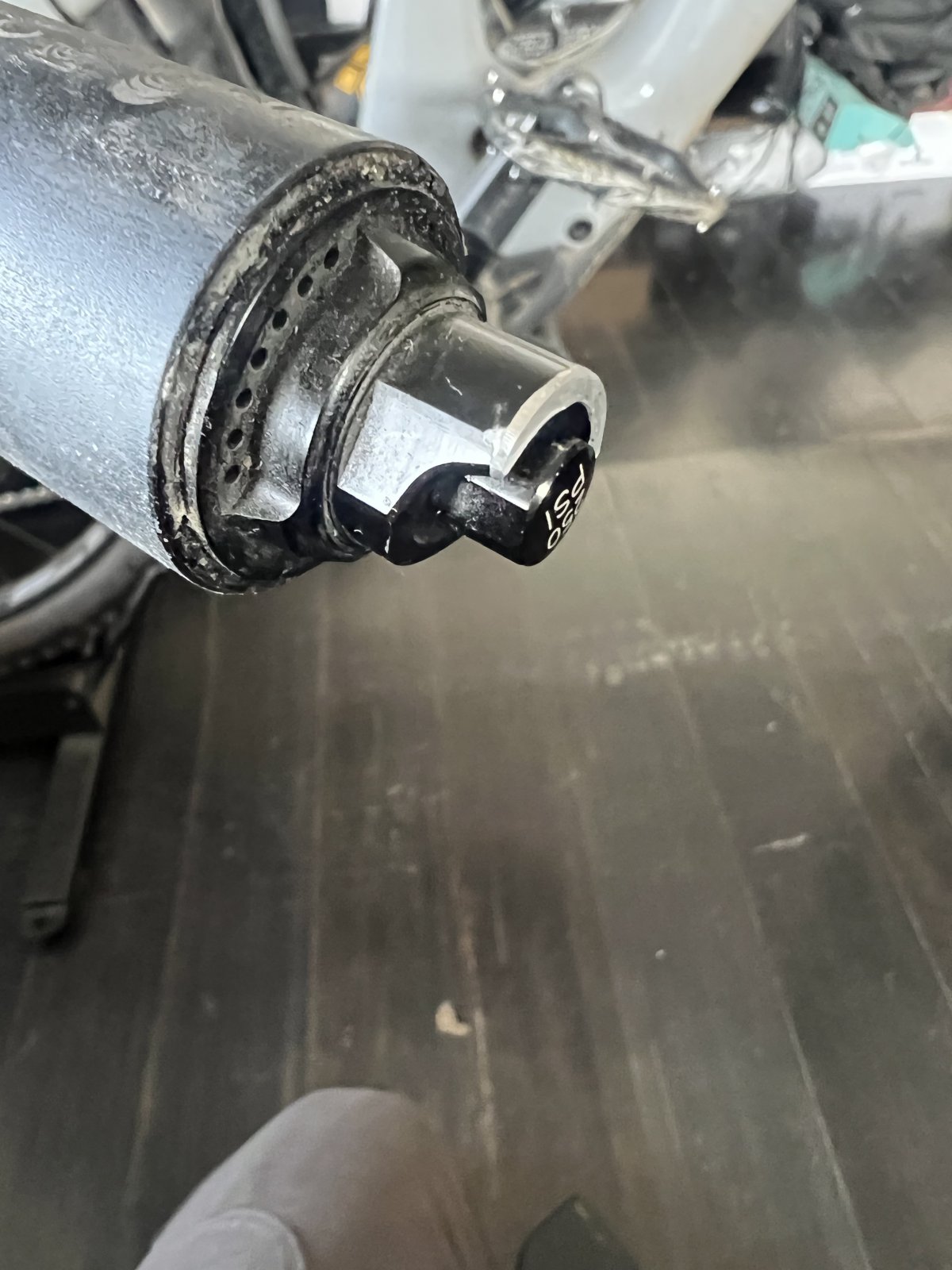

I took the aircan off of my x2 shock today (expert build) and there was no tokens in it. Is this how they normally ship? Had a quick search but couldn't find the info.
Did you remove the shock to take off the aircan? I wonder if the aircan can be pushed up for volume spacer installation without removing the shock from frame. Sometimes on certain bikes, shocks are difficult to reinstall.
I found removing by the rear wheel, aflipping the bike upside down and installing the upper bolt first, the lower bolt was pretty easy to install (eventhough it’s a tight fit).
