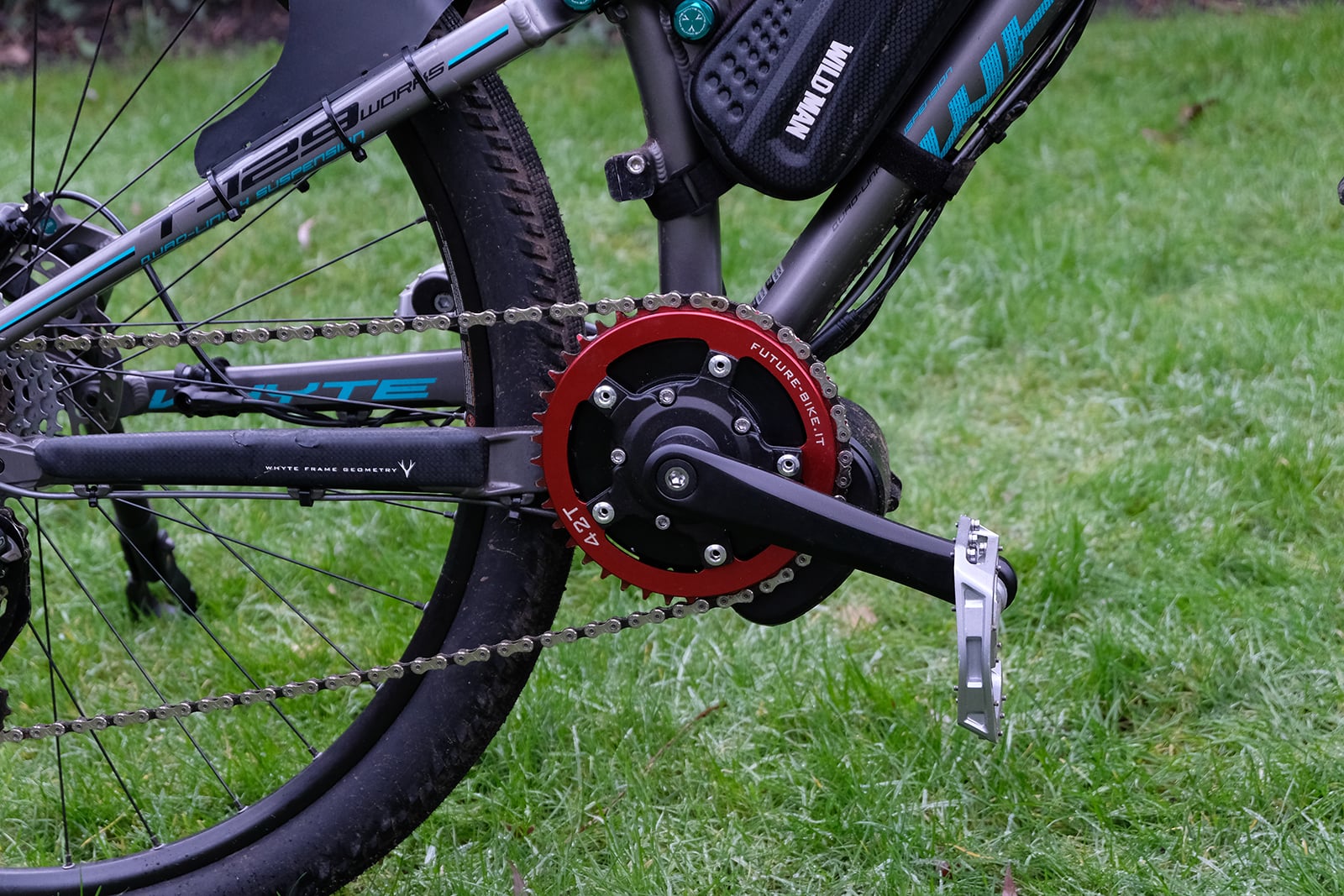

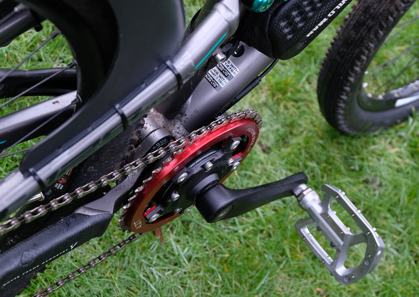

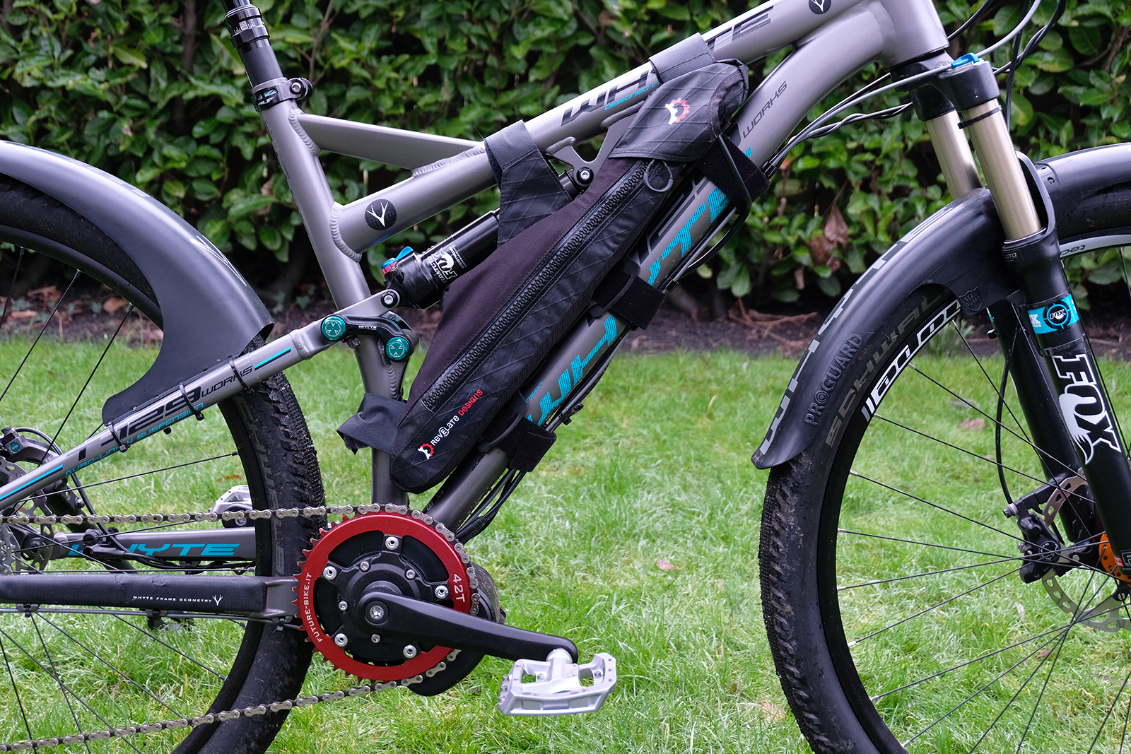

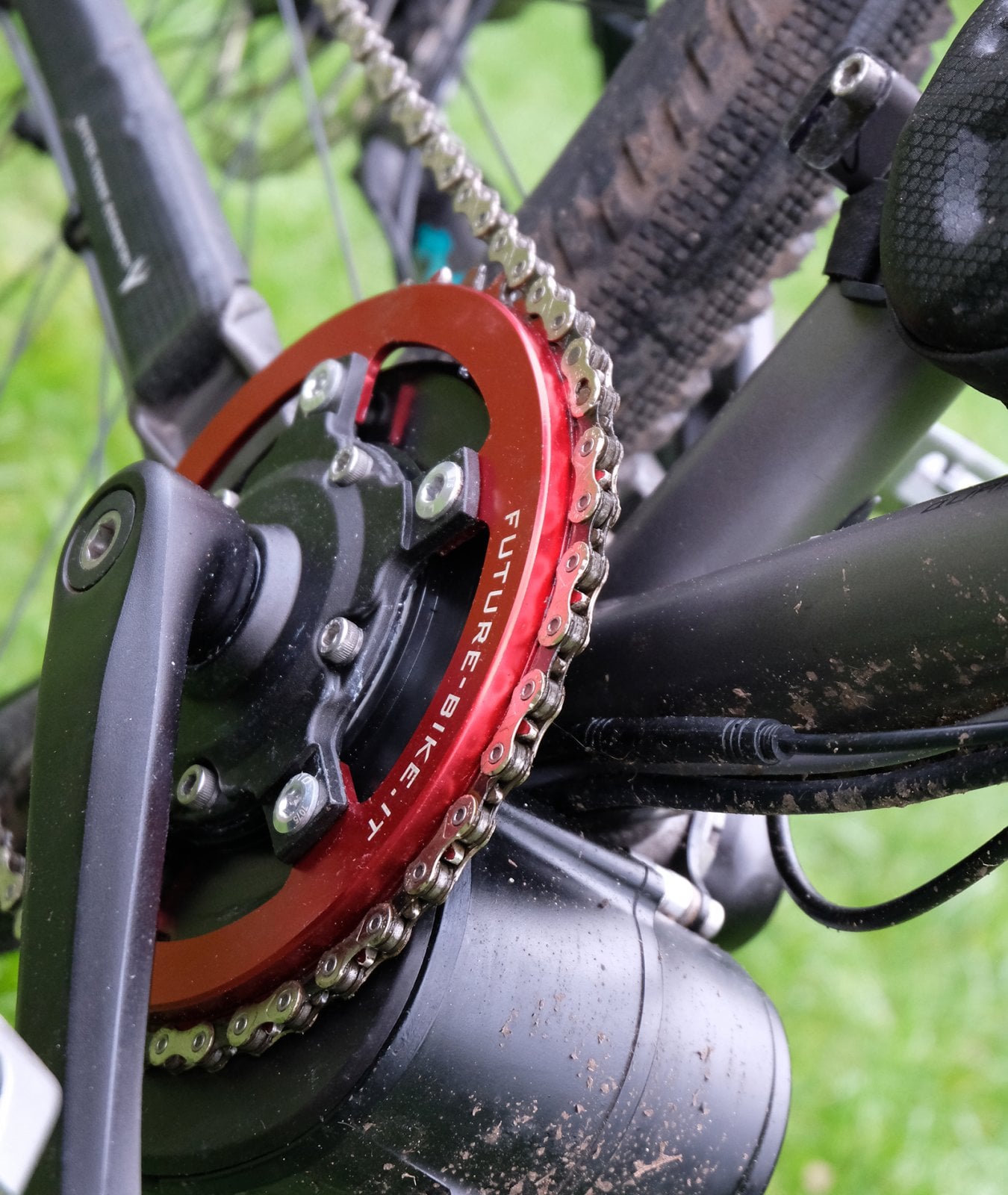

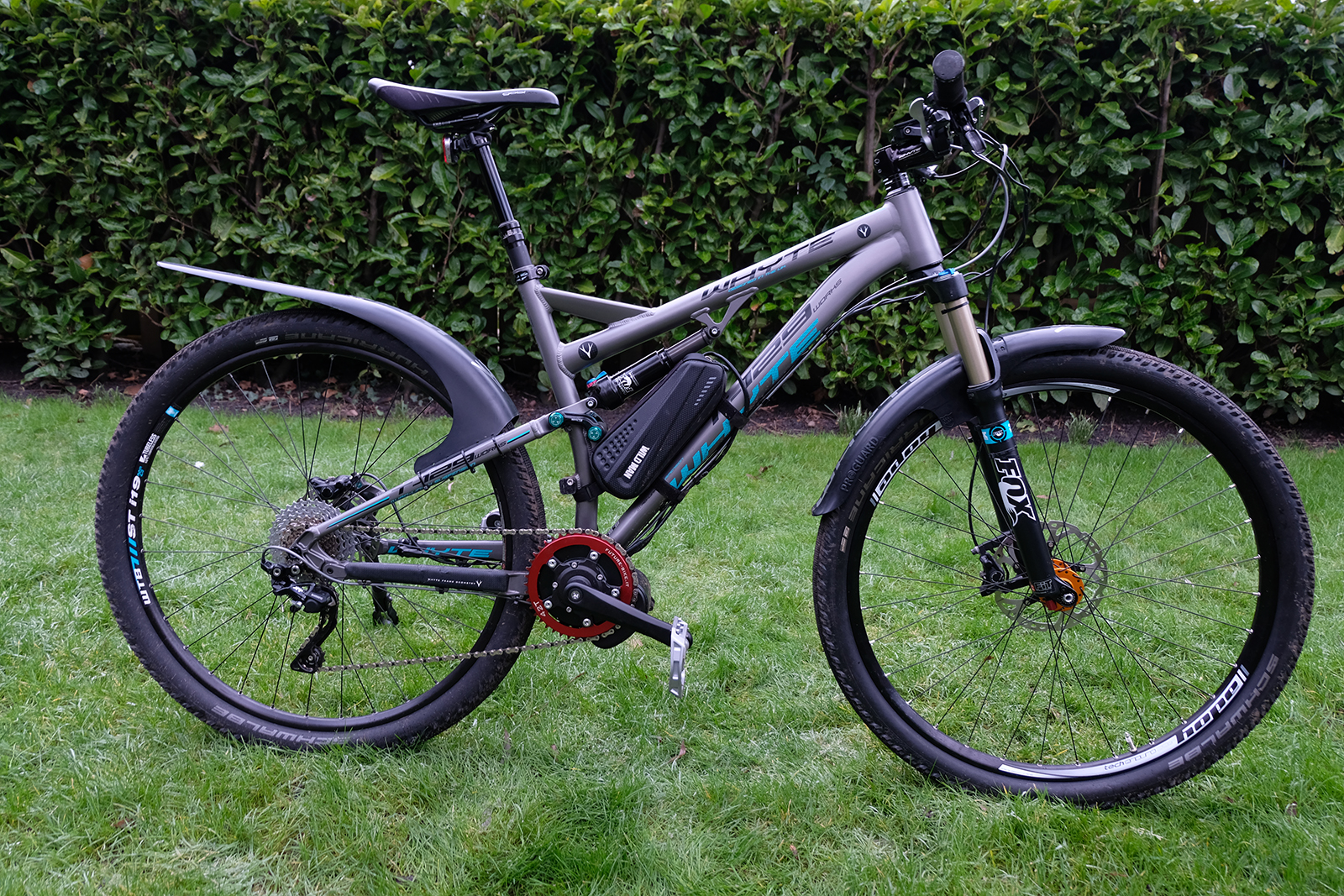

Hi, I managed to get get my bike converted at last.
This is it in commuter mode with road tyres. As soon as the rain stops here those mudguards will be gone and the Knobblies will be back on.
48v 500w, weighs in at 20.5kg, running custom firmware. I have two battery options at the moment, 8 and 12ah, both fit securely in frame bags. I did have to reverse the shock to get the battery packs to fit. Other than that everything else is standard.

The motor is the TSDZ2 48v 500w. I purchased it from Amazon before Christmas although that route is now closed due to Breshit. You may be able to find one in the uk, but I imagine the easiest route would be Aliexpress. The kit comes with everything you need apart from the battery. Because of the shape of the frame I had to build the batteries myself. A major saving over buying one off the shelf, even with the cost of having to buy a battery welder. The Wild Man case and Revelate frame bag can be bought from various places online.
I am running custom firmware with the 860c display although the motor performs pretty well out of the box.
Let me know if you go down this route and I try to help as much as I can.
