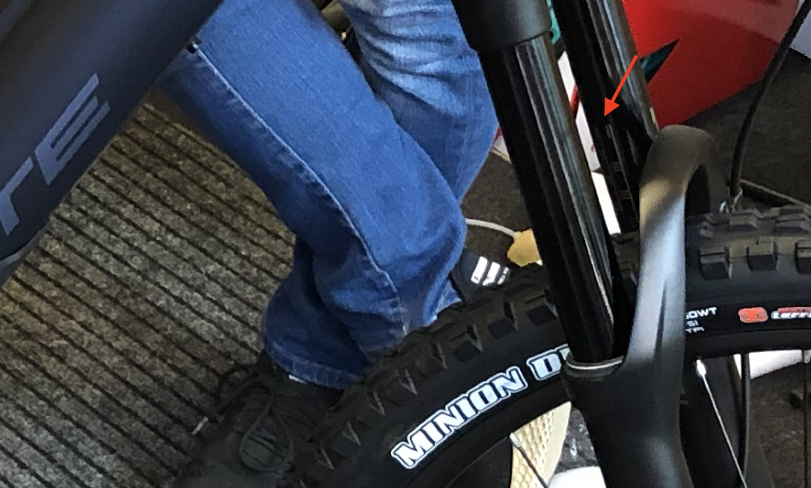

Agree just feel safer with more travel for my lack of skill?does anyone know what travel scale is on the E-150 rs Lyriks? Is it 150-160? Reason I have a new 160mm debonair Lyrik airshaft surplus ?
Yes you can put the fork up to 160mm, it has the 160mm indicators on the stanchions too
And IMO the travel on it is more than enough unless you riding is very DH focused.

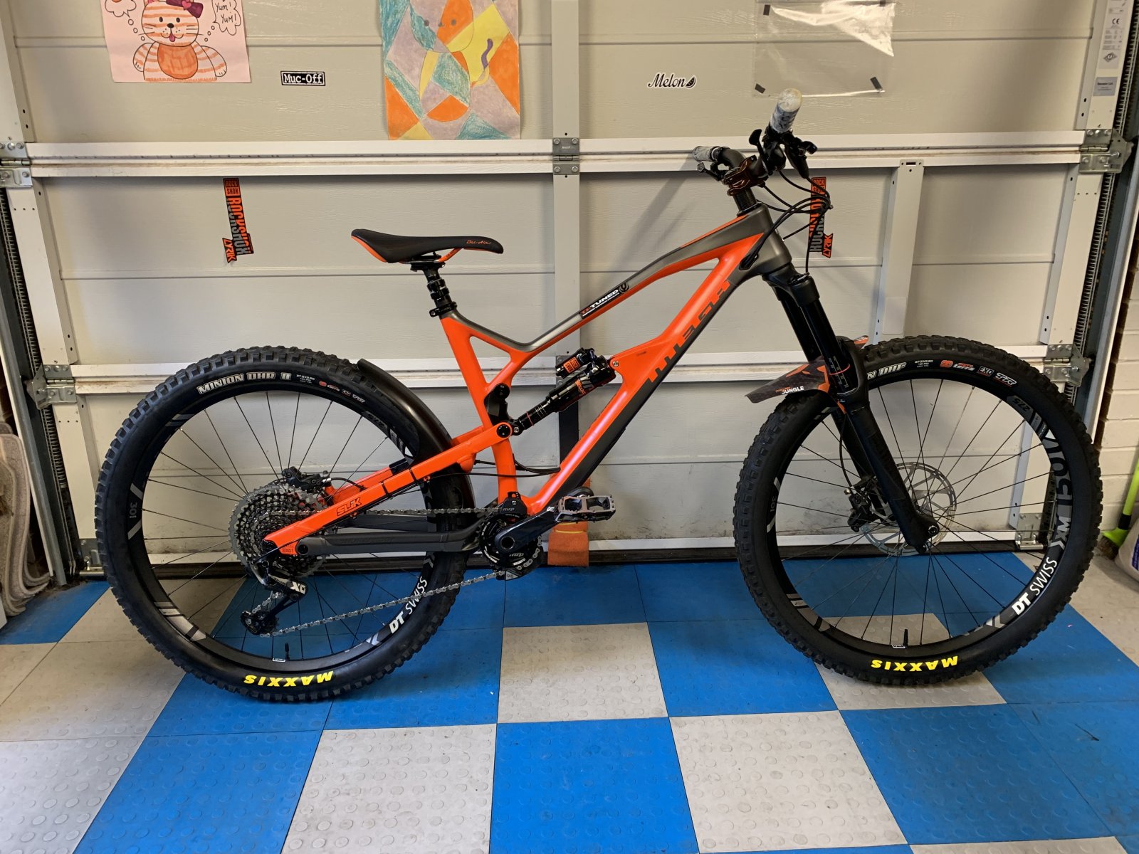

Looks awesome Scottie (y) bikes always look better filthy :p

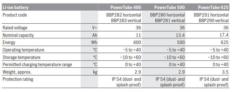

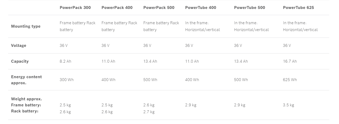

No. It's about 600Wh according to the spec sheet.
If you do the Maths (36V x 16.7Ah) you get 601.2Wh. It looks to me that they are using the same cells as the 500Wh battery (actually 482.4Wh) but adding an extra 10 cells to go from a 10S4P layout to a 10S5P layout.
Also the "Energy Content Approx" set off alarm bells.
If you look at the stats for your 504Wh Shimano battery you'll see it's bang on the money at 36V and 14Ah.
just an update to this, from the Bosch manual that comes with the bike the capacity is stated as 17.4Ah. so you actually get 626.4 Wh.
I wonder which is wrong, the website or the manual. Hopefully it’s the website...

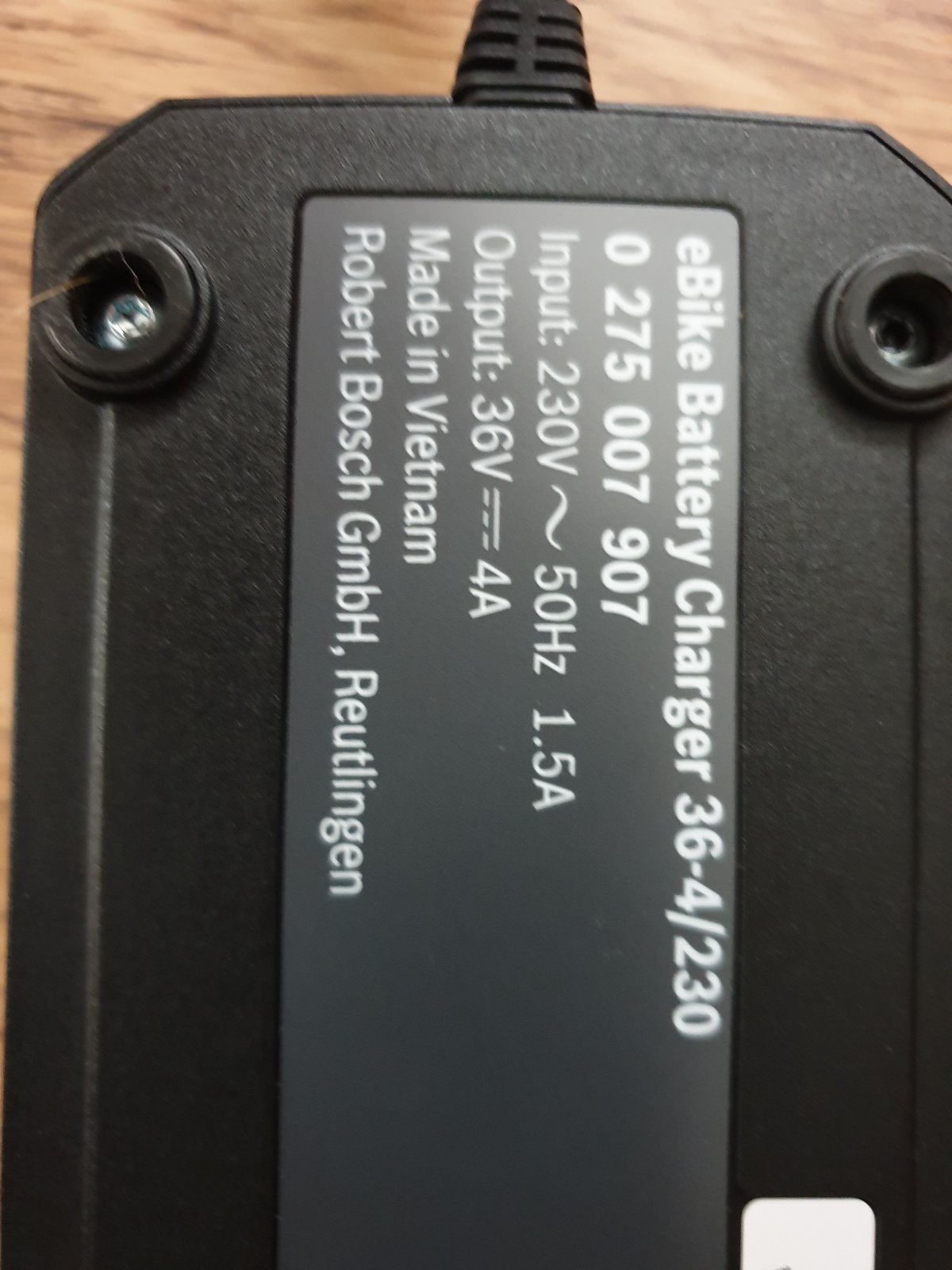

Actually, the specs are required to be shown on the battery, can someone who’s already taken delivery take a pic of the playing label on a 625 battery please?
