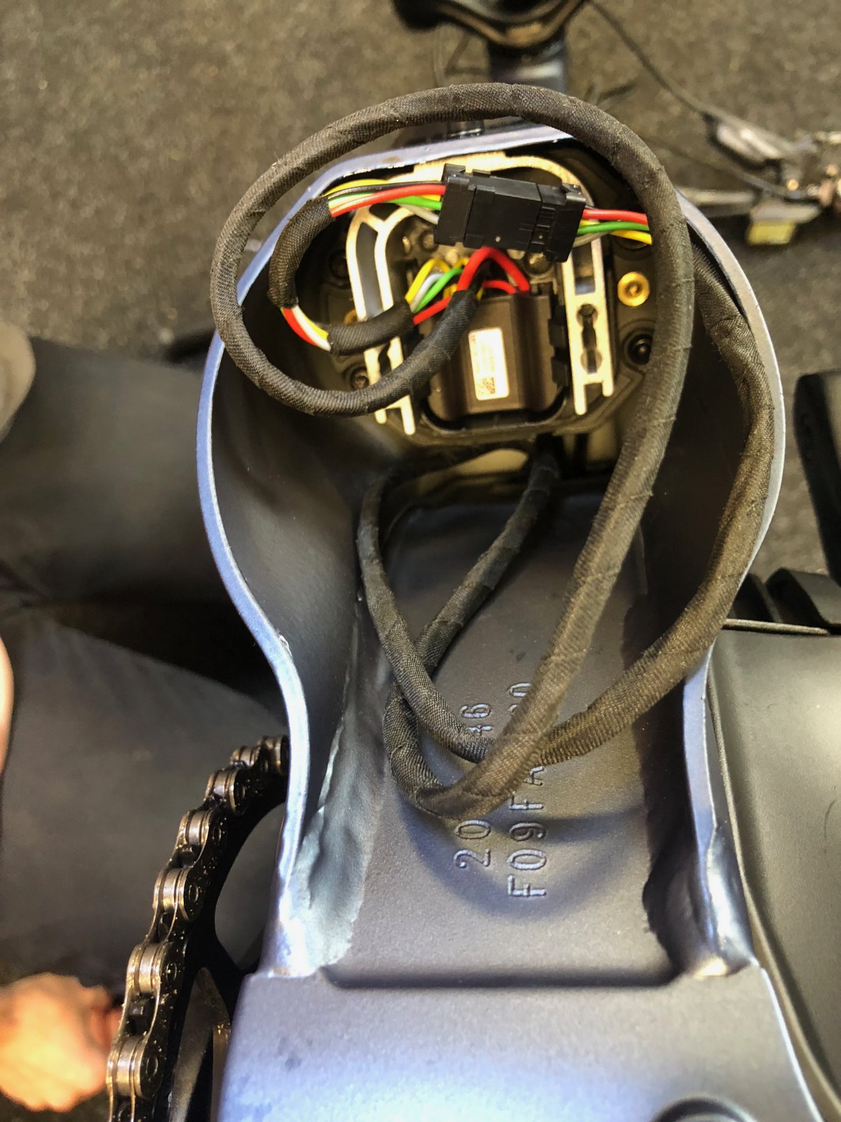

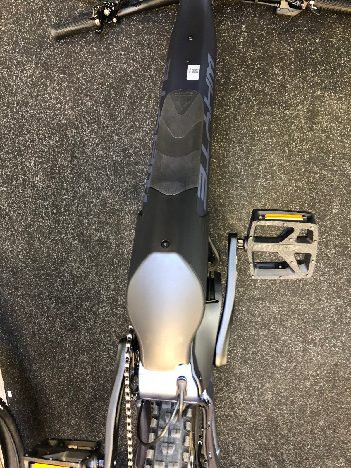

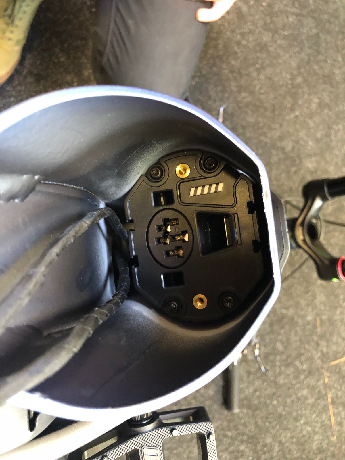

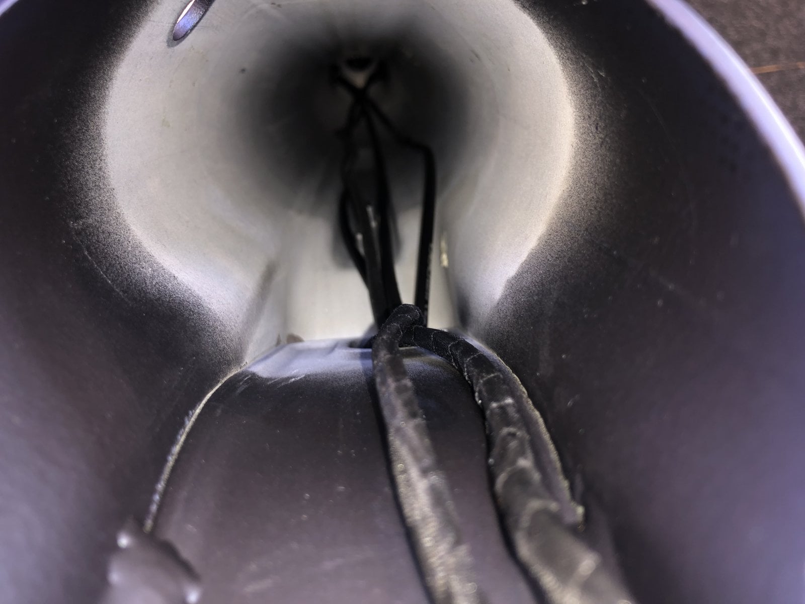

The main point I would make about the bike, is that whilst you can remove the battery, the bike is not designed to do this on a regular basis - this is definitely a bike where you are going to want to be able to charge it where you keep it. it is a PITA to take it out, and probably a 5 - 10 minute job if you want to do it properly with risking damaging any cabling.
Firstly although you probably can take the battery out with the bike turned upside down, I couldn't, because there is no way to pull it out without IMO risking damaging the connectors and wiring, and we had to flip the bike onto its back wheel to get the battery to slide out one I had disconnected the wiring.
Ideally you would put it on a workstand, remove the bash guard, which is held I place with a bolt, then you have to remove another bolt under that which releases the "cap" which holds the battery in the down tube, but also connects the battery to the motor cables. You then have to move this out of the way and slide the battery out. The bolt at the top of the downtube merely holds the top of the battery in place, preventing it sliding too far up the down tube.
The cabling from the motor to battery, and the whole assembly of the battery holder etc in the downtube is designed in such a way that it is clearly not meant to be removed on a regular basis, and I would be worried about damaging this wiring by removing the battery too often. You also have to ensure that all the internal routing it clear of the battery when you put it back in, as unless its in the channel on the top of the downtube it gets in the way.
Anyway from my brief ride I would say definitely a welcome addition to the EMTB market, not a bike for anyone who needs to remove the battery easily/regularly, and I cant wait to take one for a proper ride as it was a bike that encourage you to play around on, and I suspect will be a proper weapon on the trails.
Great write up and heads up buddy?
Yeah seconded, cheers for taking the time to write up (y)
I can see what you mean about the battery removal, looks a PITA. :( Not a job I’d want to be doing in a muddy car park at night.
