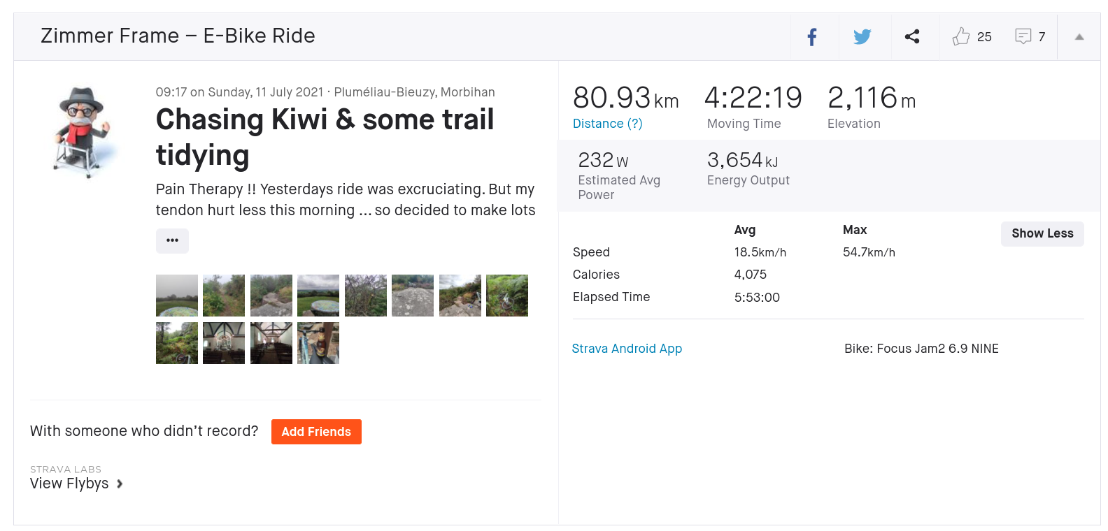

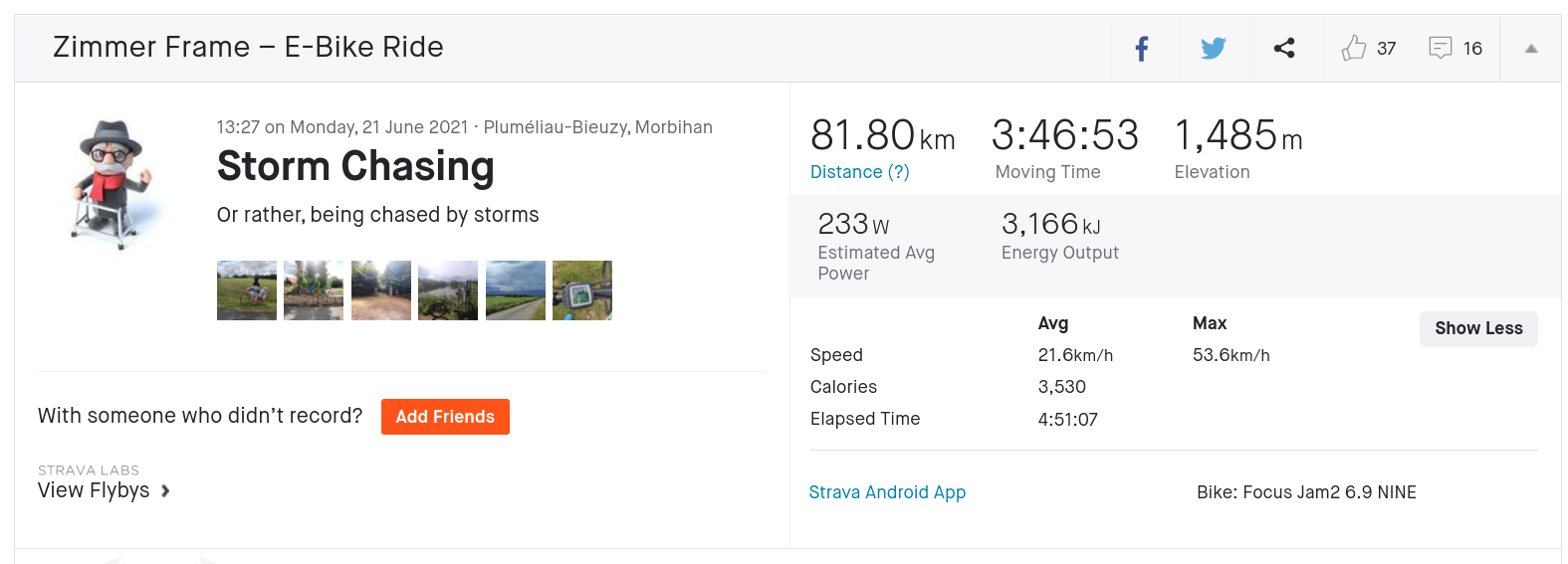

Hang on, did these special Magic ‘notmarybutZimmer’ tyres have kinetic energy generation going on?? Dear lord you don’t use that satanic eco do you, blasphemy!
Don't yours have that ? the cables can be a pig to unwind after a ride, but it's worth it.
The first one was EMTB only and was ridden to flat.
The second one was mixed mode and still had 12-17k left depending what mode you put it in - I guess maybe another 300 meters climb - but I had nothing left in me. I think for most rides EMTB mode is perfect and just leave it in it.
81km is mega!! To do this in EMTB mode is pretty cool also
