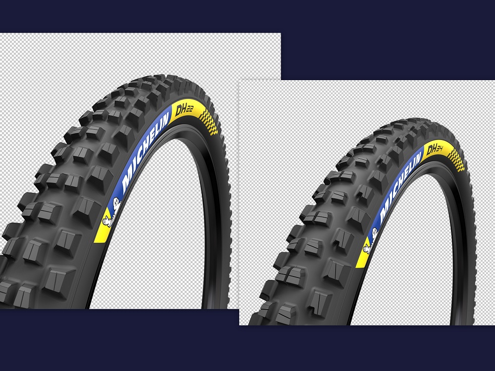

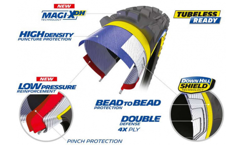

I love to talk about tires, and I have to change!
I want a pair that we forget (tear-proof, anti-puncture) to attack as we want, or we want with peace of mind.
I had chosen Eddy Current (Or E-Wild) but to "counter" the weight as much take a thinner tire (gain in liveliness, performance)
Feedback on the DH22 / 34?
A priori it is the most reinforced tire that exists.
