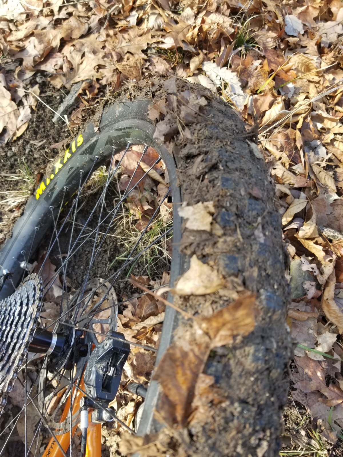

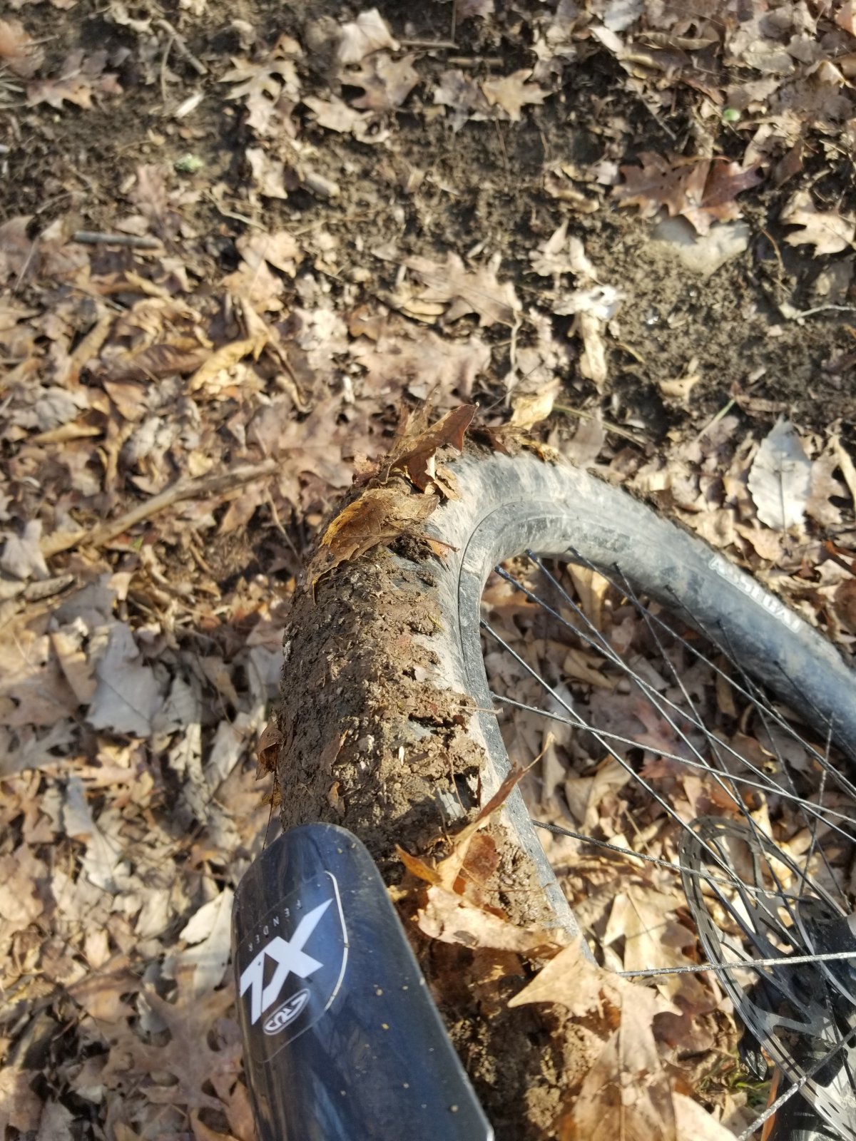

Just got my 2.5 Shorty installed -rear- and very happy with its mudabilty. I think any tire will plug up in Kentucky clay, but it grips even plugged, and cleaned out well. I was able to do some fairly technical climbs in seriously slippery wet clay. It mated well with the Assegai on the front and this combo is likely good enough for me to claim I have found a suitable setup for my winter slop fest. The bike felt balanced with neither end giving up much before the other. I found that now that I have enough rear grip to keep moving, the assegai up front cleaned out much better than when I was running the hopeless -for mud- rekon on the rear.
This is at the top of a first gear climb and while the clay is obviously happy to stick around, it couldn't stay stuck in the middle of the tire.
Here you can see the assegai didnt clean out as well, but it was still gripping enough. The assegai is better while crossing wet logs than the shorty.
Neither of these are fast rolling tires, they suck the life from the battery, and both are quite heavy... and it can be felt on the trail. In these condition's -heavy sticky clay- I'm in boost almost continuously, but I'm out there doing it daily so be it. Come summer I will be happy to shed these pigs for something lighter and faster.

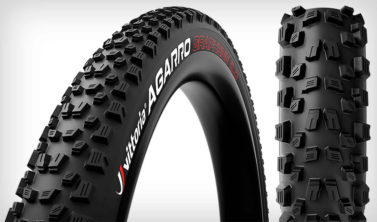

Vittoria is what i wear on my XC hardtail, great tires for that, haven’t tried any of their enduro tires, what they offer are pretty much the same draw other brands wich I’m ok with it on my ebike and I don’t want to do experiments, but now they offer the Vittoria Agarro on 27.5/29, 2.35/2.6 and it’s looks a good compromise between rolling and grip
seems good if you want to carry speed on a mixed hardpack/loose trail, for example
This looks like exactly the kind of tire I've been looking for the trails and conditions I ride. There are a couple of videos that show some pretty impressive rock crawling. Here and here. It helps that they are fairly light and can be found for a reasonable price.
