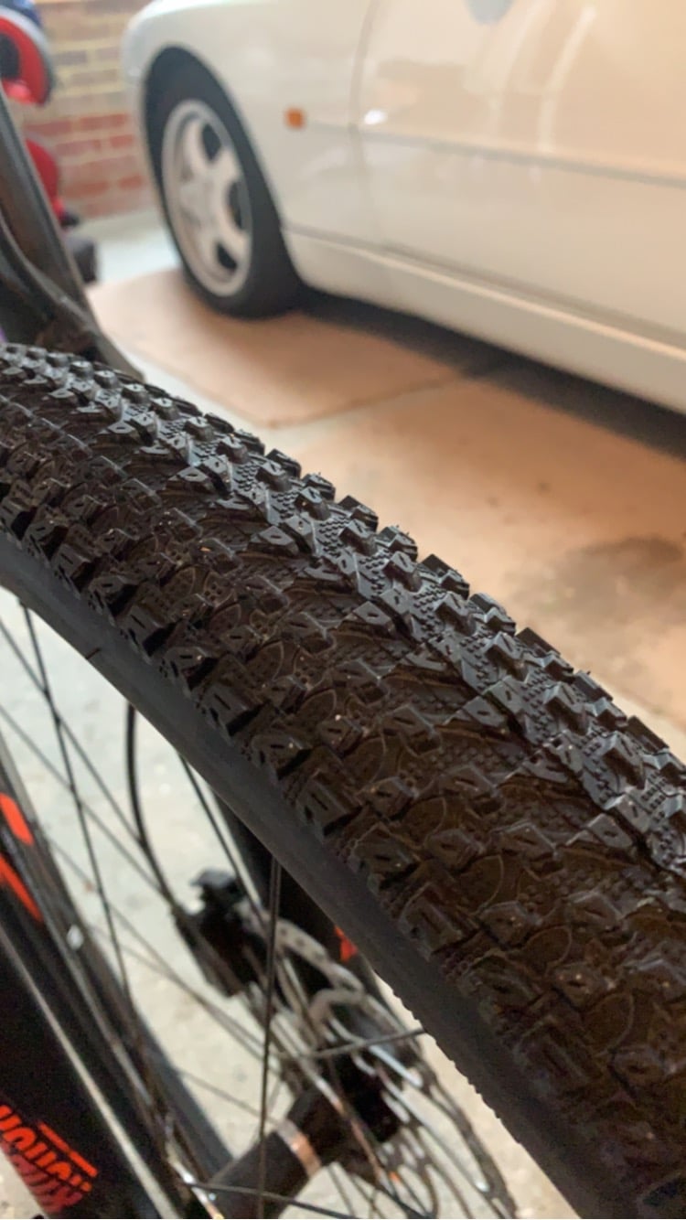

My Giant Fathom E+2 Pro came with Maxxis Forecasters, and after 6 months decided to fit tyres more suited to the tow paths, bridle ways and tracks that I frequent. Today fitted some tubeless Maxxis Pace, faster and really quiet.
