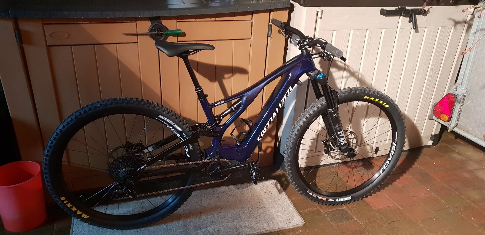

Trying a new setup - exploded my Maxxis Rekon Rear the other day on my way to the trail head passing some construction area. Nail punctured and Orange Seal could not quite seal the hole...so had to use some jerky...that work 75% so I just turned and went home. Was going to slap a boot on and call it a day until I found another nail still in the tire on the other side...same punctured tire. Not a fan of too many repairs and it was a fairly new tire.
So, today the setup is - Purgatory 2.6 Front and Maxxis Aggressor 2.5 Rear.
We'll see how this goes. I like the tread pattern of the Aggressor and looks like it should be good for grabbing the stuff we have out here on the trails.

Minnion DHF 29" 2.5 at the rear and Shorty 29" 2.5 at the front.
Testing on Sunday at the meet at Swinley.
