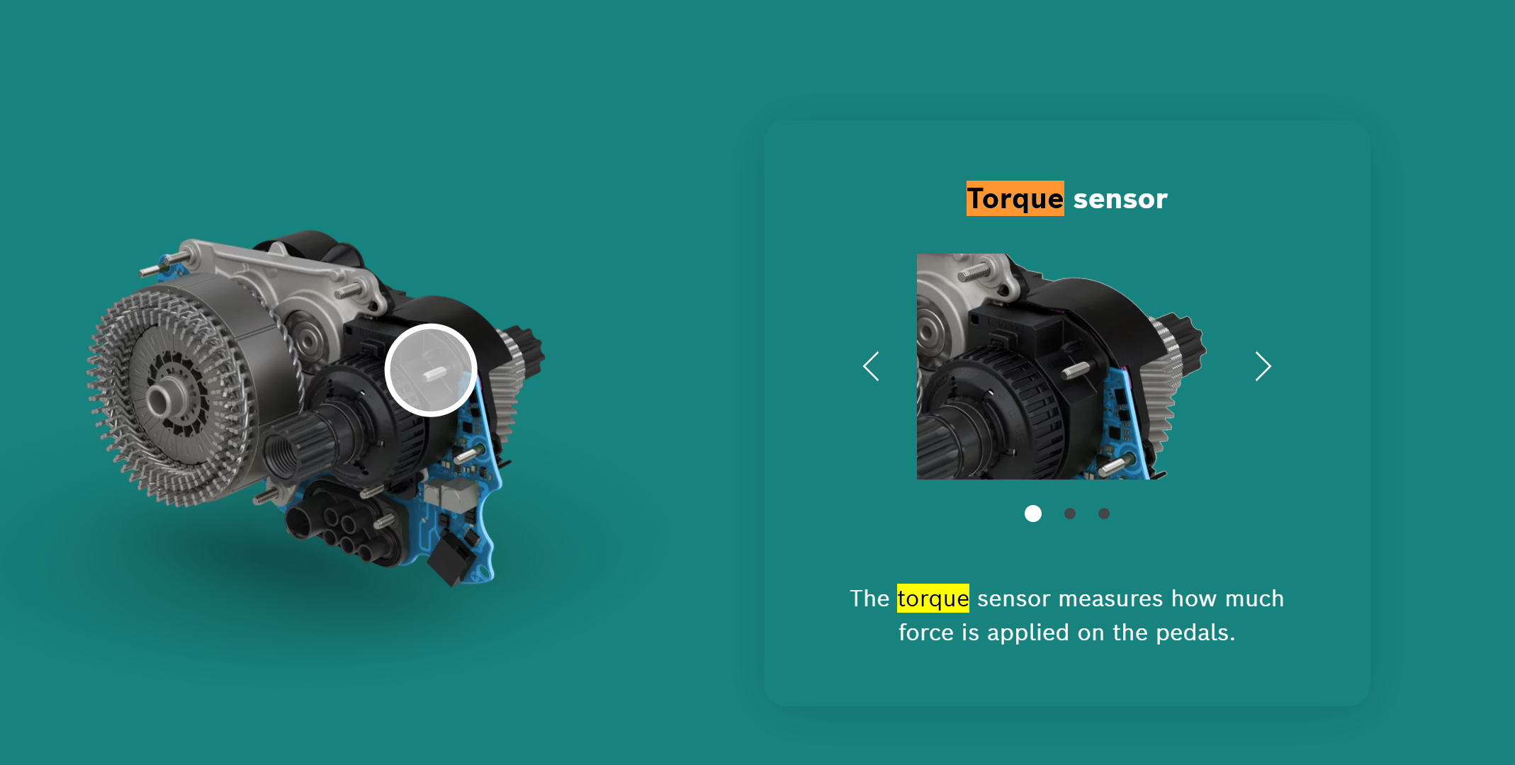

I have researched this thoroughly and the only torque sensor in the Bosch CX motor is the one measuring pedal force. This won't prevent wheelspin. I am providing documentation from Bosch to confirm.
Do you have any other documentation, regarding other Torque Sensors ? I can find none.
At the risk of playing pigeon chess with you, there’s also cadence and various MEMS sensors to detect angle and yaw moments etc.
You need to be clearer with your language, your Avinox doesn’t ’prevent’ wheel spin either, it detects it first then reduces power.
A Bosch motor does exactly the same, just doesn’t use the rear wheel ring sensor. Design and engineering choices, at the end of the day, and I know it does it because I ride a Bosch (amongst others).
So no Torque sensors in the motor to detect wheel slip. Just the one to detect rider torque on the pedals.
Look. In all honesty. I suggest you do like Steve and ride an Amflow on uneven or slippy terrain. Like him, I noticed a big difference. I rode the Merida E160 SL 6000 on the test day 99bikes had, just before buying the Amflow. It had the Bosch SX motor. Whilst smoother than my Shimano EP801, and I bought the Merida with the EP801. The Avinox Motor was noticeably better in power delivery than the Bosch.
But I agree that the Bosch performed well. But not well enough to try and talk Steve out of the Amflow.
The torque sensor is a key part of the slip detection, it detects the sudden lightening of torque input as the wheel slips and the software cuts power to the motor. The same way a rider would do it on an analogue bike actually.
I’ve ridden an Amflow, not as extensively as you have, and I’m sure it works brilliantly, but then so do other motor systems.
My Shimano is probably the worst at it than anything else I’ve ridden, not surprising given how long ago it was designed.
Wouldn't all pedal torque sensors do the same in all motor brands ? Motor output power/torque is proportional to rider input power/torque in all the big name motor systems. Normally an adjustable percentage parameter and cadence dependant. Bosch set a maximum support level of 400%.
Yes, all the motors I’d recognise as torque sensing EMTB motors would do that, they all multiply rider effort.
What’s changed over the years is the software along with MEMS sensors to detect attitude and other motion (in your Avinox as well) and importantly the processing horsepower to run it all.
