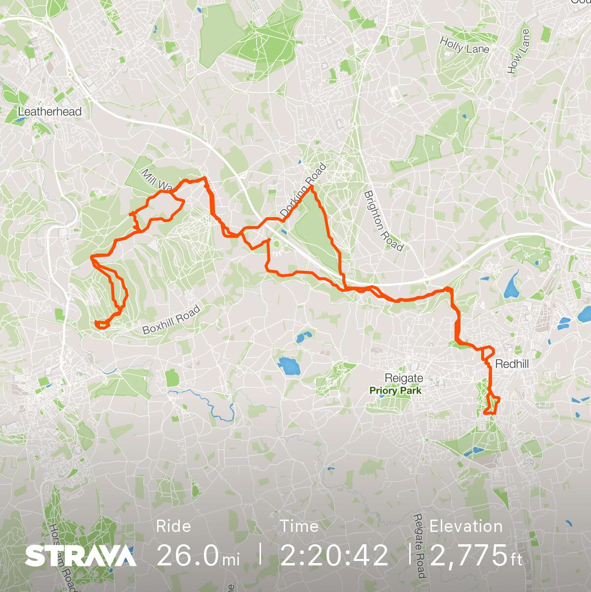

I did a 26 mile, 2800ft climb, 60-70% eco, rest in trail at weekend , with a few technical climbs and had 2 bars left, but probably about to go to one bar.

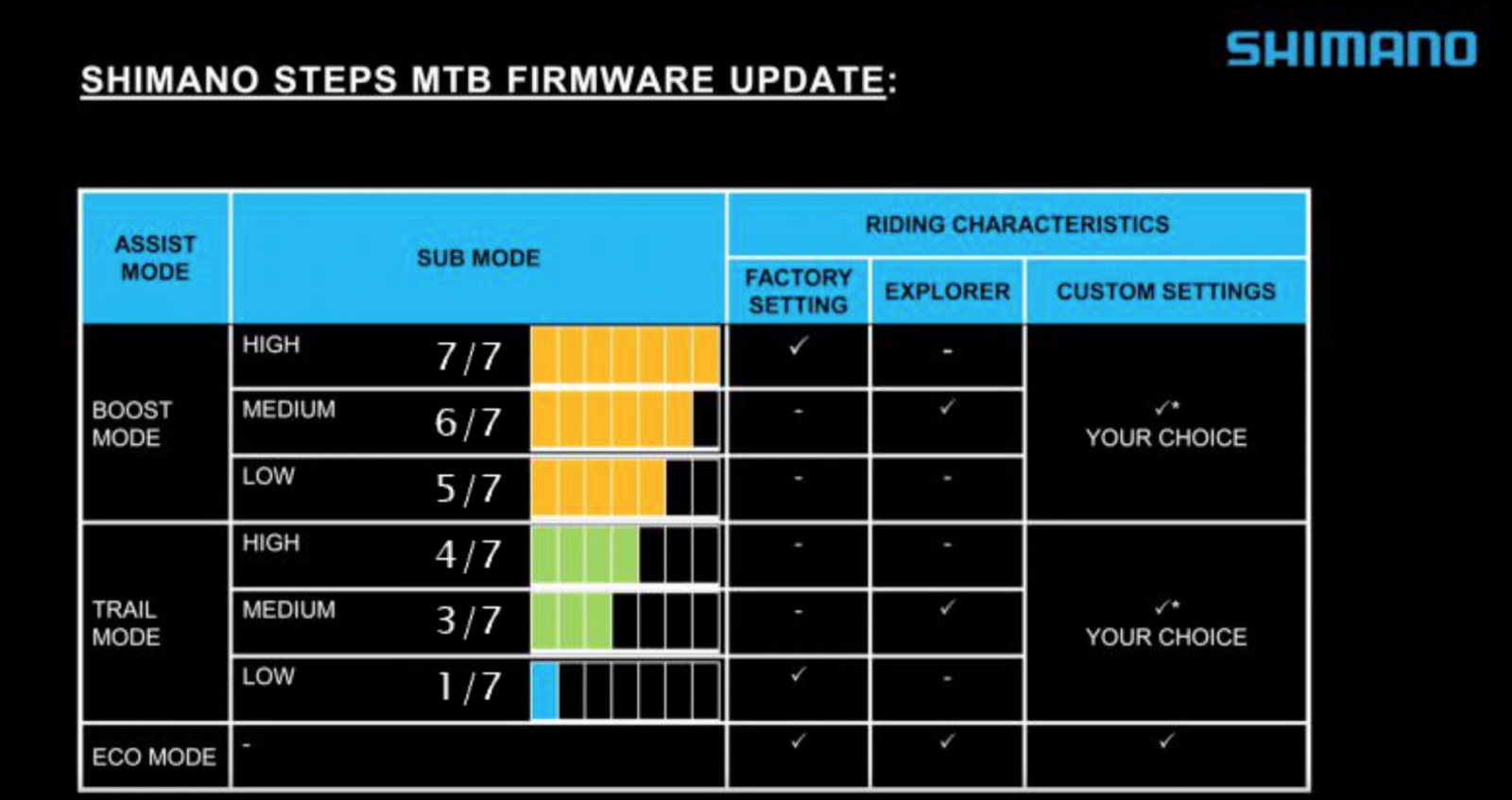

Eco is on a Shimano and non adjustable. Trail and Boost can be adjusted

So what does trail on setting 1/7 equate to in percentage terms do you think? 15%?
If that's the case I can adjust trail to be a proper eco and boost to be more like trail, but that really only gives me two effective settings.
It makes no sense for Shimano to make eco 50% and fix it there ?
In fact hold on a minute, according to that chart up there if eco is 50% then trail is more economical than eco in factory settings.....???
It just doesn't stack up that factory eco setting is 50% - would love to see a source for that bit of info....

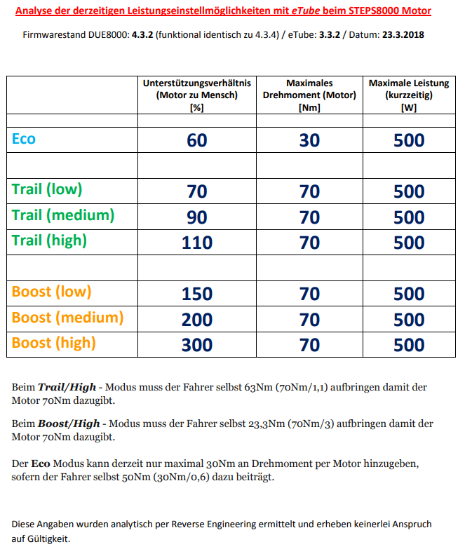

Well, that depends on how you read that chart. On my test-ride of the E8000 i got told that Eco is fixed and Trail assist starts above Eco.
Shimano isn't giving out exact numbers, but the guys from emax-tuning.com did some reverse engineering and these are the results:
Those numbers make much more sense. So it just seems than the Shimano motors just isn't capable of much more than a 30 mile hilly off road ride then.
