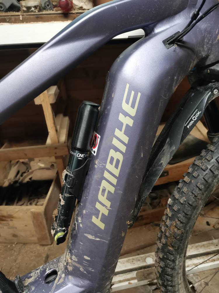

Yesterday, I installed the Oneup pump. Used the in-line mount. Put the EDC V2 tool inside the pump.
The picture was taken after my ride this morning.
Obviously, I haven't used neither the pump nor the tool much yet, but I'm sure I am going to need it from time to time.

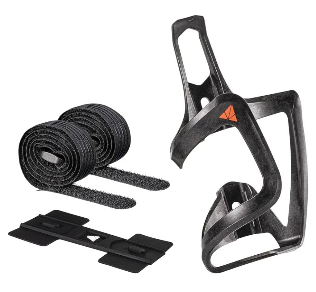

I bought the crafty a strap on
Ok so I know this could have been an easy D.I.Y but sometimes other people just make things better.
Why even bother buying it ?
The positioning of the crafty bottle mount ( underside of the top tube ) is totally inconvenient for my storage and transportation of the bike, the crafty's downtube has all the ideal space for mounting but has no mounts...
so I bought this dedicated strap on bottle holder mount which works extremely well, you get the cage supplied as it has sections for the straps to go through to hold it in place very securely.

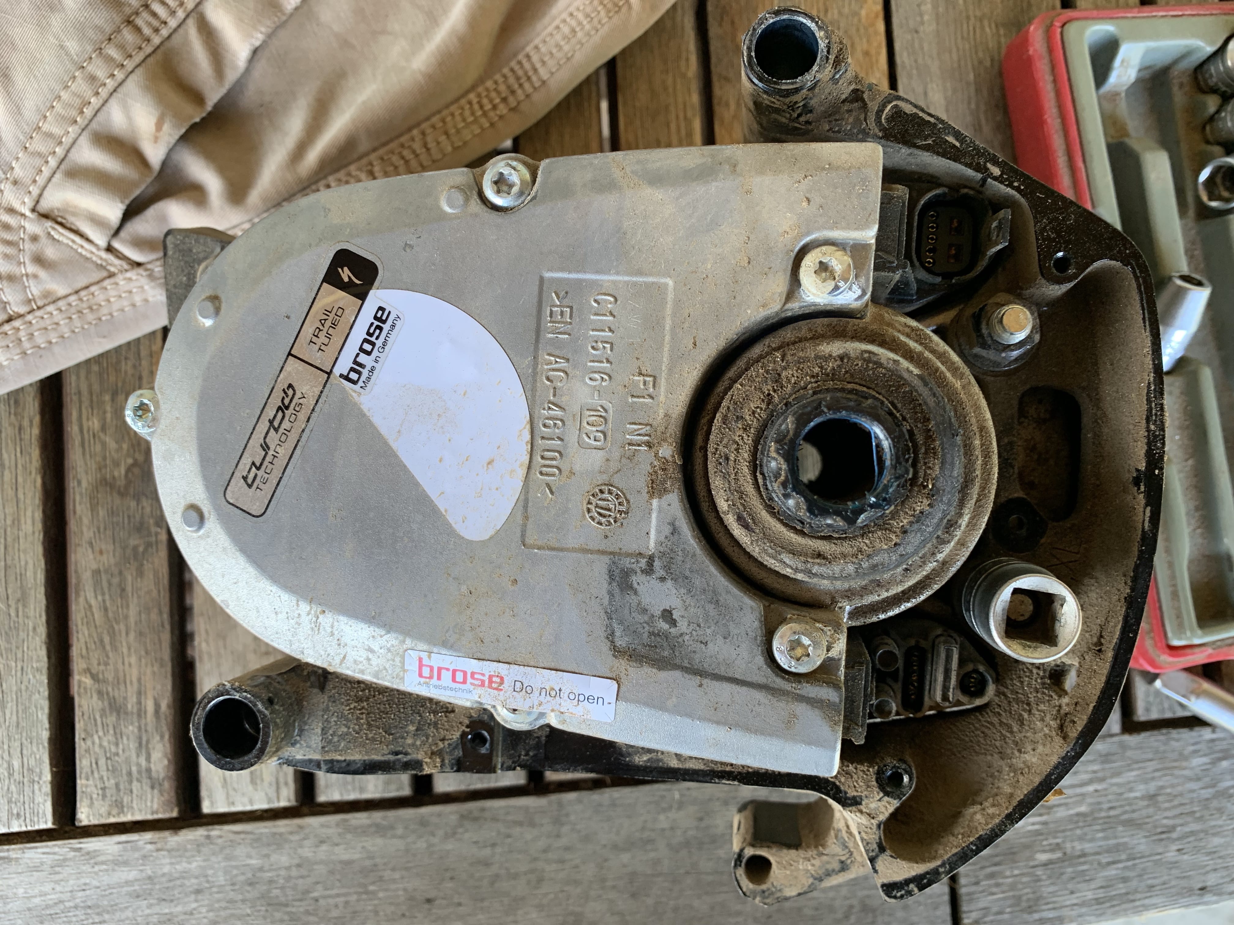

Removed the motor from my Levo, think its a problem with the sprag clutch, will be going to bearingmans french associate for the repair and upgrade.

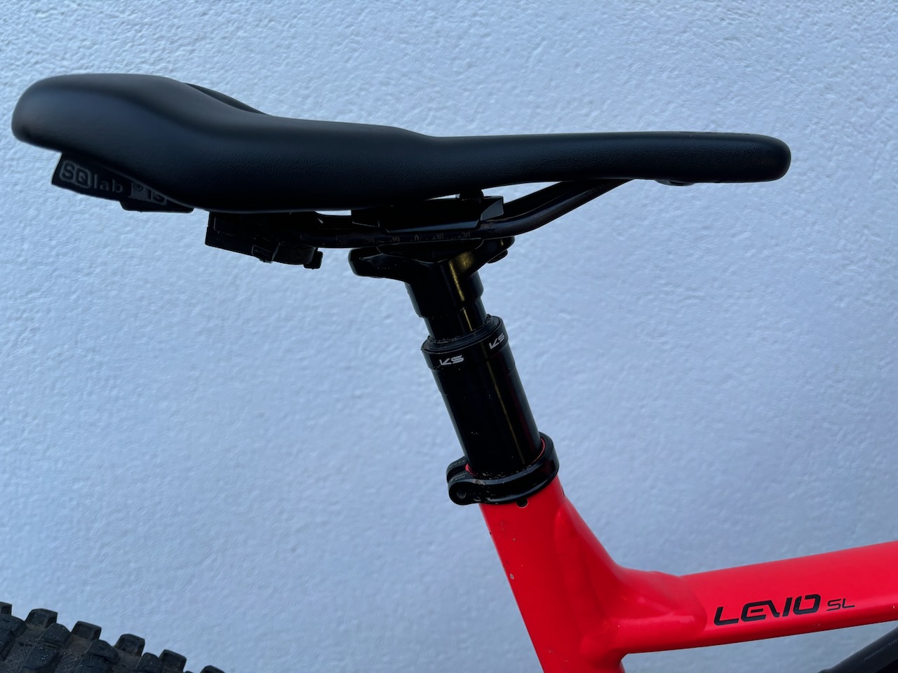

Installed a 150mm KS Rage-i dropper post as an interims-replacement for an increasingly stuck X-Fusion Manic. It's a downgrade, because the old dropper had 170 mm, but the purchase was a bargain earlier this year (~€ 25,–). Thinking about going for a One-up V3 in the future, but I don't want to spend the €€€ atm.
Install wasn't straightforward, because I didn't get the proper cable tension at first try.
And a question on that matter for others who installed a new dropper: what kind of grease do/should you use to seal the seat tube against ingress water?
I wouldn't worry about water getting down the seat tube. Between the post & the clamp, it's probably going to seal reasonably anyway & even if it doesn't, it'll run out the gaps. One useful feature of mid mount ebikes is the seat tube base is open by design. Far more likely to have dirt & water flick up from the bottom than run down from the top.

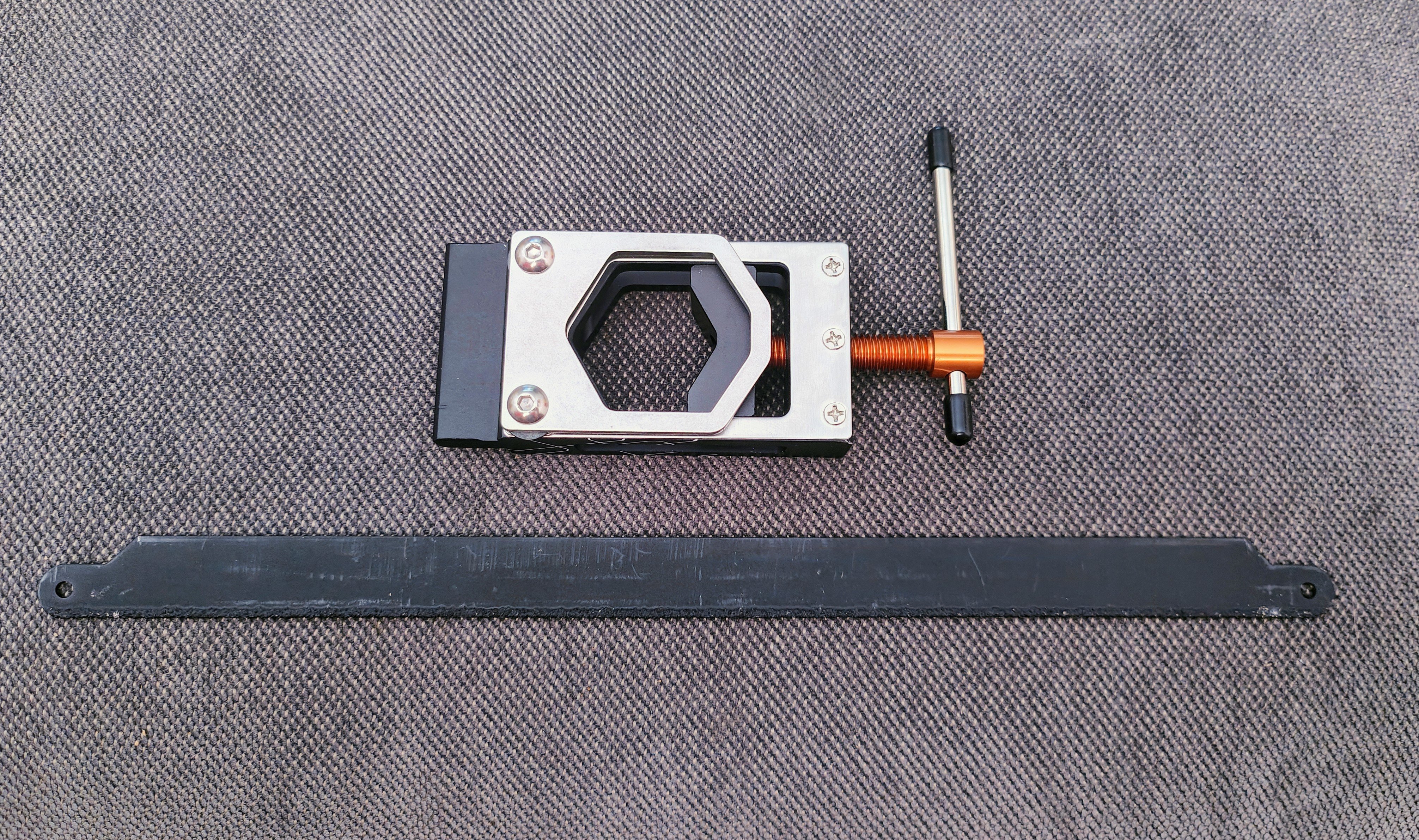

Bar and steerer cutting tool by "Toseek" and Tungsten Carbide hacksaw blade by Plastiplug. Both ebay purchases.
Cutting tool required a washer to space it put a bit as the TC blades are a bit thicker than normal.

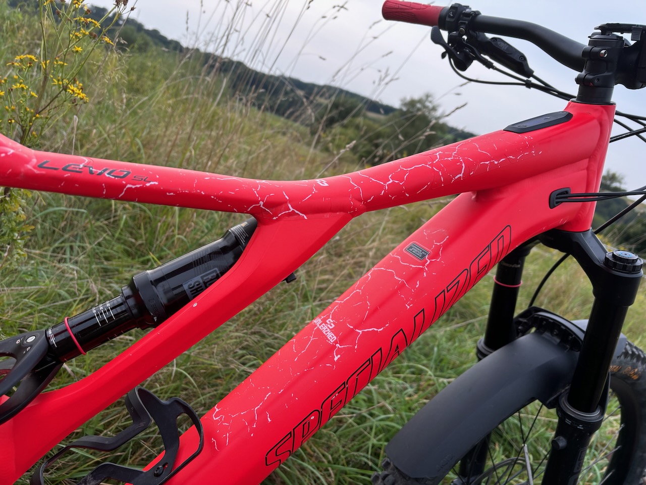

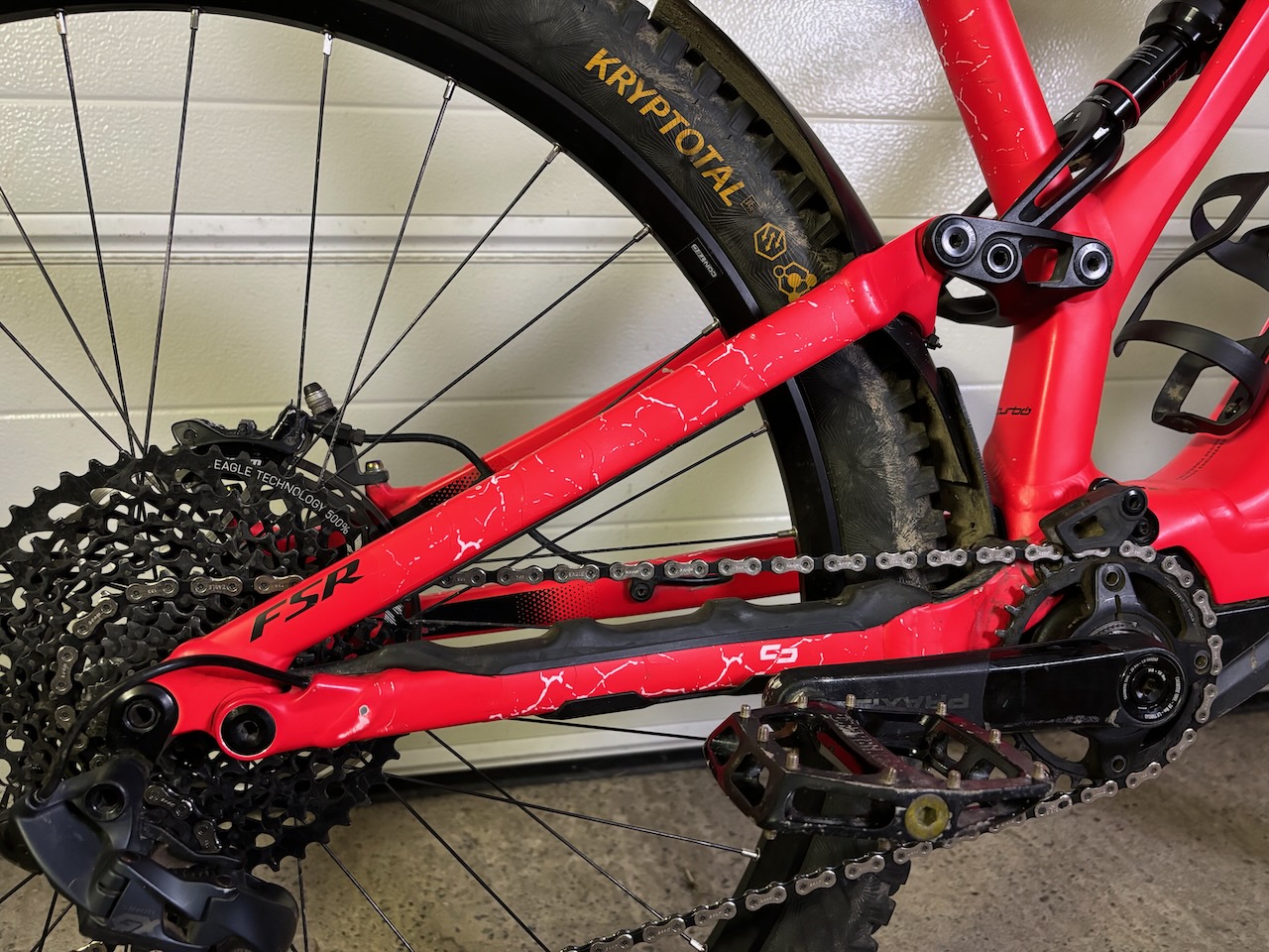

Fitted a new GX Eagle chain as the old one had reached 0.5 length over 1.500 km this summer. And finally decided to give my bike a new look and to protect the frame from further damage. Maybe a little late after 3 years, but anyway. The idea was to go for a design that helps camouflage the already existing paint chips, so Invisiframe was no option. I went for a universal frame protection foil from Unleazhed, which fitted well. Looking at the result, I might also apply them to the Levo's side arm, since I still have some stickers left.

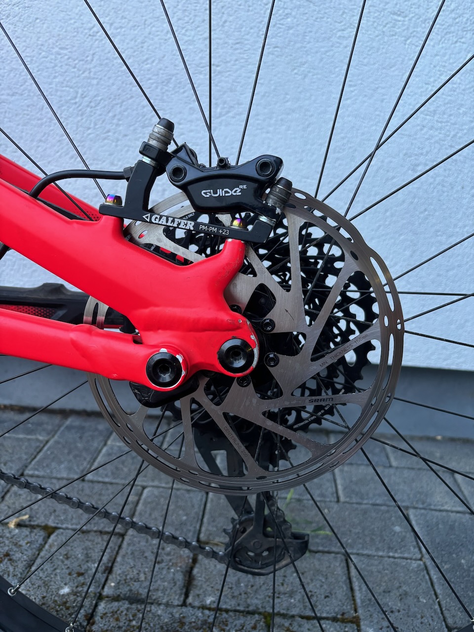

I replaced the cassette and rear brakepads for the first time, after approx 2500km. I used the same as OEM, Shimano M6100 cassette and D03S organic pads. The front pads are also soon up for a replacement.

Greased my rear wheel's spoke nipples with linseed oil (no kidding) after those spokes repeatedly getting loose. After ~2.000 km some of the spokes seemingly got loose over night.
That led me to learn the basics on wheels, spokes, tension and truing etc., I bought some tools to measure and correct my wheel's tension, but it didn't seem to help. My rear wheel still emits noises when pedaling due to the torsional forces on the spokes, and some keep losing tension. This trick is my last resort before asking my LBS (who isn't that local) to deal with it.
Anyone else have some recommendations?
