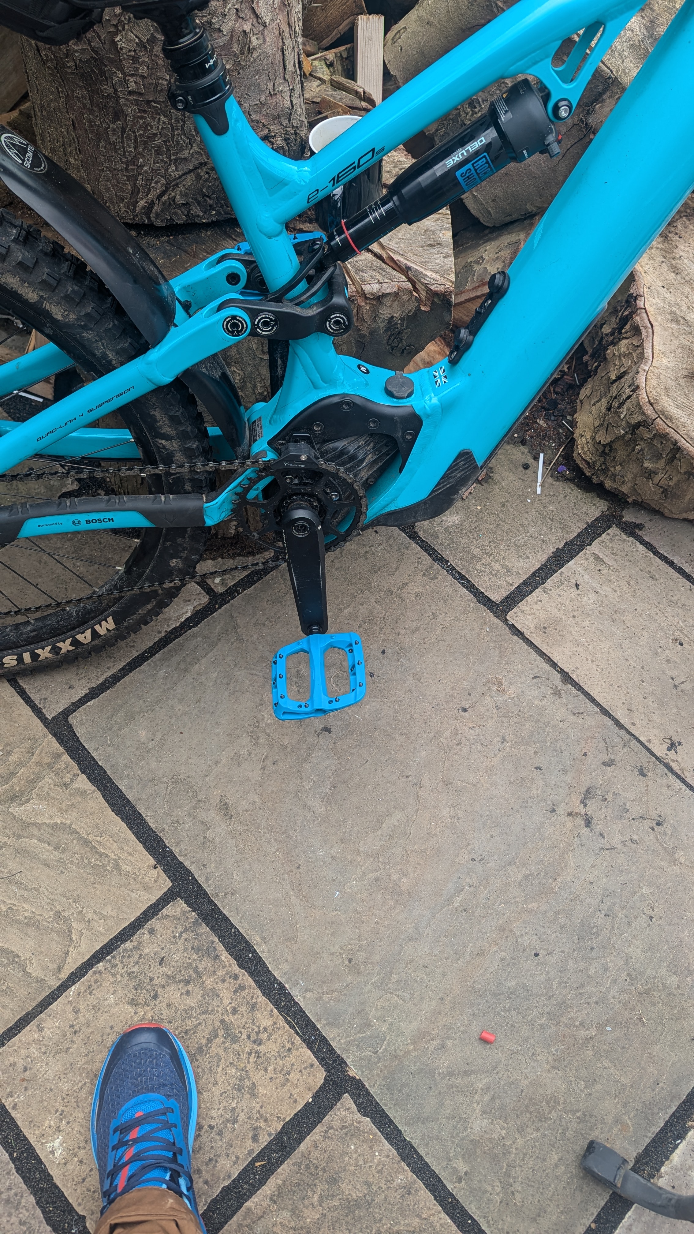

New pedals similar blue but not exact, first ride out tonight and very impressed

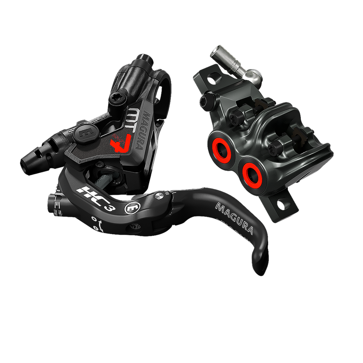

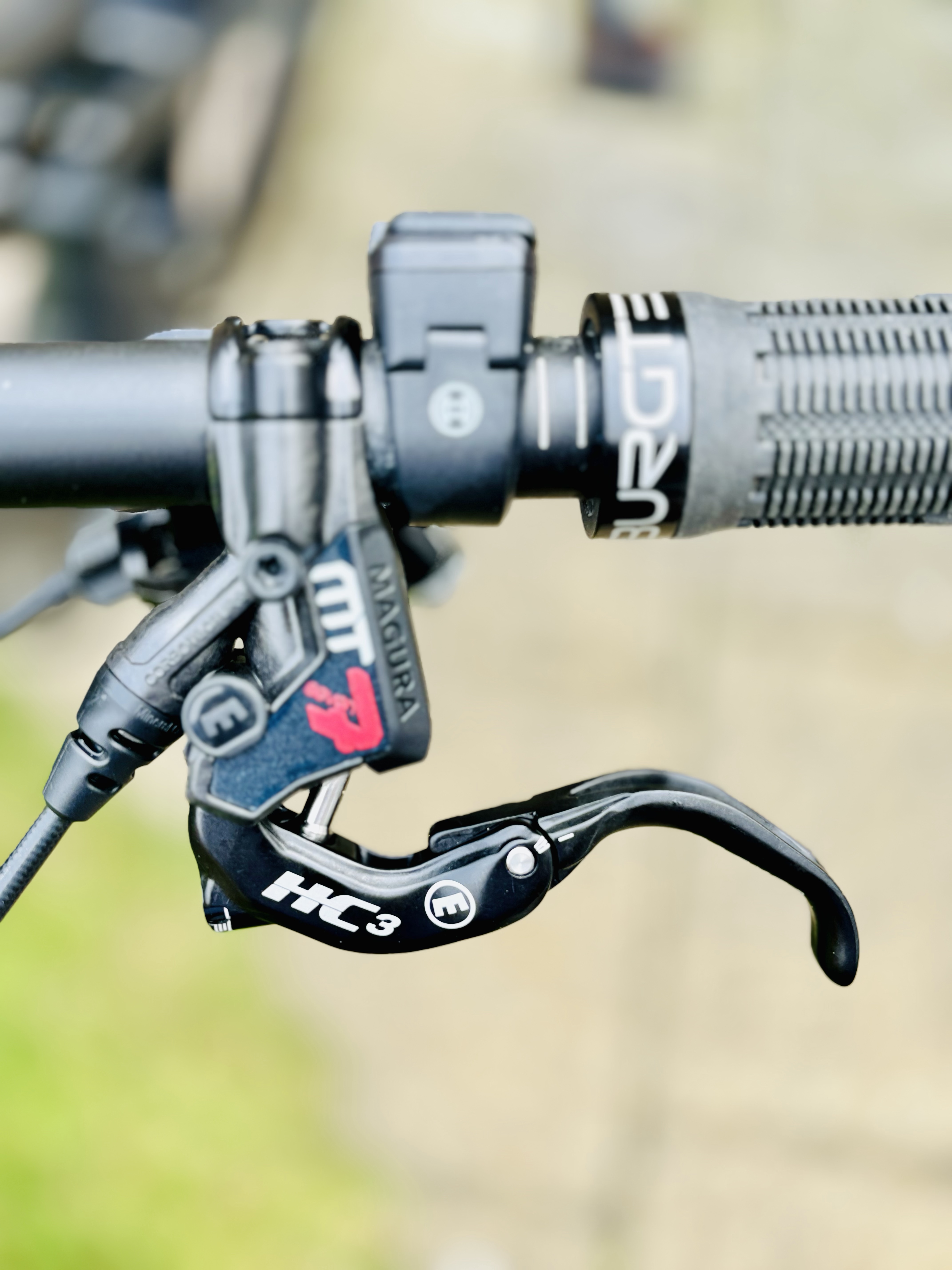

Yeah I’ve had various including RSC’s and XT’s but the Maguras just suit me perfectly. Trying the HC3 levers which are fully adjustable one finger short stubby so looking forward to them. Got a great deal from Total Bleed Solutions too who are fitting everything 👍🏽

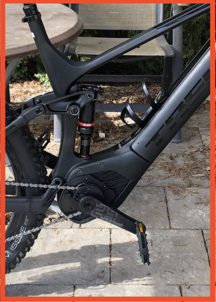

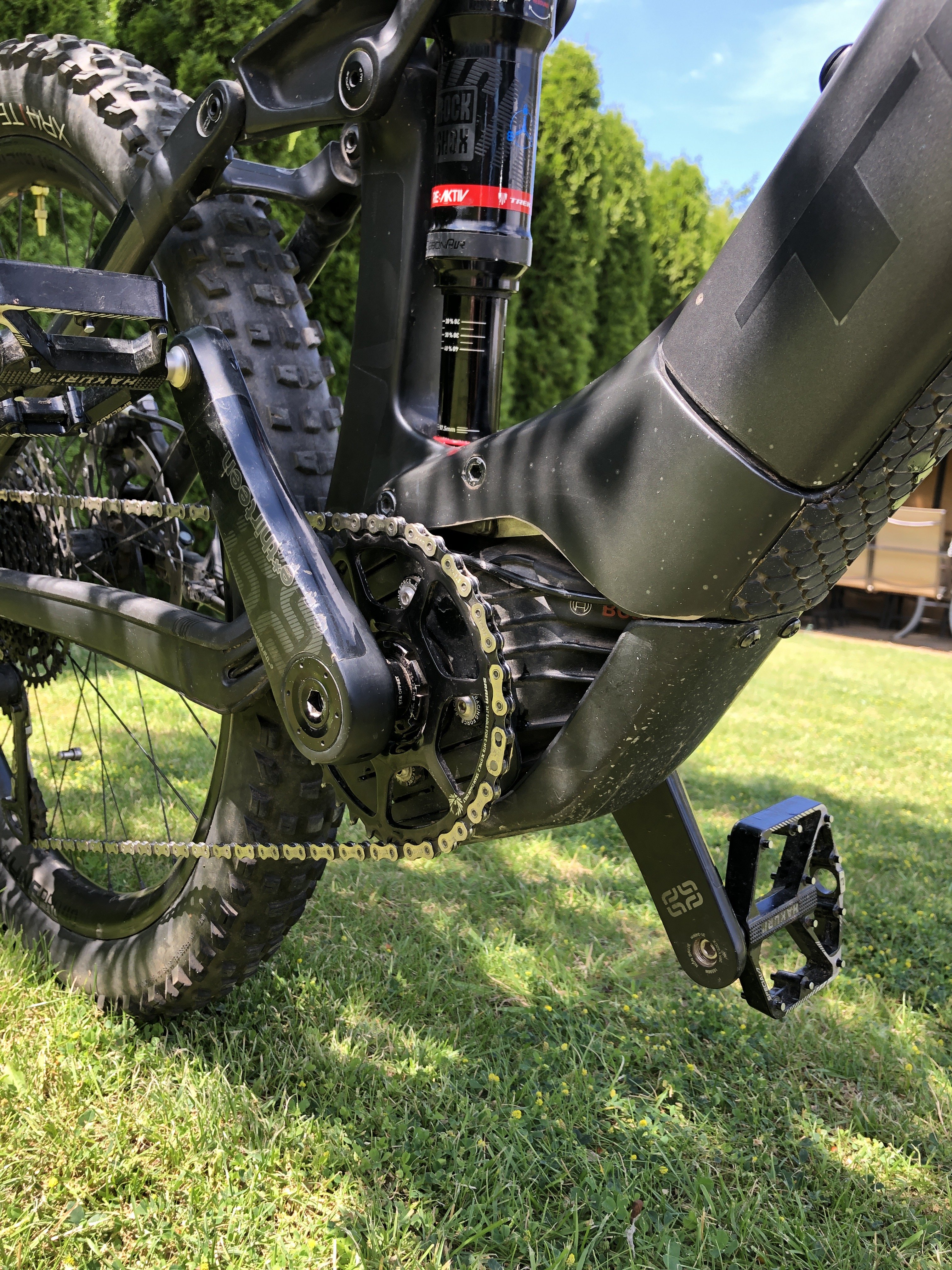

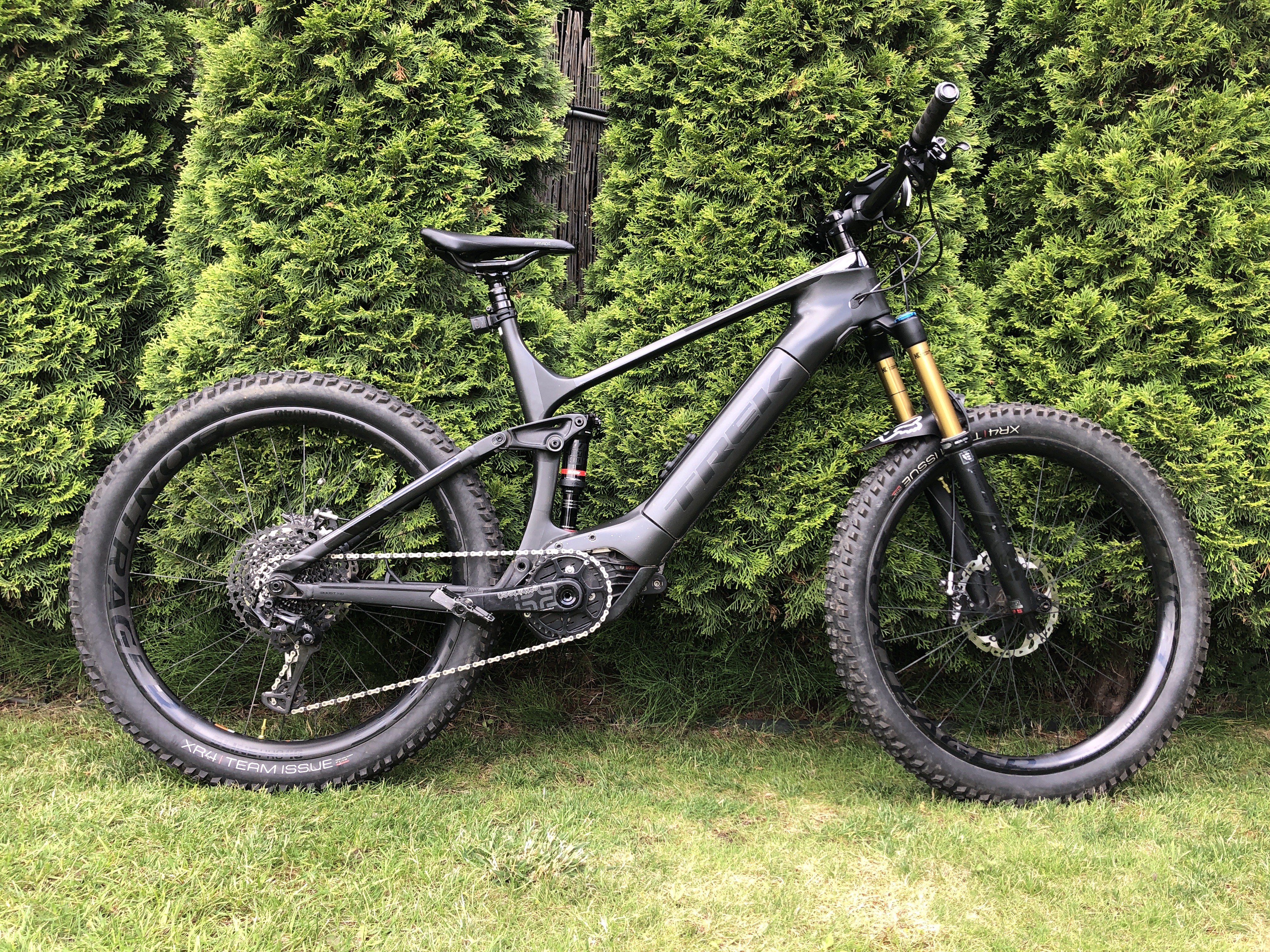

Poland

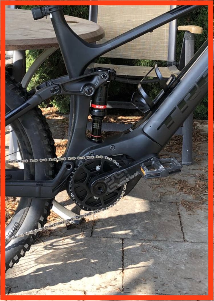

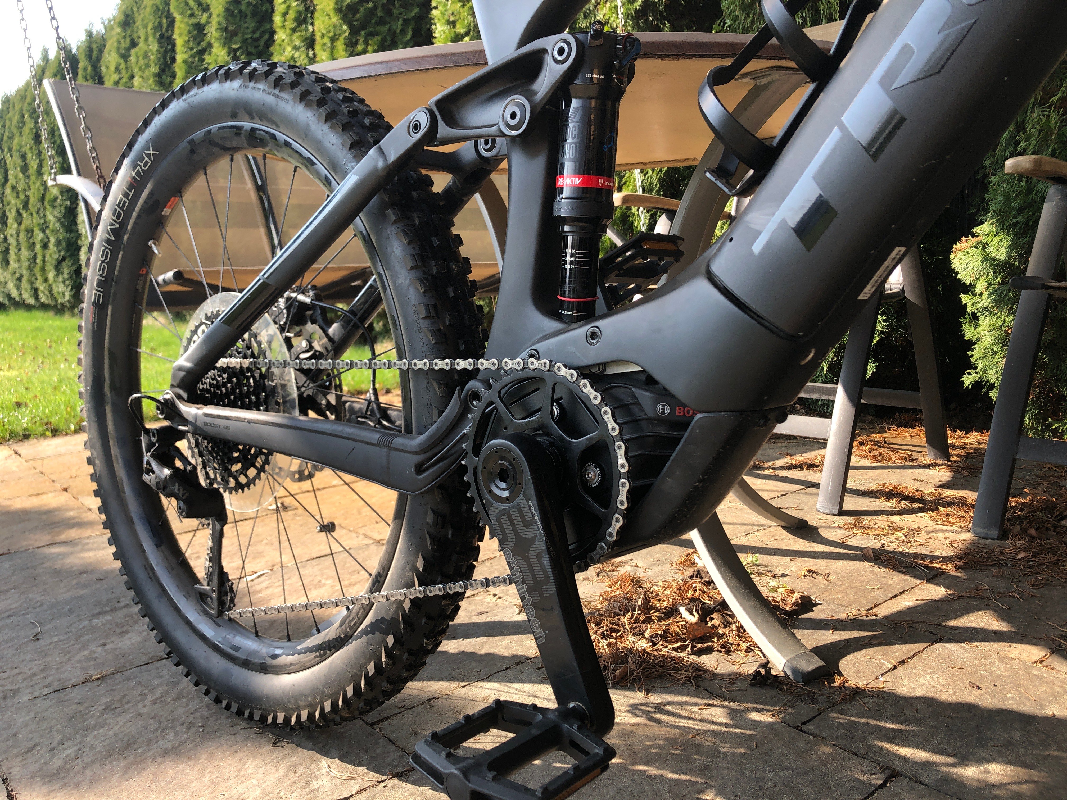

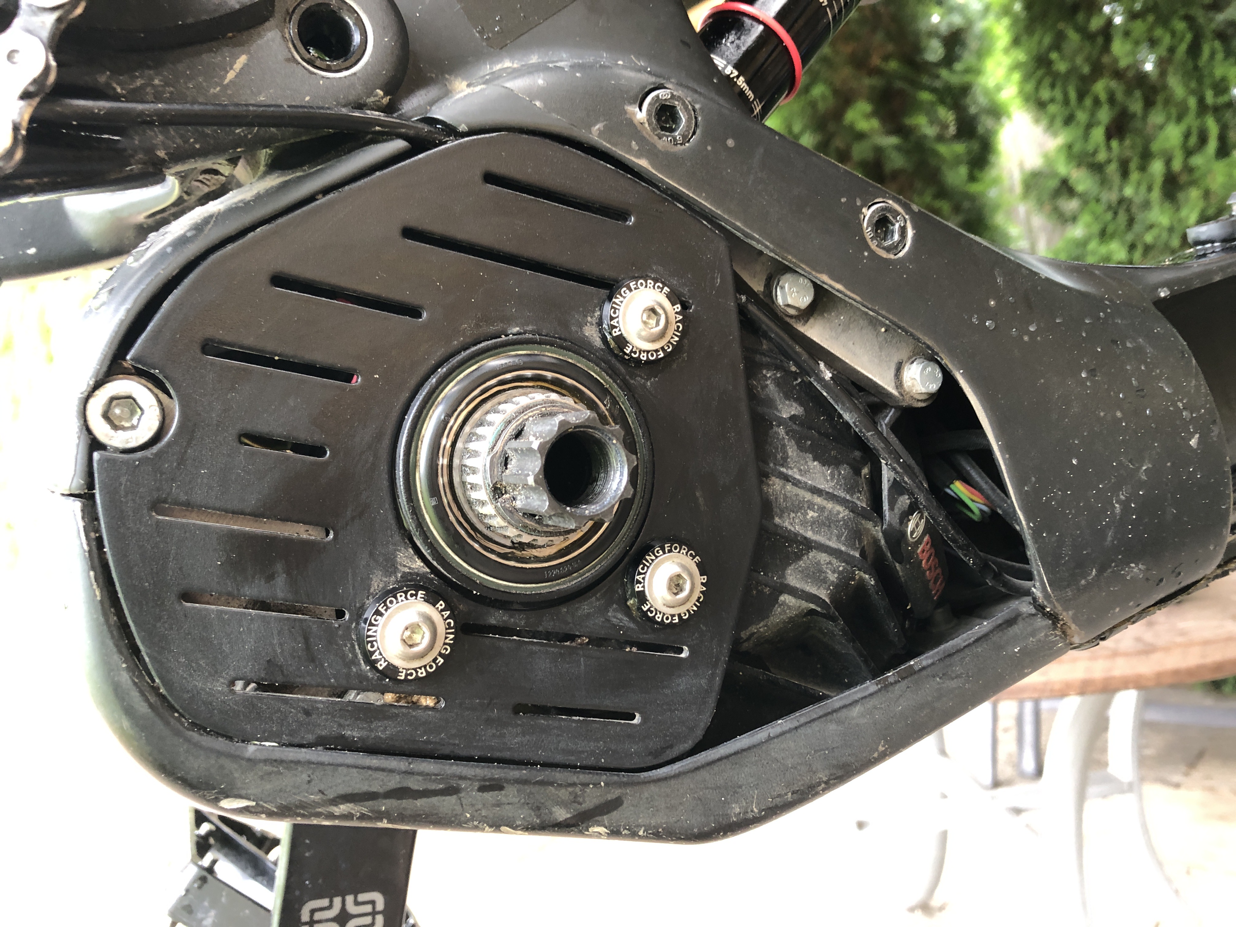

That's a sweet job buddy! 👍
How does it ride?
How long did the adaptors take you to make?
Using the same loom?
Thanks. I love my mod.
I using this over 1000km and I not plan back to original gen2. Design adapters takes me a lot of work, many mesauring and are still improving ;).
If somebody need full set to convert Trek Powerfly 9.7 or 9.9 I can organize full set - adaptors , bolts, covers.
Next is Powerfly 4 gen2. (Blue bike)
I produced 10 brand new sets - people want it. 🤘
