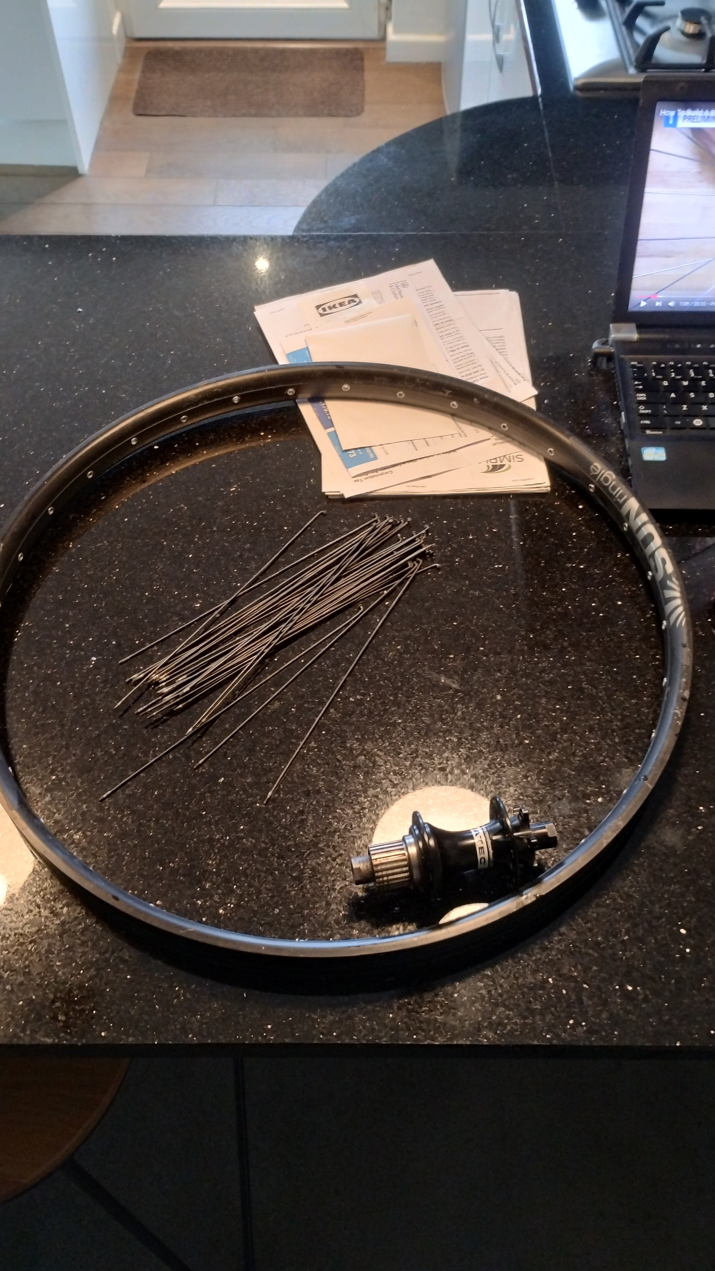

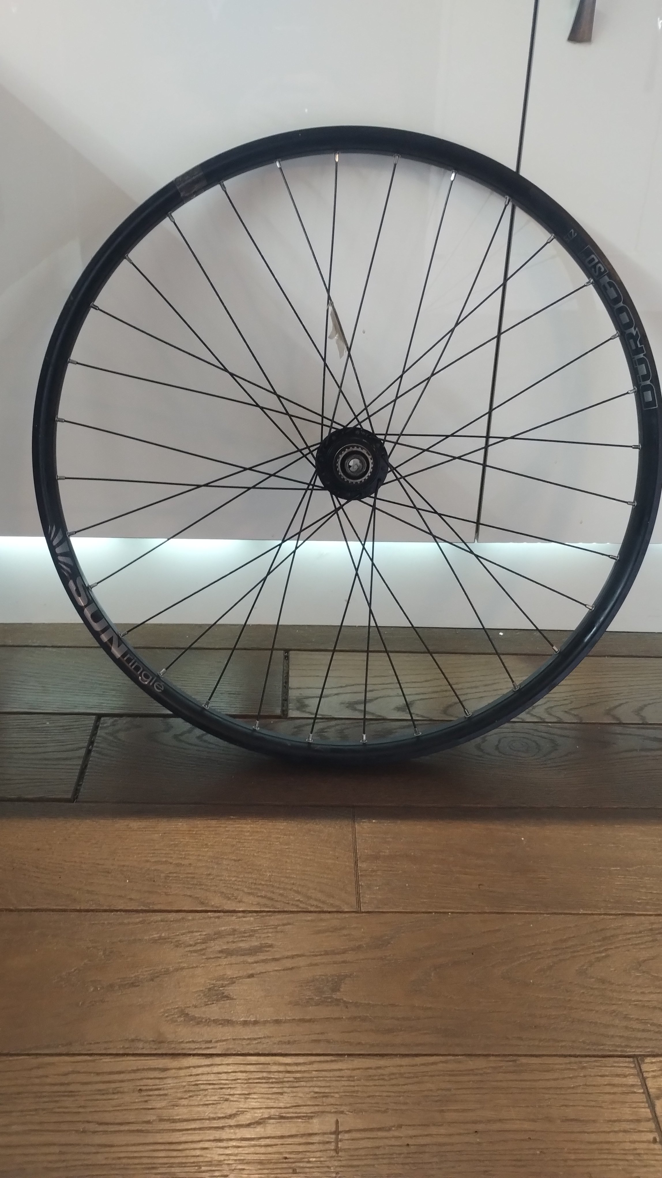

I built my first ever wheel. And it's almost round. Took the hub from my broken wheel & laced it to a spare 27.5 rim from an old bike. It's built but not tensioned or trued, more of a can I do it? than a serious thing but if I can get it right, I'll run it on the bike as a mullet & see how it goes.

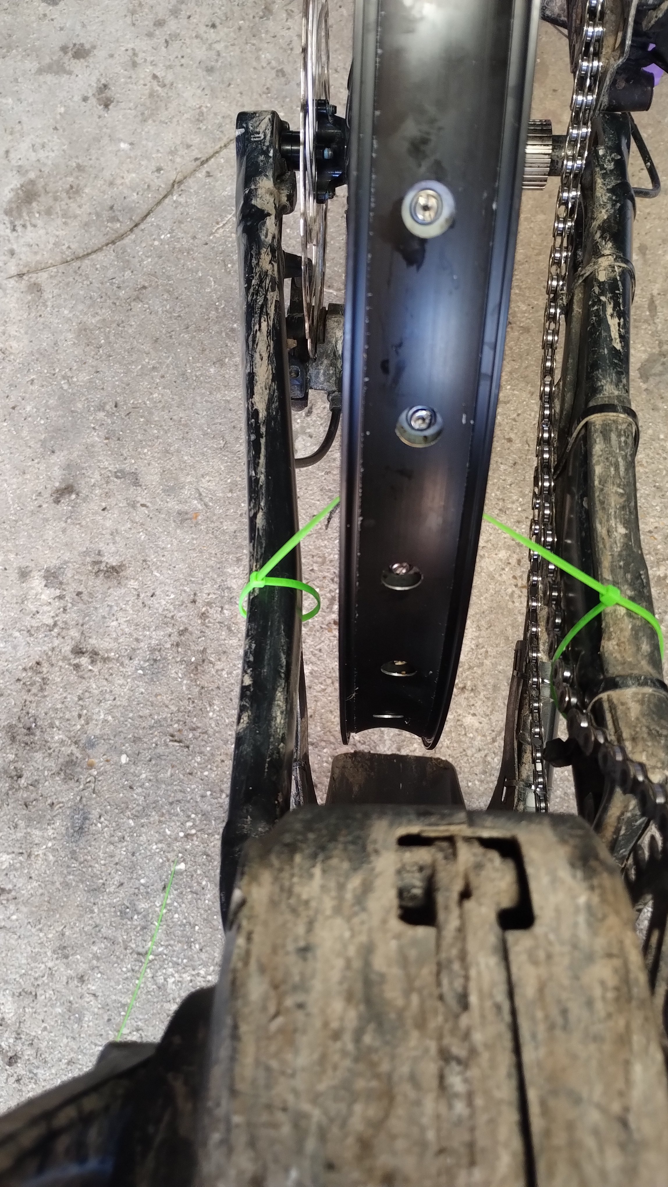

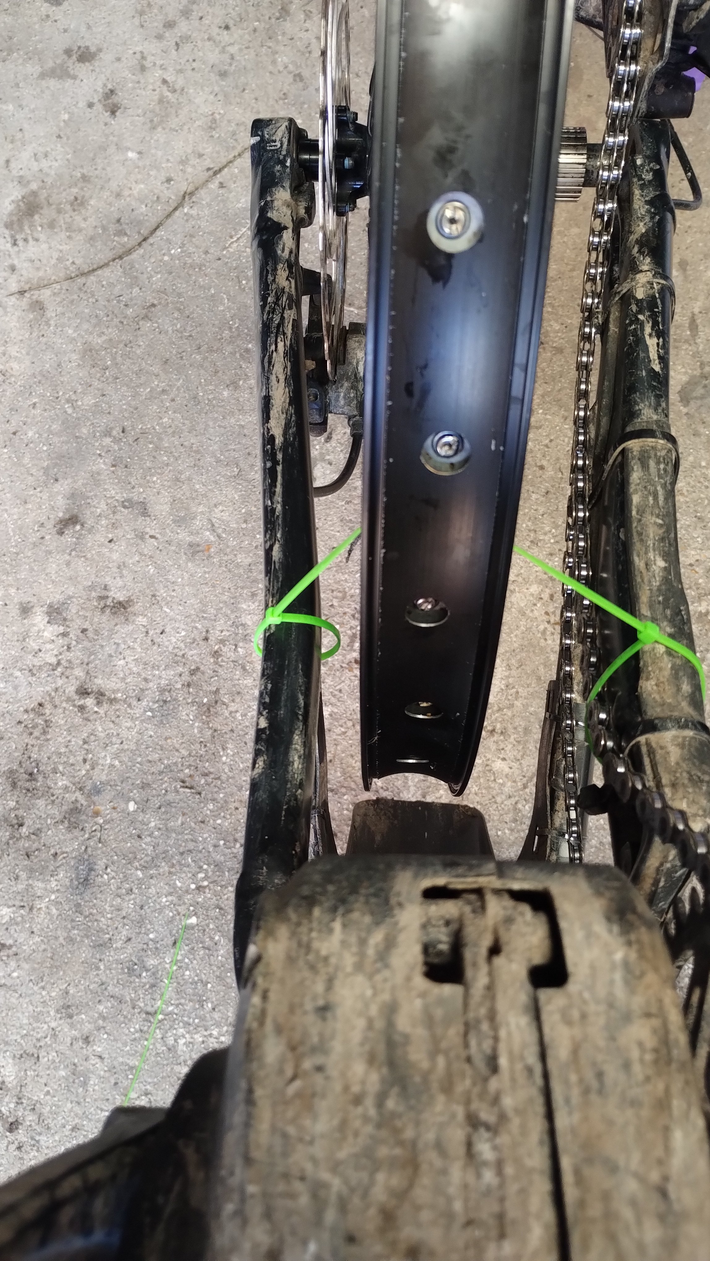

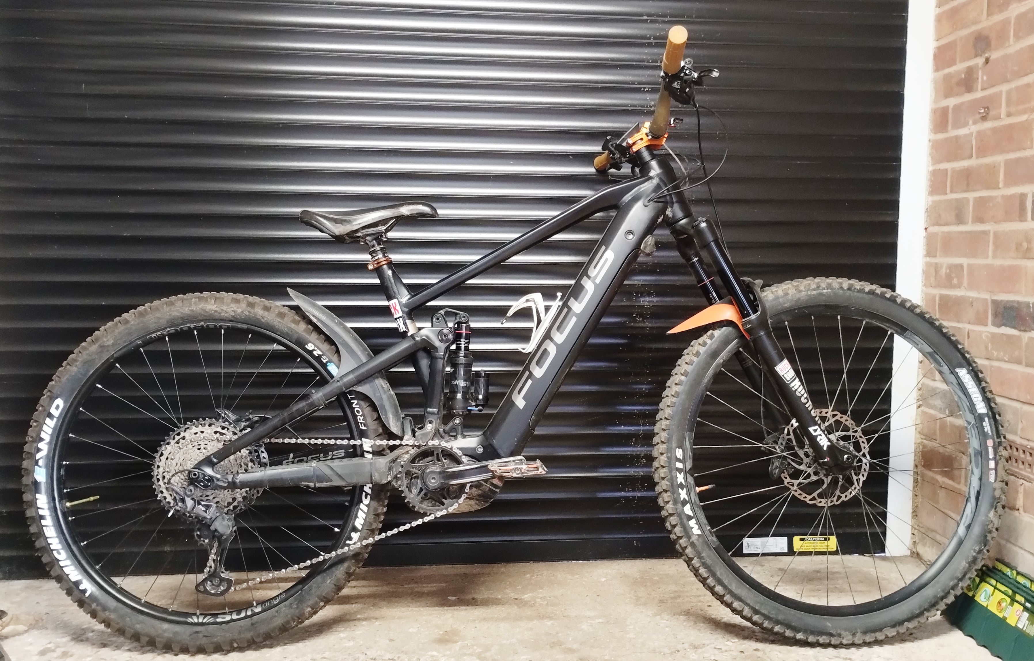

So I finished the wheel. Behold my - definitely sending this into GMBN - uber bodgey truing stand, consisting of the wheel upside down in the bike & two cable ties. Believe it or not, it trued up laterally & radially beautifully, so I put a tyre on, set it up tubeless & stuck it on the bike.
Downsides, I only have a front tyre in 27.5, so that will have to do for now, I forgot to swap the magnet over, so got a 503 error on the bike & I can't find the brake mount to use the flip chip, so it's running in the high position but otherwise, it's all good.

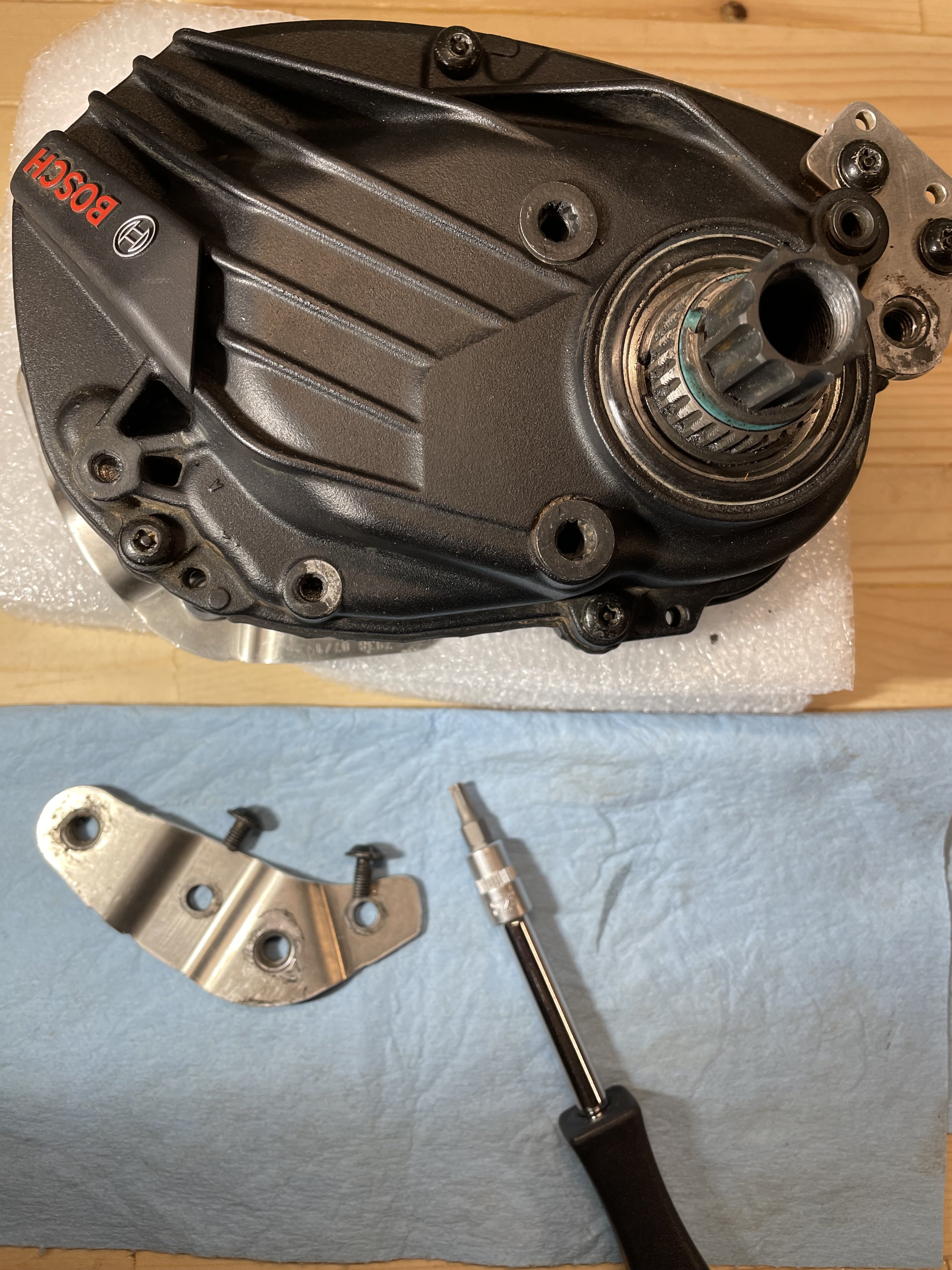

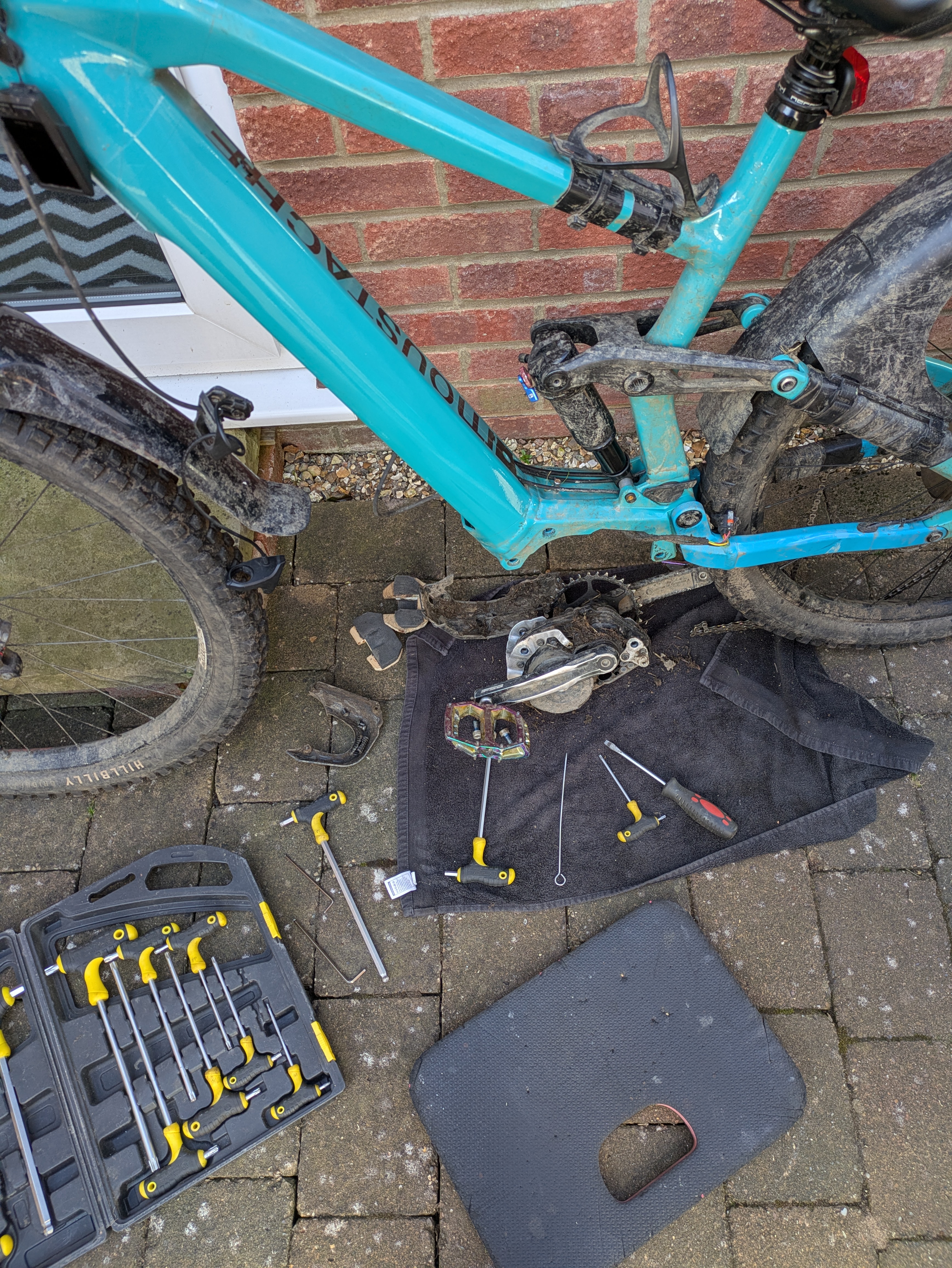

Trek rail with a creak when pedaling hard so pulled the motor to find the usual suspects 2 loose bolts holding the brackets on the bosch motor
Luckily caught it quick so no broken bolts or damage
all Bolts thread locked back in ready for more action
20mile test ride Creak gone (y)
A worthy investigation when you hear a creak like that. Any type of weird noise while peddling triggers my search for the source. Glad you caught it before anymore damage occurred.
Sometimes it’s not the cost of parts but rather the downtime …which could take months. Those brackets are notorious for coming loose and ignoring that noise or sound can be costly.
Sheared bracket bolts are almost impossible to remove from a magnesium casing. Thanks to the Motor Repair Centre a replacement cost my buddy $110. His downtime on the bike can’t be measured though.

Green cable ties. Now that is just showing off 😁

I did that when I swapped out a couple of hubs on a pair of wheels last year. Had it running lovely and true in the frame ....until I realised I hadn't set the dishing. Luckily I was watching a Berm Peak vid on YT a few days later and he made use of the ultimate home made wheel dishing jig, three tin cans of the same brand and matching height (baked beans) and I used a salmon can with a stack of washers to centralise the centre line of the hub in relation to the centre line of the rim. Worked a treat.

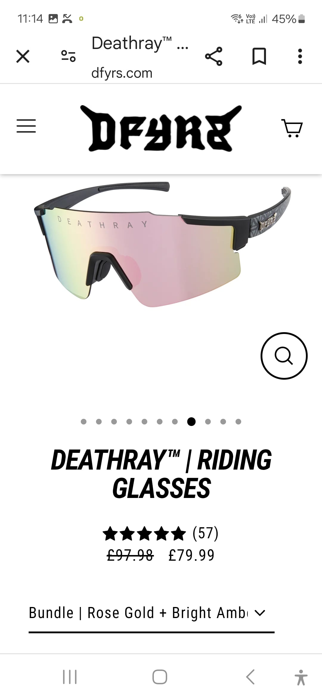

Having stopped for a snack on the outskirts of Slaley Forest yesterday I took my sunglasses off and rested them on the top of my back pack slightly inside the pack itself ..at the next gate stop I realised I'd forgotten to put them back on ..but surprise surprise they weren't there .
I simply couldn't be arsed to scour the 2miles we had covered searching for them on a dense Heather clad trail ..and a new upgrade was long overdue ..
Hopefully these will help me to avoid so many tumbles off the bike too ..😂
Being Deathray I'm looking forward to using the laser beam on any roadie Pelton I encounter while travelling in the car on our narrow country roads ..😉

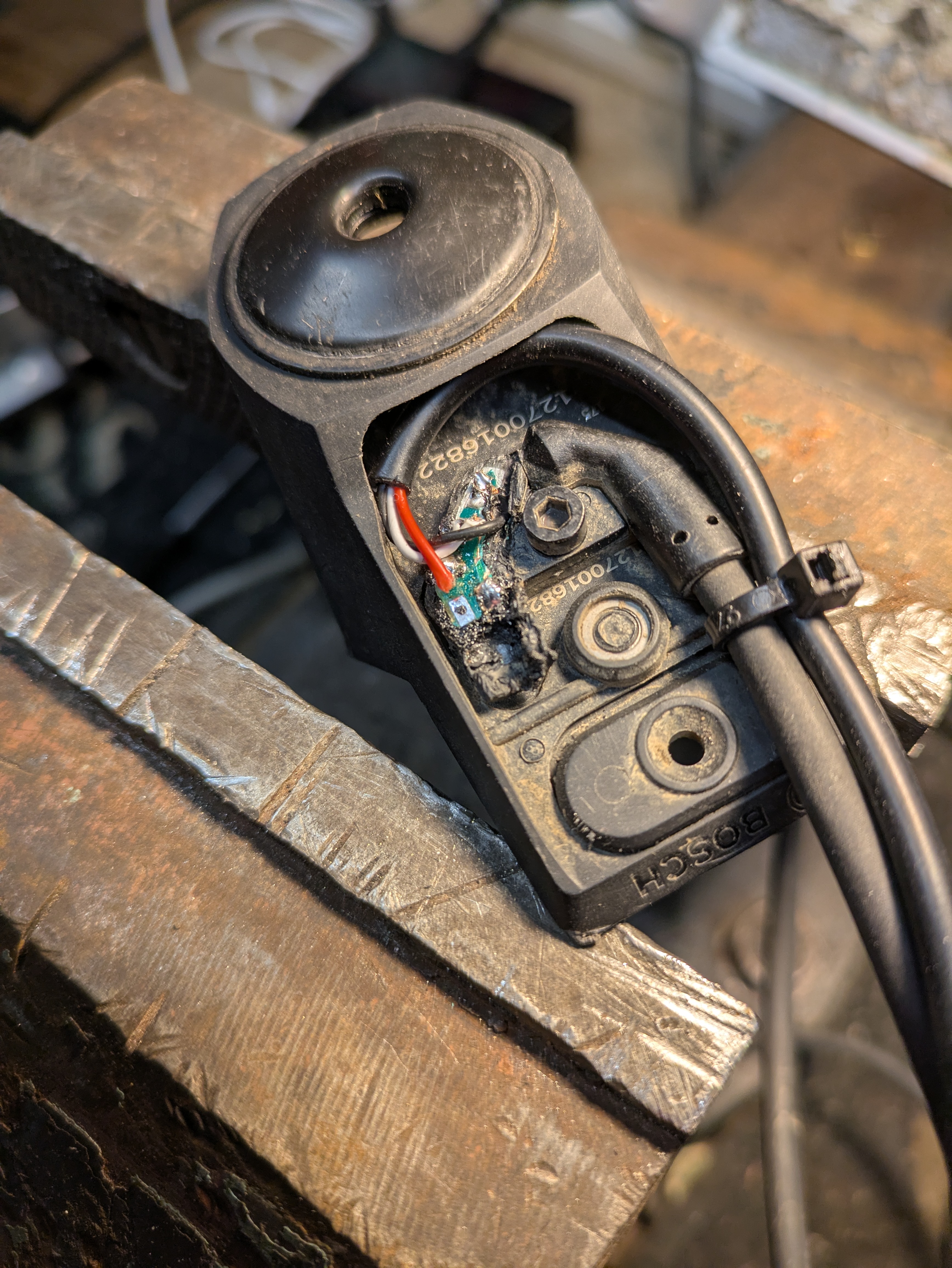

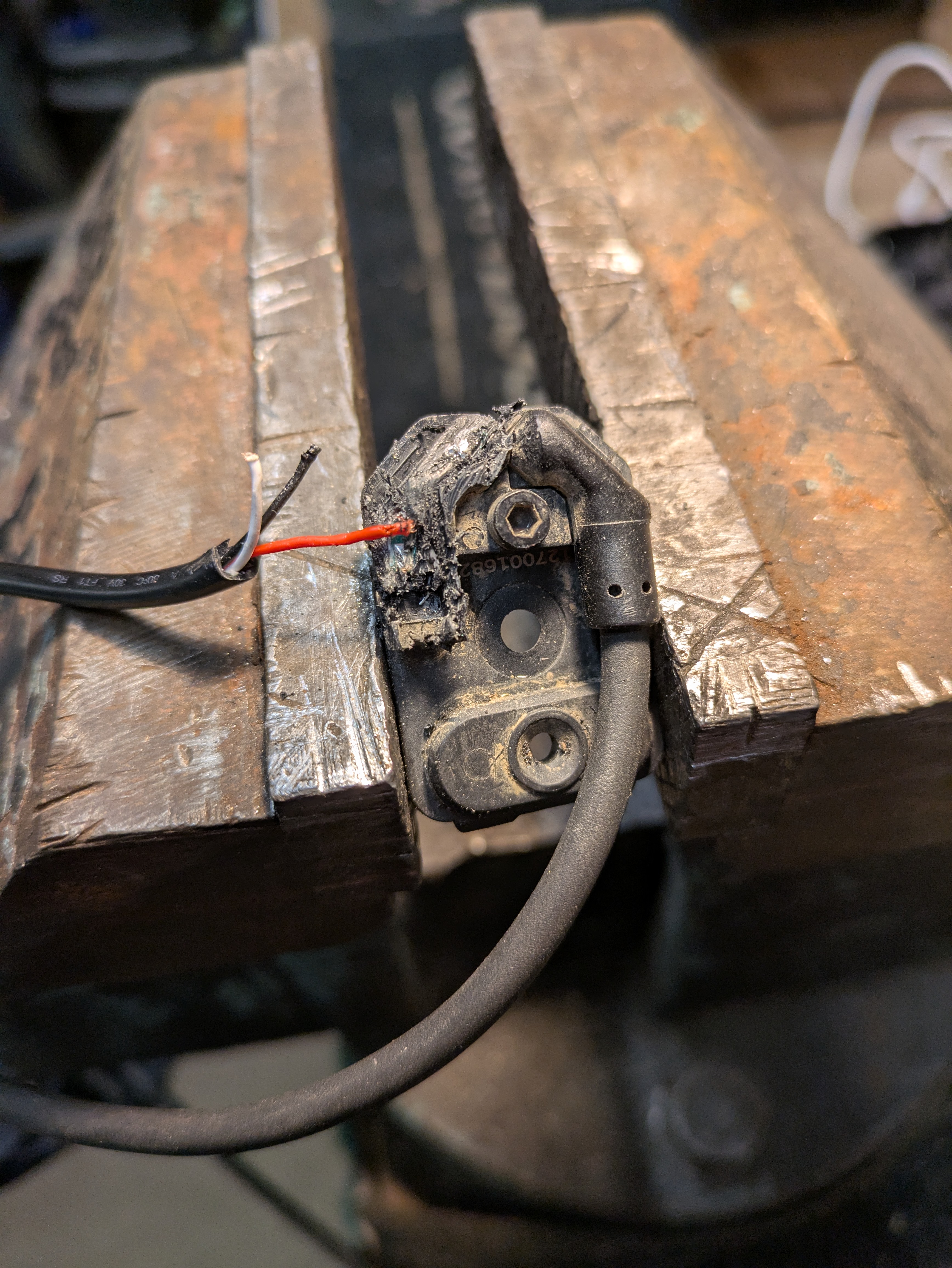

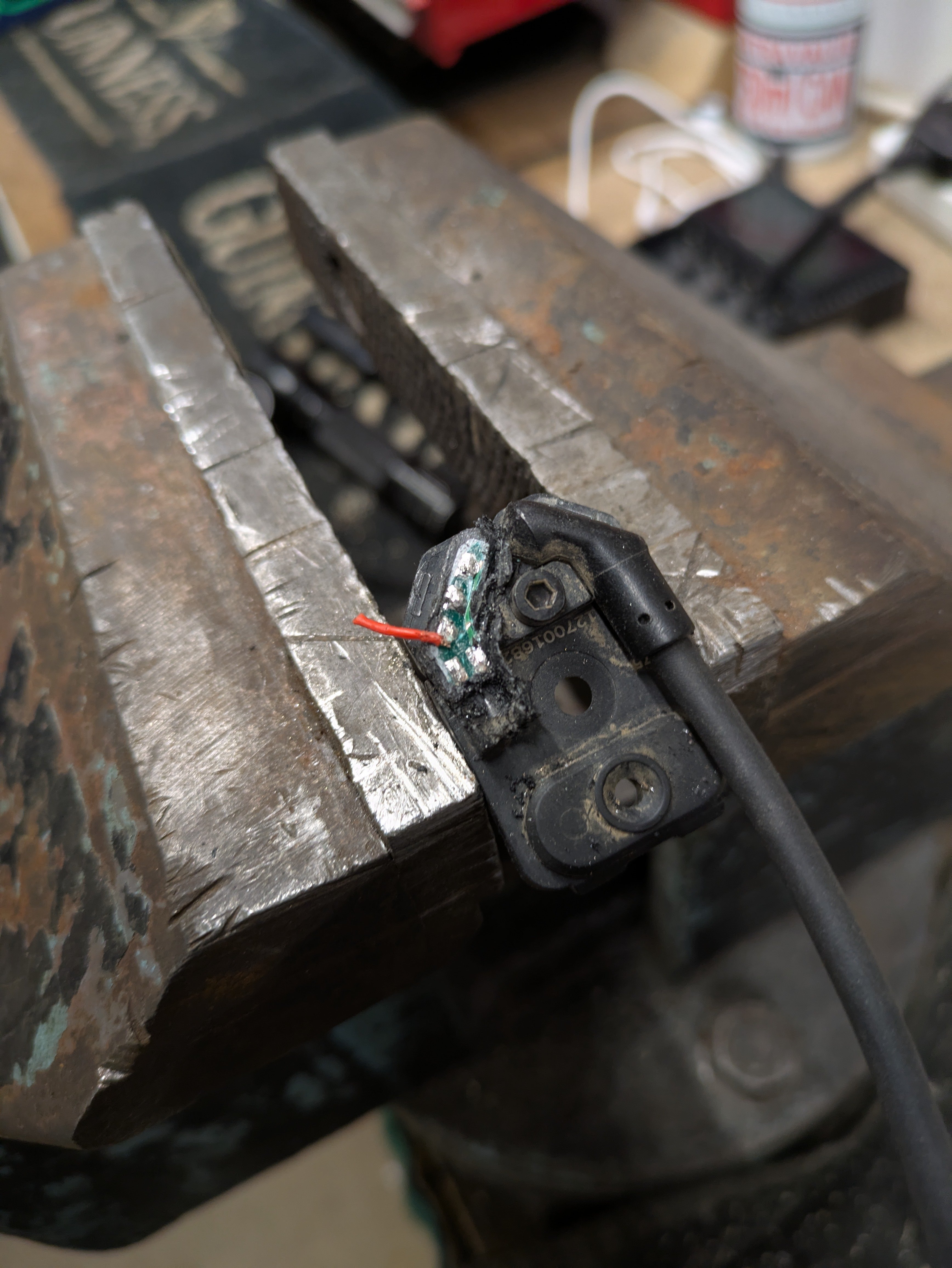

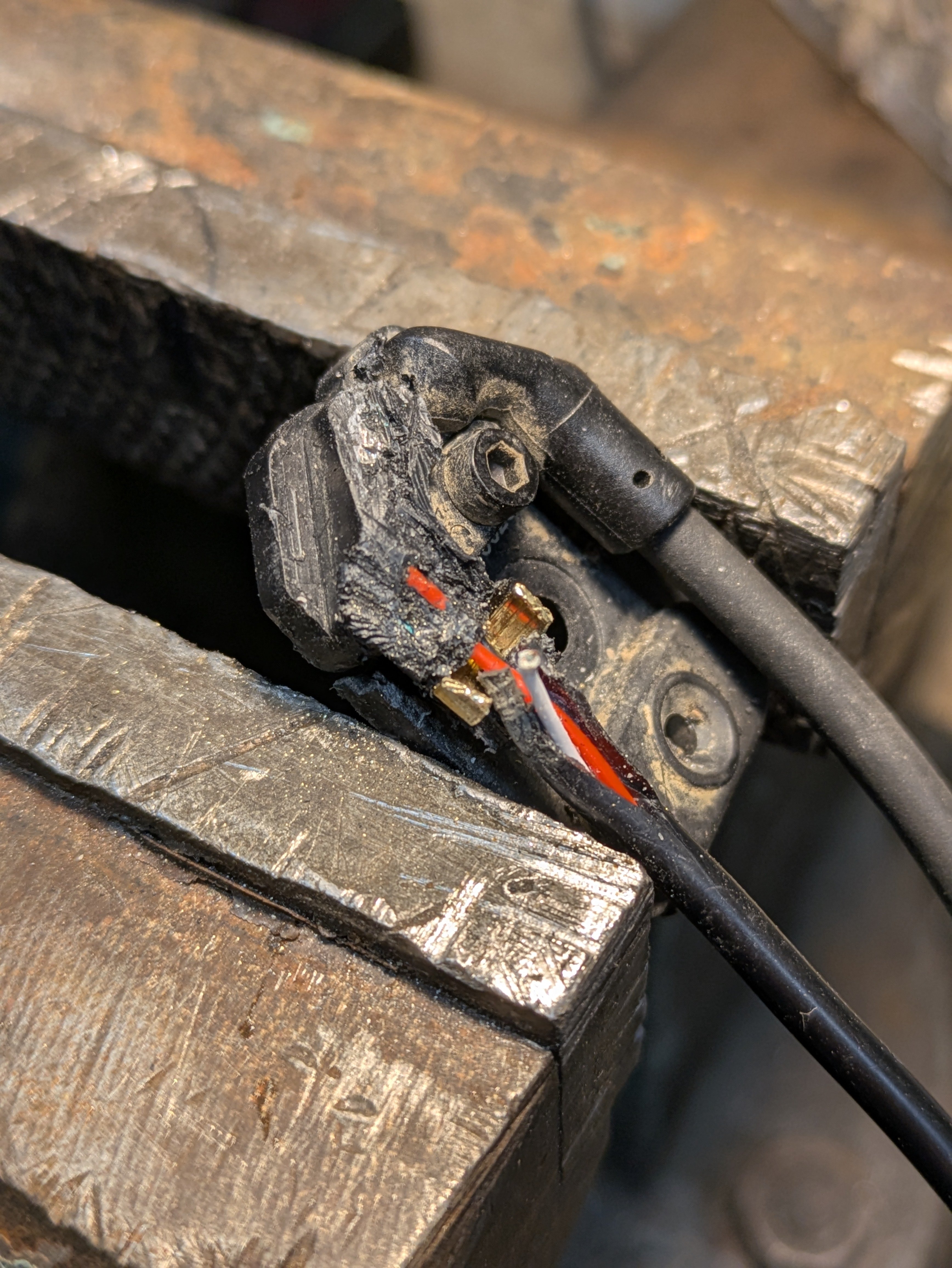

I went for a ride on Wednesday and got about 100m up the road and the bike would not alter the power so was stuck on boost mode 🤔
It then turned itself off and generally started to act like a twat!
It was working fine the night before so after a bit of fiddling it was looking like loose wires on the Bosch kiox head unit.
Seeing as a fair bit of my working life as a mechanic involved sorting out vehicle electrics, I got stuck in and did some stripping down and resoldered a couple of broken wires back onto the head unit 👍
Resulting in the bodge of the day until I can get another wiring loom from Germany 😁

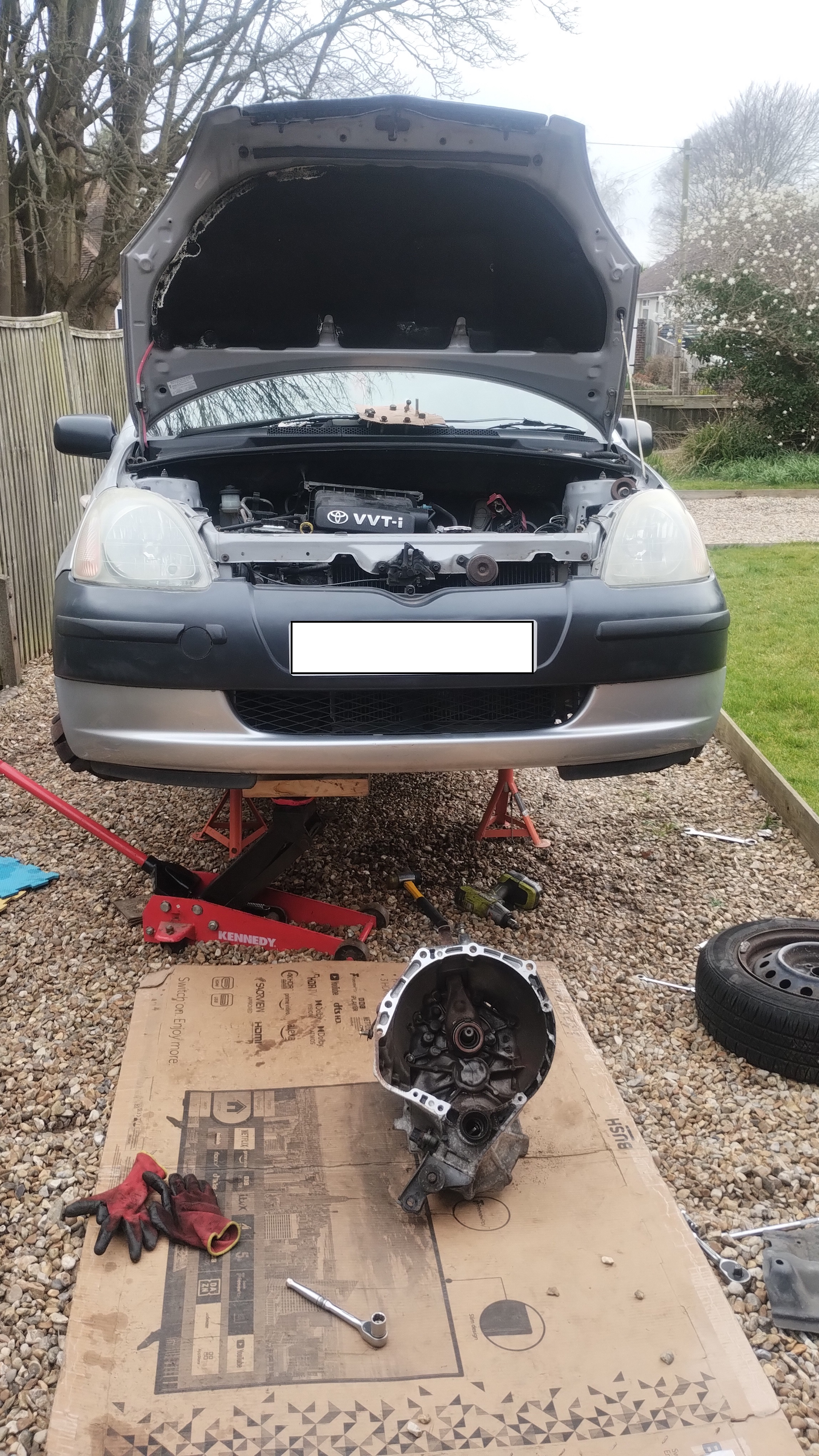

Woah, that thing is destroyed, shopping time. Meanwhile, here at Rusty towers, I'm balls deep into taking the gearbox off my daughter's s**tbox Toyota Yaris before it starts raining, we should swap notes 😂
Halfway, new clutch in. This is relevant as it adds to my mtb technical prowess. I will not be taking questions at this time. 🤪
Come on man and pull your finger out, your supposed to be on a bonus system 🤣🤣🤣
Btw is this the point where you find out the duel mass flywheel is fubared😱

Done. I'm knackered now. No ramps or electric tools here like you la di da posh boys.

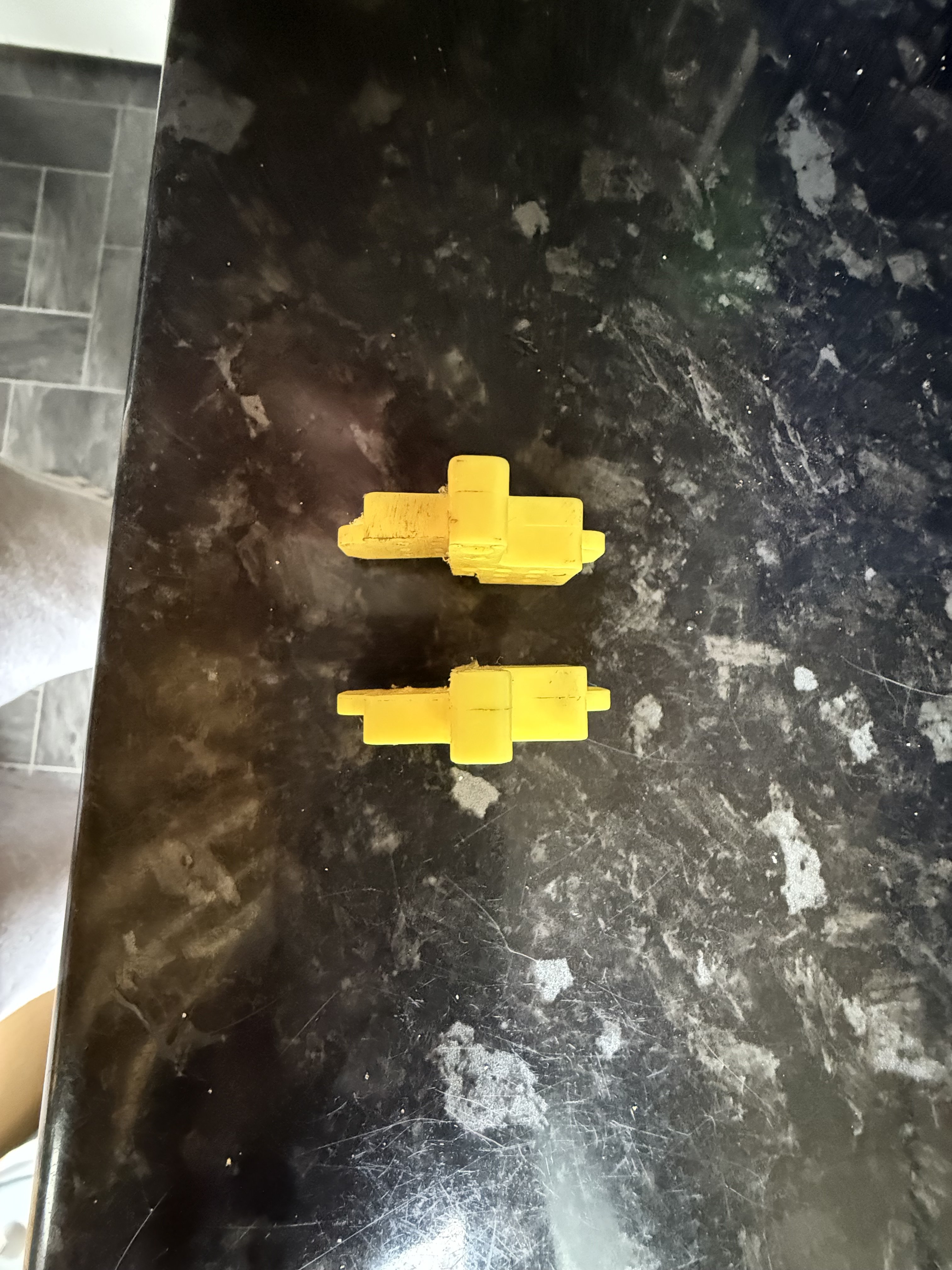

also modified some sram bleed blocks for the Magura mt7 so I can block 3 of the pistons and only 1 comes out had to make 2 opposites as the way the caliper is constructed works perfect though
