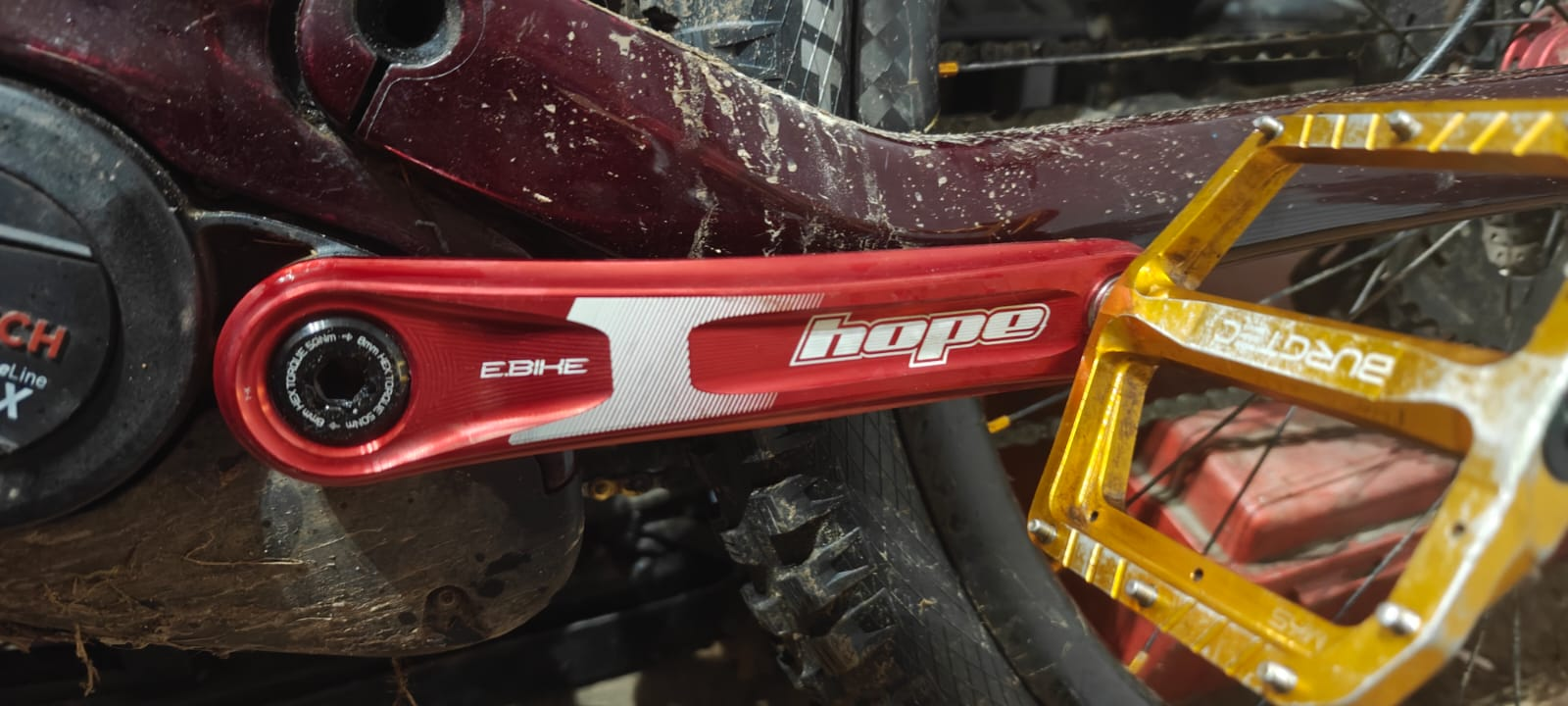

Unfortunately, while working around the chainring, I noticed the cranks/motor spindle looked odd. After further investigation I found that there was 3mm of play on them!
I've emailed the store I bought it from but I'm not impressed. The drive side crank was only half on the spindle, and the central bolt wasn't even finger-tight, so I'm pretty sure someone has had this apart already.
Edit: shop have replied simply saying to take it to my nearest Spesh dealer for warranty, didn’t address the other point I raised (bike arrived with no back axle), and zero explanation for why the RHS crank would be so loose. Very very unimpressed.

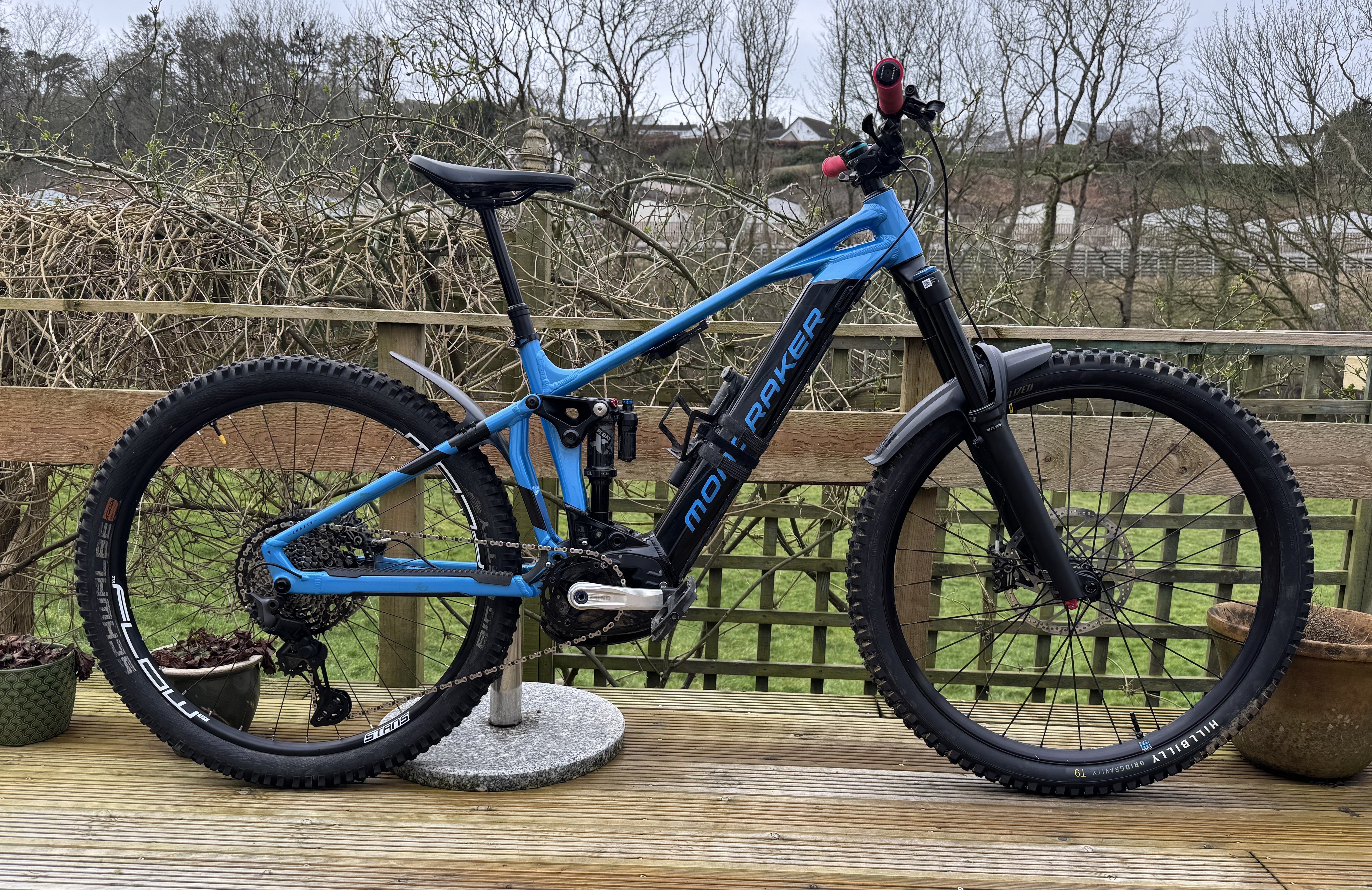

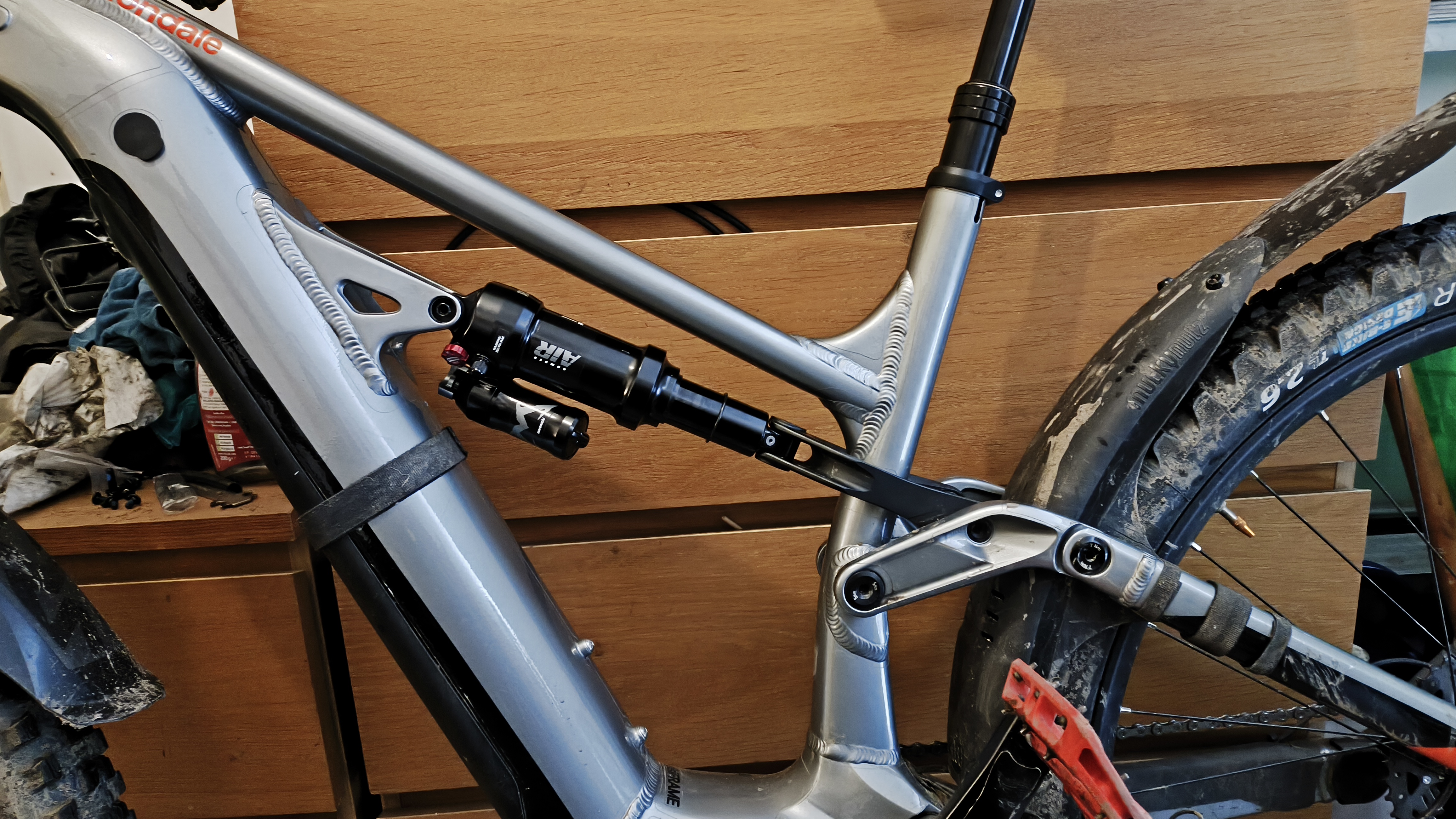

Installed the stroke spacers in the Marzocchi Air and whilst the can was open fitted a 0.6" token. No idea if that's to much or not enough volume reduction as it's been pissing it down all night and it's still raining now but it'll give me a starting point, so I'll have to test the rear ramp up/ bottom out another day. Oh and obviously installed the shock on the Moterra.
Tested the Bomber Air (in the post above) , bloody brilliant compared to the stock non piggyback Rockshox Deluxe. So much smoother, (tested down a flight of steps). Also hit 38mph going down a steep (on road, not off road) hill near me and only the fact that water and run off grit on the road around a corner made me slow down equalled my best with the stock Rockshox in dry summer conditions, it was 2 or 3C today and wet. Must admit I hadn't realised (as I've been riding on the bog standard RS Deluxe for nearly 2 years) how much of a difference a rear shock can make. And my arse didn't ache after 24 miles!
Not tested the Bomber seriously off road yet as everywhere is still a wet mess of mud and slippy rock (after all the rain around here) but my first impressions are "I'm impressed" and doubly impressed that I paid £150 for the shock, £30 for the bag of tokens (volume reducers) and £5 for a new DU eyelet bush), so sub £200 fitted and a hour say of time of fitting a 0.6" token and installing the shock. 👍
Tested the rear Bomber Air properly today , hurrah it was sunny, the local tracks had sort of semi dried out and it was 13C 😀
Must say, I'm impressed, handled even hard downhill chunk with aplomb and felt planted at all times. As it's been said many times before, when the back ends working correctly the front end feels better too.
Unfortunately my bikes now far more capable than I am, as I'm that used to having to slow down over fast downhill chunck (the o/e RS Deluxe R felt dead /unresponsive/ easily hung up/ not working in unison with the front in comparison) that I've got to recalibrate my brain to keep me off the brakes!

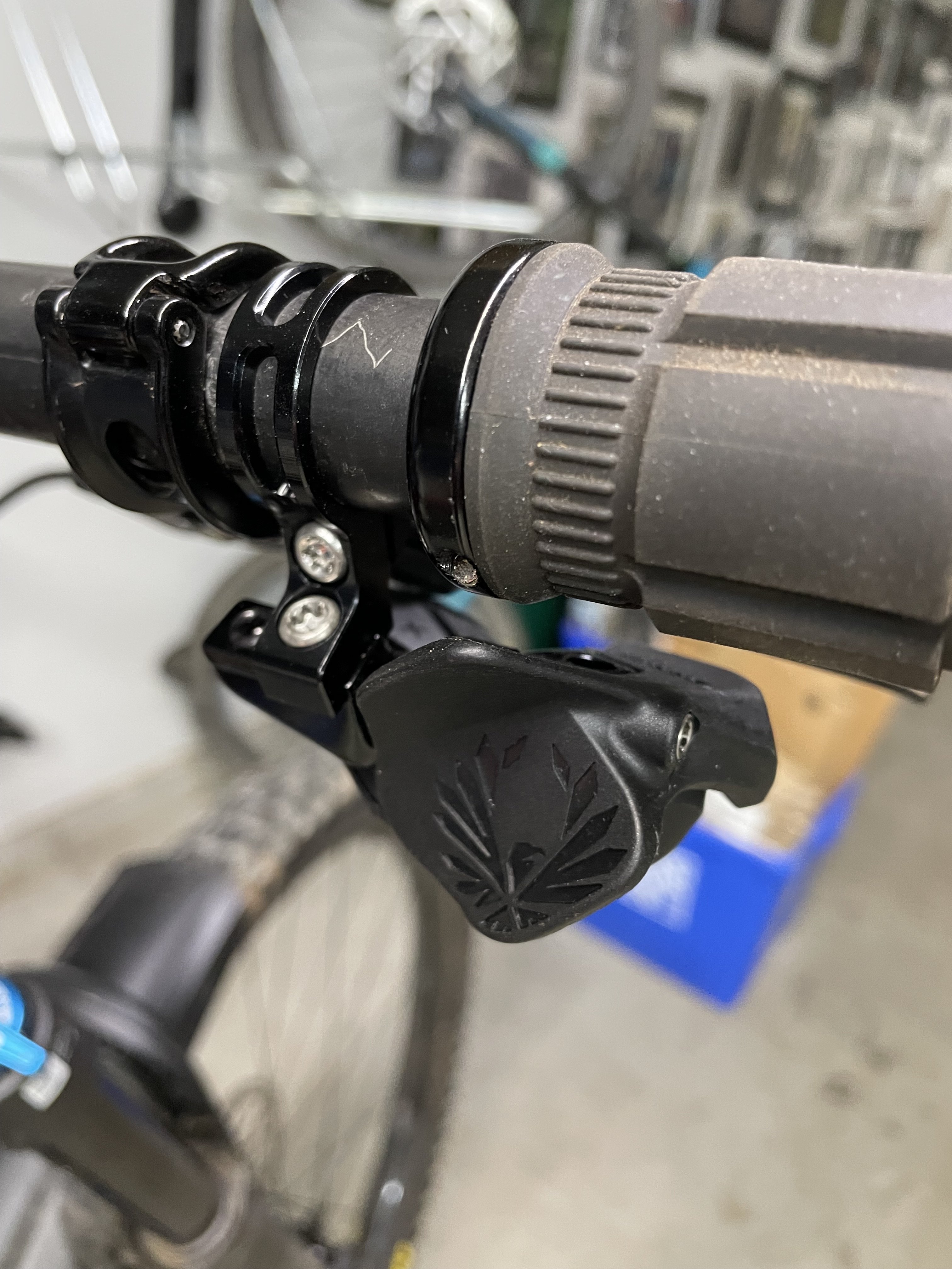

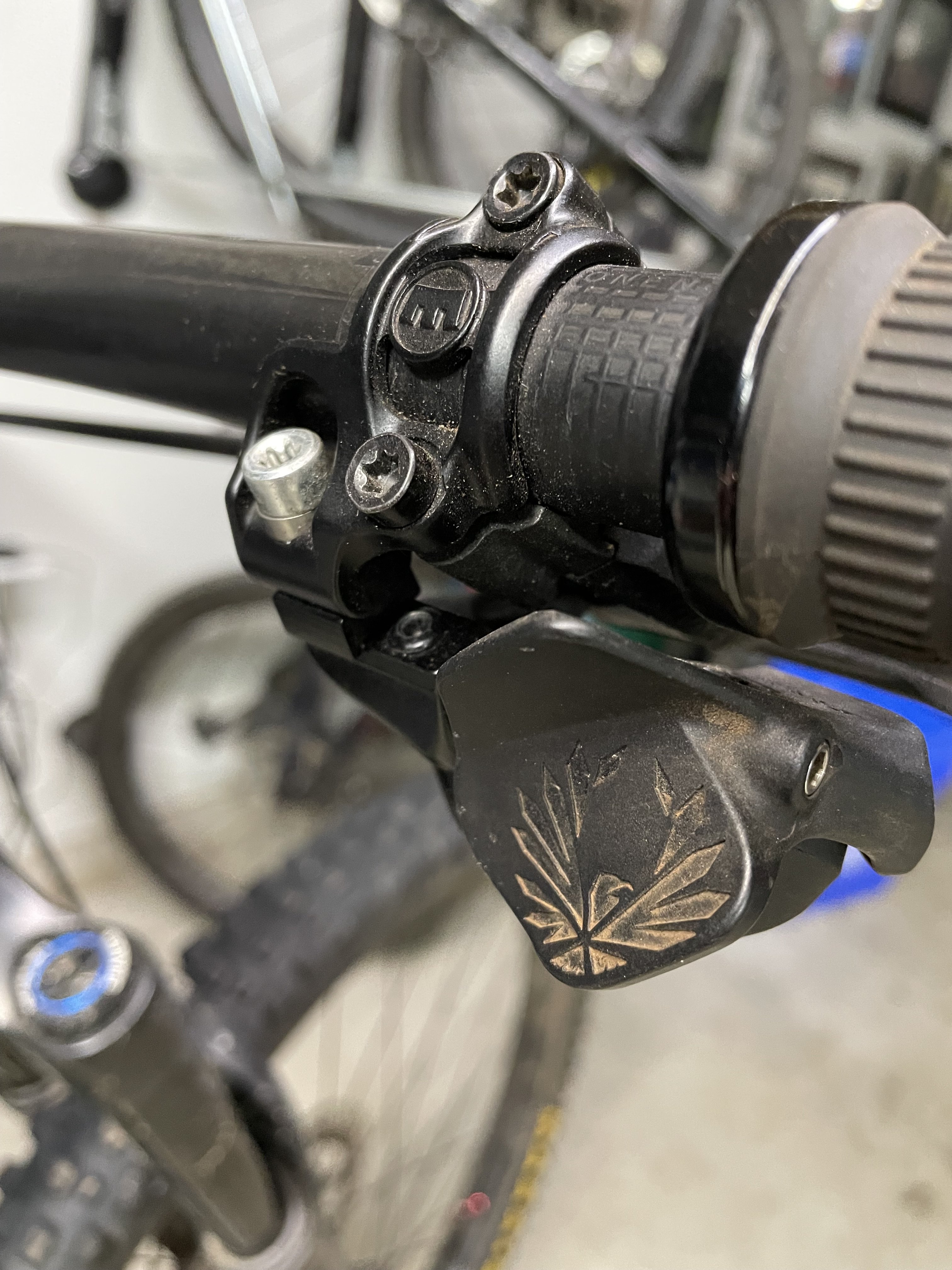

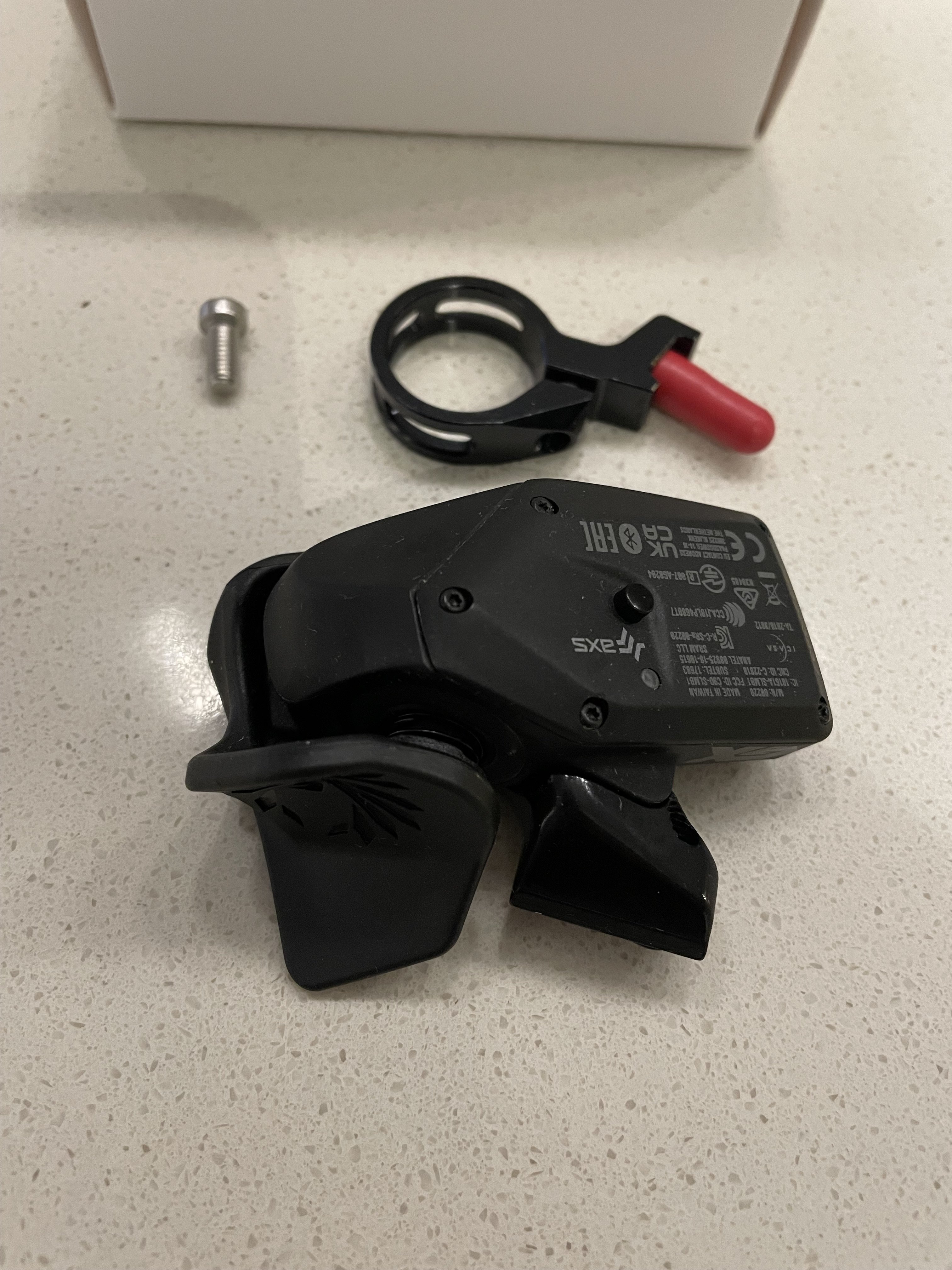

The Cues RD U3020 derailleur doesn't have a clutch, so replaced it with an RD U6000. Made a right mess of the shifter cable, so replaced that as well.

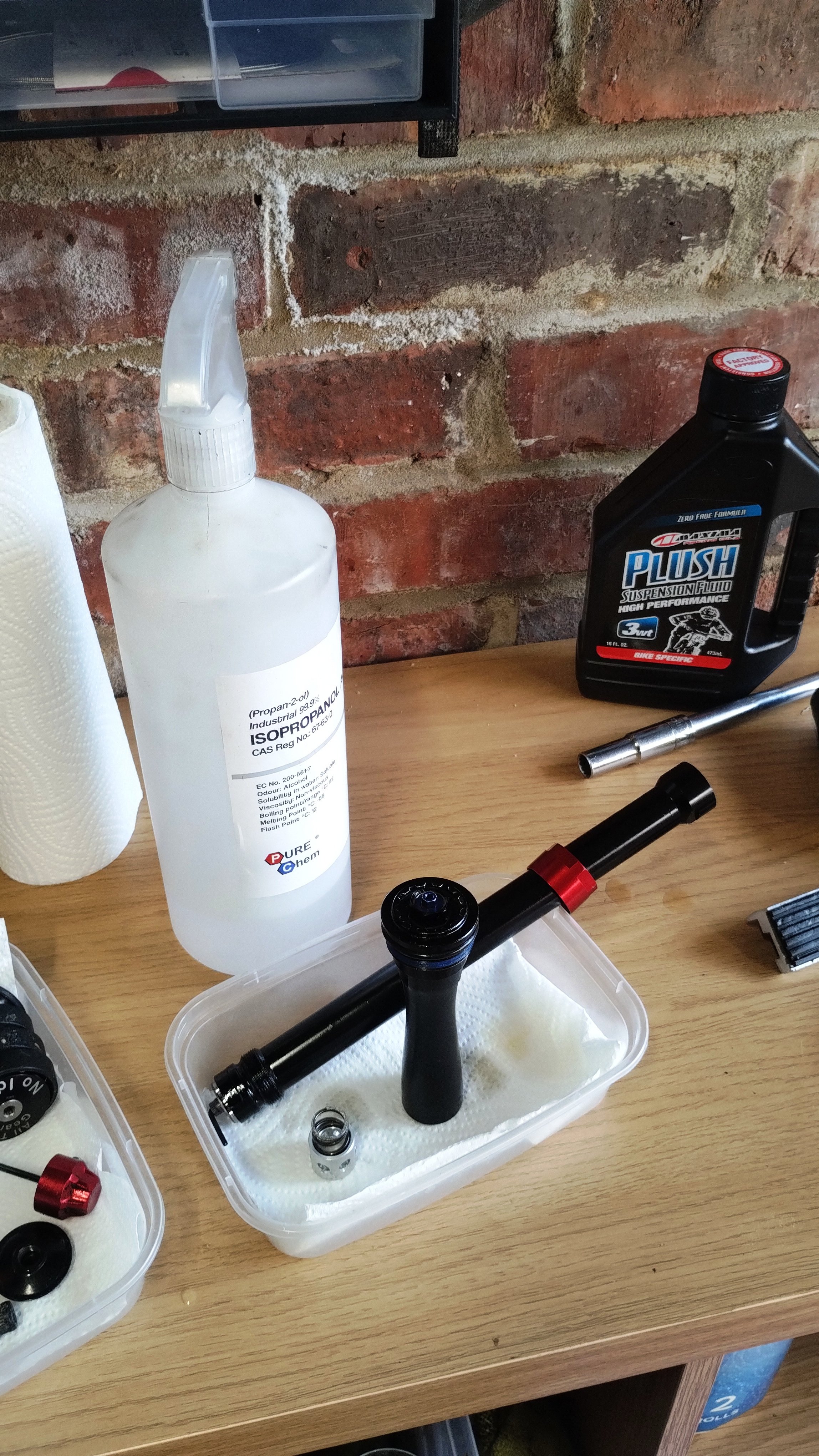

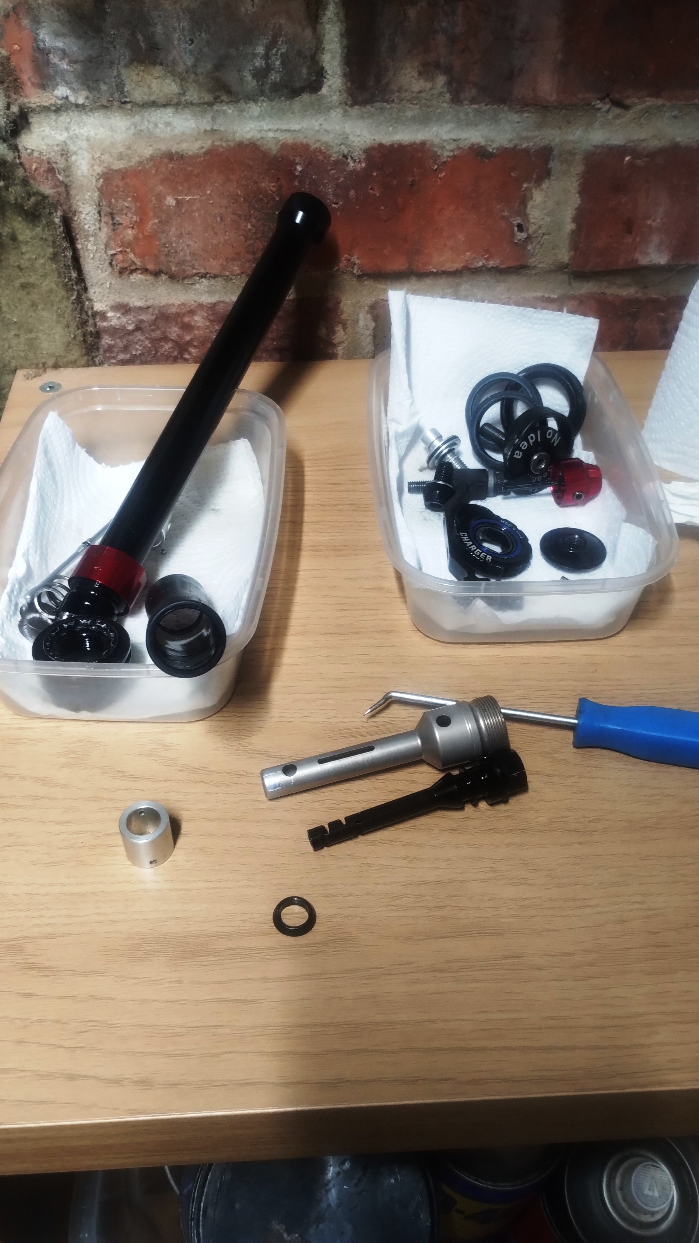

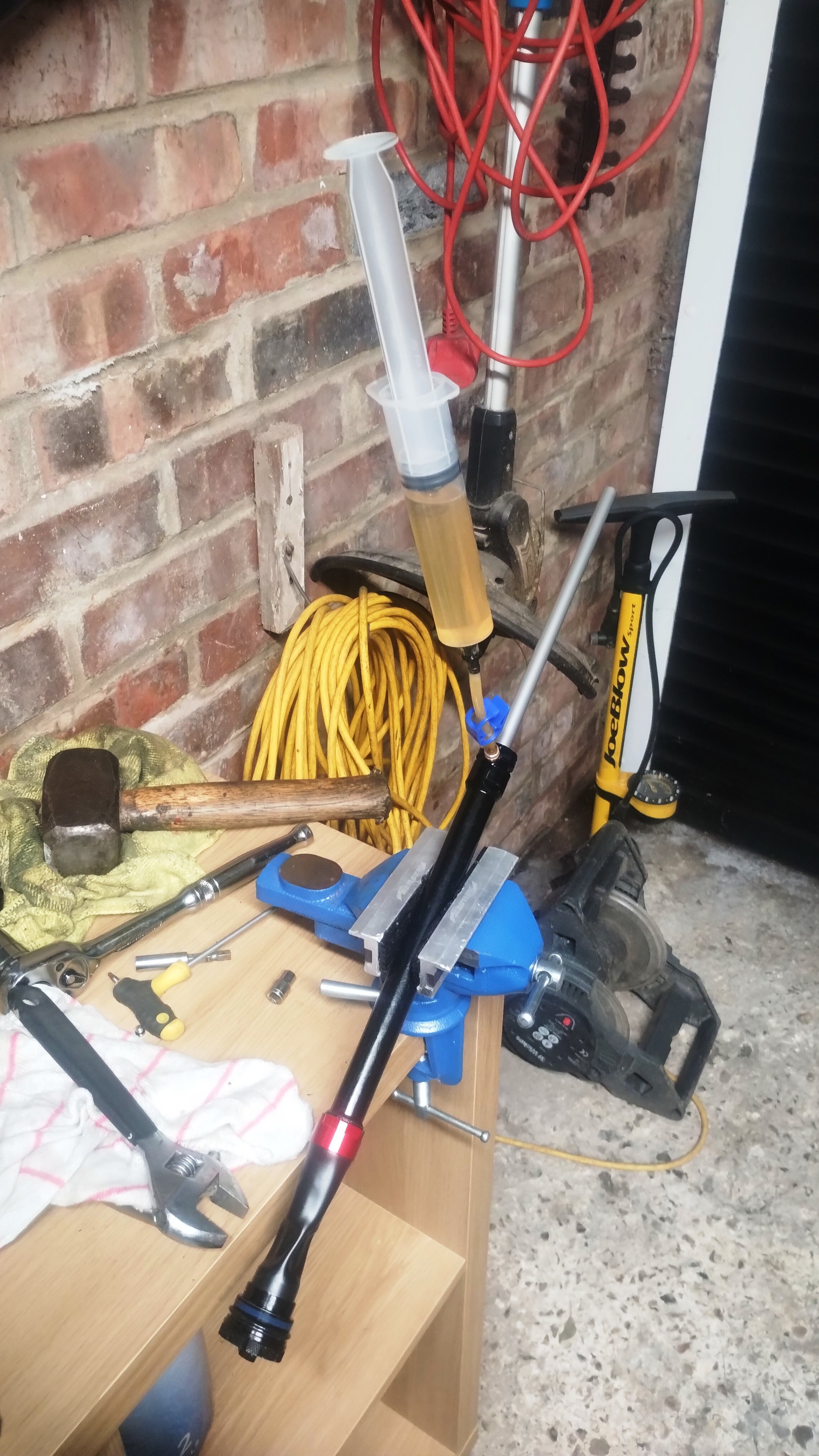

I went about as deep as it's possible to go on a Rockshox Charger damper. 2.1 dampers have a design flaw where a seal in the compression circuit assembly fails. The damper then leaks oil upwards through the adjuster knobs until the bladder eventually collapses.
Usually, the opposite happens where over the 200 hour service interval, the damper ingests oil from the lower legs & swells. In the former case, damping weakens, in the latter, it gets harder. The assembly itself isn't serviceable on the face of it, since it's made up of an internal & external shaft connected to an external sleeve by pressed in brass pins. when you turn the adjuster, the internal shaft rotates which via a scroll cut into it, moving the brass pins in the channel, which in turn move the external sleeve, pressing on a second spring loaded sleeve beneath adding or removing pressure on the compression shim stack.
Rockshox don't sell replacements & the pins are permanently fixed, so the standard repair is to replace the whole damper. However, you can tap, press or drill the pins out to separate the two shafts & replace the seal with an upgraded o-ring which should outlast the damper.
Awkward job, lots of steps & you do need the tools & the will but in the end, it's two quids worth of o-rings vs £350 of damper, so well worth the effort in my view.
