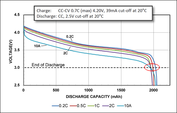

I have some experience on batteries and have been working with them for long time.
As most of us know, a lithium cell, 18650, can be charged safely up to 4.2v and discharged to 3v
In my 2021 turbo levo I checked the voltage battery in mission control when battery is in "its" very low level and nearly cutting but it is still 33 or 34v so we have some power remaining that can be safely used. I sincerely doubt than a 500Wh battery allows to use that energy, in my oppinion the are doing like some cars manufacturers, keeping that energy to maintain the range when the battery starts to loose performance.

Not exactly. I just wanted to share and know your experience about the battery remaining energy when the bike say it is totally flat.
Usually a 36v lithium battery is 30v when flat (very safe limit) but our bikes battery say is flat with 33v, still about 40w usable remaining (8% more or less)

...The limit of 3 volt per series is a totally safe and very common. Until 2.9v is also of, lower limits is right that can affect the battery life but 3 volt is totally ok. If you cut 3.3 or 3.4v, yes you can extend the battery life also if you charge to 4 and cut 3.5 but who wants that, is totally silly except for the battery manufacturer, to pass the warranty period without any claim.
3V/cell would be a very aggressive cut-off voltage - look at the discharge curve on the average high power 18650, they are almost completely exhausted at that voltage...
Remember these bikes are being sold in all sorts of climates. In colder countries you could easily permanently damage the packs through over-discharge with a cut-off so low. The manufacturers are not brainless, they know they need these batteries to do hundreds of cycles so they are never going to do that. Given the Spec batteries are from memory a 10S4P configuration 33V at rest when discharged = 3.3V/cell off load seems an eminently sensible endpoint.
