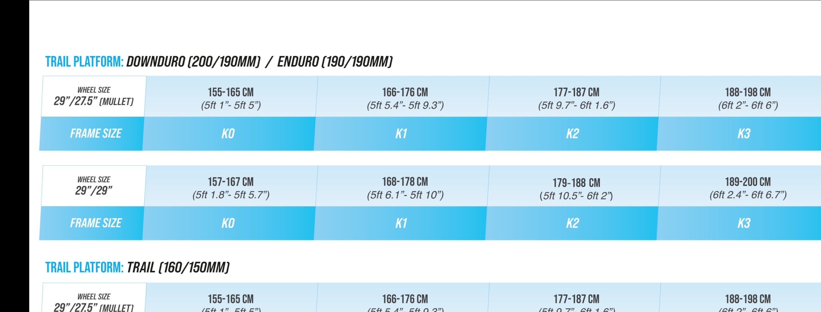

Ordered a K2 size today. I am 188 tall and have been riding a Focus SAM2 in size Large. The K2 seems to be similar sized, but with a bit longer wheelbase. Will probably add a longer stem and rise bars and hopefully i will be spot on.
Just a question for taller riders on K2 (i am 1.88), what Stem size did you put on, (if you changed it?) I am contemplating the Oneup 50mm stem and the 35mm riser bar.
Has anyone ordered and received a K0?
I’m considering a K0 instead of a K1, I’m 170 cm.
My current Levo’s are 435 mm reach but I use sqlab 30x bars with 16 degrees of sweep.
450 mm just seems too long for me.
RAD measurements suggest a K0 (and my current medium Levo setup seems to match that RAD).
I assume it is easier to make a K0 a bit longer than it is to make a K1 shorter.
They are big bikes. If you are hovering between sizes, size down.
I th
I think you’re ok with either one. I’m 5’6-5’7ish and I’m on my second K1 Voima. However I am using a 10mm stem on my 40, so the reach isn’t an issue for me. I haven’t tried a K0 though, but with 455 chainstays I think a K1 with 450 reach is more balanced and centered for the rider rather than a short front and long back. I suppose you could put a longer stem on a K0 though to even it out.
I’m curious as well, being that I am also 188 tall and am ordering a K2.
I’m thinking a 40-50 stem and a 35-40 riser bar.
Any pics of a 50mm stem setup?

Good to see that people are going for what they think suits - the short seat tube means its fits a wide range of sizes which is cool. I’m 173, with a k2, and think the bike is nice and agile, corners great, and loves steep weird tight stuff.

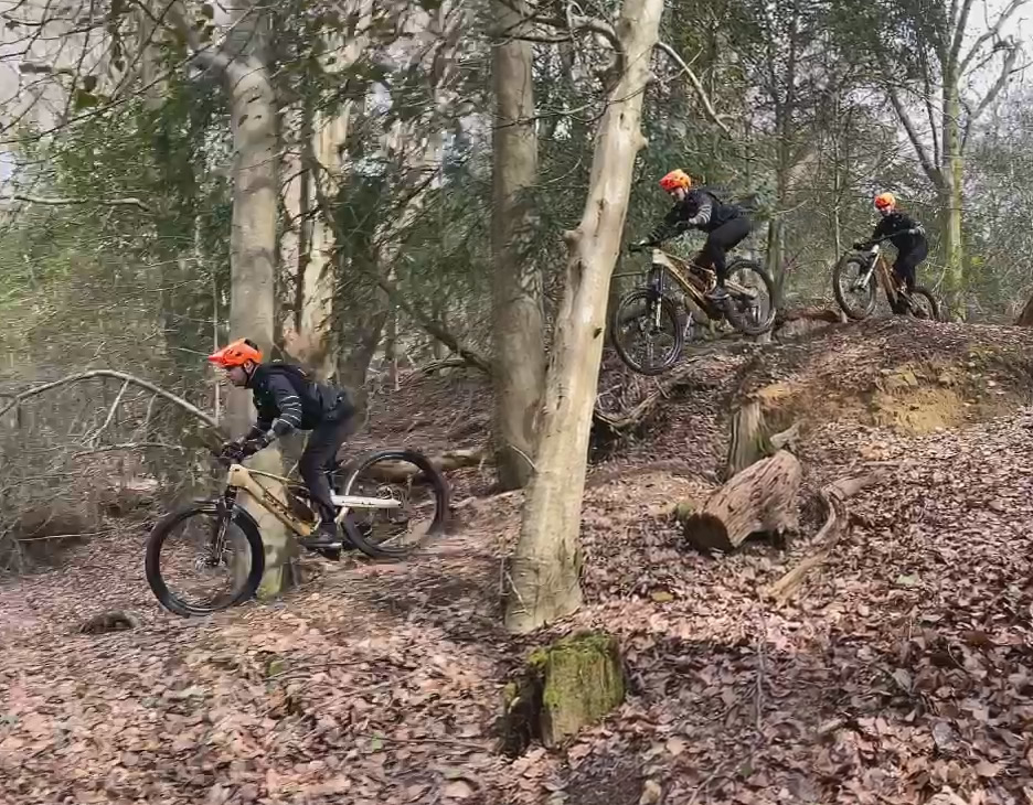

If you look at this pic of me hitting a mediumish drop - im not cramped and im not stretched when the bike is dynamically compressed beyond sag – which is where it counts. In fact I might take off a spacer to add a bit of reach for the next ride and see how that works! Would be good to see others post up “dynamic mid travel” pics as I think it would give people a good idea of how the sizing works, when it matters, and not just on paper.
I don’t think the geo is as out there as it might appear on paper. I totally have 100% forgotten about it and it just feels a like more composed but equally dynamic and playful version of my last bike (a rail size M )
You're exactly same height as me and one of the few in our height range that are saying definitely K2.
I'm used to a Med Mondraker Level RR at 470 Reach and 1270 Wheelbase. So much bigger than the usual mainstream 2023 Med sizing. That's why what you've said has really caught my attention, because on the basis of my Mondraker, on paper, the K1 looks like a tiny cockpit. You also don't look over-biked in your pic at all

Yeah, it did my head in for a while. The answer for me was to size for the reach that you like. If that's 470 go for s k2 if it's 450 go for a k1.
I like 450 reacg so sized for k1 and I'm glad I did.
The short tt Isn't ideal on the flat. But you get used to it. The short tt makes sense going up steep ups.
I think the new size guide on the Pole website has been adjusted now, and it's pretty accurate now for me.
I ride a medium in most bikes and I would say the K1 is a medium.
