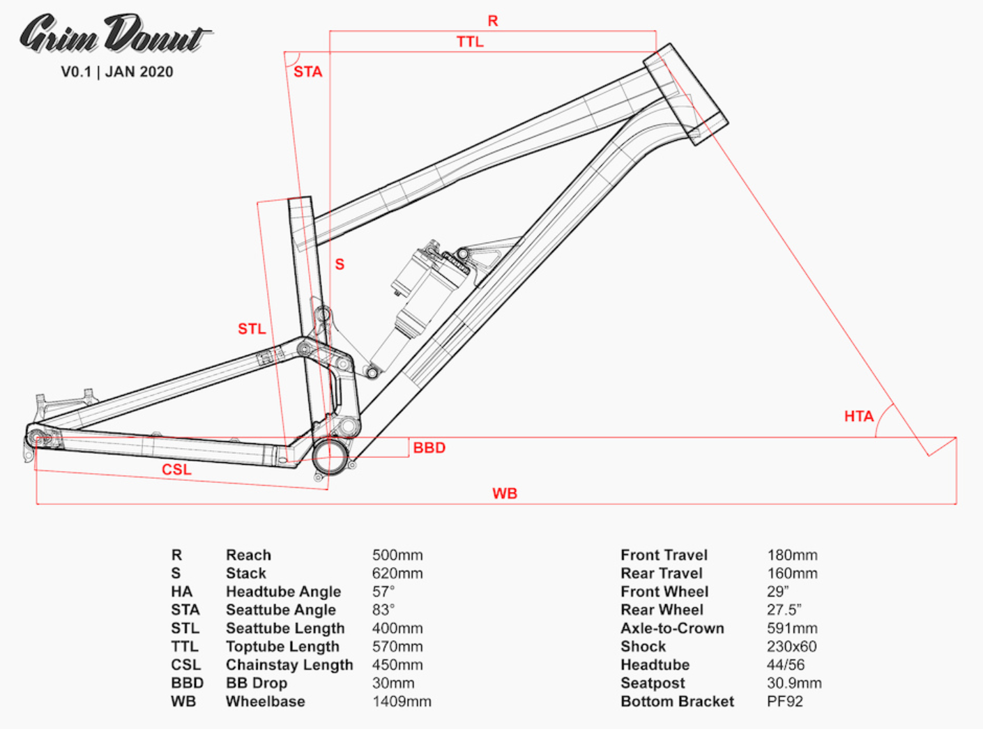

The Grim Donut was an interesting experiment with Geo ..
In the Video Yoann Barelli rides it (about 10:36) with interesting results .

It was the long chain stays that made Yoann so much faster on the Grim Donut. You can clearly see that he is finishing the turns faster and tighter.
He had similar speed gains getting off his old Commencal (short chainstays on L bike) and onto the GG.

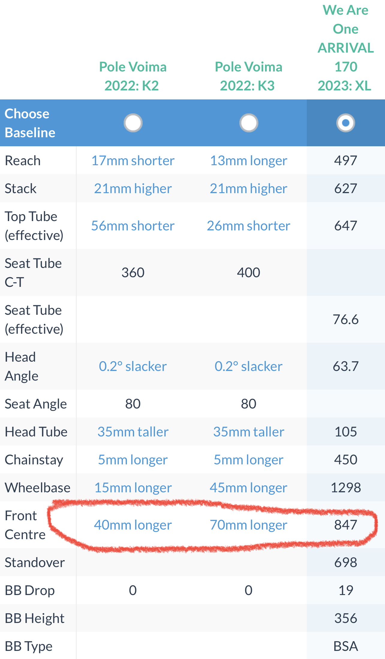

Ordered a Voima ID yesterday and now having cold feet on sizing. 6’-4” and like a 500-510 reach. Ordered a K3 but now that I see that massive front center number (I know, I know) I’m having second thoughts.
Any input appreciated - still need to approve the specs before they roll it into production.
S5 Enduro / S5 Kenevo SL were both perfect fits for me with 180 up front. Worried the Voima front wheel will be too light and will understeer in corners.
Blownoutrides
Mar 22, 2021
232
164
Thanks.

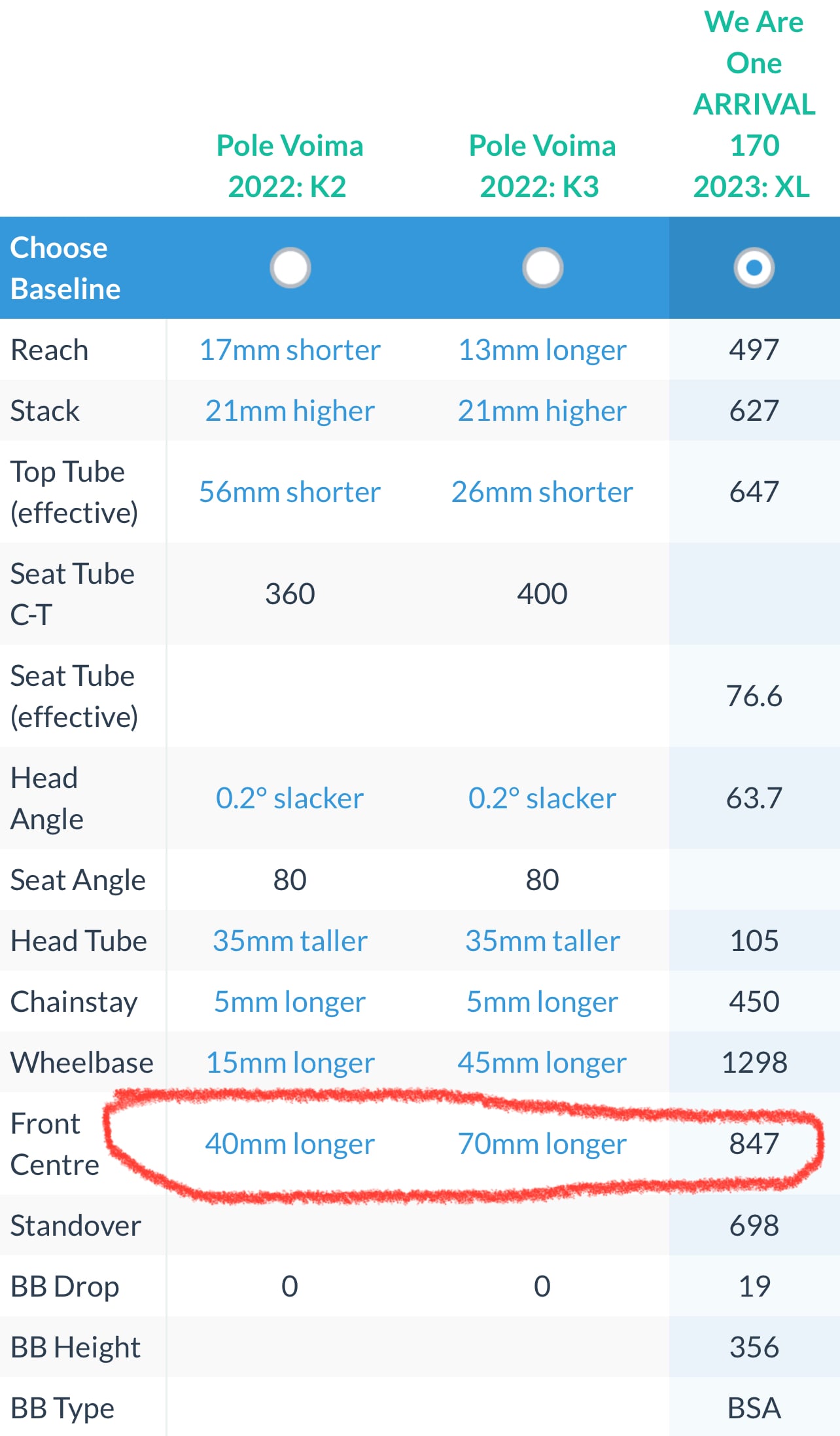

K3 front center is 70mm longer than my current XL WR1 Arrival. Weighting the front could be a massive concern.
K2 would have me pretty balled up in the cockpit pedaling.
Crap. Do I bet my $6k on Rob’s recs or on Leo’s???
Crap. Do I bet my $6k on Rob’s recs or on Leo’s??? View attachment 111920
If I hit go on the pole I'll be sending the size that my standing/descending cockpit cockpit enjoys that's the reach measurement. So if you like the reach of the enduro/kenevo. Then I'd suggest go with that reach.
Ps at 5'11 that's k1 size for me.
Pss. I rode a k4 voima. Stupid long for me but. Still easily could weight the front.

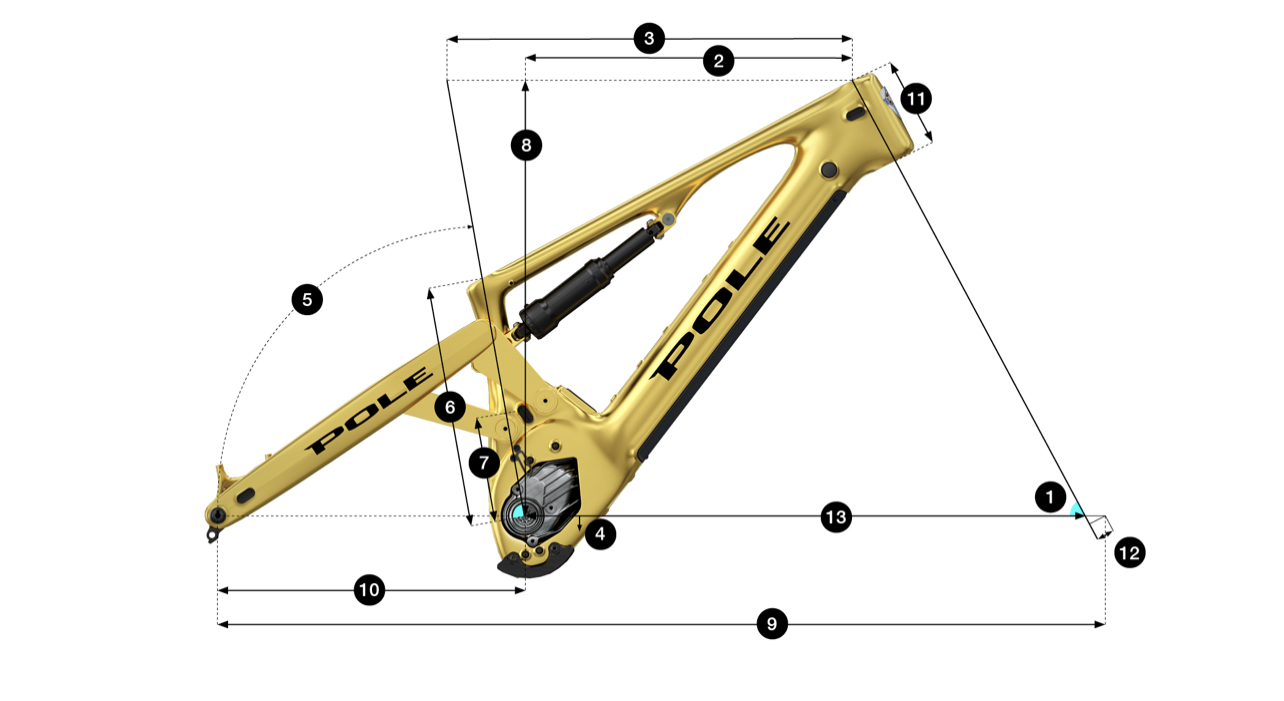

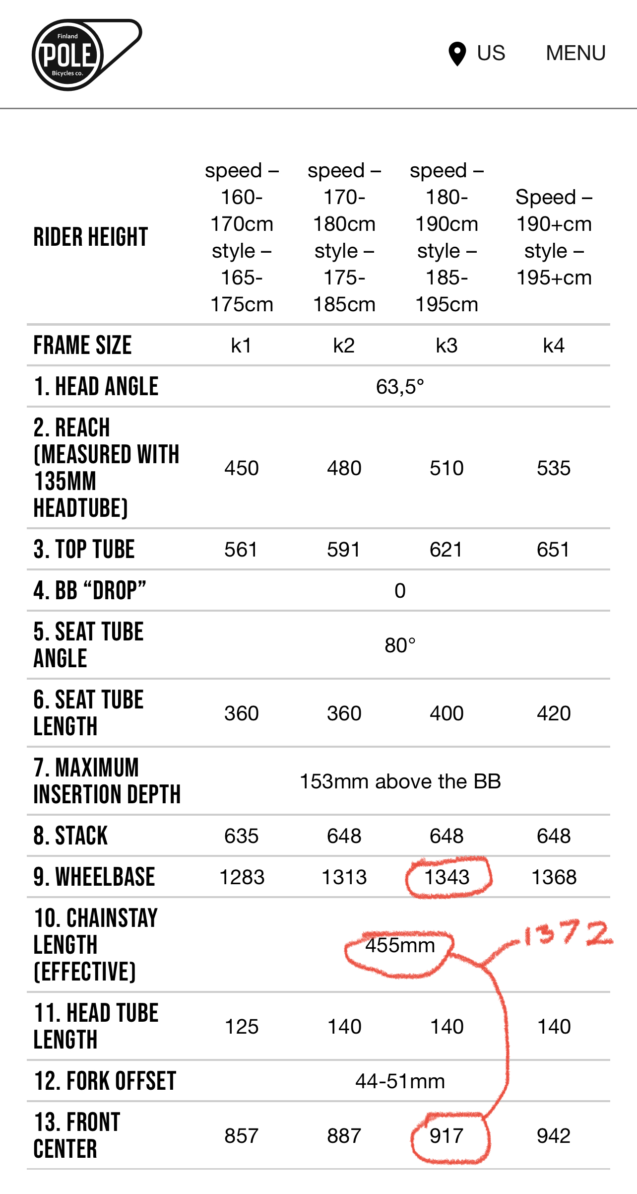

Confused - I’m looking at the Voima geo chart, and it seems that chainstay + front center do not add up to wheelbase.
On the K3 for example:
455mm CS + 917mm FS = 1372mm
But K3 wheelbase is listed as 1343mm
It’s not a small difference ~3cm.
It doesn’t add up. What am I missing… ?
More practically, can someone put a tape on their K3 and post the actual numbers?

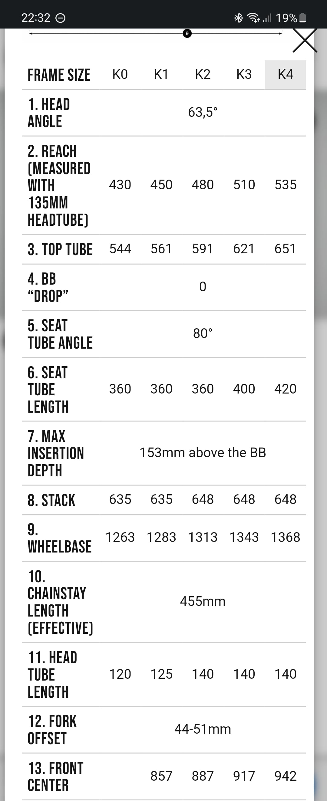

Pole have now introduced a new size, the K0 and looks like they are pulling the K4?
Blownoutrides
Mar 22, 2021
232
164
Pole have now introduced a new size, the K0 and looks like they are pulling the K4? View attachment 114000
Looks like wheelbase is still listed as 29mm shorter than chainstay + front center. The front center numbers look ginormous, so I’m guessing that’s where the issue may be.
Can someone please measure their wheelbase and front/rear centers and post here?
Thanks!
Thanks!

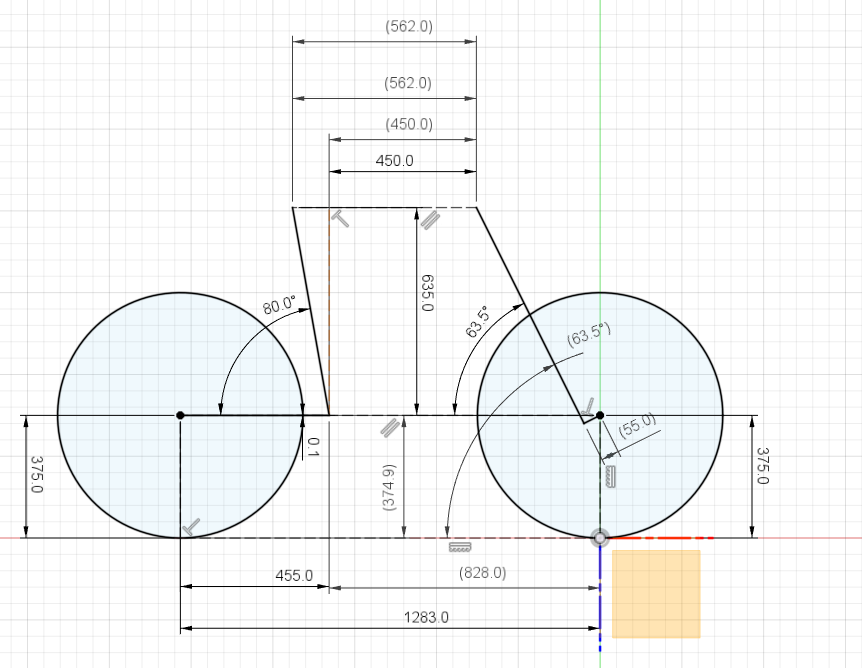

Afternoon modelling the geo so I could assess mullet impact on geo i came to the conclusion that the Pole front Center measurement published is incorrect.
All other measurements stack up except the front center. Below is the K1 size.
