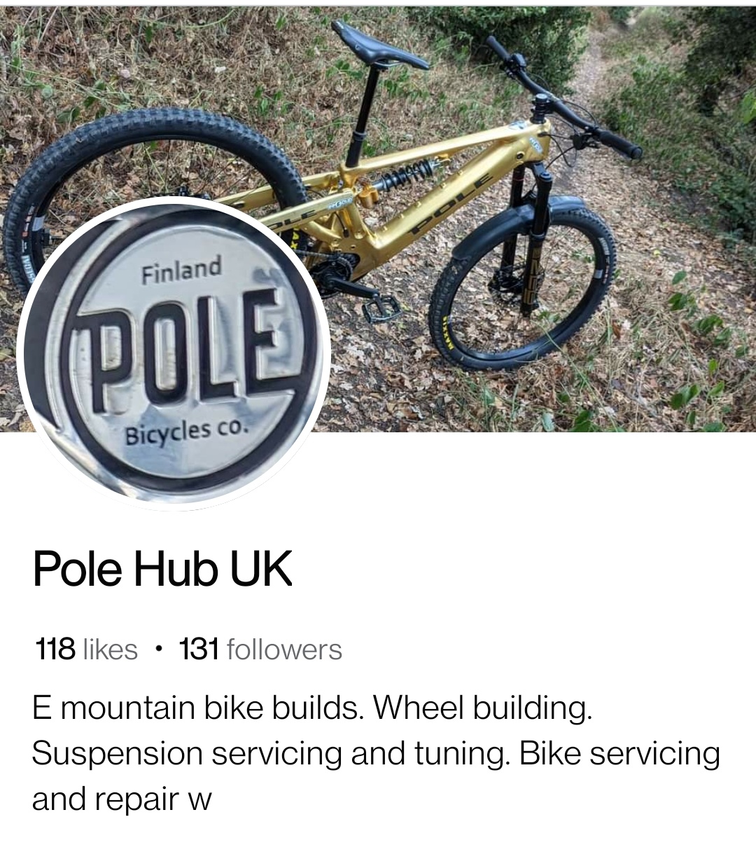

I see you're in Surrey, it's worth a trip to Colchester to see Phil Seaton.
He is the UK Pole contact now and has both sizes for test rides.
01206 866400
Is this the soon to be UK Pole dealer they were talking about on EMBN a few episodes ago?

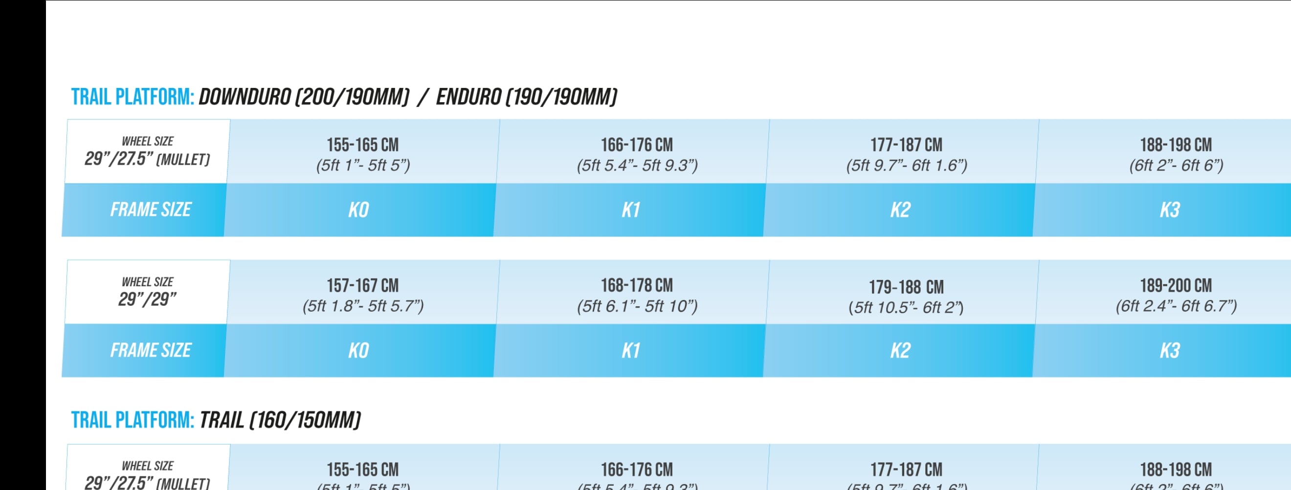

I think the new size guide on the Pole website has been adjusted now, and it's pretty accurate now for me.
I ride a medium in most bikes and I would say the K1 is a medium. View attachment 130924View attachment 130924
Yeah, you're right. On paper, that paper, I'm a K1 but they USED to say, if you wanted speed and stability go K2. They've taken the 'playful' vs. 'speed' sizing dimension away now
01206 866400
Yeah really interesting, I saw a post on YouTube where Phil offered me that. He said he had the bikes because he sponsored an E-EWS team. Interesting neither he nor Pole, who I've been talking to, have mentioned 'dealership' or 'representation' in the context of Seton Tuning Ltd. I have spoken to guy called Chris based in Scotland who said he was Pole UK's marketing manager. He was good and technically very well versed. Pole support put me in touch with him.
