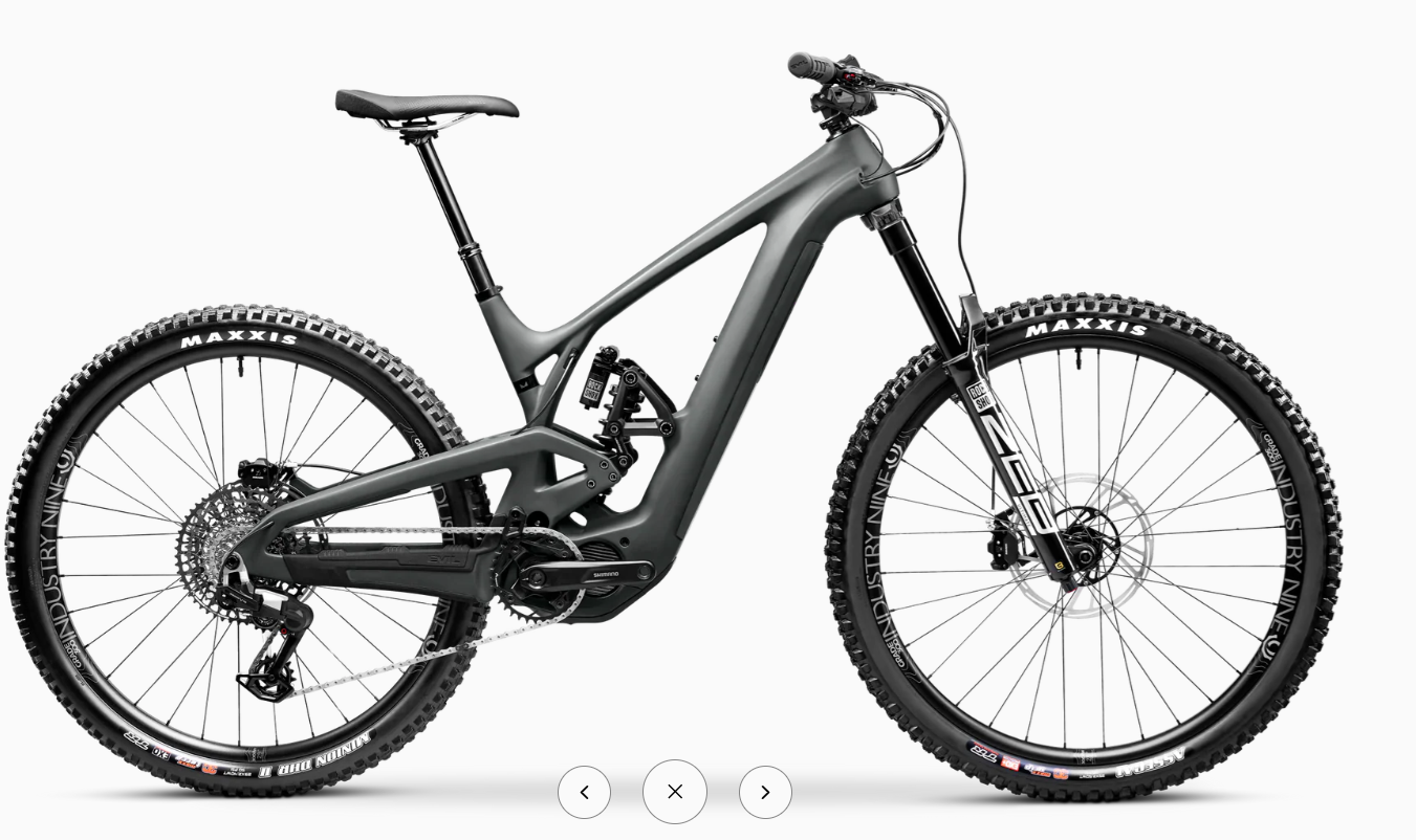

Nice bike, but how did they come up with that headtube?
Make it perpendicular like almost all bikes.
why do you expect a company that only ships one chainstay length to offer the same adjustment options as a company that allows you to alter the geometry in lots of different ways? can't have all these at the same low price point
What are you talking about? I don't expect adjustment options, i like the bike as it is, but want a perpendicular headtube like almost every bike in the market.
that crestline has a 1.5" straight tube so you can use reach adjust headsets to setup your reach, venduro opted not for one, what is not to understand about this!? if you don't have a straight tube you don't need extra material up there. form follows function in that case
It reminds me of Evils butt plug style head tubes.

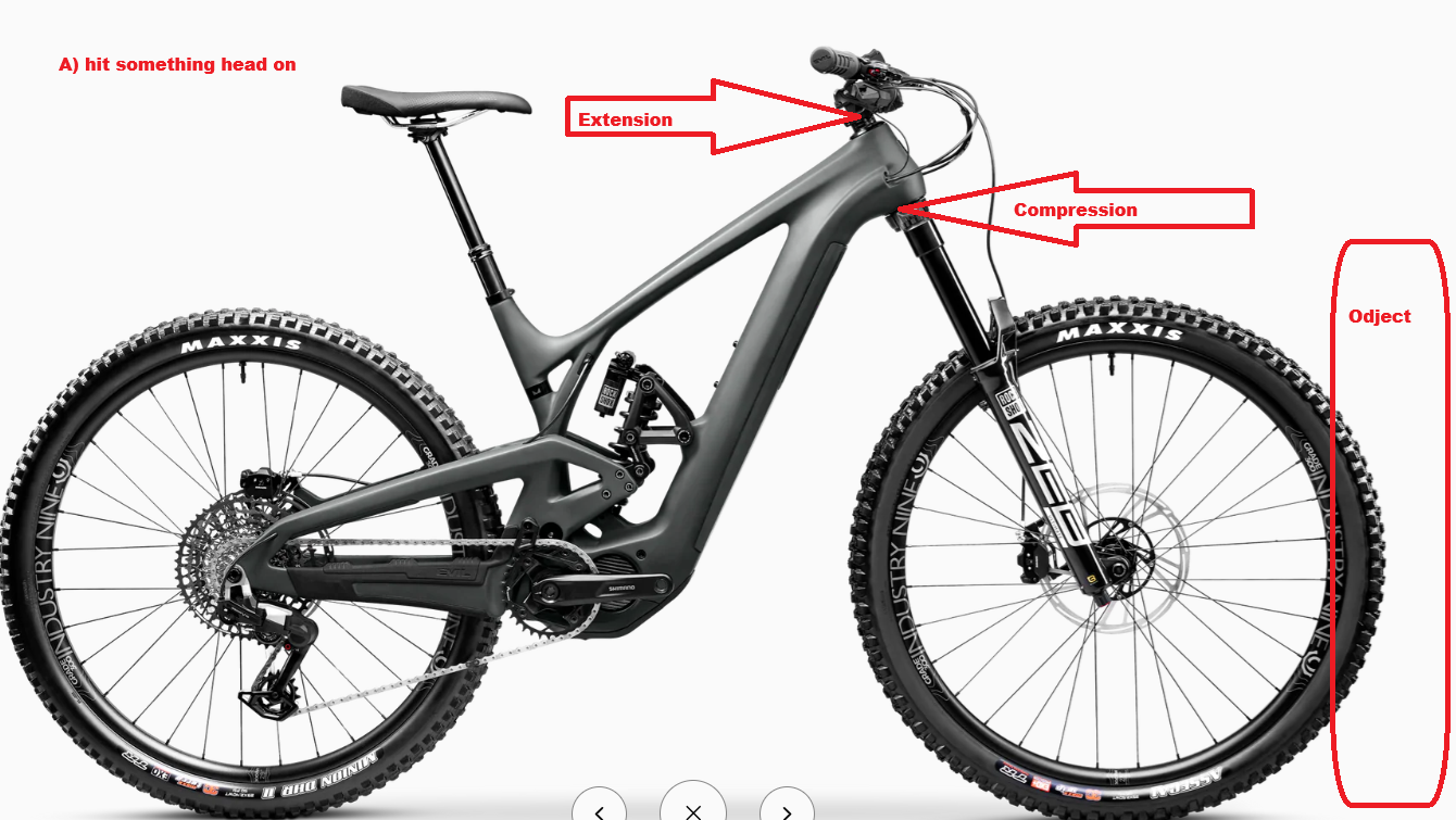

One of the advantages of carbon is you can add reinforcement where its needed easily.
Its good engineering principles, not bad.
If we consider head tube potential failure states of crashing.
A) Hitting something head on. Say run short on a jump and nose into the back face of a jump. That is applying a compressive force at the bottom of the head set trying to push fork through the top tube. The top of the head you has an extension force trying to tear the top of the head tube out.
B) Flat bottom out type. Like running long on a drop and fully bottoming the bike. This failure type is putting a extension force on the bottom of the headtube and a compressive force on the top of the head tube.
Butt plug style head tubes resist Flat bottom out extension forces on the be bottom of the head tube better than straight consistance head tube type designs.
Flat bottom out failure type.
It's not an engineering demand, it's just aesthetic, which i don't follow. DH bikes have perpendicular headtubes with no failure issues.
They are less optimized for weightsavings.... So in that use case run the heavy wall straight through.
In all honesty, I don't care for the butt plug look either. However, im function over form. So it the bike suits my needs then so be it.
OK, how much would that be? 50gr? 100gr?
Sorry, but aesthetic should match the engineering. The funny thing here is that this bottom bump could be reduced.
But the mission was to make a headtube like it bumped on a wall.

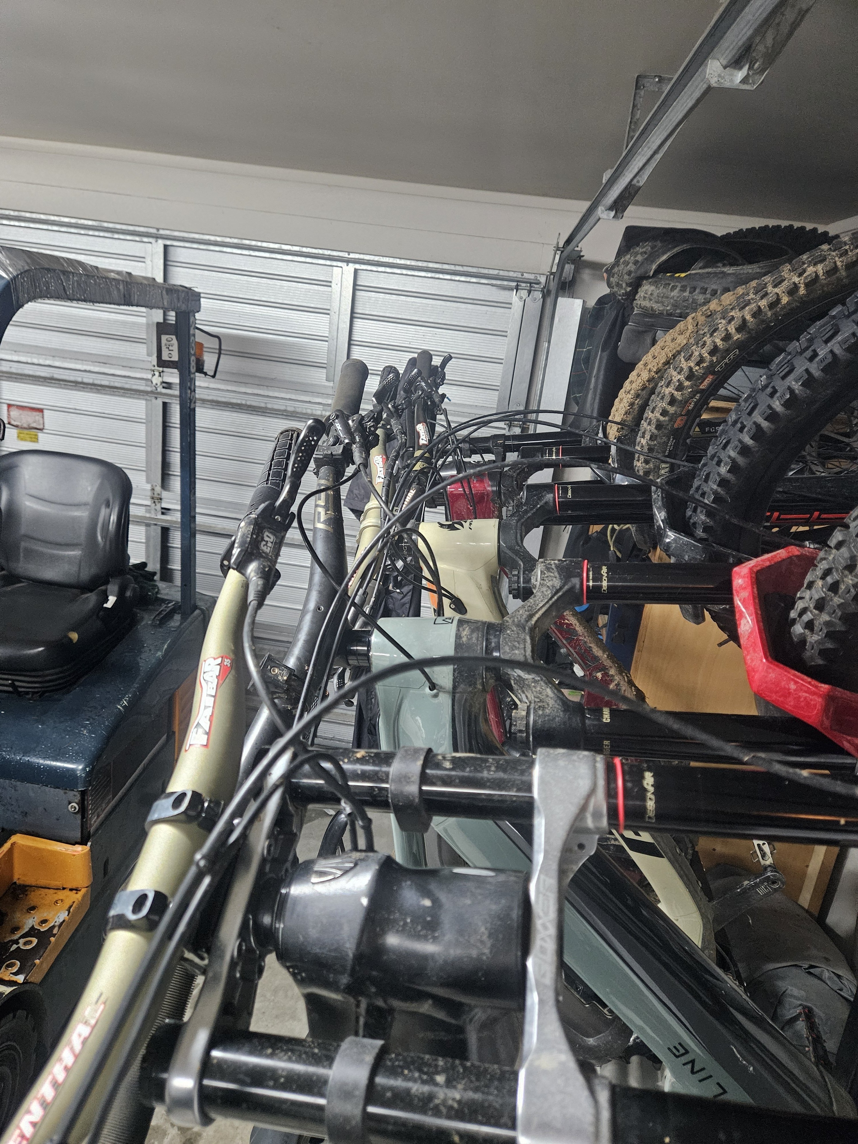

I checked my quiver of bikes. All of them have some form of tapering on the head tubes. The dh bike actually has some formed butt plug style of shape.

It's also worth meentioning that the steerer on dh bikes are also not tapered, leaving a lot more room for material in the bottom section.
