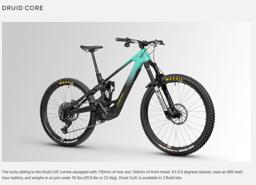

Has anyone seen an all up weight posted anywhere?
Ive only heard a speculated 22kg
This is just conjecture... but surely very similar to the E Druid?
22-23kg +/-1kg range dependent on build and battery selected..

shocker, bikes with the same motor, battery and components tend to weigh the same. who would have thought?

All cf frames vary by half a kilo at most with high pivot Horst Link bikes bring at the higher end of that.
The motor system is fixed and the rest is the build.

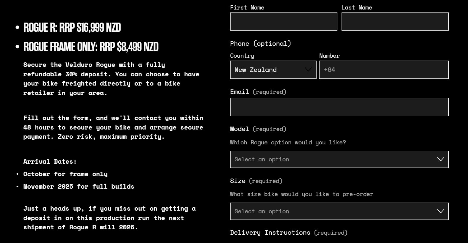

Pre-orders available now.....
For any of you wondering, those prices in NZD are pretty good.
In GBP it's about 90p and in USD, just shy of $1.50.
NB: This is only for NZ customers.

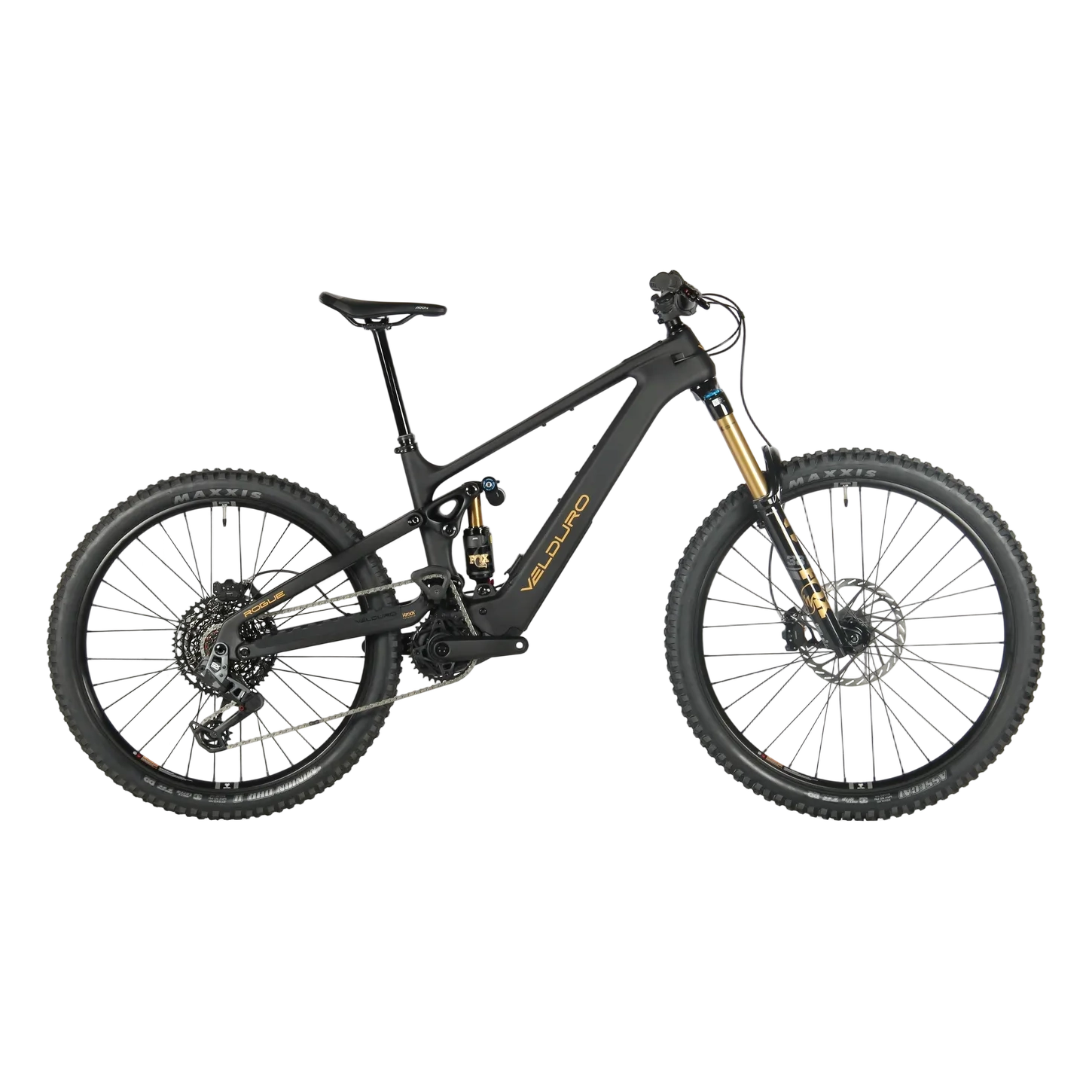

Pricing is good, I think the chainstay lengths are a bit of a let down. If things go well for them, (and they are reading this) maybe consider a longer CS option, say, 460?
I'm sure the CS lengthen considerably at sag, probably about 10-18mm.
I agree proportional chainstays are a huge + for people at the either end of the spectrum. For me in the medium bike size range that chainstay for a mid pivot is bang on the money.
That CS length will work well for M and L. Not so much for S and XL
Of course there's an additional cost for added cs lengths in expensive carbon moulds, tweaking kinematics, testing etc.
The question has to be asked. How many size small and size XL bikes will they sell and does that justify the additional expense?

Yeah ok thanks, something to consider on effects to sizing.... the Rogue sizing sets me up for a S and currently ride a M bike reach 450 - TT 585.... height at 170cm
Due to sag increase with mid high pivot as in proportion effectiveness to CS length..... can you please offer an example to change of performance.... the changes of riding handling to nature that could be expected with sizes S XL...
My riding position preference is rearward or back.... Im getting size S to proportion will shift to a more forward riding position.

To give you a reference point. I have
Deviate claymore high pivot 170/180mm 435cs/460 reach
Trek session mid high pivot 200/200 445 cs465 reach
Crestline S180 VPP 180/180mm CS445/455 reach.
The big advantage of the mid and high pivots is that the rear grows and the bike becomes more stable and speed when diving deeper into its travel and more nimble when using less travel. They also feel the square edge hits as the rear wheel kind of climbs up and over the obstactle.
However wheelies and manuals are harder. My harderest to wheelie or manual bike I have is the claymore as the high pivot changes the cs as you pull for the manual. It makes for funky manualling. My easiest to manual bike is the crestline at 445 chainstay. That has a small amount of rearward path but not much.
When buying a high or mid pivot you really need to consider the sagged CS length. That is what you will actually be riding. My deviate is sags out to 445ish when seating getting to my ideal cs length. That matches the crestline cs length. The DH bike will sag out further and give me closer to 455 cs. That suits its use case of a high speed stable dh bike.
For you riding a small you need to consider of the 440 cs unsagged, closer to 450 sagged, is going to be too long and feel like a bus of a bike that isnt very playful and is pretty damn hard if not impossible to manual.
For a size small i've like to see 430,435cs at the longest on a mid or high pivot bike.
