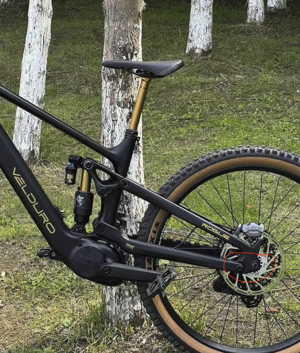

I welcome any long-travel DJI bike with high-pivot and Horst Link. Dare I say it looks a bit sexier than the E-Druid.

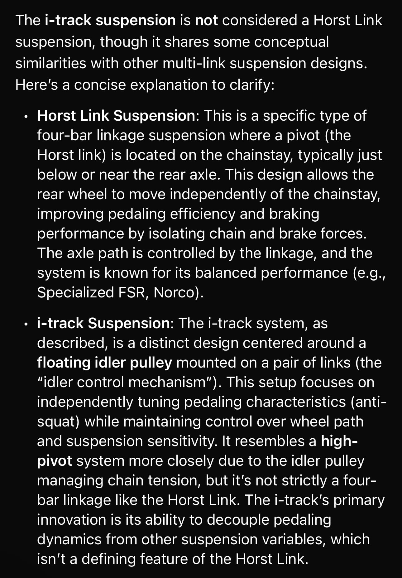

And yes it is a Horst Link bike, or at least certainly sports one. Looking at the I-Track patent, there is nothing about the patent that necessitates its use. The patent really hinges (no pun intended) around locating the pulley on the chainstay as they suggest I-Track can be used on multiple kinds or rear suspension designs (single-pivot, slider and slider, 4-bar, 6-bar, etc.).
The bake-off here will be between this bike and the Forbidden, as pulley location will be the main design difference between them; geometry and other aesthetics aside.
Hey man, didn't mean to derail this thread or attack you in any way. The suspension layouts do indeed look very similar in regards to high pivot, idler and rocker link, but still the fact remains that Trek's and Velduro's designs are different. You can see by yourself that Trek doesn't use a chainstay pivot, they have a concentric pivot around rear axle that they call ABP (Active Braking Pivot) and use on vast majority of their full suspension bikes. And have been for ages. Orbea has a similar design, I am familiar with it from my last Rallon.

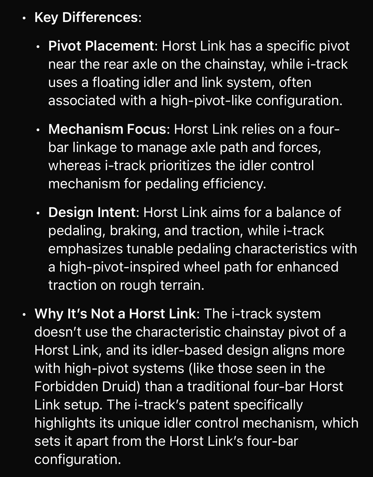

Velduro definitely uses a 4-bar design with a pivot on chainstay. I don't know if the text you posted is meant for Velduro bike, and why or who claims it doesn't have a chainstay pivot. When all we need to do is look at the picture...
Anyway, sorry again for derailing this thread with my comment, this is pretty insignificant for the bike itself which I definitely find interesting!
I was just going off of what they discussed in the YouTube video I watched. There’s one talking about all of the upcoming bikes running the DJI Avinox system.
In the video they said Velduro, Trek and Norco license the I-track suspension design, I’m not surprised Trek calls it something else.
itrack and apb are 2 different things. itrack license is for the position of the idler only
apb means the rearmost pivot of the rear triangle is centrered on the wheel axle. It works really well I think.
But hopefully the iTrack (what a stupid name) will make it work just as well under braking too.

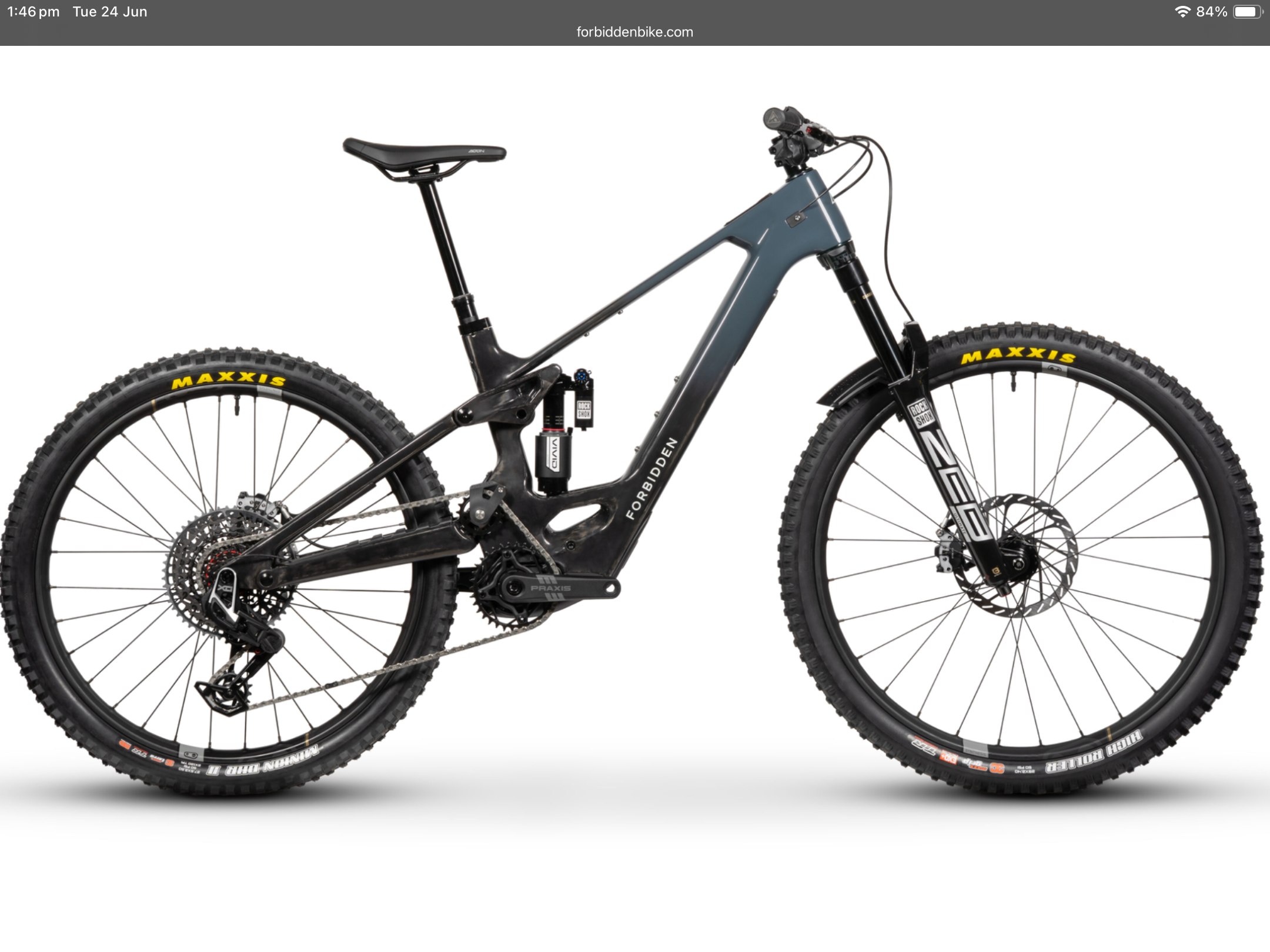

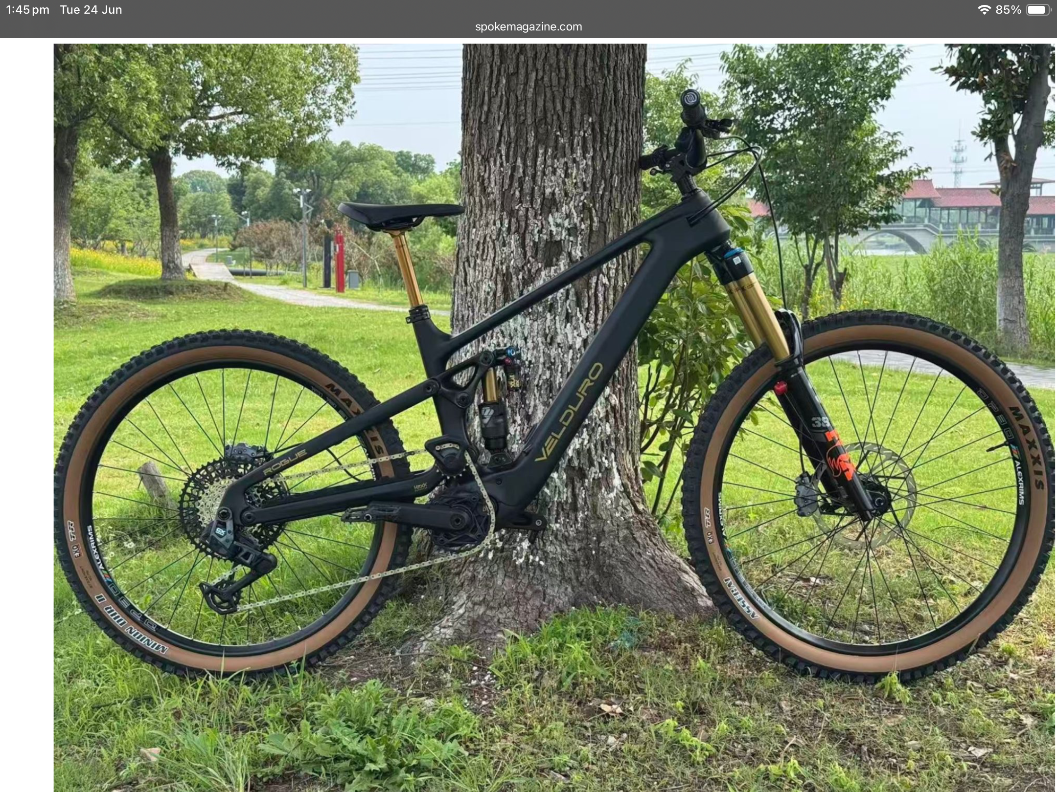

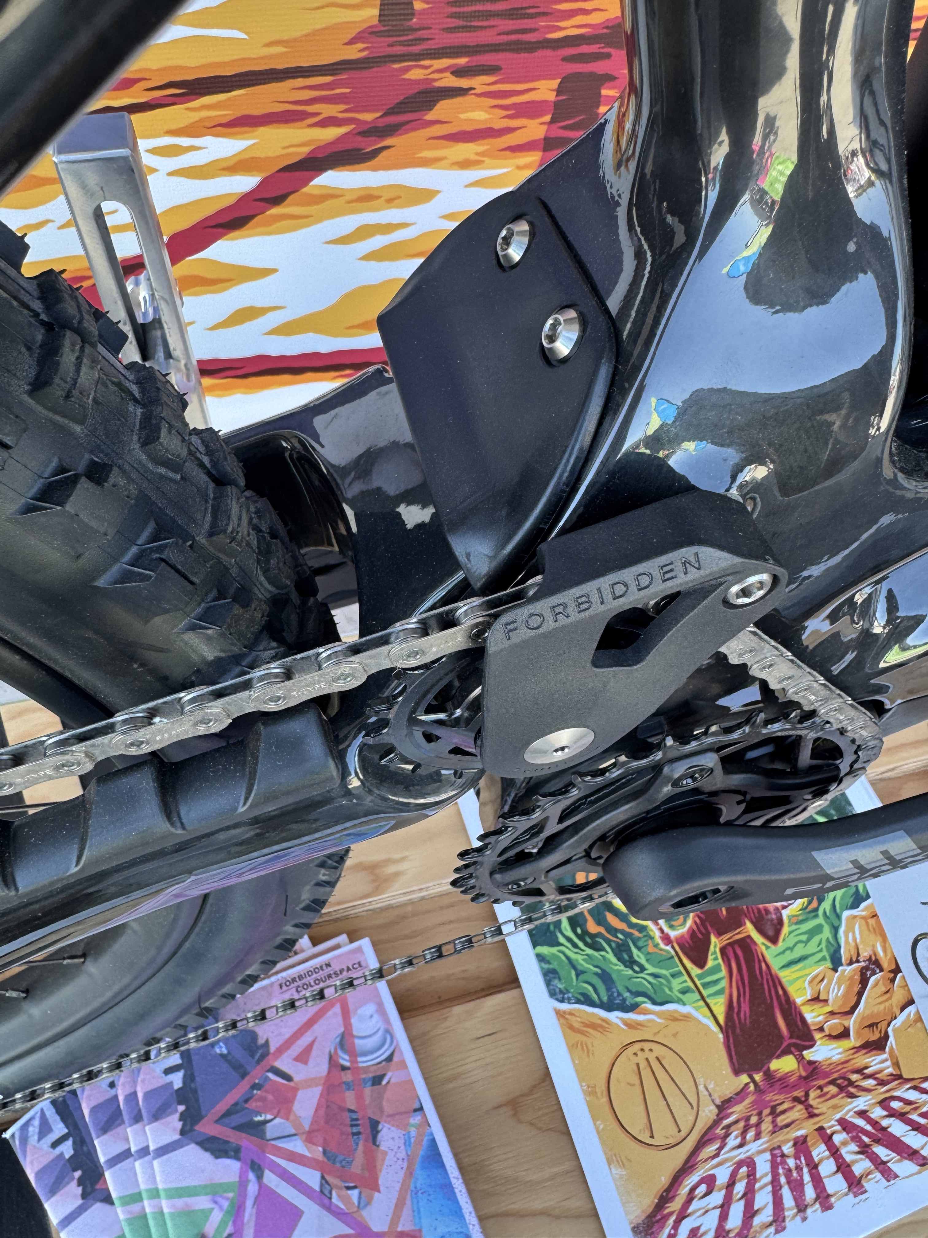

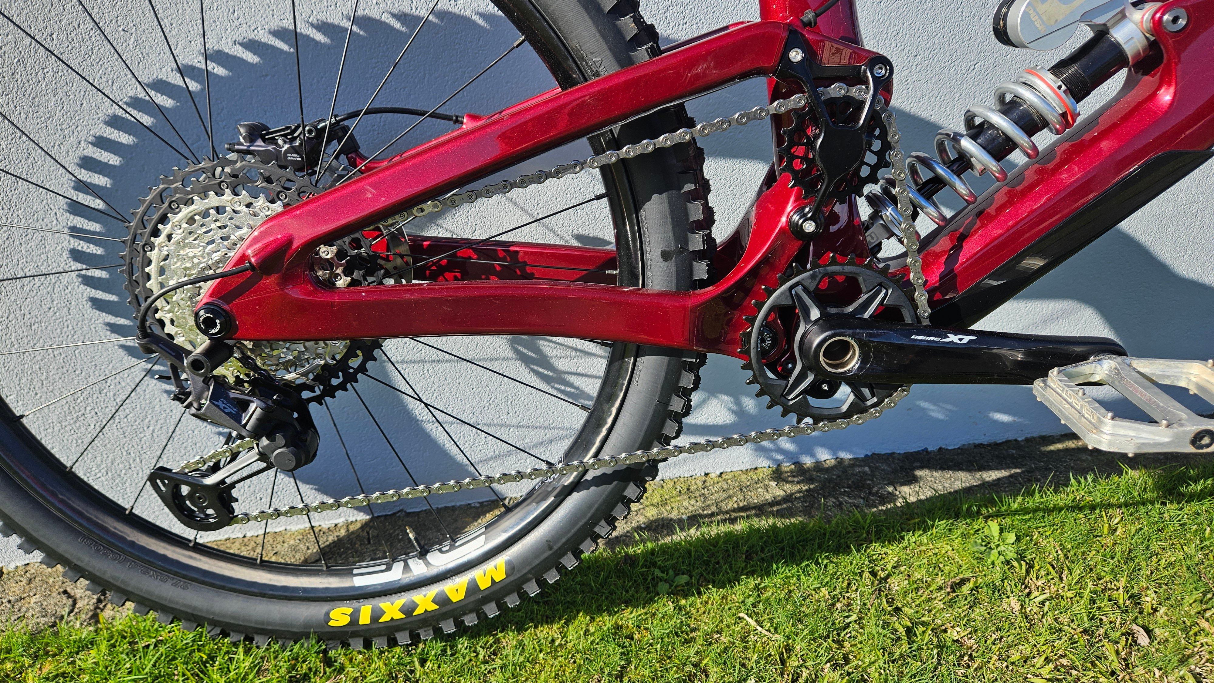

Seeing the high pivot position from the Forbidden and Velduro... Forbidden idler appears to be positioned and accessing through the CS pivot and set back behind the BB.... Where as the Rogue's idler location set closer above the BB while placed on the CS and not placed through CS pivot.....
My question here would be, these idler and CS differences would provide to a individual ride characteristic, then adding to a shock tune to enhance this performance. Can anyone add on to further provide knowledge on how the two bikes with idler pivot positioning with respect of each design may feel upon the trail.....
Cheers!
Cheers!View attachment 162957View attachment 162958
That's the $64K question and it's interesting to see them juxtaposed. The Forbidden "looks" the high-pivot part with the pivot noticeably higher and to the aft compared to the Rogue. The Rogue's lower high-pivot is actually fore of the BB with the idler near stacked on top of the BB pivot of the Rogue looks more like a traditional four-bar if you squint, even though they both have Horst Links. Perhaps that's why the bike doesn't call attention to itself as others have noted, though I'm a bit drawn to this bike for precisely that reason.

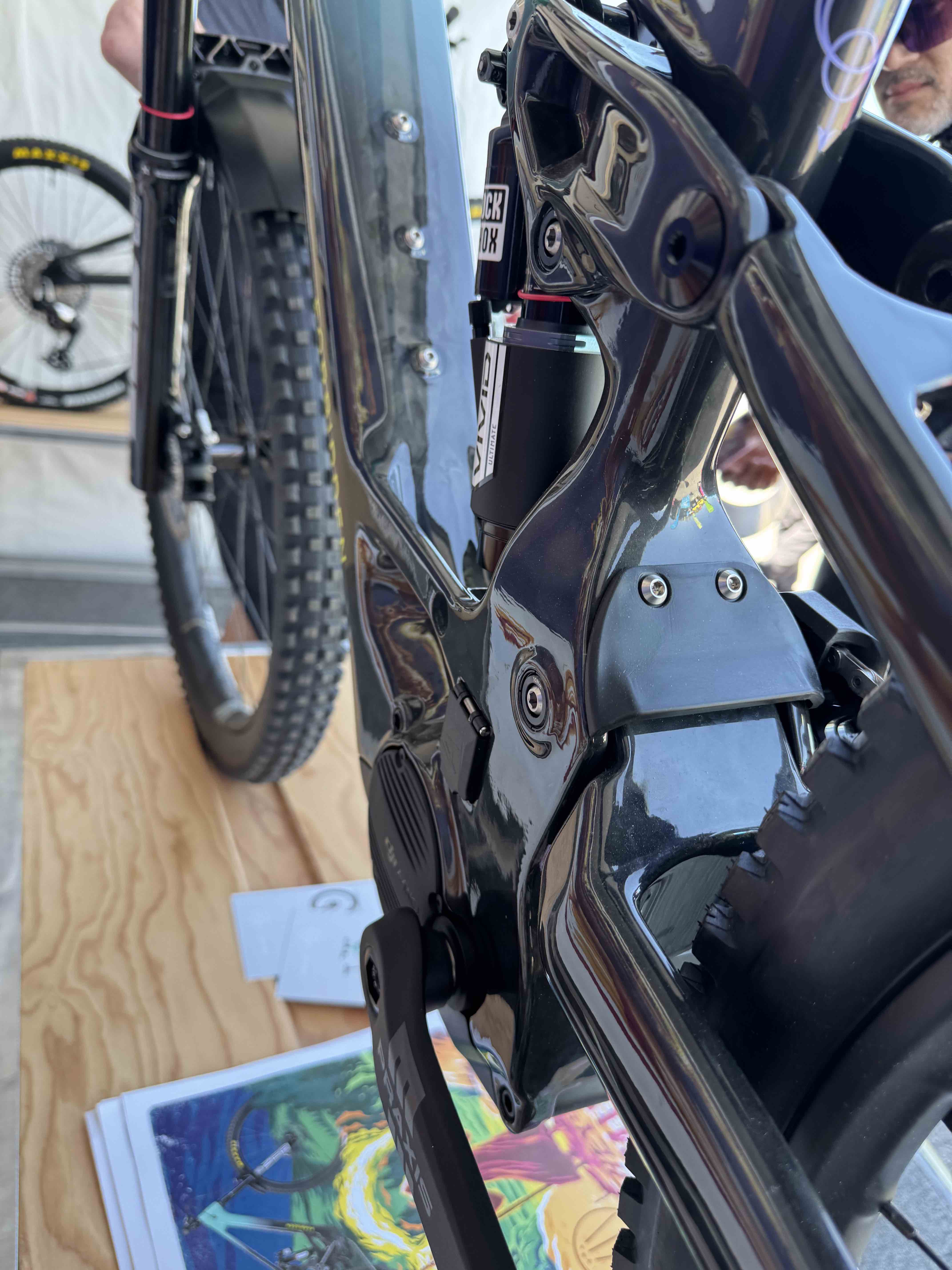

Here is the pivot location closeup of the Forbidden and looks to have the pivot right (about) on the axis of the chainstay pivot, where you would expect it for the chain to track with the pivot:
For the Rogue, the I-track pulley seems hardly further down on the chainstay until your realize just how forward the chainstay pivot is, that it's actually front of the seat tube! Also interesting is the pulley appears to be below the chainstay pivot as well. All of this could be some kind of I-Track sorcery, but I wouldn't be surprised if these bikes behave quite differently on test. Time to put these bikes through the Linkage Design software for a full blown analysis.
View attachment 162969 View attachment 162970
I would expect the forbidden being a higher pivot to have more rear ward axle path and more chainstay growth compared to the velduro. Forbidden will have better square edge bump absorption, be more stable at speed, but will suck more to manual and wheelie and feel less playfull deeper into its travel.
Velcro being more mid pivot will feel more 4 bar link ish and will be a more playful bike to ride....
Was also leading up to with similar conclusion....
As with the Forbidden at 150mm bike of this stature to a high pivot rear wheel axel path takes out at best square edge hits without compromising its agility as its designed around 150mm travel, greater increase travel it become less of the bike its designed for offering optimum appeal.....
Rogue at 170mm mid high pivot has the availability to push deeper into its stoke when things get rowdy, giving to optimise its mid high pivot ability that with the CS pivot closer to BB the bike handling, some pop agility reminiscent to the 4 bar....

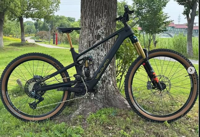

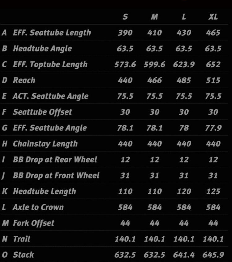

the first question is, which size of the velduro are we talking about here? with the same chainstay length over all models, they will all ride differently. the forbidden with its proportionally growing chainstay size will have the same ride in all sizes.
Nice!
Bit disappointed with the chainstay lengths, aside from that its looking good :)
A bit short (440mm) for the L & XL guys, but it does grow about 10mm at sag.
I'd like to see a bike that has chainstay length growth perfectly match the loss of front center as the fork compresses to maintain WB through the travel, for more consistency.

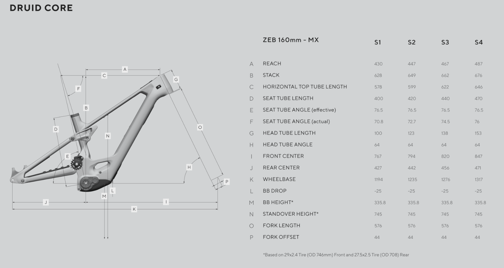

Well lets compare.
The closest comparison Is size M for Velduro and S3 for Druid core.
I personally prefer the Velduro rear center/chainstay of 440 and reach combo of 466 for mid pivot is reasonable. 556 is way way way to long for a high pivot bike for that sized reach of the bike. Bearing in mind the chainstay grows another 20mm... Jeeesus. It would be stable but like piloting a bus.
I do agree as you get to the L and XL in velduro the chainstay rear/center is too short. Conversly its too long on the druid..... plus the druid taps out at size large with rediculously long chainstays of 470...

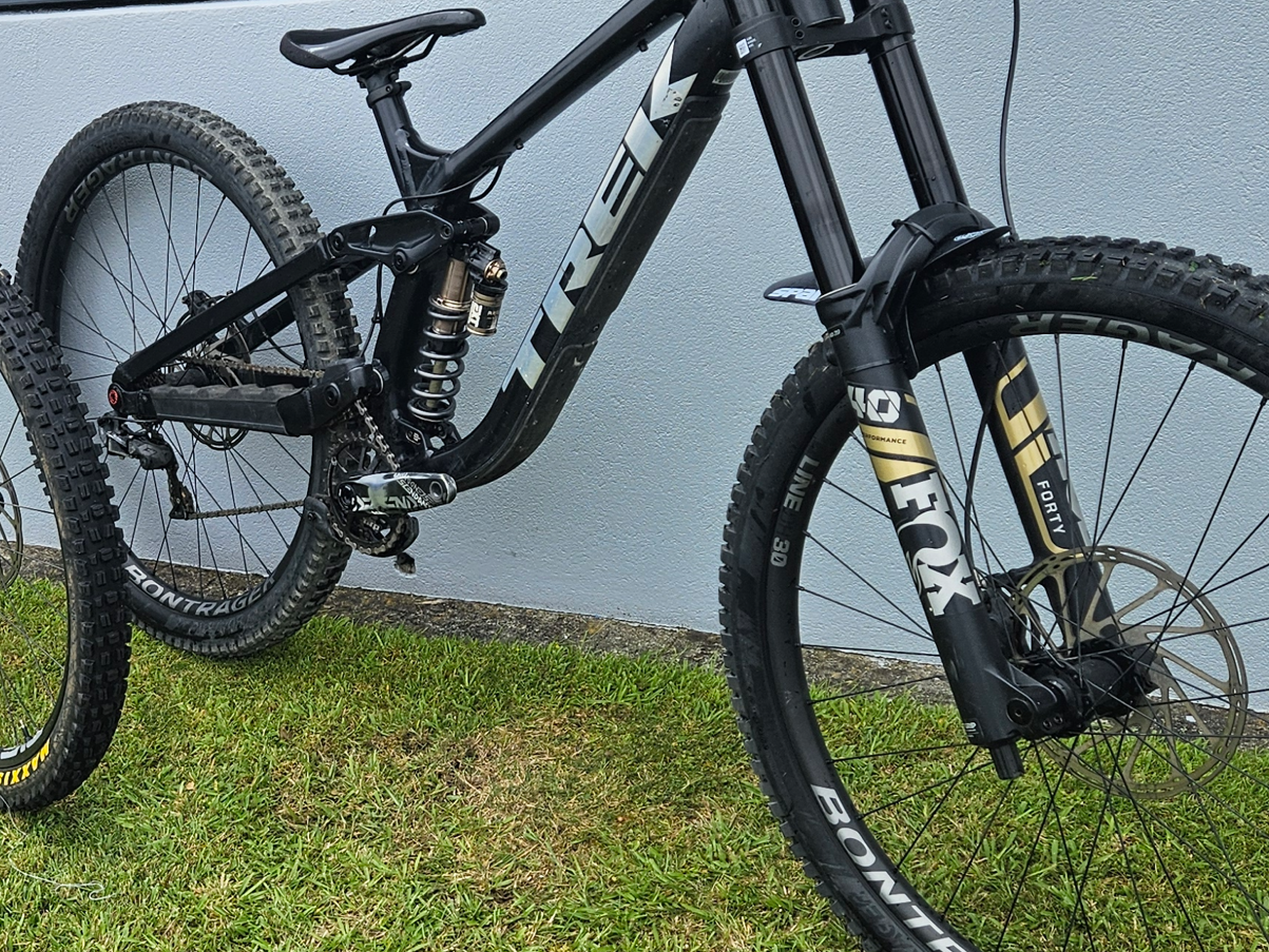

As a reference point on high pivots,
I have the following and i'm 180cm tall
High Pivot Deviate claymore 435 chainstay, 460 reach
Mid pivot Trek Session 445 chainstay, 465 reach
Plus I have a vpp in the Crestline
455 reach, 445 chain stay.
I also had a Voima
450 reach, 455 chain stay.
I don't want for a longer chainstay on a high than the claymore. At 435 its playful but still hard to manual and is plenty stable enough. The mid pivot 4 bar of the session is closest to the velduro spec (except with 200mm of travel). The 445 chainstay for me is as long as i want to go. Its a bit long for a mid pivot for general riding but bang on for high speed required for a dh rig.
I hated the 455 chainstay and heavy big battery of the voima. It made for an impossible to manual bike for me. It was stable but felt like a bus in the tighter stuff. Event though it had a shorter reach.
The Crestline at 445 rear non high pivot vpp feels optimal for me. Interestingly it is the easiest bike to manual with the 400wh battery installed.... Those high pivots are hard to manual bikes as the chainstay grows it fucks with the balance pont.
