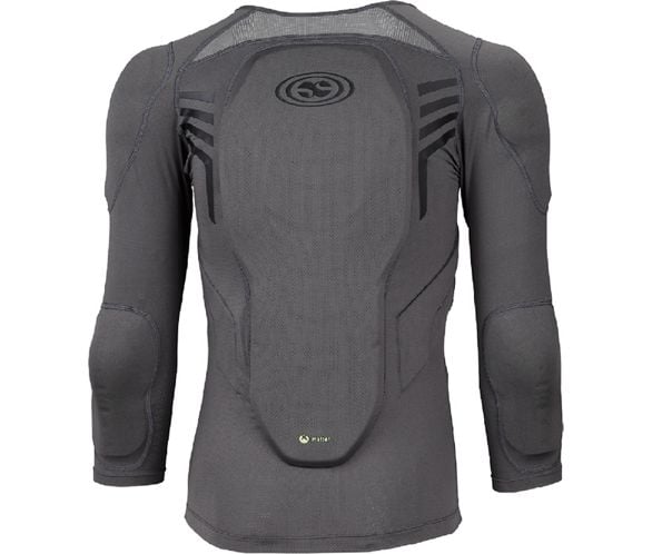

IXS Trigger upper body protection ..
Doesn't look like it offers more than the Knox and as far as I can ascertain, the armour is worse. Not very breathable.

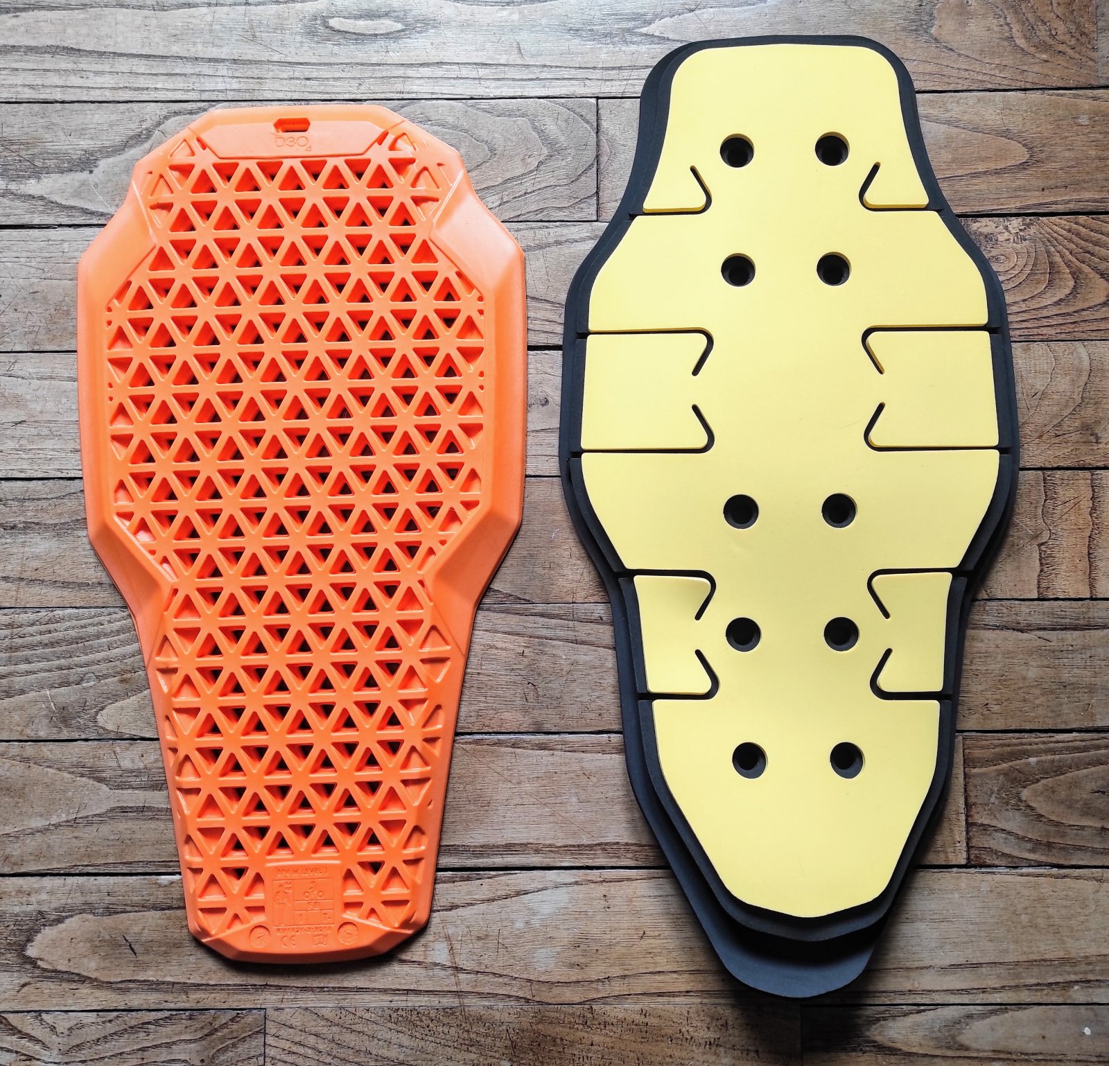

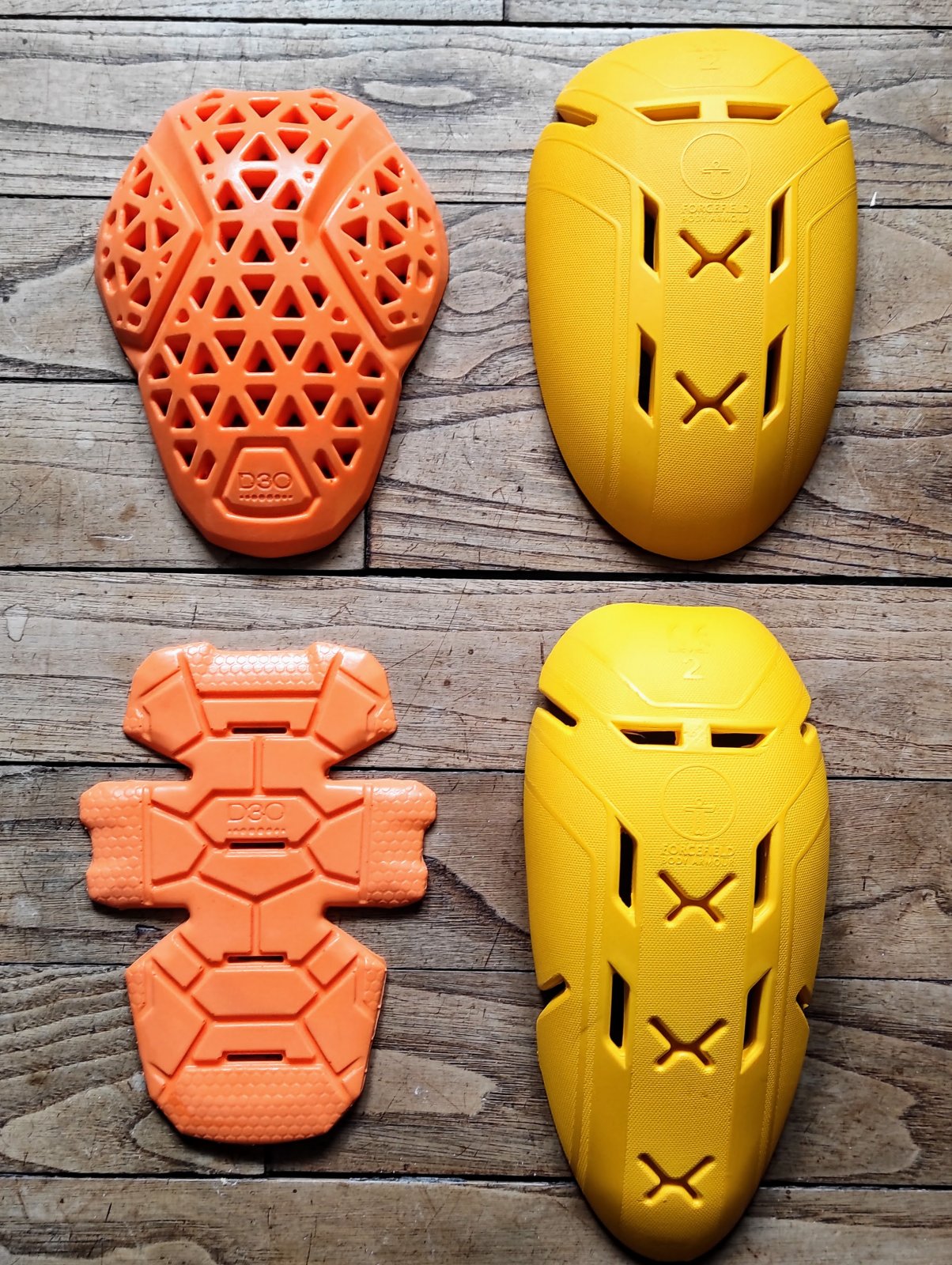

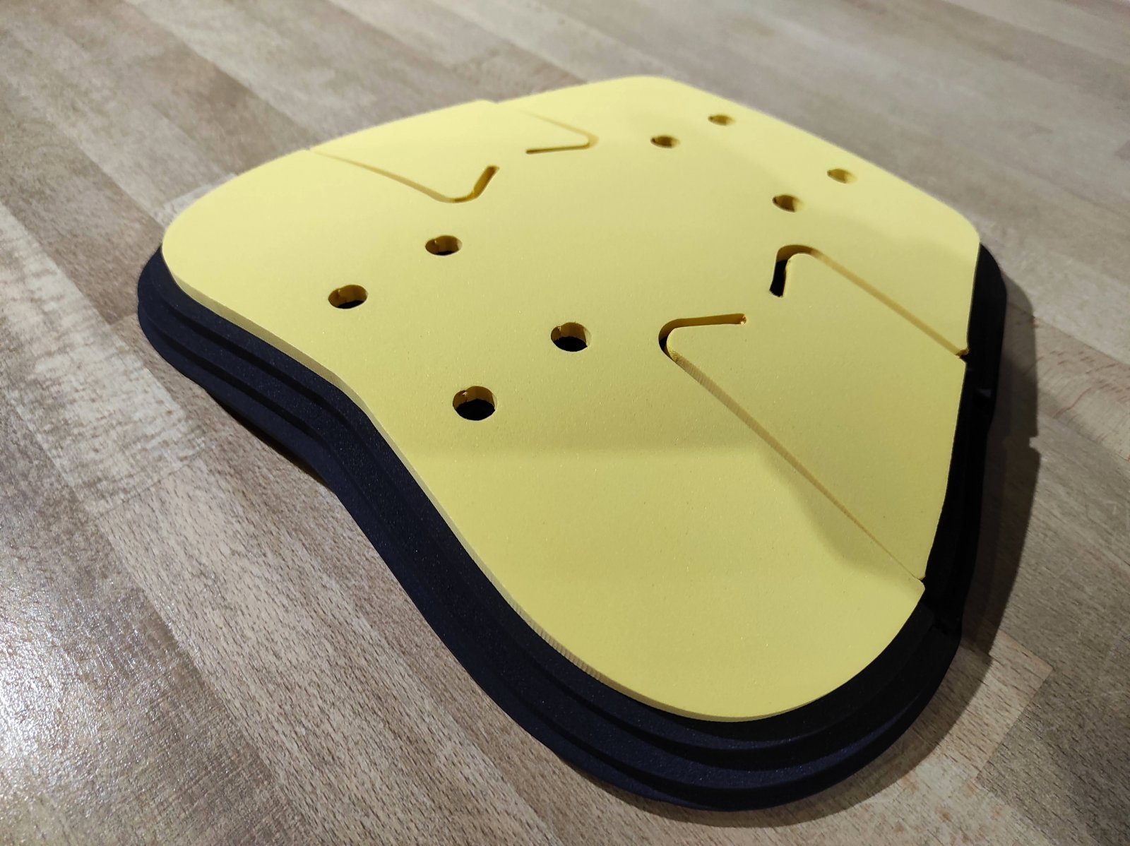

Just a couple of quick pictures .. D3O BP4 Back in Medium on the left . Force field CE2 Small on the right (the FF CE2 is lighter than the D3O CE1) :
D3O CE1 shoulders and elbows left . Forcefield CE2 right
Most pictures make the Forcefield chest armour look like a large slab of concrete, but it forms around your body. This is after a ride where it's already started to return to flat, but you can see it's curved.
The CE2 armour is quite thick (chest/back about 22mm - the same as D3O CE2) - so if you want to be stealth armoured - you won't be in the forcefield unless you have a jacket over it - another compromise !
