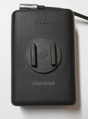

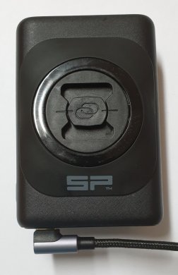

I use the SP connect adapters on the bike (steam mount pro) and on the phone. Having a powerbank (Charmast Powerbank 10000mAh) and attached SP connect adhesive adapters on both sides, so that I can stack the powerbank between the steam mount and the phone if I need it (plus a litte usb cable with rectangle connectors)
PS: This powerbank has the typical USB-A connectors (and micro USB for charging) but also a USB-C connector that supports fastcharge PD or QC 18W in both directions (for the phone as well as for the powerbank).
