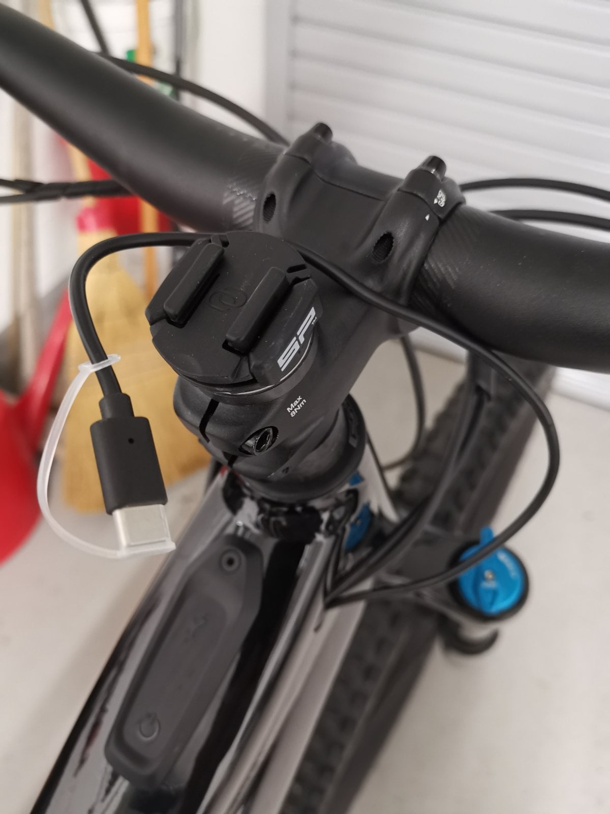

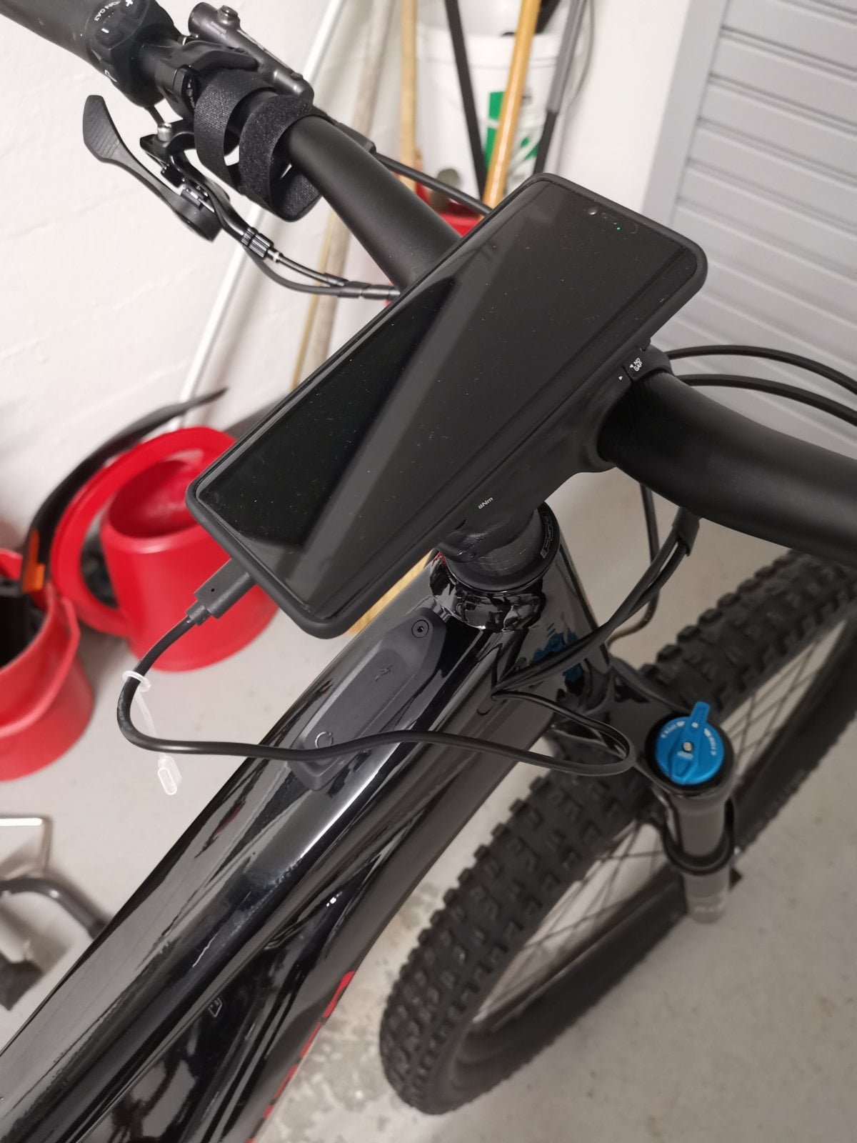

Maybe this might be helpful to achieve what you want:
www.sp-connect.eu/collections/bike/products/cable-wireless-charger
www.sp-connect.eu/collections/bike/products/wireless-charging-module
I got the charging cable from SP Connect fitted by my local Specialized dealer and he saw no implications as far as warranty is concerned. The cable is connected to the front light port and is therefore, switched on/off correctly with the power button. It converts the voltage accordingly without any additional device/converter - very simple. You can charge your phone either by connecting it directly via USB-C or indirectly using the wireless charger. Works perfectly.
View attachment 42170 View attachment 42171
Very neat job! Out of interest, does it offer enough amps for fast charging?
according to the definition of Quick Charge 2.0, it should support up to 2A. This is the case with the cable mentioned. It is not excactly hyper-fast charging but the same you get from your regular power supply based on the QC2.0 standard at home. Nevertheless, when used to connect your phone while riding, then it is not really a queston on 'recharging' but to simply keep the device on a reasonably charged level on long tour - at least this my typical use case.
