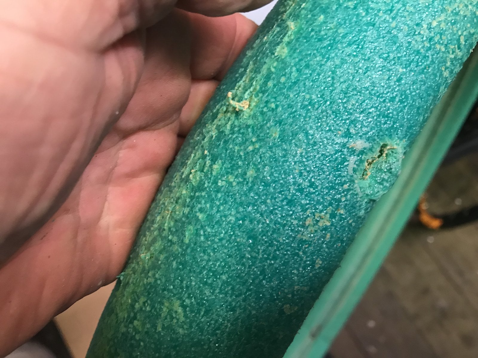

i have made my own,15mm pipe insulation,cut in half ,wrap with insulating tape every inch,it will take two lengths ,fix together with a zip tie,measure and cut to length connect with second zip tie ,and place in tyer,easy fit,cost £2,works will,i added stans sealent,i have tested this by running no preasure on grass ,fantastic

cut it length ways down the middle,there is a slot for the pipe use this slot to make the cut lengthways,i found it too big to fit inti a 2.6 butchers tyer and so i used the tape to make the foam narrower ,it then fits easy,the stans sealent doesnot soak into the foam

there is 3-4 people around here including me, that use this insert, works very well and the price is low.
riped a hole on the side wall of my tire, and rode almost 100 meter without any air inside, and rim was not in touch with the ground

The foam insert material needs to be a high density Closed-cell polymer. Hot water pipe insulation will be low density because more air volume means better thermal efficiency.
CushCore, Vittoria Air-Liner, etc. use a Closed-cell polymer and are therefore expensive. IMHO: the cheap options are rubbish.
IMHO: CushCore is the superior design; it really holds tyre hard against rim (to prevent burping), provides similar sidewall support (for running lower tyre pressures) and retains more tyre air volume so that the tyre can work as designed (conforming to shape ground for maximum grip).

Been using rat bites for a year now , well proven , cheapest lightest and for me so far 100% effective . They allow me to run a much lighter rear tyre , when I changed my tyre a while ago it was obvious they had saved my rear tyre at least 7 times
