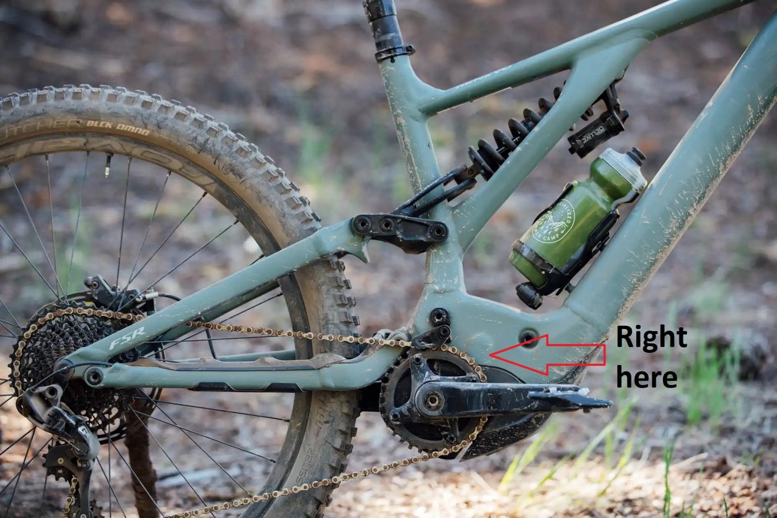

The bump on the drive side is for motor clearance and it tends to rub on motor. I ended up pulling the motor and adding some thermal pads that fixed the noise.

It's the motor rubbing on the inside of the frame on the drive side!

That sounds like a design flaw, and if so it would have done it right from the start. Why would it only start doing this recently ?
I think a return to bike shop is the only solution. There is still a month left on the 2 year warranty.
The clearance is very tight. sometimes some dirt gets in or the motor shifts slightly.
