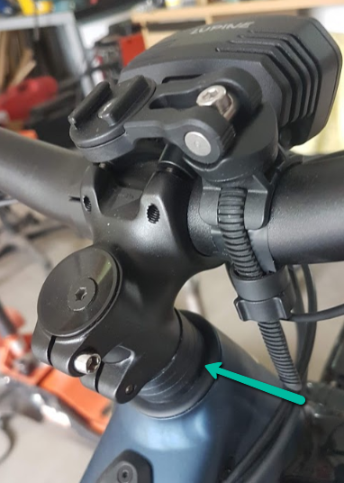

My bike also makes some creaking while ground is bumpy.
I tried put some teflon drylube between these shims but it didn't help. I think I'll try some other lube next time. Does anyone know which is the exact part that makes that noise?
