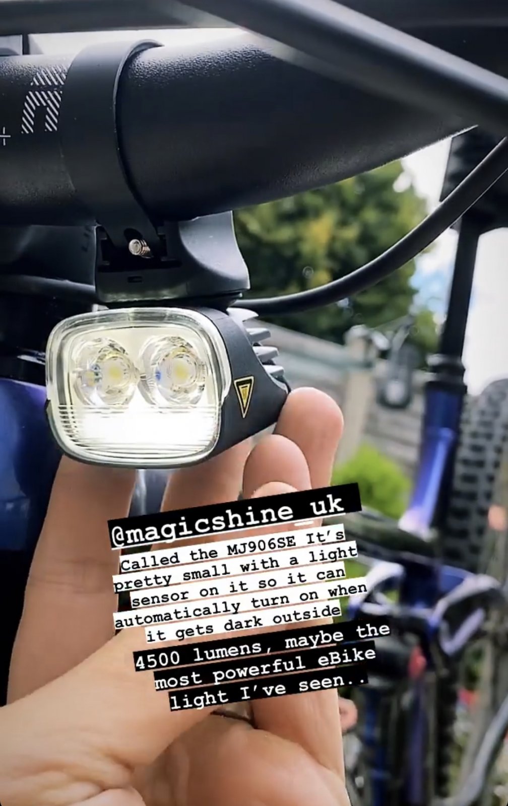

Ok I just spoke with the guys at Magicshine, I asked for a discount code.
if you use EMTB10 you’ll save 10% on this MJ906S light that I posted above:
Just tried the code, not working yet!
Hopefully soon.
Looks fantastic! Did you mount it to a rail? If so, did you cut the cable or did you get an extra extension from Magicshine?

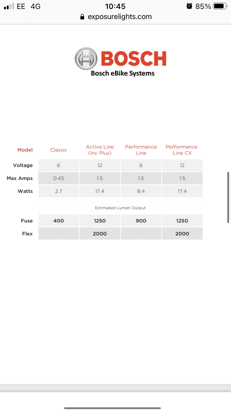

Hi Rob,
I was kicking myself for getting the lesser power/more expensive Exposure light!
I’ve looked into the detail.
Exposure Flex quoted max lumens = 3300
Magicshine quoted max lumens = 4500

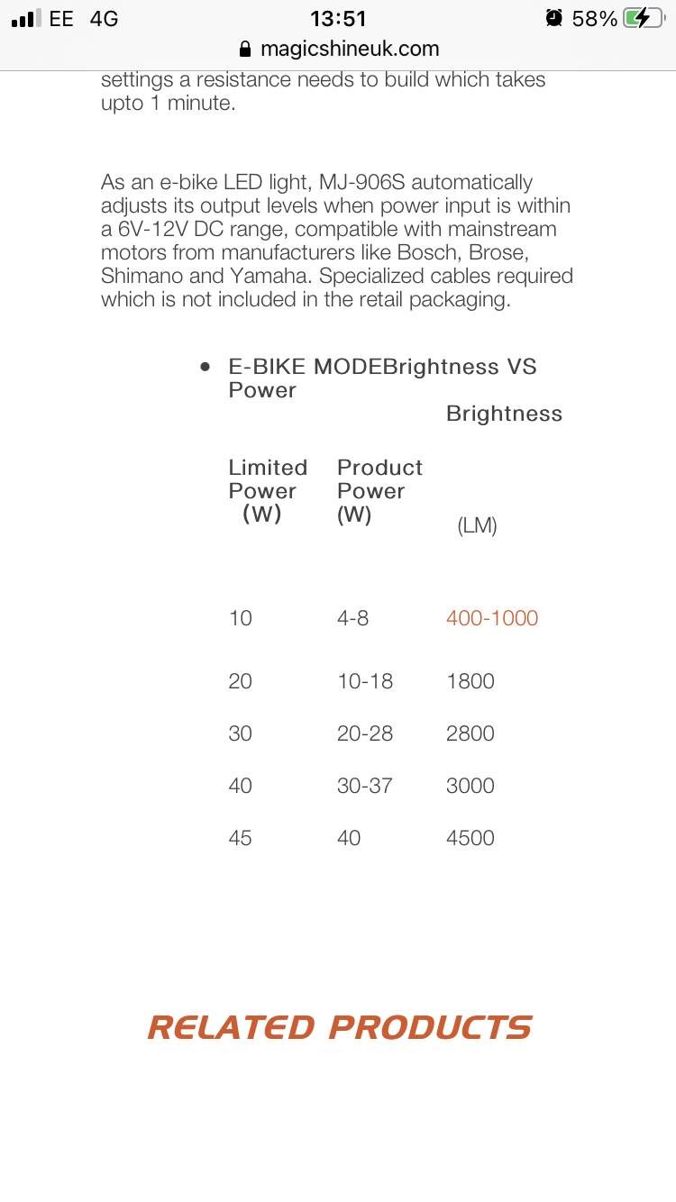

However these light outputs aren’t available to all Ebikes.
We are both using them on Rails/Bosch Gen4 bikes. Which has a 12v lighting circuit and a max current of 1.5amps / 18watts.
At this output the Magicshine quotes 1800lumens and Exposure 2000lumens
That’s good to know! So only 4500 lumens when connected to more power / external battery pack ?

Output Chart for the Flex
Guessing your Rise is EP8 Shimano? So quoted output is 2500lumens

So based on the maximum Lumens being limited by the max current of 1.5amps / 18watts, it's worth getting the Magicshine smaller brother as the output is the same, 1800 lumens maximum.
