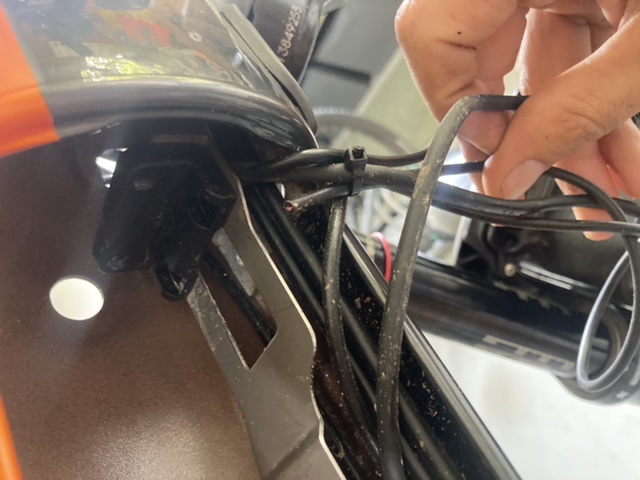

O boy. My LBS Did not know that there is an option and a wire to connect the light so I had to do it myself.
Anyone knows what to tell the LBS ? So he can know what to do? And my LBS is an Trek store, not regular LBS.
That's great they are a Trek store. They should have the software to enable the port. Mine is a Trek dealer, as well. I just asked them to activate my light port and they were like, no problem.

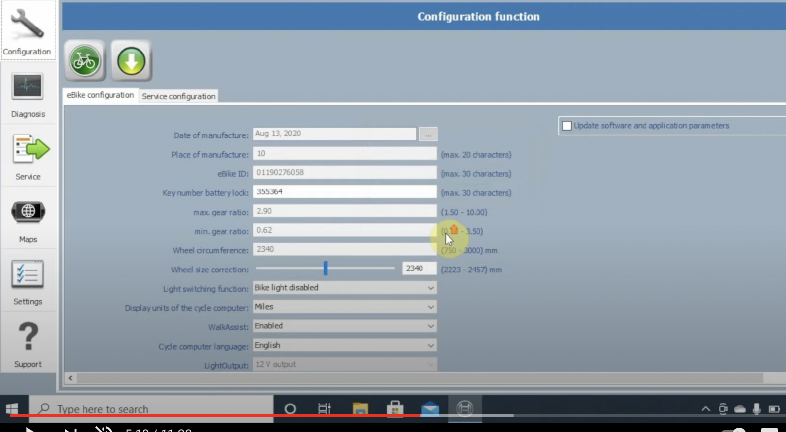

Found the option in Bosch software. So now I know what to tell the LBS. (see the bike light disabled drop down)
You need to take it to the LBS and have them activate the light in the software. i just went through this, using a Lezyne 1000 also. FYI the cable is just inside the frame where the other cables exit on the right. just remove the one screw pull the plastic guide piece out and use a flash light and a hook of stiff wire to pull it out. No messing with the battery mounts and all below.
Tnx. Did almost the same, only took the battery cover off. Was easier to solder the wires.

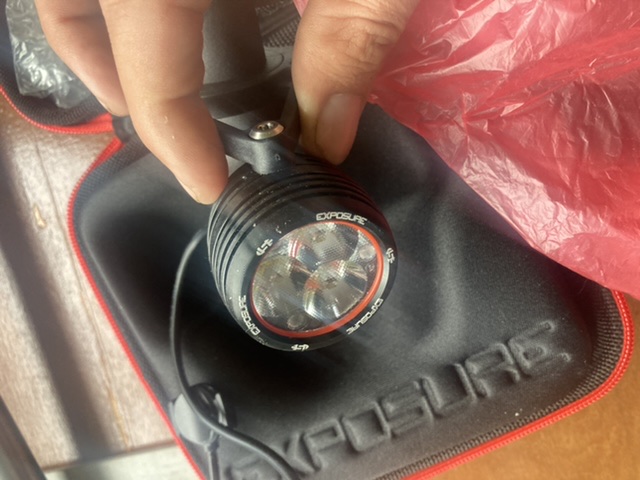

I got the LBS to enable the light option when I bought my Rail, I’ve had an Exposure Flex Ebike light for a month but not had a chance to fit it.
Now the nights are drawing in, I’ll be needing it.
Hopefully get it wired in this week.

yes there is an option in that drop down menu to have the light on Permanently, or switched by the Purion/Kiox.
so your LBS have just selected the wrong option for you.

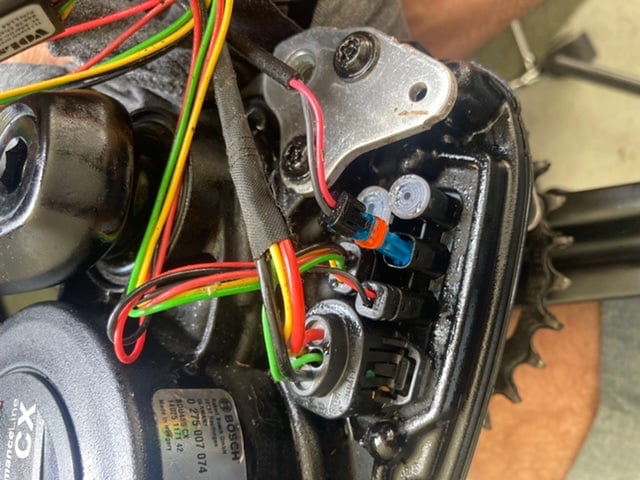

Hi, what perfect timing. I just installed a Lupine on my front handle bars and just got the Supernova tail light in today. Very easy to find the front wiring, just had to take out the lock and top battery connector and found the wires snap tied in a loop. Plenty of room to work. Now the back wires, do you have to remove the crank? It doesn't really sound like it, but I can't find any detail on where the tail light wires are accessible?

I’m unsure if the rear light loom is supplied on the 2021 Rail9. When I removed the motor to tighten the creaking motor mounts.
I don’t remember seeing the rear light tails.
won’t need to remove the crank, but you should be able to remove the bash guard and check the plugs on the side of the Gen4 CX motor.
(This photo has Volspeed Chip fitted)
You can buy the tail light loom
