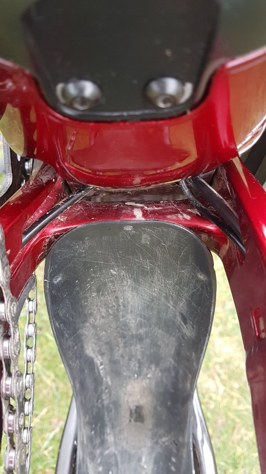

Hi,
Loving my Trek Rail 9.8 XT, already made some changes which I’ll highlight in the existing thread. I do have one concern though and that’s the cabling existing the bottom bracket area going to the chain stays - so the sensor, brake line and rear mech cable.
They currently cross over on exit and rub against each other and the stays. I would have thought that exiting straight into each stay would have been better. Is mine a one-off? I’m thinking of dropping the motor and re-routing them straight. Has anyone done this?
I know it would involve a complete re-route of the brake line from the lever because that’s of the banjo at the callipers - I’d actually prefer for the hose to enter on the right side of the head tube anyway so it would be two birds, one stone - UK spec, RH rear brake, FYI.
There’s already some rub and I can’t see the cables lasting terribly long in the current format. See pics:
Cheers,
James

Mine is the same. When i swapped my brakes I tried to re route the brake down the other wide, but with the cats cradle of wiring I couldn't get the motor back to it's mount points. I don't know if it's because there is less space that side, or just a PITA to do. I gave up in the end and just swapped it back.
I don't think you can run the cables the other way around the headtube as there isn't any spare holes in the internal eyelet, you already have the dropper & controller cable running in that side (well, I do on mine anyway).
I know Trek had a different bolt in cable guide that allowed for 3 cables on a different model (was either the early Slash 29, or Fuel - can't remember which). Whether it fits or not I have no idea, but could be an option.
Dropping motors & getting it all back together whilst trying not to pull/damage a cable was a headache, so i'm leaving mine alone. Likely you will also need a new cable too, as the current brake hose won't be long enough to go the 'long way' round the head tube.

leave it like it is, the cables need a bit of flex there to accomodate the swing of the rear triangle. When I dropped the motor to swap the brakes (shimano out, SRAM in) had a look and did the reroute. As already said, the motor would not mount propperly and the cables were tot tight. The cross patern gives the just the ammount of flex they need ;)

I always thought UK was the same as NZ, left-hand rear brake - and it was the US that was the opposite. Anyway, I can't see any reason at all why you can't re-route them, if it bothers you. Maybe over time it might be an issue with the outers rubbing on each other. It's quite easy to drop the motor. Break the chain, unplug the wiring, 6 bolts. Easy to tidy up the wiring so it's all routed nicely. Good idea when replacing the motor, before you torque up all the bolts, make sure the dropper cable is free to move, that way you won't need to drop the motor when it's time to service your dropper ;)

Thanks for the feedback all - first of all Philly G, you're right, it was typo, should have said LH rear brake hence RH entry port on frame.
When I do it's first big service I'll look to swap the Purion cable entry with the rear brake hose. The controller hose is really flexible so I'd prefer this to exit on the LH and then into the controller then I can use the (now) free port on the RH for the rear brake hose.
OK, if the cables have to cross that's fine, I'll just slide on some old camelbak hose I've got to stop the cable rub/wear. Boom!

My brakes are the same way round as you, and the cables are not crossed over where they enter the chainstays. I think it would annoy me too. The only way to fix it would be to disconnect the brake hose from the caliper, and the shift cable from the derailleur, pull them both back through the stays, re-route them through the correct exit holes in the motor cavity. It's kinda a big job for a small job, but I agree it doesn't look right and I would want to fix it too.

I've "corrected" the bottom bracket routing to the same as Philly's above. Very pleased I've done this because both the brake and rear mech cable/hose were already wearing the carbon exit ports on the chain stays!!
I also swapped the Purion control cable over with the rear brake hose - so now I have RH exit for the brake to the LH rear brake lever - far more feng shui.
Struggling to get the motor to sit without pressure to align the bolt holes, I need to do some cable fiddling...

James, sorry to hear about your crash! Hope you're out on the trails again soon. I didn't think about how the cables could wear away the carbon, it's lucky you've been able to sort it sooner rather than later! It is a bit tricky getting the motor back, I just made sure the wiring wasn't under tension and let the shift cable/brake hose just lie where they wanted. I don't think it would matter too much if the motor does press down on these a little, as long as they're not being crimped or crushed of course, and there is a bit more space above the motor than I thought initially. You'll get it sorted!

Anyway, more importantly, the cable routing. Good shout, I was looking to introduce as much slack as possible in the motor area - which probably means removing the bottom battery clamp connection unfortunately.
Still another week off the bike so time to get this perfect!
Then what do I "fix"...
Philly G
Jun 29, 2020
692
517
New Zealand
Good to hear you're on the mend! You shouldn't have to remove the battery connector, there is room underneath it (just) for the cables to slide.
I would just loosen, or remove, the two cable clamps on the downtube . This should allow you to feed through as much slack as you want. You want the dropper cable routed as naturally as possible so you can feed it through with the motor in place when it's time to service or swap out the dropper. I did a dry run with loosely bolting the motor in just to make sure the dropper cable would move. There is a sort of machined lip where the motor bolts in, and another lip below that, just let your electrical cables lie on that lower lip. There'll be enough slack that they'll plug into the motor OK, but they'll be out of the way so they won't get caught or pinched when you put the motor back . Sorry I don't have a better pic for you than this

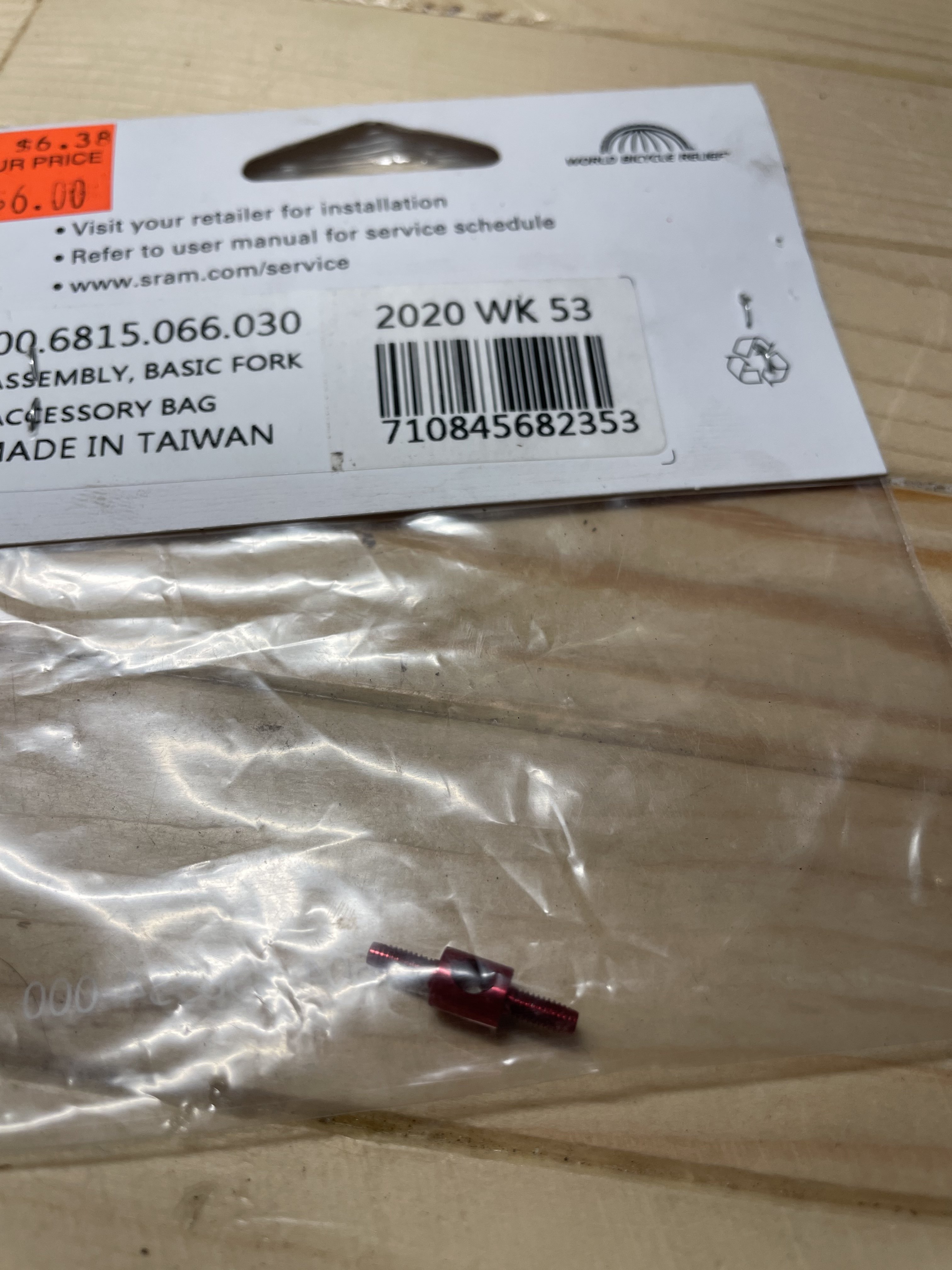

Ha, i just bought that hose connector. I'm replacing my dropper and really hoping that will attach the old and new hose so I can pull it all thru without dropping the motor. It's called the Rockshox Reverb Stealth Barb Connector.
Yah, that’s it. Cheapest little tool I’ve ever bought. Used it many times for new rear brake lines. Going through the head tube with a push/pull technique is a breeze now. I don’t want to misplace this little “gem” so I keep it in the original packaging.

Got it for less than $5 at my LBS. Unfortunately it didn't work for this application. My motor/wires are jamming the housing/hose for the dropper so it won't move. I'll have to drop the motor, buying the torx plus kit now.
Stihldog
Handheld Power Tool
Jun 10, 2020
2,469
3,331
Coquitlam, BC
Someone here mentioned using a small fine thread screw cut very short . Might work in a pinch?
