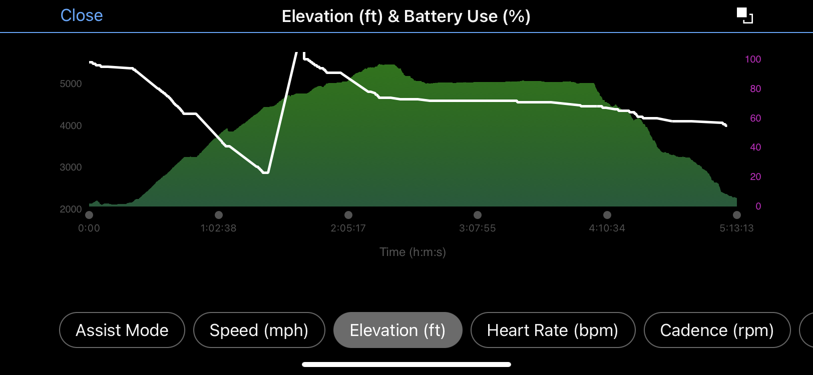

First “dual battery” backcountry adventure today. 4000’ vert, 22 miles, 10lb pack, all in boost. Swapped batteries when #1 was at 10%, #2 finished at 50%. Felt like riding a FF eBike. Recharging off solar!

Awesome, that is exactly what I wanted to hear. How did the 10 lbs on your back feel and how much water were you carrying?
It was an epic day! Early season and LOTS of trees down. I brought a folding saw and spend some time clearing. The climb was 11 miles on service roads, I was happy to spin that out in boost.
I had probably 40oz of water in pack + 16 on the bike, camera & clothes, pads,
saw, tools & a bunch of other junk. The pack weight was not bad at all, I could have brought a water filter and hauled a lot less water.

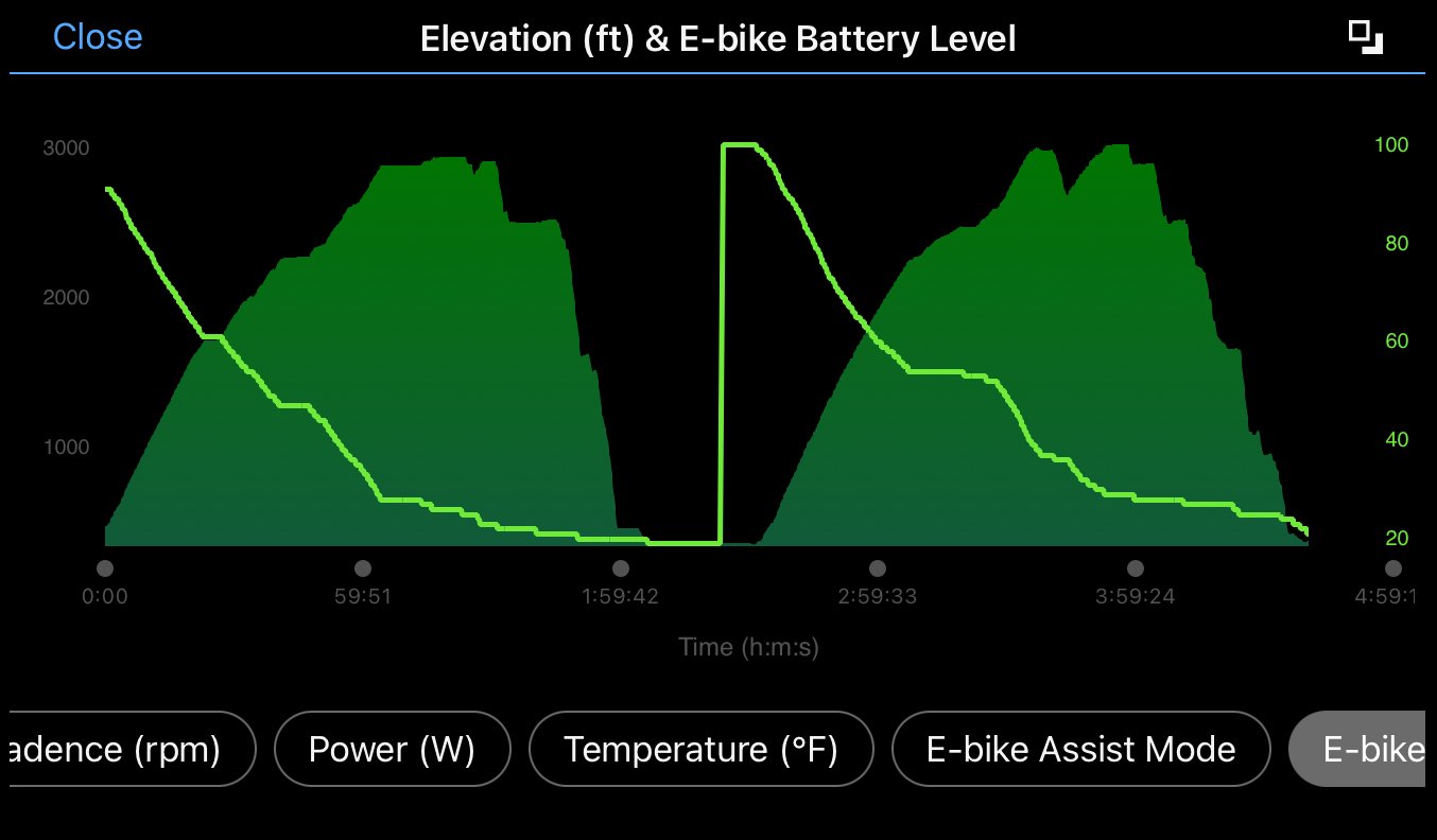

Todays dual battery adventure! 5,860 Up & down in 20 miles. So good! This was two separate loops from the same trailhead, so I was able to swap batteries at my car mid-ride. The first half was with 3 friends who were all on full-power ebikes, I was mostly in trail mode. Then they peeled off and second half was with another friend on a full power ebike. I was in trail/boost for lap 2. The descents were steep loam and conditions were incredible.
