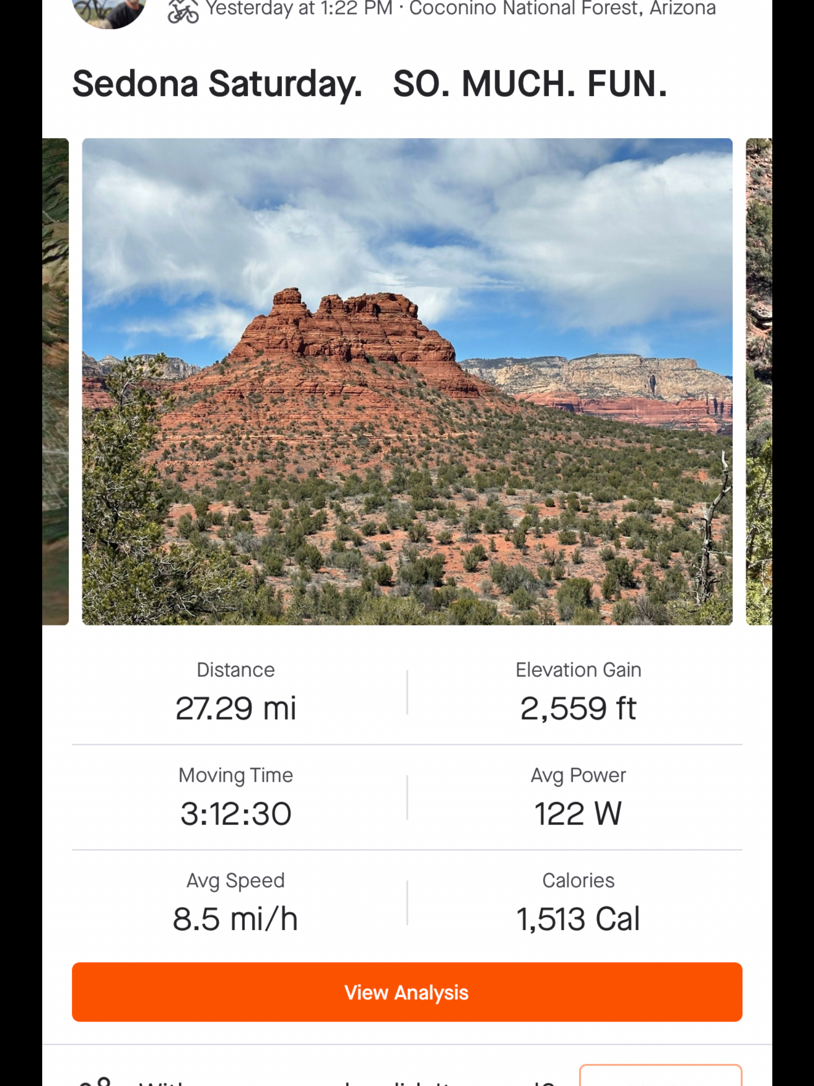

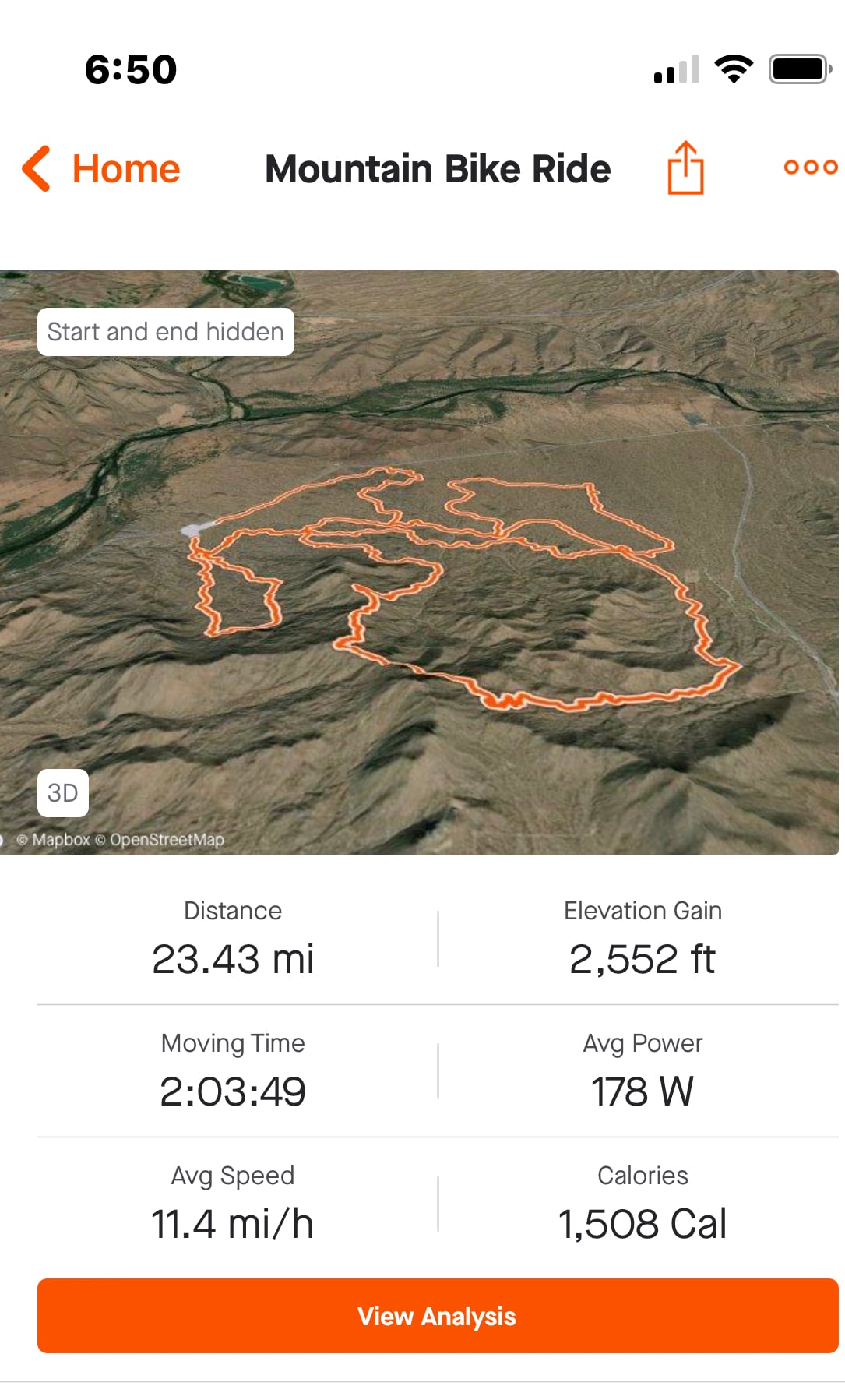

Just did 25.63 miles with 2,687‘ elevation. I had 4% battery left. I rode probably 1 mile with no assist towards the middle of the ride. I am 175 lbs ready to ride. I used a combination of all 3 assist modes.

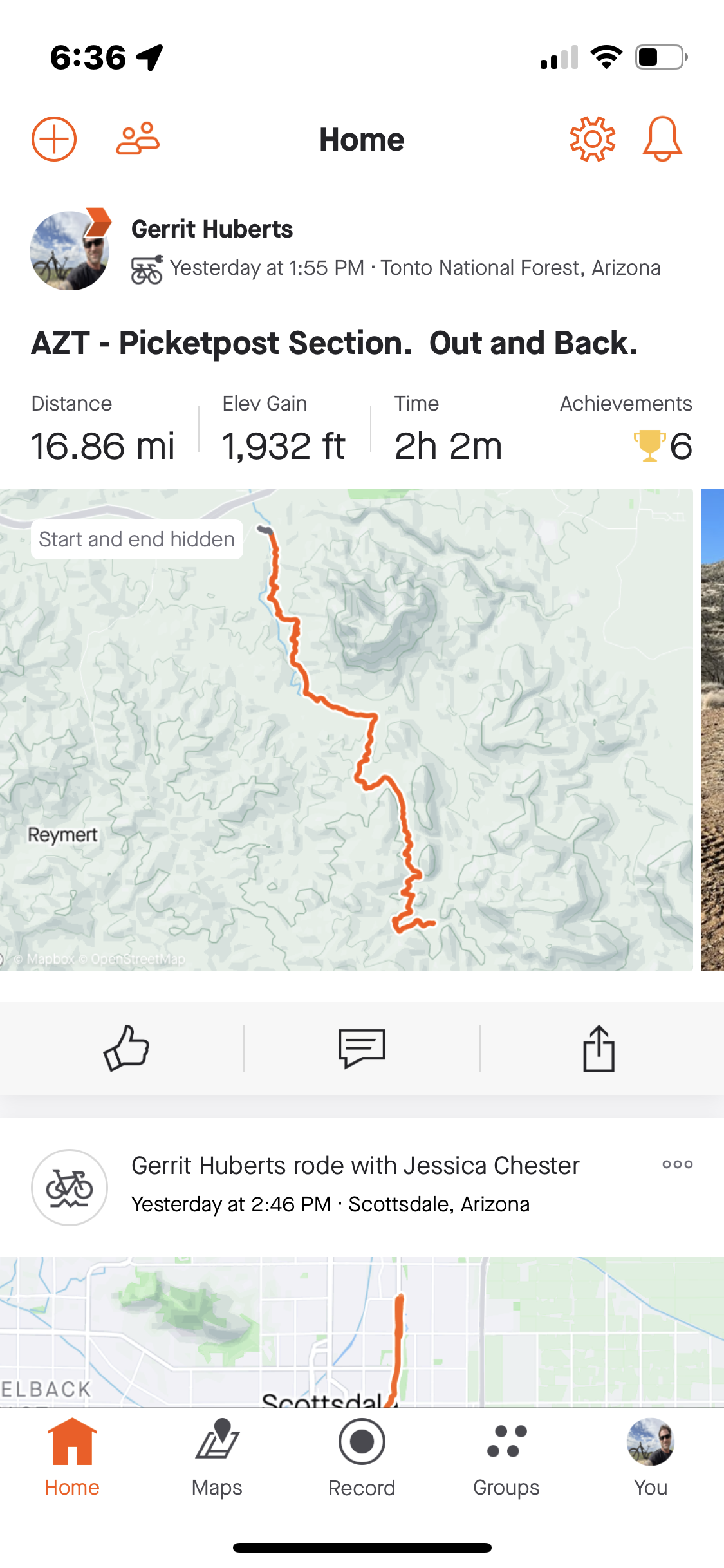

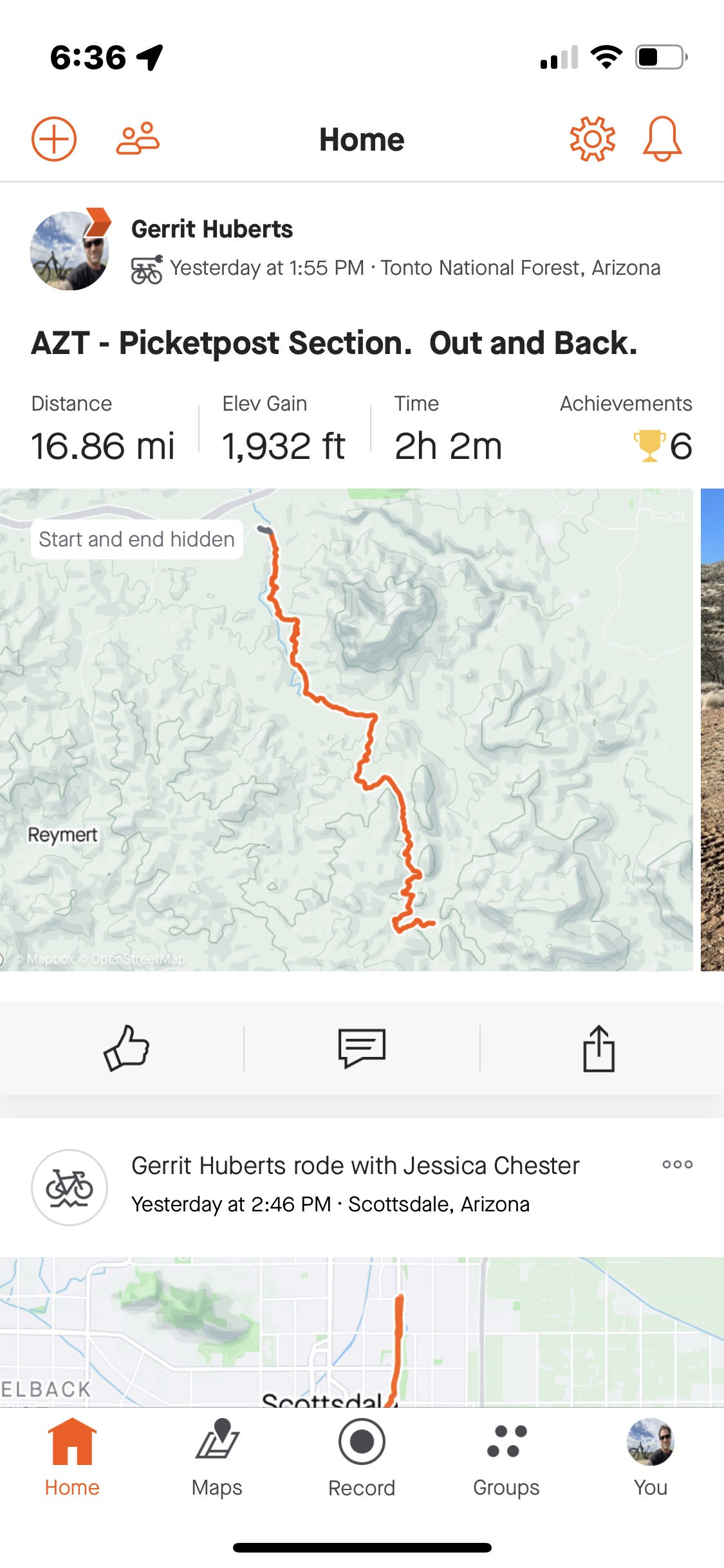

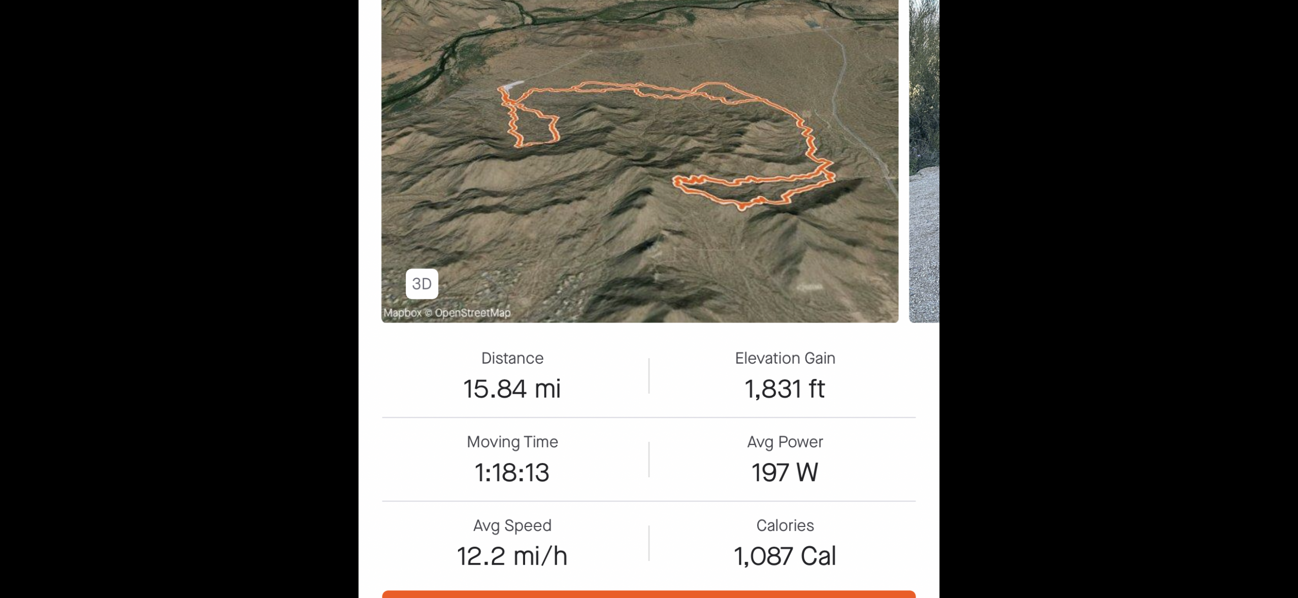

My ride yesterday was 16.86 miles and 1,932’ elevation.

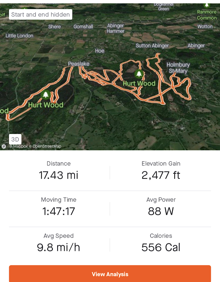

If you want to nerd out on data here are some rides I captured. Basically on the Levo SL I average 5-7 wh/mi for fun rides. I’m 210lbs and garmin says I’m 24 years old in fitness age which is About half my earth years.
I’m Sure with full power on the new trek it’ll easily be 30wh/mi or more climbing but if you give around 200 watts with your legs, That would legitimately be hauling ass up hill and that’s a full time hill climb.
my morning commutes are 4-5 wh/mi with super light wheels/tires and hard packed dirt/german paved trails.
View attachment 92721 View attachment 92722 View attachment 92723

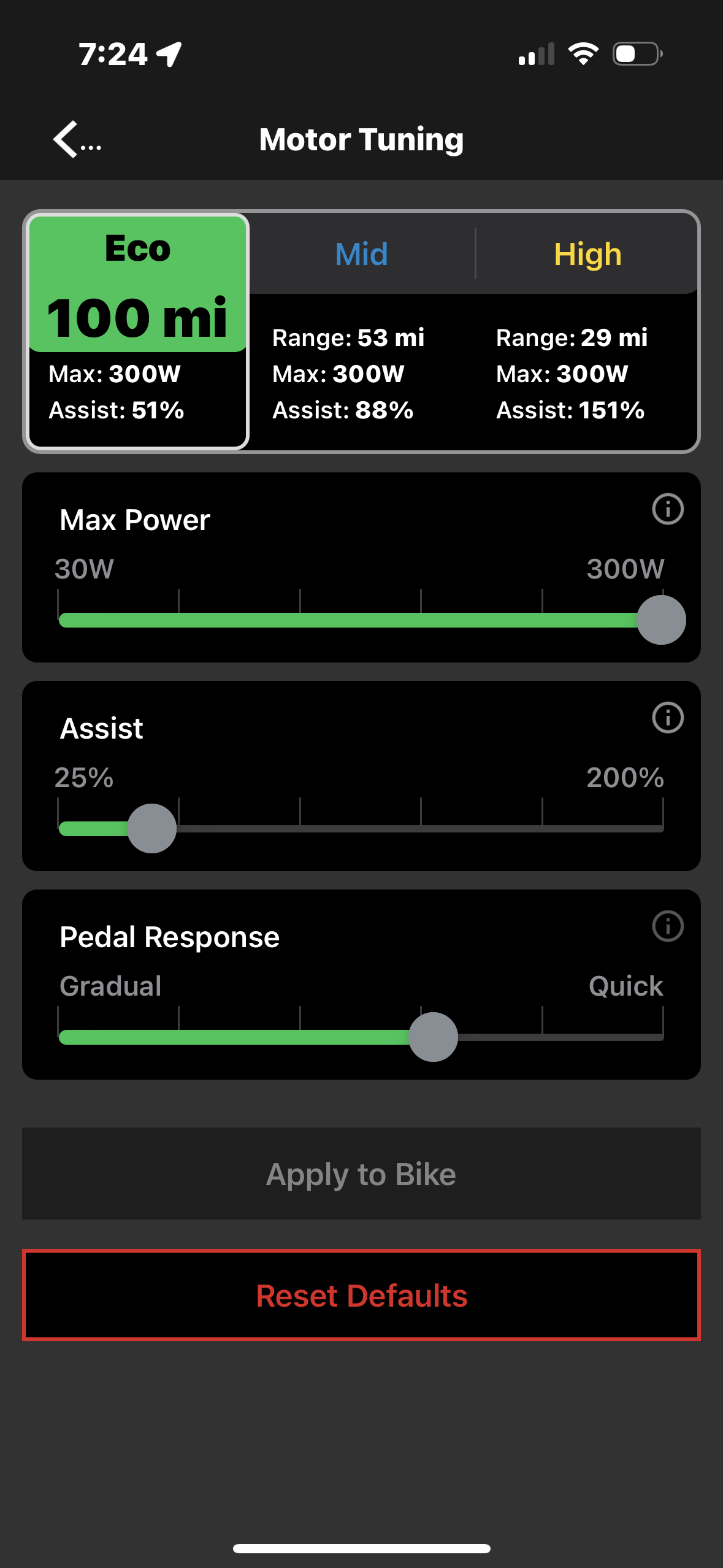

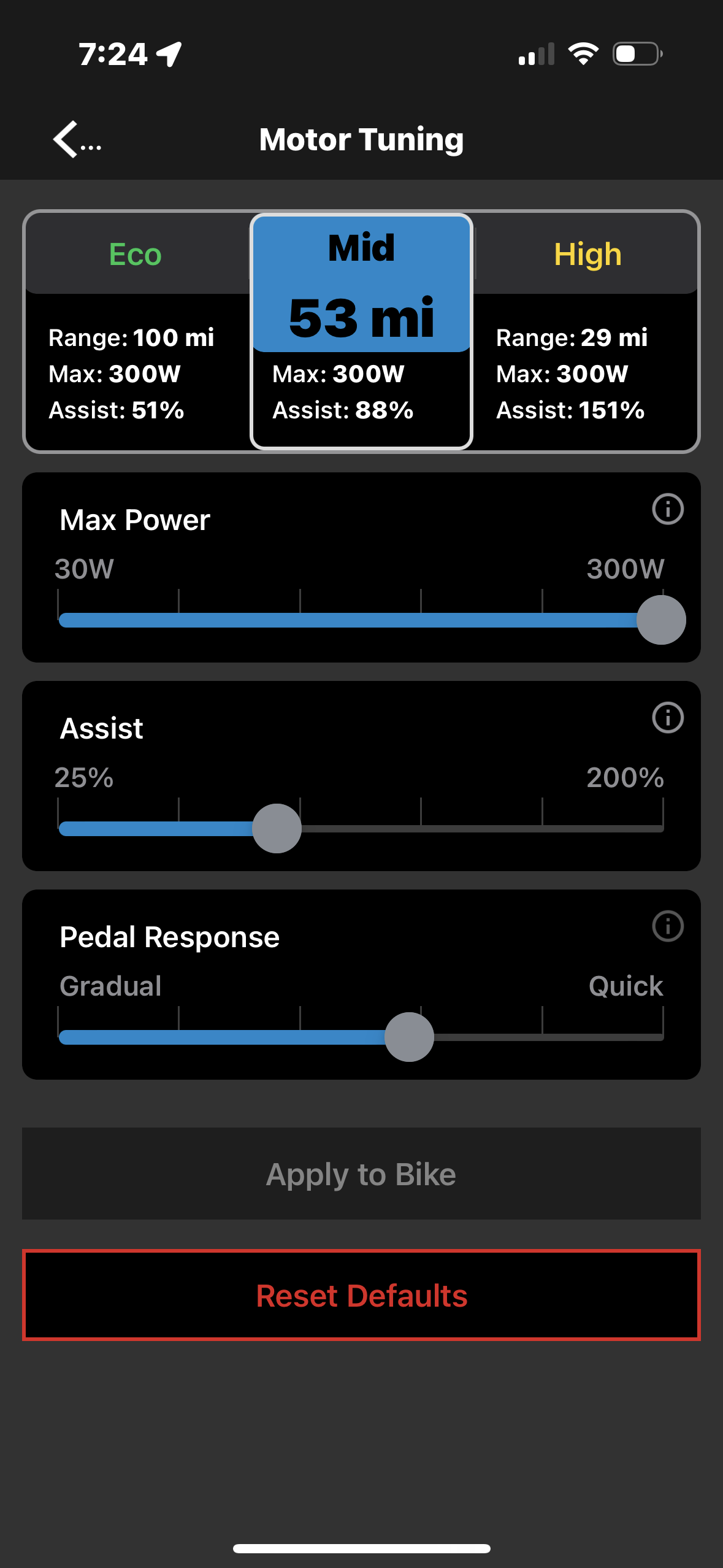

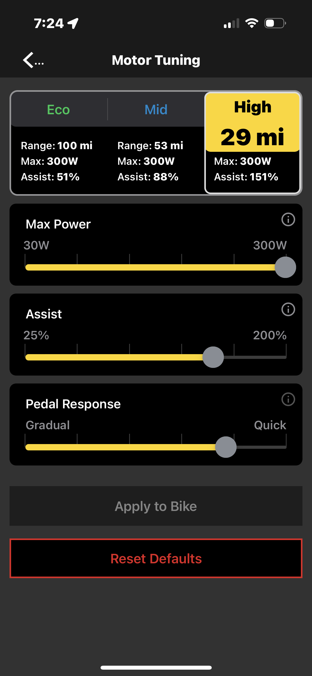

Did a ride yesterday. I finally felt pretty good about my range. My have been doing PT on my hip, so been off the bike for a month. I decided to ride in all mid and high mode, no eco. I am not sure why, but I had the same range as I did in eco. The mid settings re definitely higher on the Trek app. I had exactly 25% battery remaining. Here is the range and my current settings:

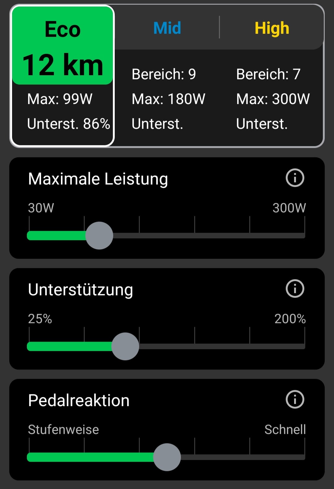

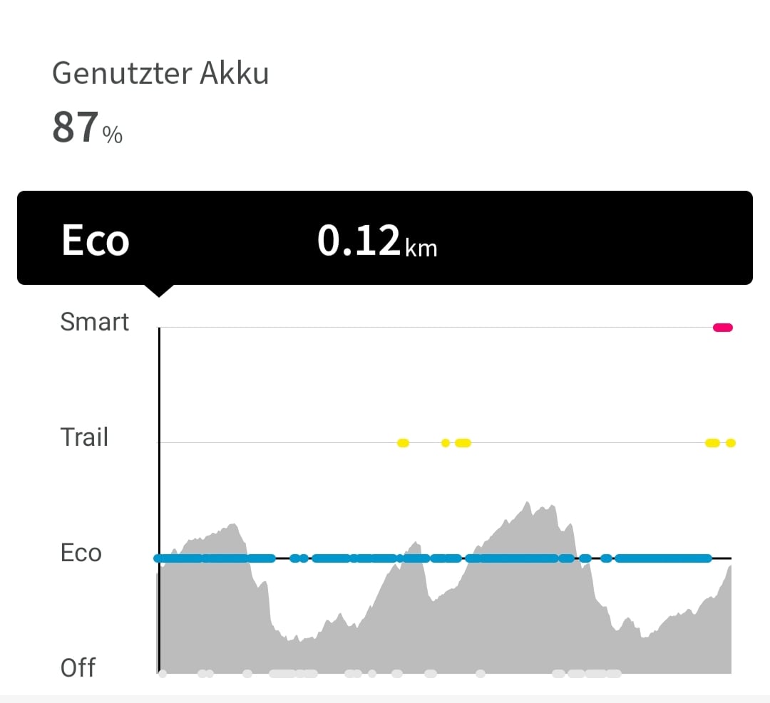

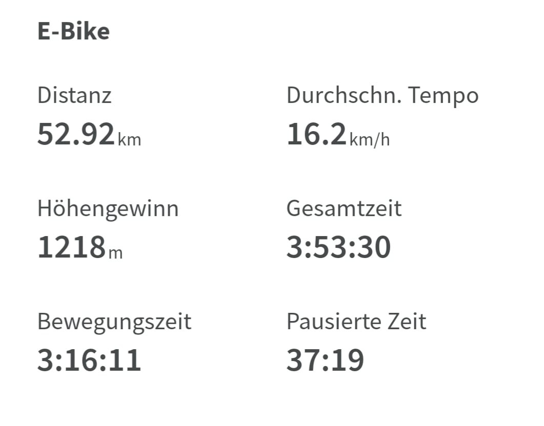

Yesterday ride
52.9km with 1218m elevation gain
most of the time in eco. 87% Battery used
this means 1400m elevation gain should be possible with 100% Battery. And season here in switzerland is just starting. Noticed from my trackedd powerprofile that I'm not yet in my usual fitness shape. So maybe even more. Love the fact that this bike pedals so easy. So with the right fitness one can extend the range quite a bit and only use the mltor for the really steep climbs.

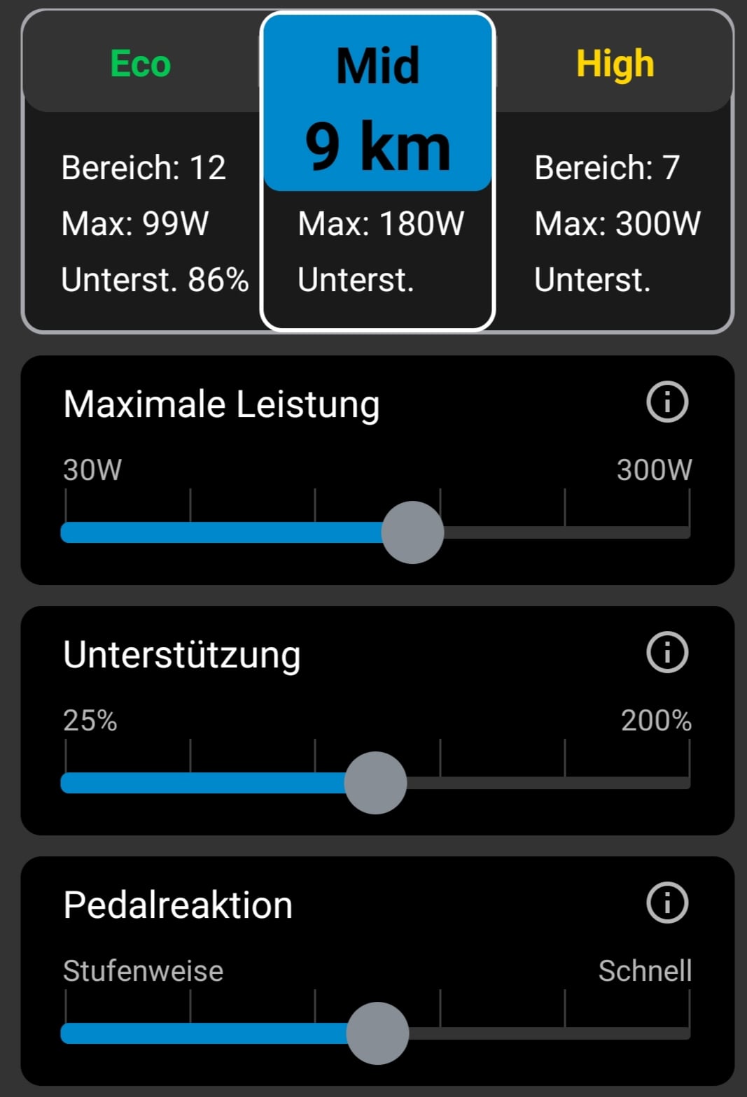

Settings (stock):

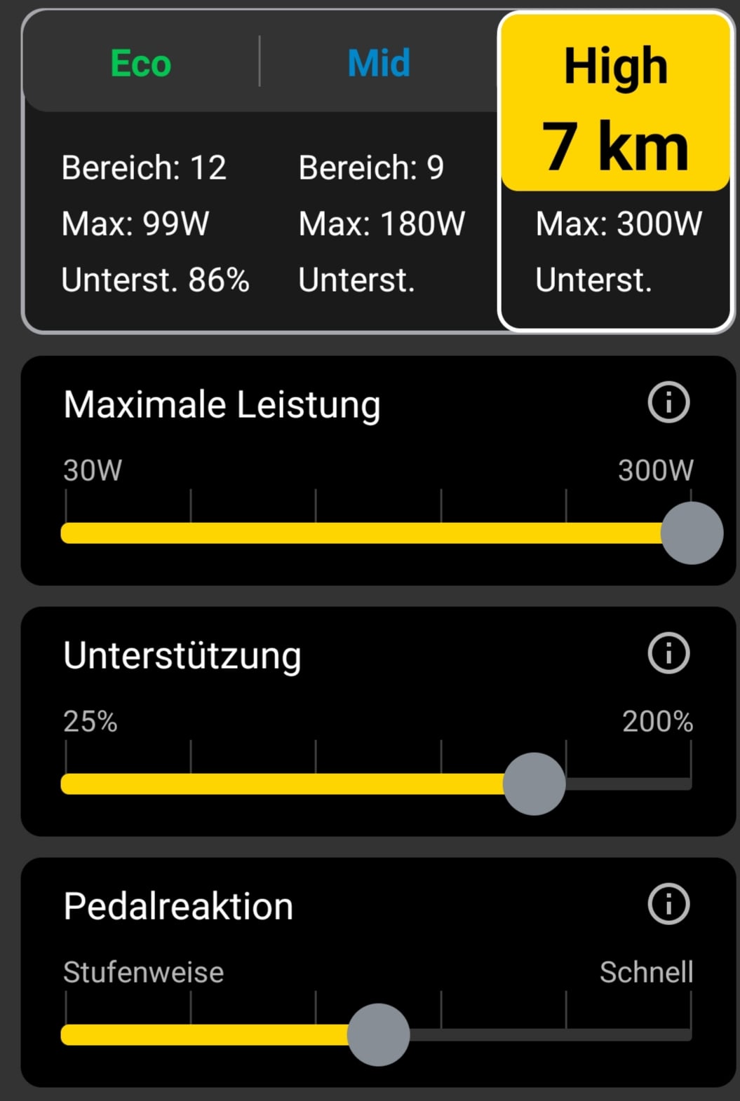

I don't if it's my region where i live, but the Trek Central app is way off with the elevation data. Had a ride today tracked with Trek app and Strava. Distance was very similar, but elevation difference was almost 700m. How is the data in the Trek app calculated?
Strava 926m total elevation, Trek 1613m.
Distance ~33km, 76% battery used, 70% eco/30% mid.
