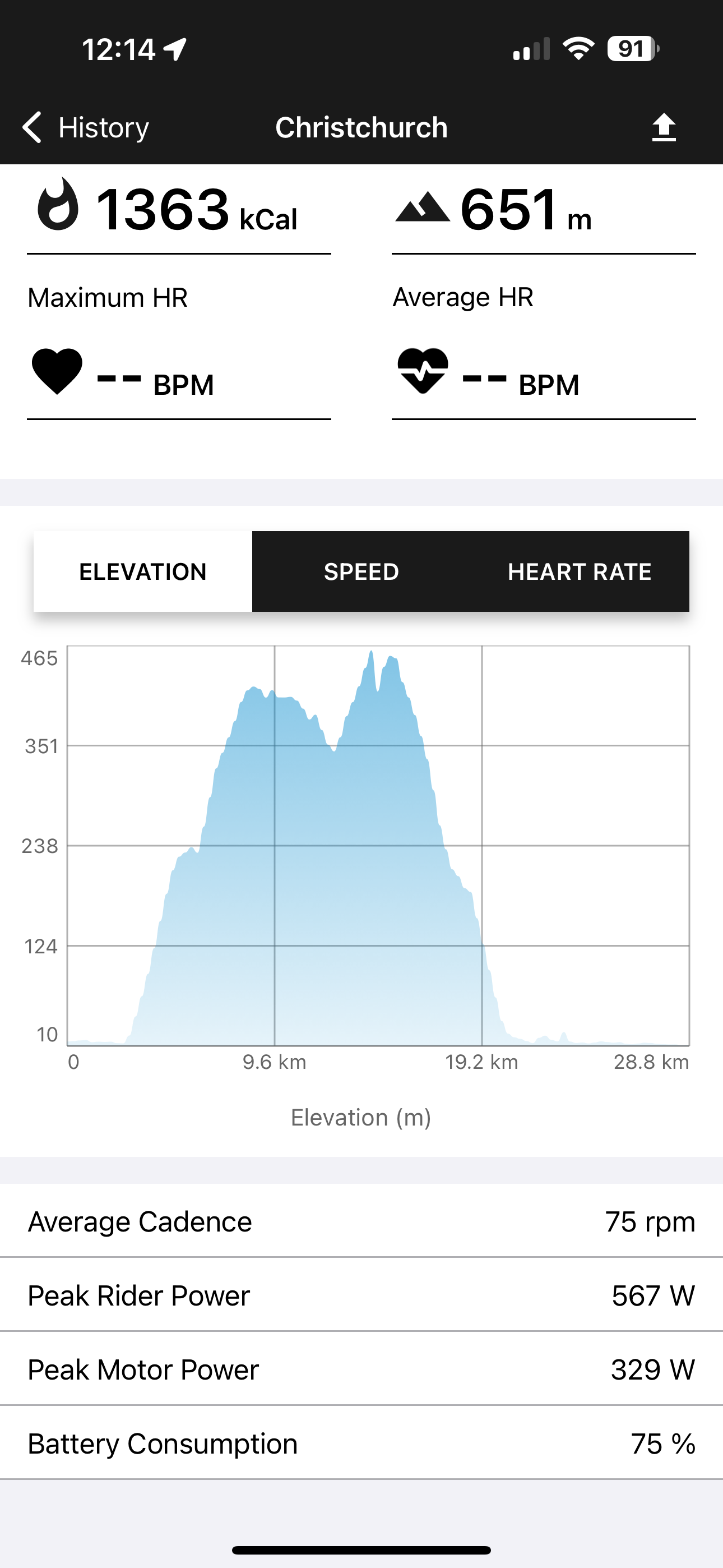

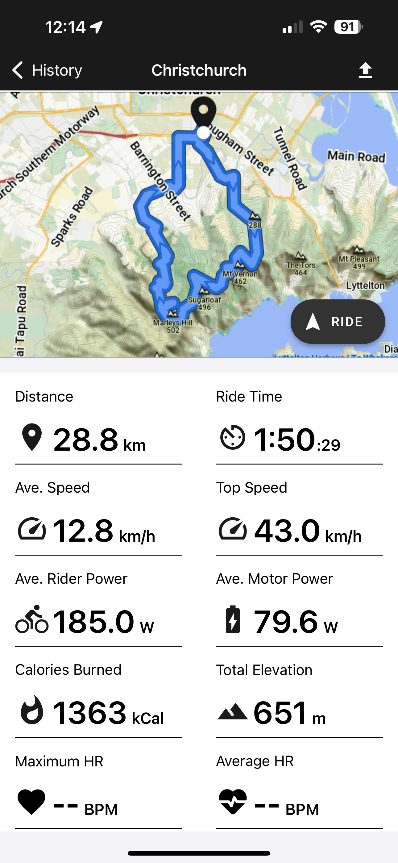

Finally did my first decent ride on my exe this morning. It takes a LOT more effort than my rail. Did the whole climb in mid power. My motor settings are.
Eco (108w and 85% assist)
Mid (200w and 100% assist)
High (300w and 156% assist)
Did 28.8km with 660m of elevation. Got home with 25% battery left. 70/30 mix off road and roads to the trailhead and home.

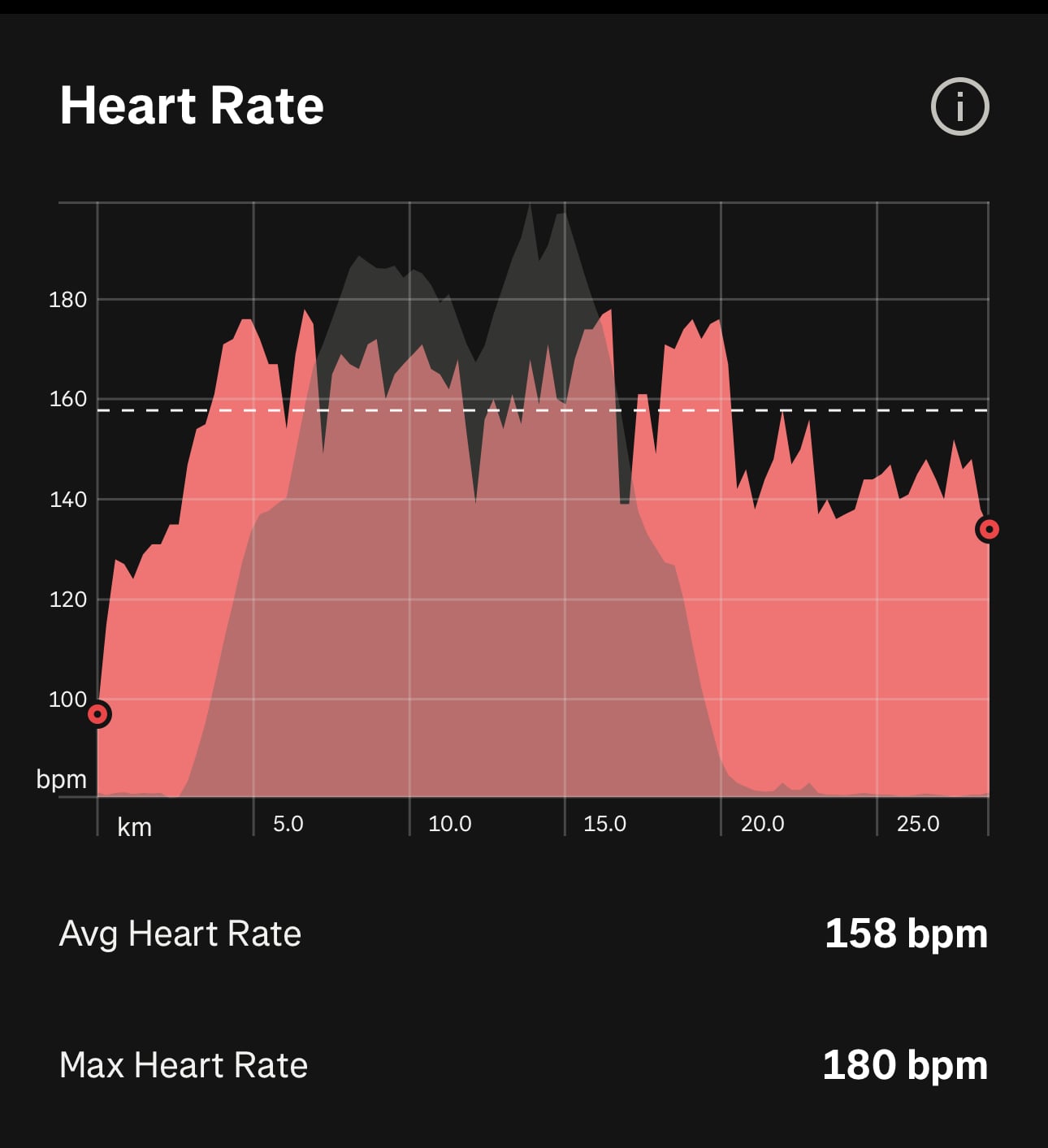

Strava HR data added from my Apple Watch. No wonder I’m so tired haha
